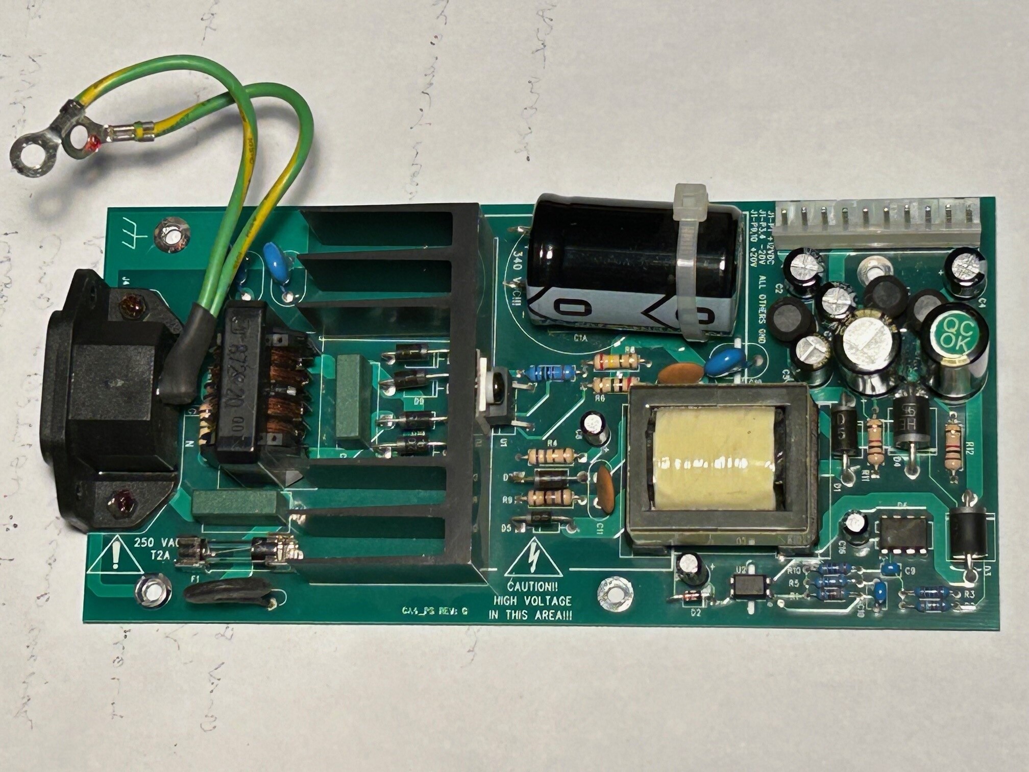

    Hello Everybody,
    Trying to repair a power supply from a Russound CA4 Multizone Controller (picture attached)
    Russound no longer supports it but were kind enough to provide a schematic of the power supply (pdf attached).
    The outputs marked 12v and 20v are all measuring only 1v.
    The board is clicking, which I think means it is in something called hiccup mode when the flyback transformers switches because of an internal problem or something else on the board Overloading it.
    The capacitors physically look clean (no bludgesor leaks) and are not shorted. The diodes seems to all be showing continuity only in one direction.
    Someone in another forum suggested lifting a leg from the 2M 1/2W resistor at position R6 that triggers the TOP248YN (connected to the large heatsink) but it tested at healthy looking 1.994M.
    Have enough skills to be dangerous, but am in over my head on this one.
    Any guidance on how to pinpoint the fault Is welcome and appreciated.
    Thank you!

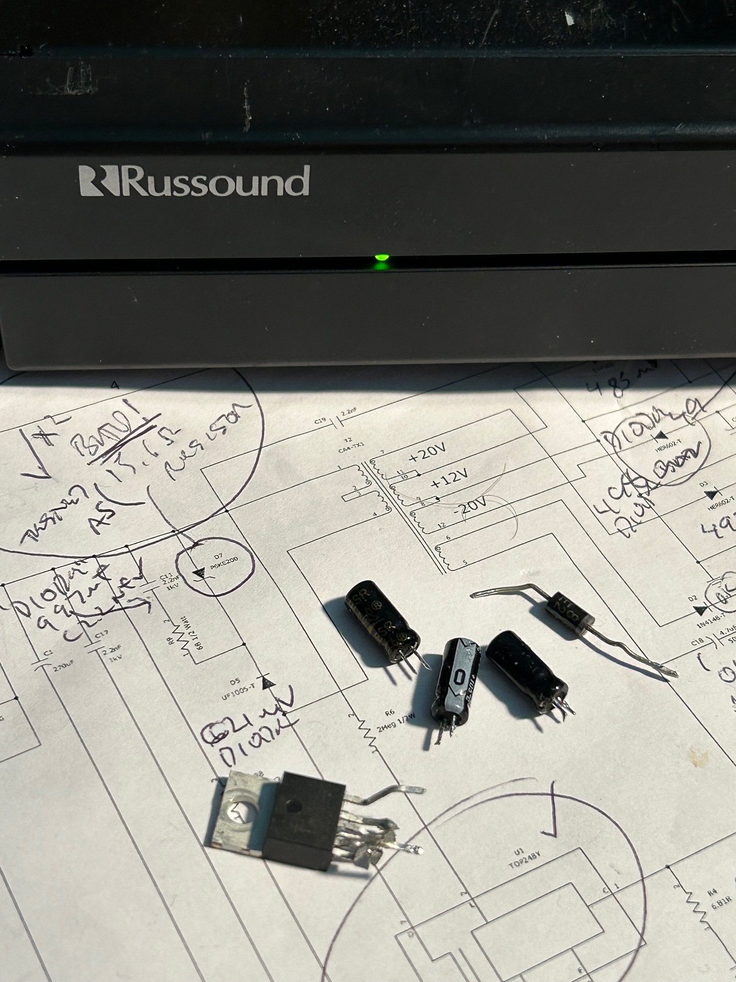

    Success! Replaced the P6KE200, the TOP248YN, and three small capacitors that had high ear ratings and it now alive and kicking,
    thank everybody!

      A cap that can cause problems is C18 (4.7µf/50v) check that there are no shorts across any of the outputs

              If C18 is bad, as in open, the top248 will start and shut down repeatedly, this cap is meant to maintain the ic's vcc voltage, D7 is a tvs diode and might check open circuit, D5 should check as a regular diode, remove one end of these diodes to check them out of circuit, if one is shorted it could cause this problem as the primary of the transformer is not being switched
              D4 might be the problem as it should not check 1.5 in reverse, remove one end and check it again. D3 should check the same as D4 (obviously D4 is installed for negative voltage)
              The clicking sound is usually caused by the ic driving the transformer and shutting down due to a short in the output somewhere.

                  Remove and test out of circuit the three small capacitors C18, C16, C8
                  Though C18 is the most likely to cause this issue, the others might too.
                  D2 could also be suspect, it maybe shorted/leaky.
                  Another fairly likely cause is the TOP248YN, I've seen a lot of these little integrated "offline" SMPS controllers fail, in various ways, and power-cycling is one of them.

                    Pulled just about everything off the board to test out of circuit.
                    Turns out that it was none of the above.
                    It was the diode at D7, a P6KE200 testing as a 15.6 ohm resistor instead of a diode.
                    Thanks everybody.
                              thank everybody!
