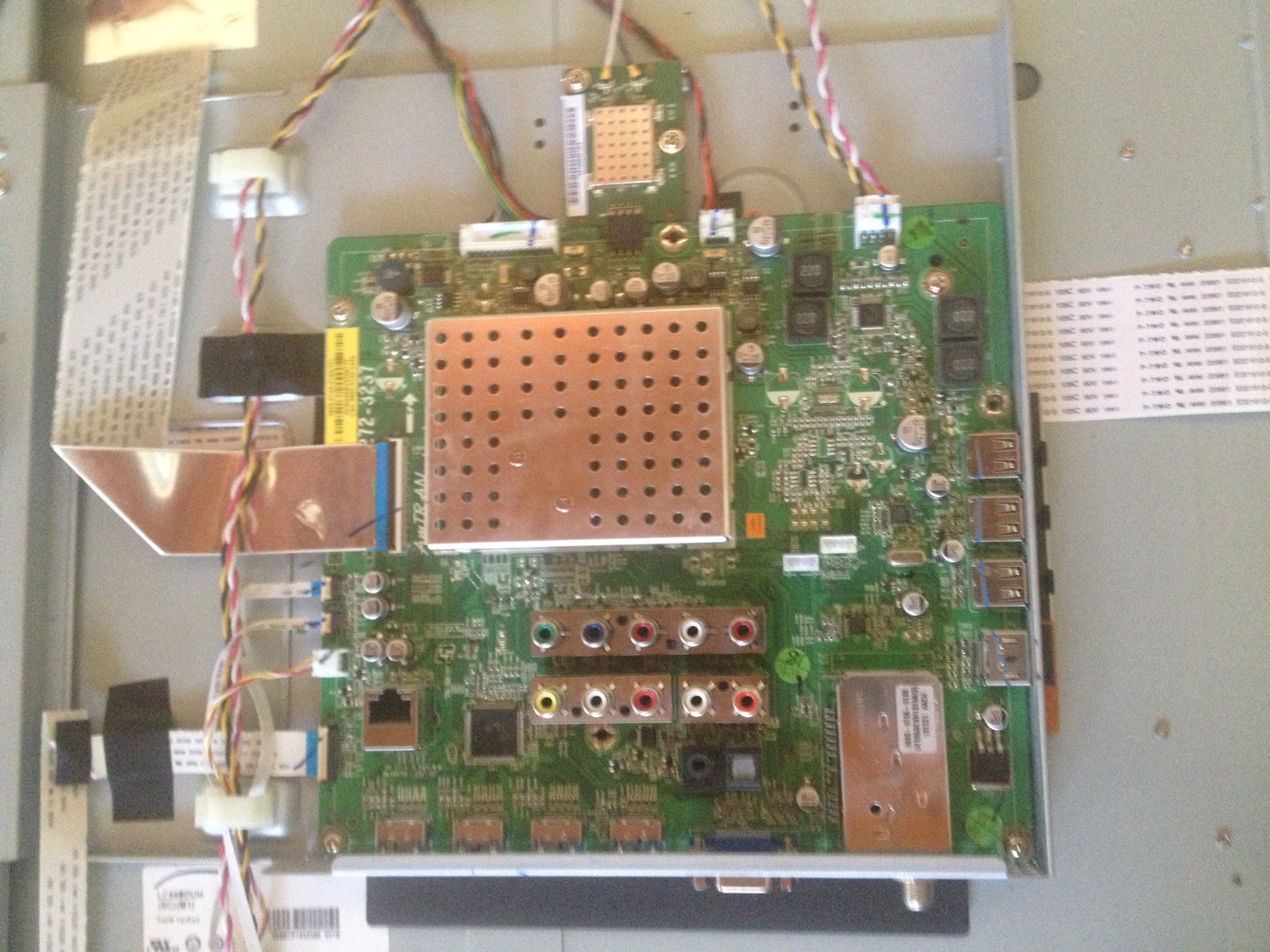

    This is most likely a bad main board on these models. If you post some pictures of inside the unit, it may be possible to rule out the other parts so you know it is the main board at fault.

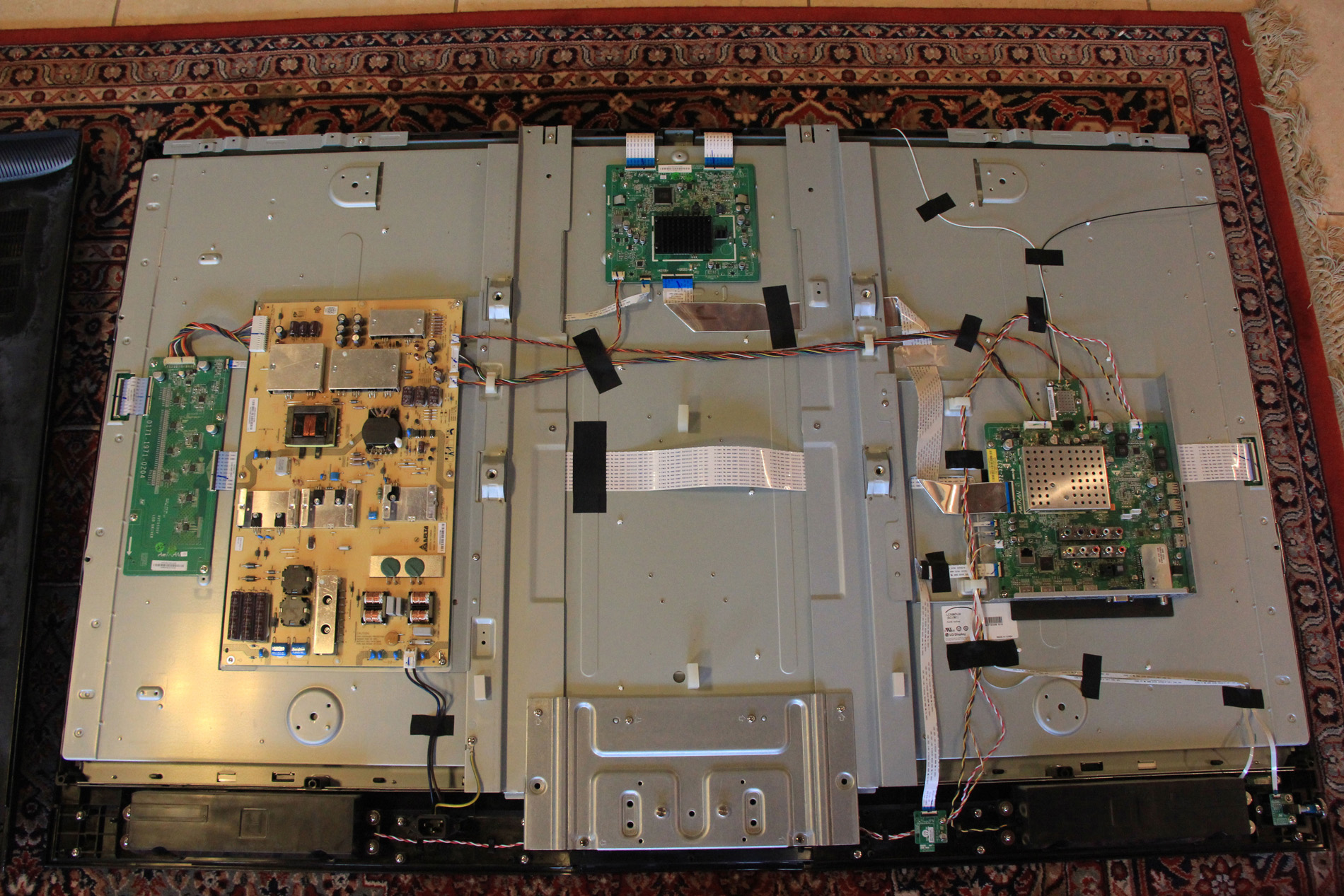

      Hello Tom, Thank you for your help. The requested photo is attached.
        Re: 55" Vizio XVT553SV no power, just orange standby after power surge
        OK, left hand yellow board is your power board.
        Right hand green board (with video inputs) is the main board.

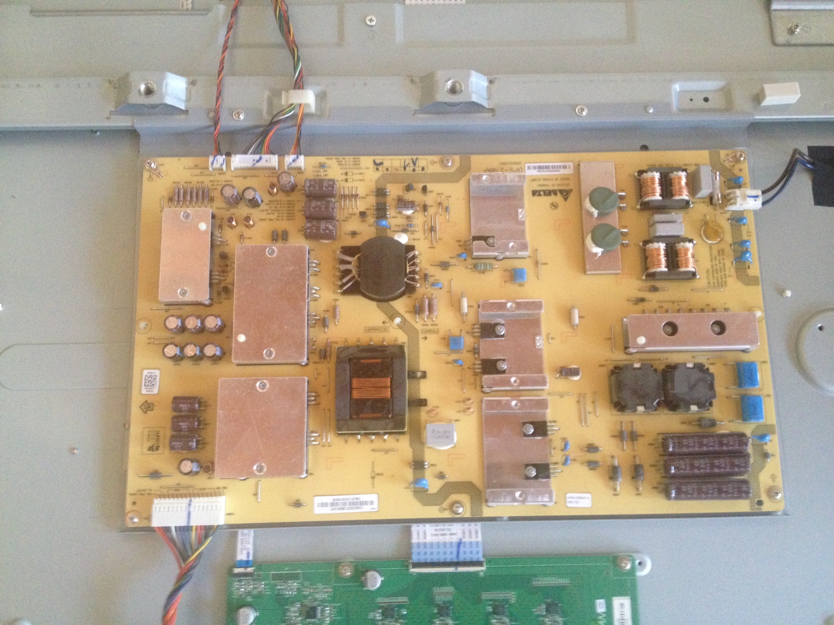

        On the power board there is a power cable which connects to the main board. Can you get a closer shot of around that cable?
          Hi Tom, these pics may not be clear enough but let me know if I need to take better ones. Thanks!
          I found someone has some good pics here: https://www.badcaps.net/forum/showth...light=XVT553SV
          The TV is at my friend's house so I am unable to take new pics at the moment but hopefully the ones I have and the pics from other thread will help.

              I would say this is almost certainly a main board fault. Even if the power supply wasn't working, the Vizio light should turn white when the power button is pressed. The same 5V that runs the standby light also turns it white. I've had a few in this same state. The couple I did have with PS issues were at least outputting 5V and the logo would turn white even though nothing happened beyond that.

                    Eeprom chip would be a likely suspect. You could check all the voltage regulators too. I've heard of people having luck with an eeprom swap but I tried two with no success.
