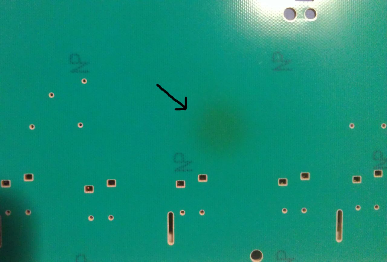

        Re: Sony Bravia KDL-37M4000 doesn't turn on
        There's no damage anywhere that I can see. All the caps look good and aren't bulging or exploded. No burnt smell anywhere and nothing looks burnt. There are a couple of spots on the back of the inverter that look like they got a little warm.
        I'm looking over the links you posted, budm.
        Overall:
        Power Board:
        Inverter:
        BM Board:
        TCON:

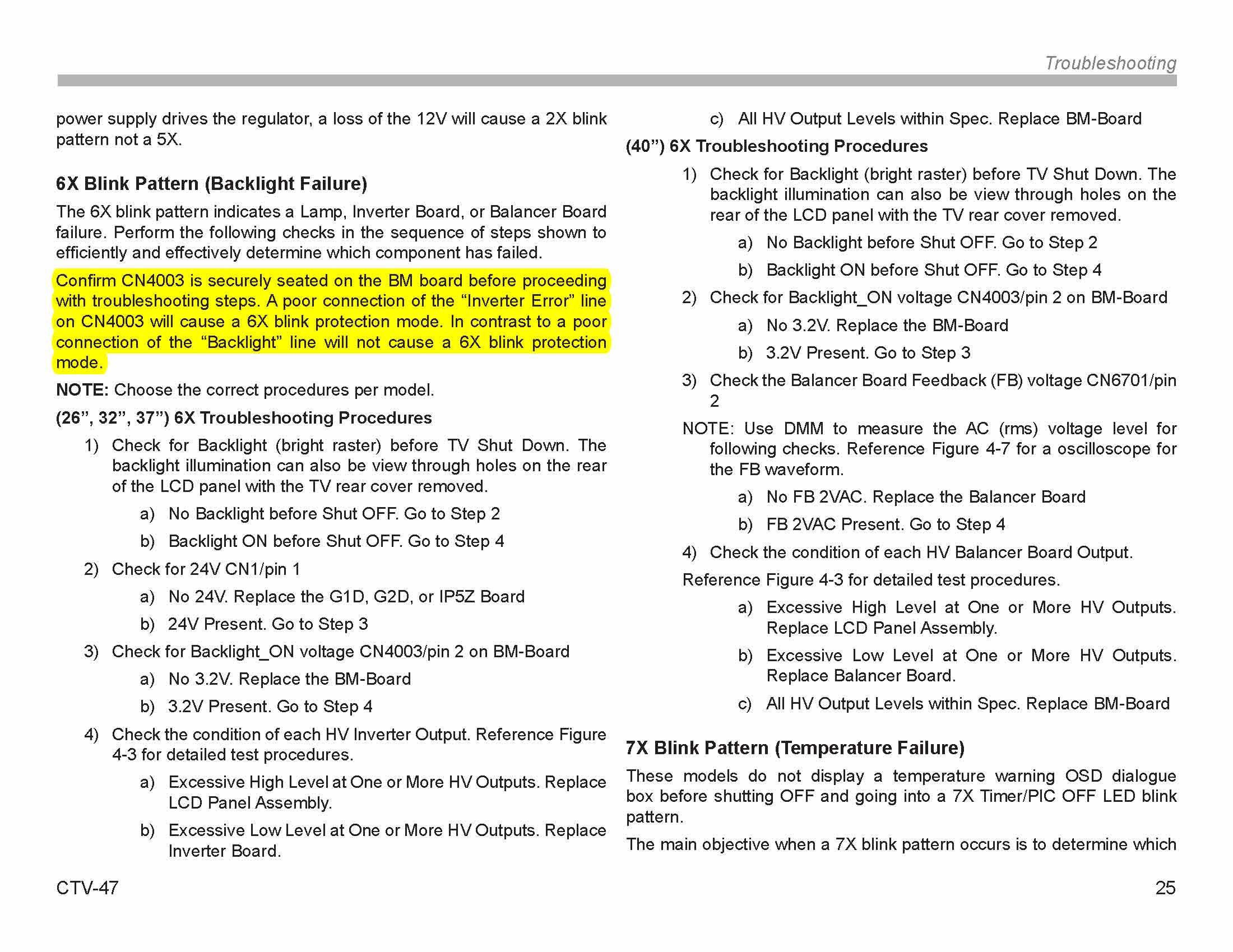

            I tried your suggestion, jose6326. Couldn't get a backlight to come on with any of the connectors removed.
            The service manual says the Timer/PIC LED flashing 6 times is a backlight problem. It could be caused by the BM4 Main Board, G2D Power Board, Inverter or LCD Panel. That narrows it down some. ;-)

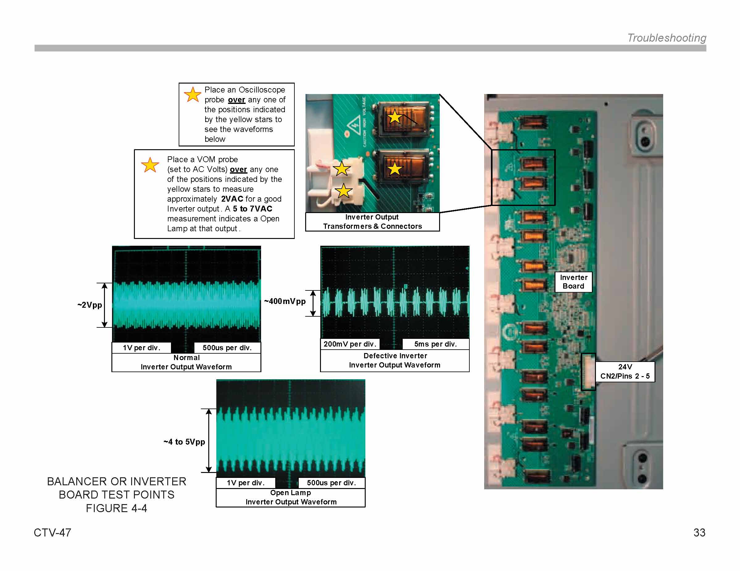

                    Let me check ... Alright, I'm getting 24.28V at each of the pins on the inverter connector on the power supply.
                      Can we get good clear focus picture of the inverter board, and any labeling by the connector? We need to look for BL_ON ot INV_ON signal pin.
                            OK, check pin 2 (BACKLIGHT), that is the BL_ON signal to turn on the inverter.
                            Also check pin3 (error) when TV is off and when you turn it on.
                                OK, I need to find out what Inverter error (Pin3) and the Balancer (pin5) error signal should be HI or LO for normal operation.
                                    OK, the Inverter error should normally be low when the inverter board is OK.
                                    Per training manual, the 6-blink code will only happen if the inverter board is not working, poor lamp connection will not cause 6-blink code.
                                      I'm getting 24V on Pin 1 at the inverter connection (CN1). I'm also getting 3.2V for Backlight_ON voltage at Pin 2 on the BM board connector (CN4003), but it drops to zero after about 3-4 seconds. Should that be a continuous 3.2V or is it just a momentary signal to power on the inverter?
                                      I don't get any voltage readings on the HV side of the inverter when I turn on the TV per the instructions on FIG 4-4 that you provided.
