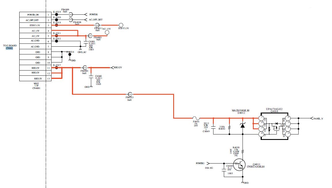

    Ok, I replaced the inverter. It's still not working, but now I'm getting slightly different symptoms.
    The Timer/PIC LED doesn't flash red at 6X intervals anymore. The TV turns on and stays on with a green power LED. When powered off, there's no standby LED (never was). There is still no backlight, no video and no audio.
    I checked the standby power circuit at CN602 on the power board. With the power off, there's 3.36V at pin 3 (Standby), 3.36V at pin 2 (AC_OFF_DET) and 0V at pin 1 (POWER_ON). With power on there's 3.10V at pin 1 (POWER_ON).
    It looks like the standby circuit is good... Where to next or do I need to replace the main board (BM4)?

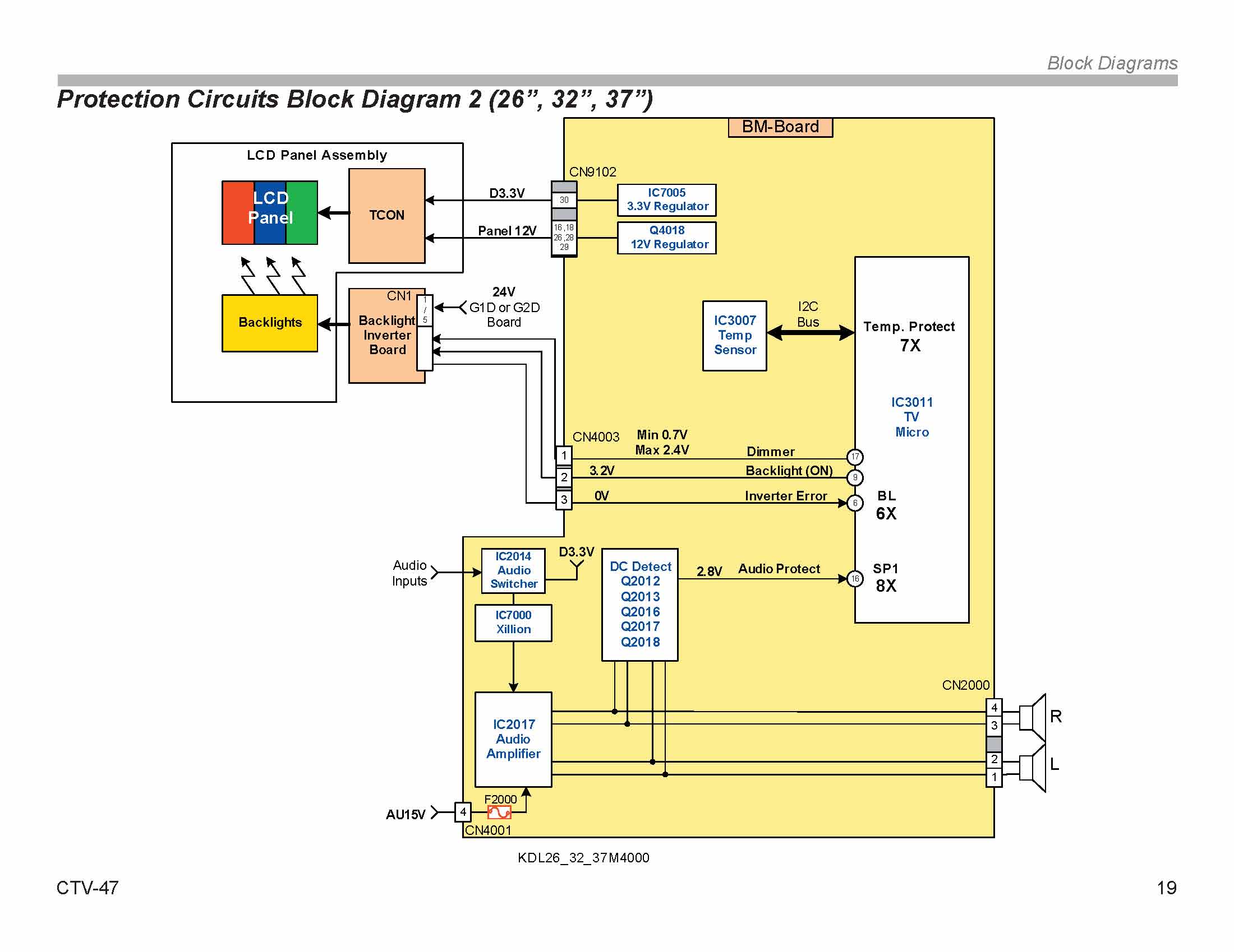

      So what voltages do you get now at cn 4003 in the post 13 diagram?

        Re: Sony Bravia KDL-37M4000 doesn't turn on
        Pin 1 (Dimmer) is 0V when off and 1.63V when turned on.
        Pin 2 (Backlight) is 0V when off and 3.14V when turned on.
        Pin 3 (Inverter_err) is .76V when off and .93V when turned on.
          It is strange that you no longer get backlights error code with the new inverter board, I have to think what to check next.
          OK, try grounding the inverter error pin to ground with 100 Ohms resistor, then power up the TV to see what happen.
                I connected the 100 Ohm resistor to pin 3 and connected the other end to chassis ground. When I plugged in the TV it read .76V and when I turned on the power it read 1.36V. Then after I turned the off the power and it dropped to .25V. I had to unplug the AC and plug it back in to get the .76V reading again.
                  That does not make sense for it to have that high reading of 1.36V since we basically ground the Base of the transistor to ground with 100 Ohms resistor. The Base resistor for Biasing the transistor is 10K (RB4001) so it can not have 1.36V reading due to resistor divider circuit ratio of 100: 10,000.
                      I just double checked it again. Now I get 1.38V with or without the resistor when powered on.
                        #31
                        Are you sure it is 100 Ohms resistor? To have 3.3v feeding 10,000 Ohms resistor is series with 100 Ohms to ground, and the voltage reading across 100 Ohms is 1.38V. That does not add up.

                            #33
                            Ok, I got rid of the jumper wires and connected the resistor directly to pin3 and pin 4 (GND) and the 1.36V drops to 0V.
                              #34
                              And what happen when you power up the TV?
                              So I read the training manual again, per block diagram, that Inverter Error pin 3 should have 0 V when normal, that is why I have you ground it with 100 Ohms resistor. Since you are getting 1.3V on that pin, it means the new Inverter board is putting out an error signal. At the same time, you are not getting 6-blink error code which is confusing me now the way it is behaving with new inverter board.
