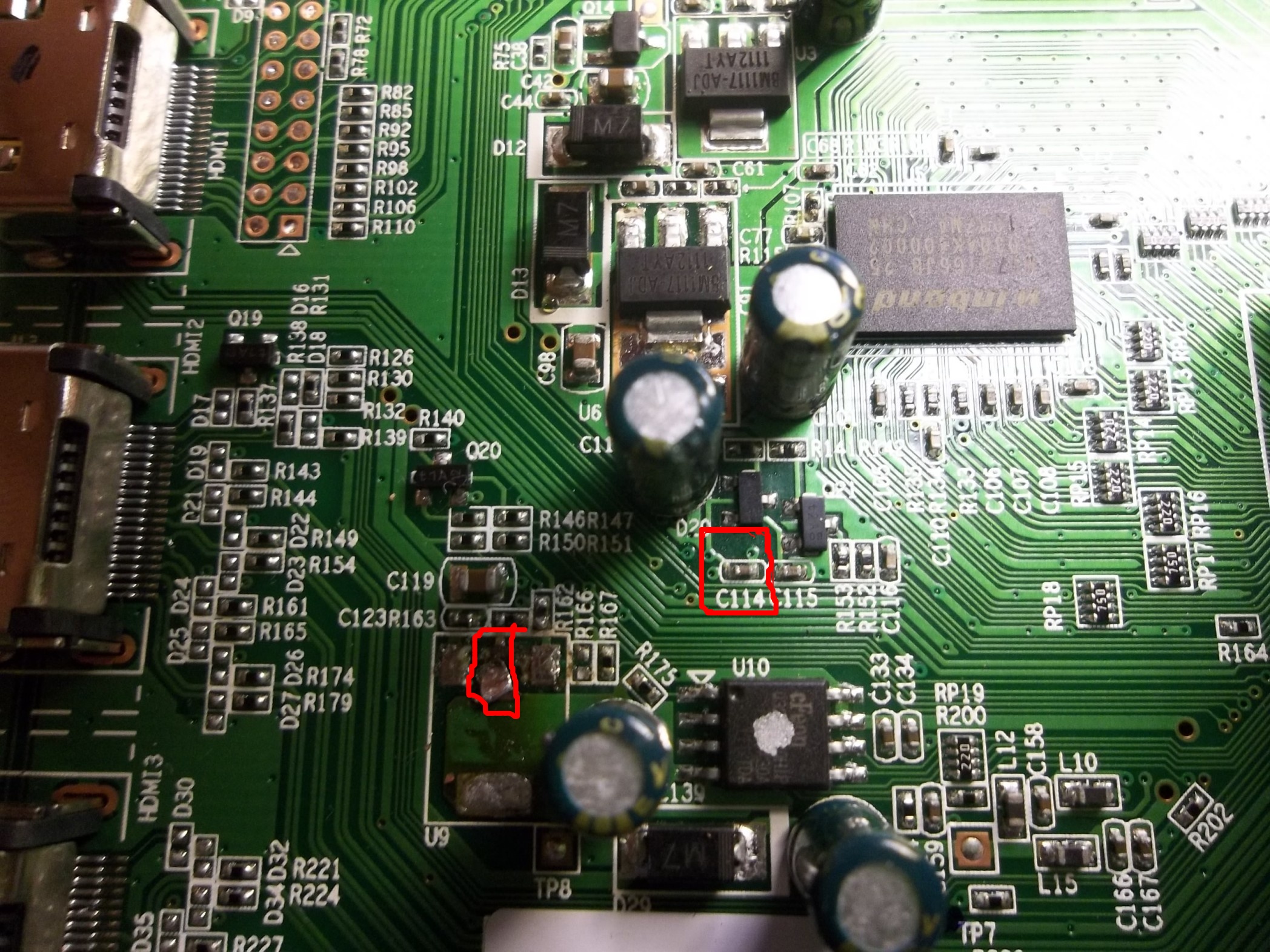

                      I was just about ready to make the test. I mocked up the battery holder, soldered the gnd wire to a gnd on bottom of board. had the 2.2 ohm resister soldered between the +battery and the wire lead. I was attempting to solder the + lead to the pin # 2 pad when the pad came loose. I think I can repair or at least get around that problem. perhaps I shouldn't have done it that way. what way would you have connected the + lead to pin # 2 pad?
                      however, when the pad lifted up off the board, I decided to check to see what side of the smd was shorted. the short is connected via the tab part of the board to gnd. on the other side of the pad where it broke no shorts to gnd.
                      I started checking from gnd to all the caps in the area. all the caps I tested had some ohm readings on the 2K scale. ocassionally one end of the cap appeared to be connected to gnd.
                      however, cap C114 circled in red showed short from gnd to each end of the cap, and when I went across the cap. no other cap did that. could this little guy be the problem? it looks shorter than a 1206. how can you determine the value? OH what I would give for a schematic.
                      thanks Tom, will eagerly wait your thoughts on this one.

                        #51
                        Re: ELEMENT ELEFQ462 led/lcd power problem
                        Pin 2 is connected to the tab pin, so as long as you can solder to the tab that will be fine. I would have just touched it to the board for a short period of time. I wouldn't leave it continuously, you don't need to and it might cause damage.
                        As for which cap is bad, the problem is there may be several in parallel, so they could show short even if they are not. So, you need to try and see what heats up to see what exactly is shorted.

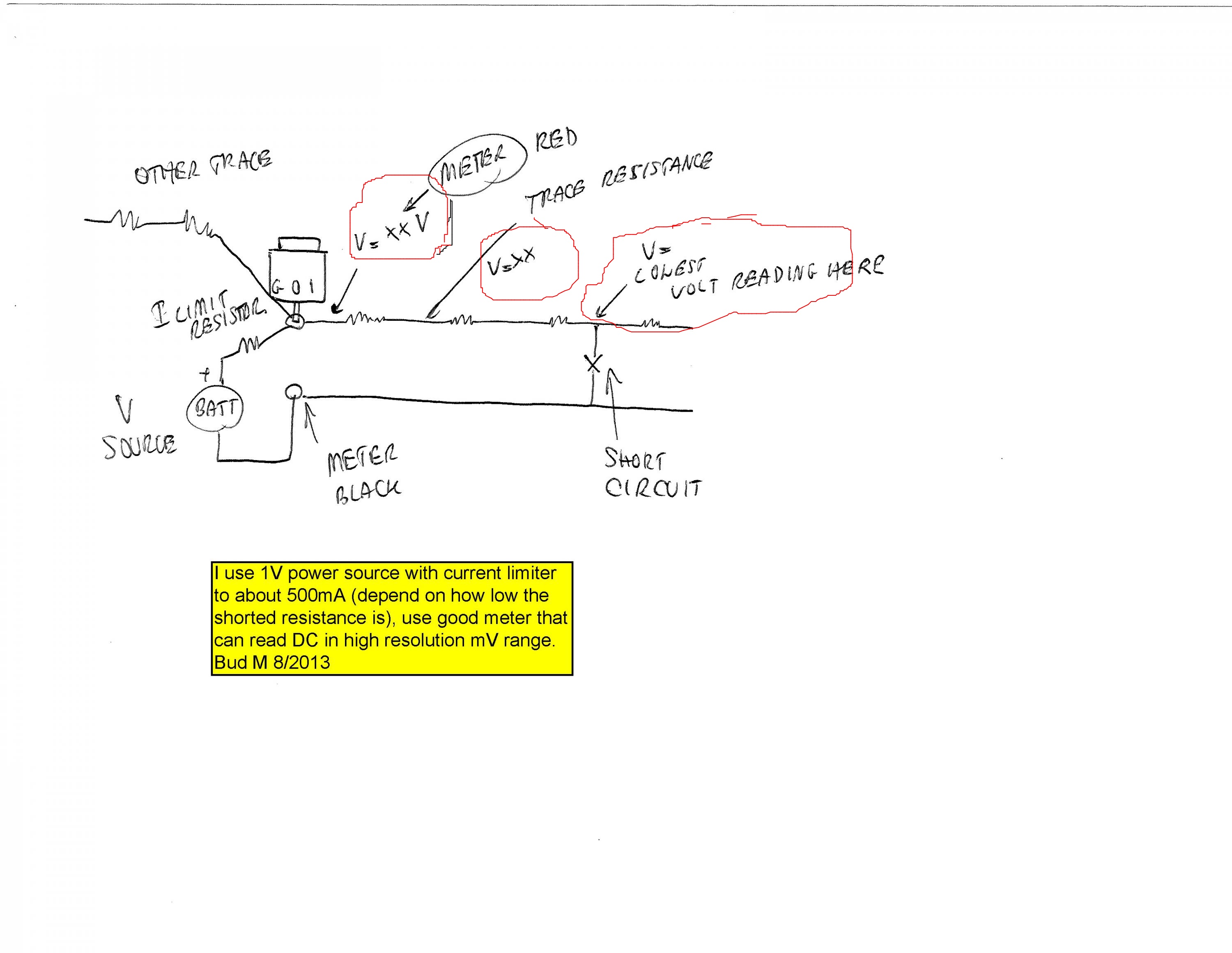

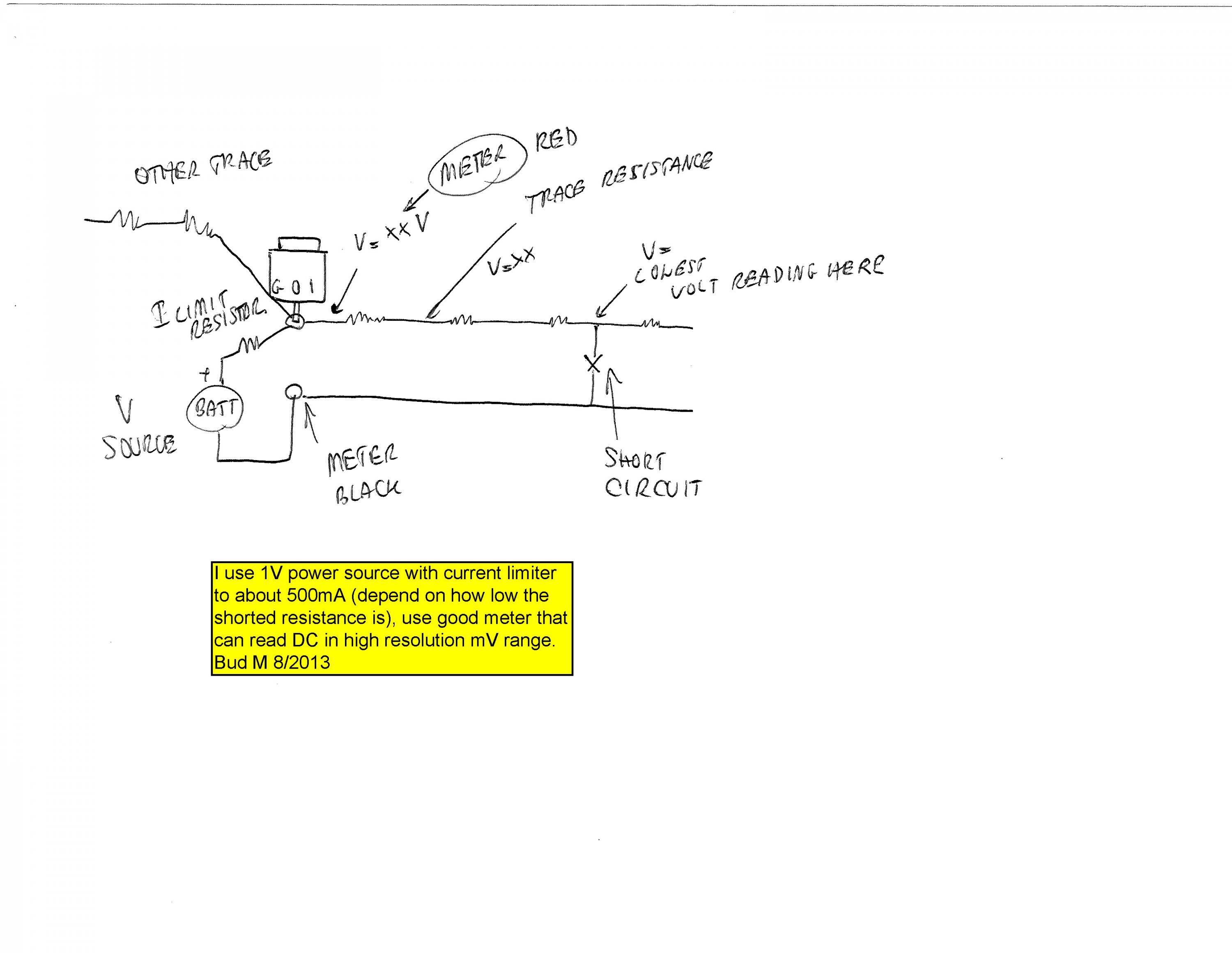

                              #54
                              You try using this method. I use this for checking out short on new prototype PCB. It will help localize the location in that area.

                                #55
                                Tom66-budm,
                                Thanks for the response guys. I have a power supply but not sure about current limiting feature. I'll take a pic and maybe you can tell. the meter face on the PS has voltage reading on the bottom of scale and dc mill-amps on the top of the scale. the voltage can be dialed in.
                                budm,
                                can you explain your circuit a little more in depth, I'm going to need a just a bit more clarity, sorry. this is all brand new to me troubleshooting a circuit like this. thanks for you patience and understanding. I marked up your pic in red.
                                you guys are great, thanks again!
                                frank
                                  #56
                                  Just hook up the power supply to the two pad where the regulator was, then your meter in mV range, black probe right at the pad where negative of the power supply is connected to, then take the reading right at the pad where the positive of the power supply is connected to, take that reading, then start moving the red probe along the trace that is connected to the positive, you will see the voltage starting to drop as you get close to the short, the trace beyond the shorted will show the same voltage at the shorted point.
                                  If you have any old circuit board around you can try it out by creating short and experiment with it to see how it works.

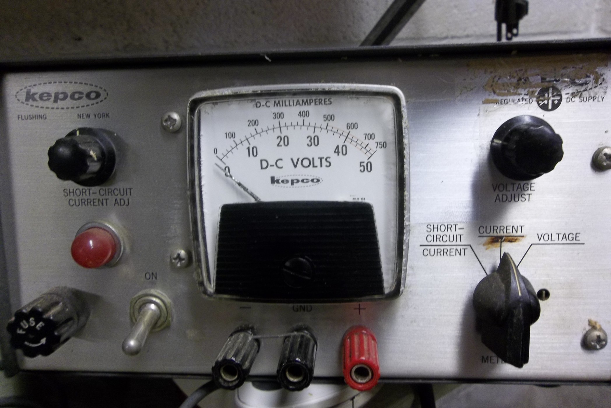

                                    Tom66-budm,

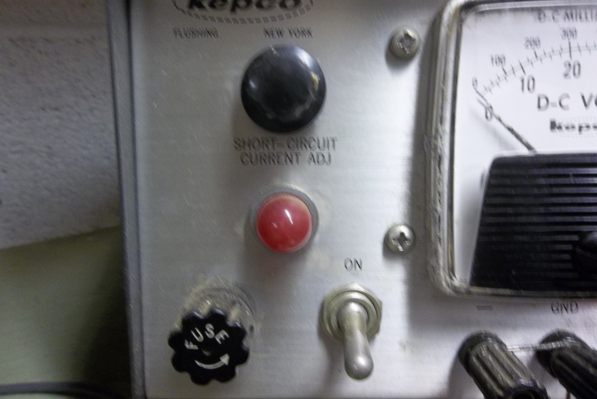

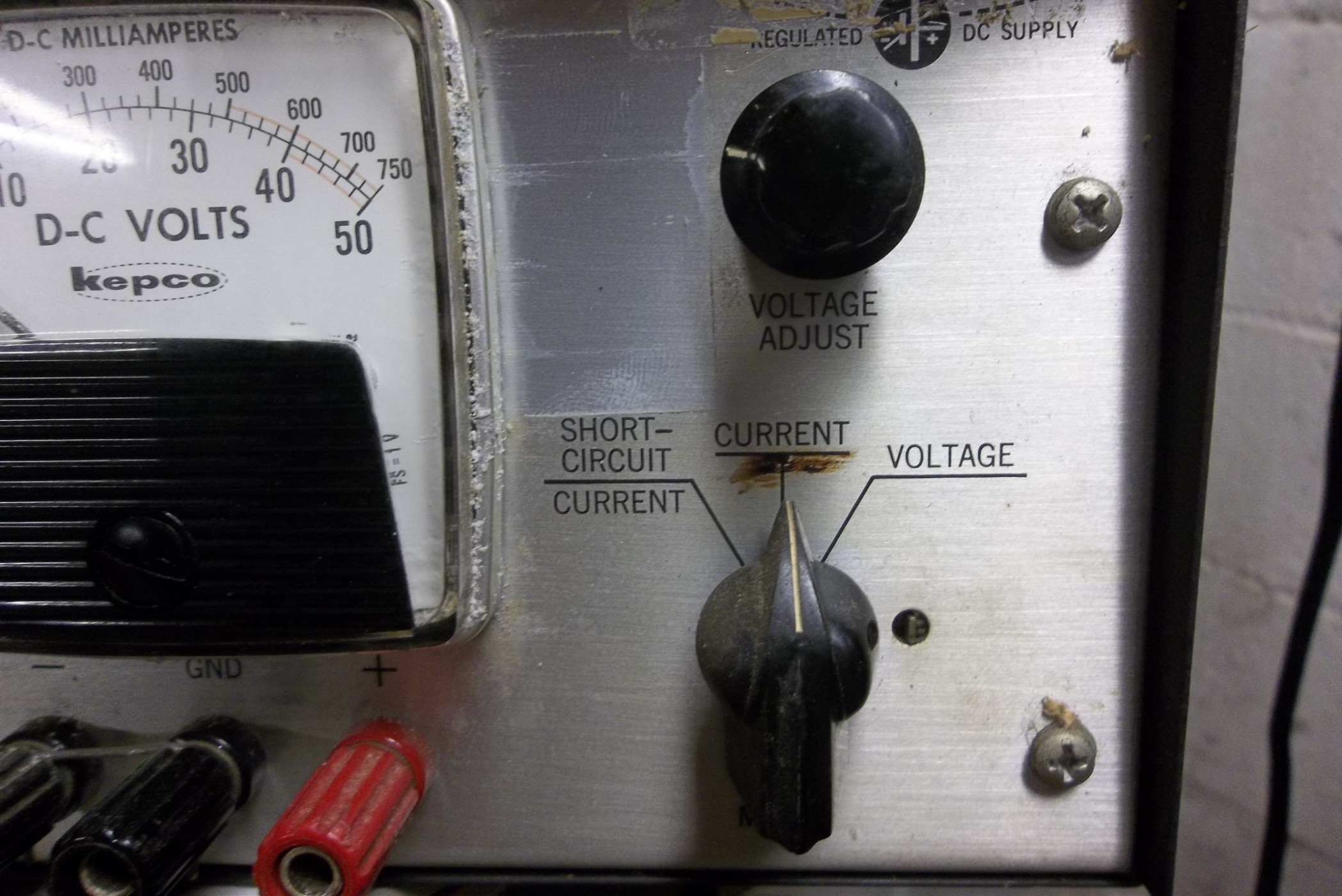

                                    took a couple of pics of the power supply and my meter.
                                    Tom, maybe the supply I have is a current limiting supply. I only used this supply for 12V for bench testing stuff. I don't have the manual. I'm sure it's many years old. if you can determine that it is from looking at it, just give me an idea how to use it in the way you want me too.
                                    the knob on the right sets the meter for voltage or current. it also has another position called short circuit current. that part of the switch is spring loaded as it cannot be left on that position like the positions for V and I.
                                    switch on left says short circuit current adjust. this may be a valid supply for this test.

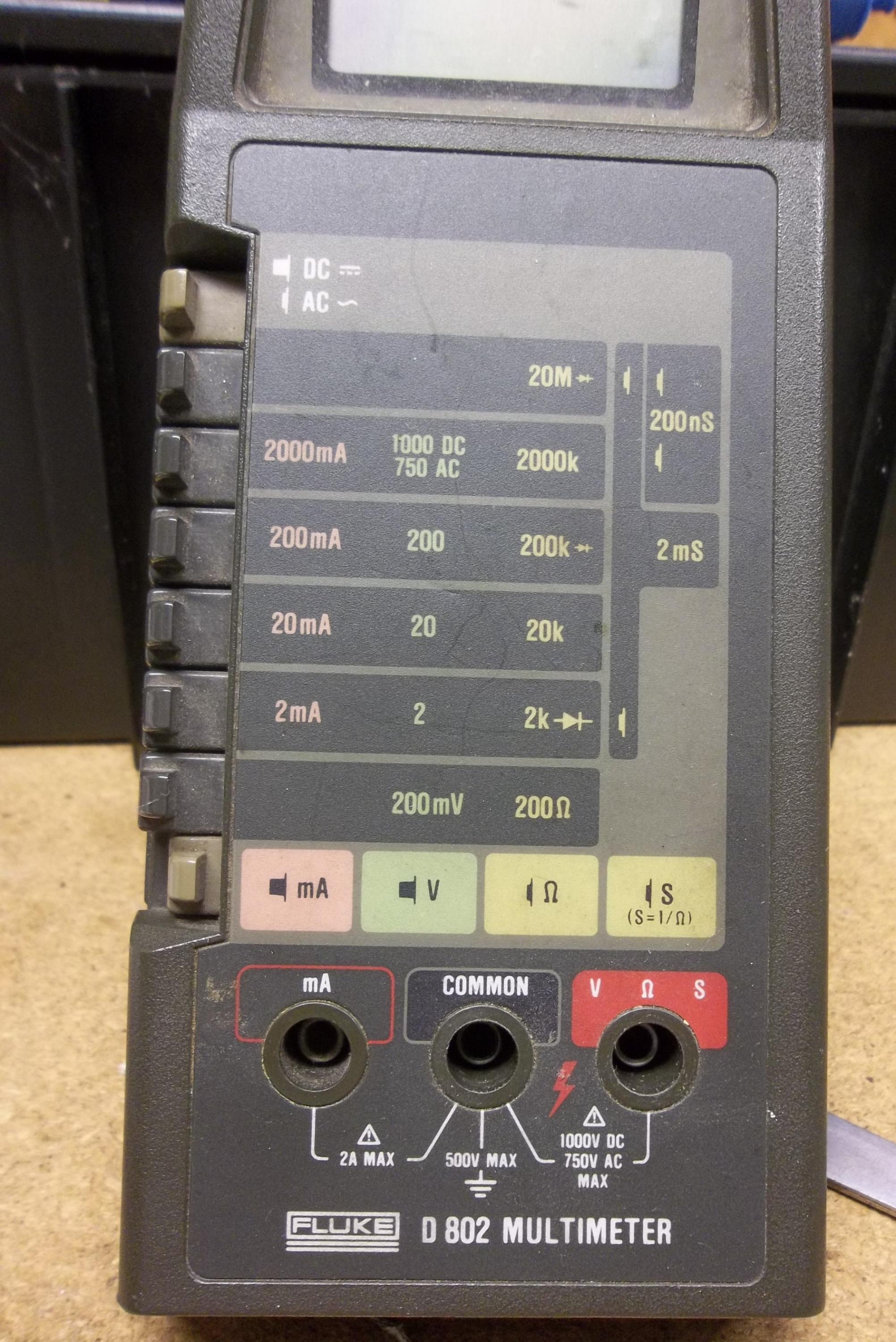

                                    budm,
                                    a picture of my 802 fluke, goes to 200mv, is that worthy of your test method.
                                    thanks a bunch,
                                    frank
                                      #58
                                      Should be usable, but it's only capable of around 750mA from looking at it?
                                        #59
                                        Tom66,
                                        do you think that's too low and won't generate enough heat?
                                        thanks
                                        frank
                                          #60
                                          Yeah, you tried up to 1 amp with no luck. I went for 3 amps in the video.
