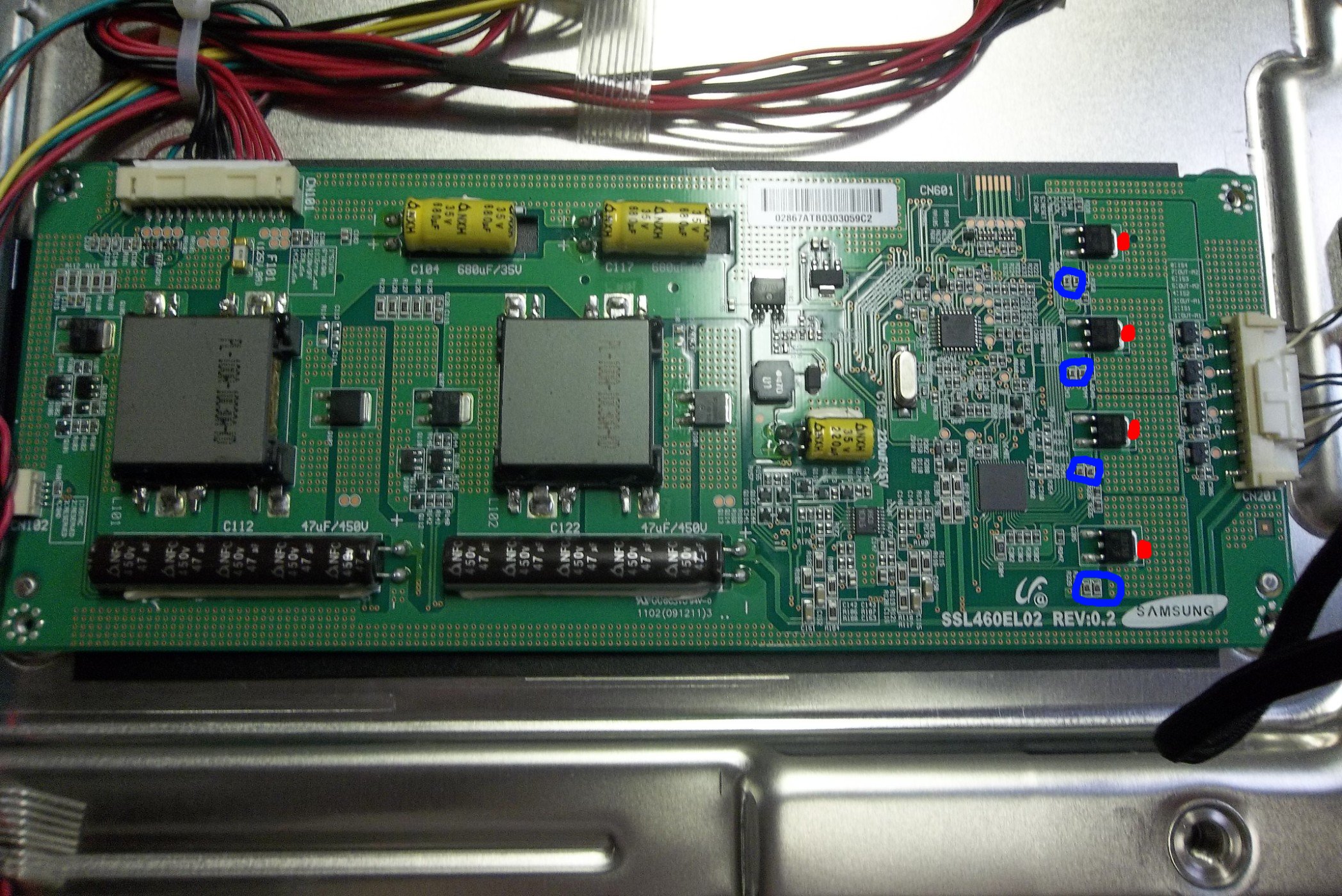

    Tom66,
    unit plugged into ac outlet, not pressing power on switch.
    all 4 pads have 23.5V Tom.
    thanks,
    frank
      Re: ELEMENT ELEFQ462 led/lcd power problem
      That's OK.
      So, next step.
      At red points, please measure voltage (TAB of SMD FET, like testing LDO), I'm expecting nearly the same 23.5V.
      At blue highlighted areas, please measure voltage across one of the two SMD resistor devices. They are in parallel so measuring either is fine. (Red probe one end and black probe other end.) Also, please tell me what numbers/letters are printed on these (they will probably be all the same.)
      EDIT: Please check the previous four test points WITH power on. Then perform above steps.

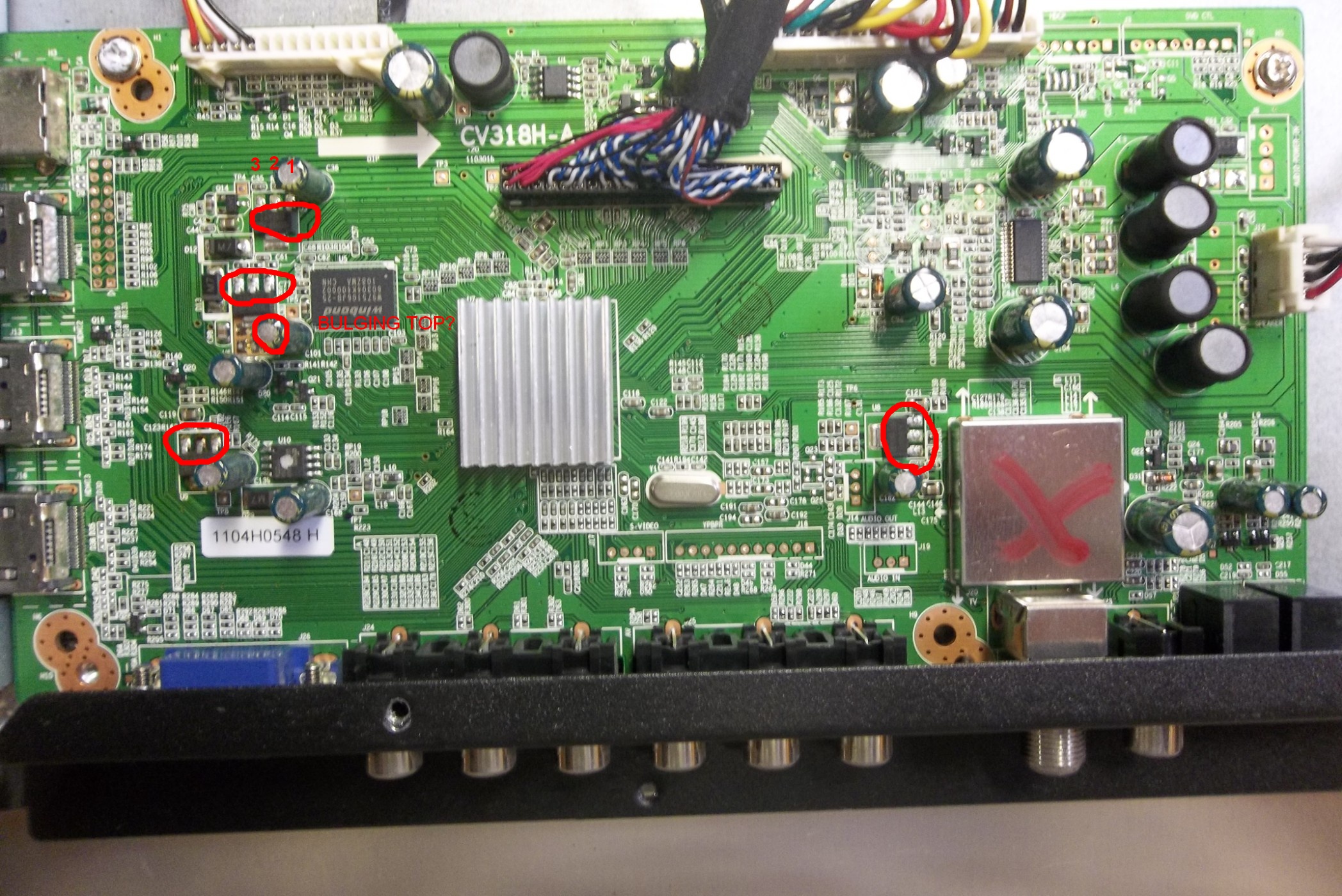

        You may want to check the voltage of those regulator, one of the cap looks like it has domed top.
        TV power on, Black lead on the chassis, red lead on pin 1, 2, 3. Report the reading of each regulator and the P/N as printed on top. I expect them to have something like 1117 printed on top of the body.
            "blue panel goes out"
            You mean backlight goes out?
            I thought you had no backlight, maybe I got mixed up somewhere.
            Proceed with Bud's test for now. Did you check BLON?
                OK since BL ON didn't change, the backlight is not at fault, it is probably a main board fault then.
                  Tom66 Budm,
                  tom66, I had 0 voltage across the resistors marked in blue on inverter board.
                  MAIN board:
                  all 4 smd's are "BM1117-adj
                  1112AYT
                  legend, smd with the tab at the bottom, pins numbered 1,2,3 from left to right.
                  starting at the bottom left of the picture going up, and the far right smd last.
                  pin 1 5.2
                  pin 2 00.1
                  pin 3 00.1
                  pin 1 3.7
                  pin 2 1.8
                  pin 3 0.6
                  pin 1 5.2
                  pin 2 3.3
                  pin 3 2.0
                  pin 1 5.2
                  pin 2 3.3
                  pin 3 2.0

                    #29
                    Double check first reg, but it looks bad.
                      budm-tom66
                      doubled checked the lower regulator.
                      voltages are as stated,
                      pin1 5.2 and 00.1 on pins 2 and 3.
                      any other components I should be concerned about? that cap you pointed out doesn't look bulged to my eye, I can take another picture with a good close up if you want it.
                      tell me more!
                      thanks
                      frank

                          #32
                          Is there P/N printing on that one? It looks bad if it is voltage regulator. Put meter in Ohm mode and check the resistance between chassis and 2, chassis and 3 of that suspect regulator.
                            tom66-budm
                            power to the ac outlet. touched the smd, and it was not warm or hot
                            sprayed smd with freeze spray, no change, it did not melt the frost quickly.
                            ohm readings between chassis and pins 2 and 3:
                            pin 2 .001
                            pin 3 .310 ohms
                            checked on the 2K setting
                            the writing on the smd is BM1117-adj 1112 AYT
                            thanks
                            frank
                              There is a definite short between pin 2 and ground; can you remove the regulator from the board and test the resistance with it removed? (Test the board, not the regulator.)
                                      Pin 3 is ground, or adjust, so that's normal. But pin 2 is output, and that shouldn't be zero ohms, so the short is on the board.
