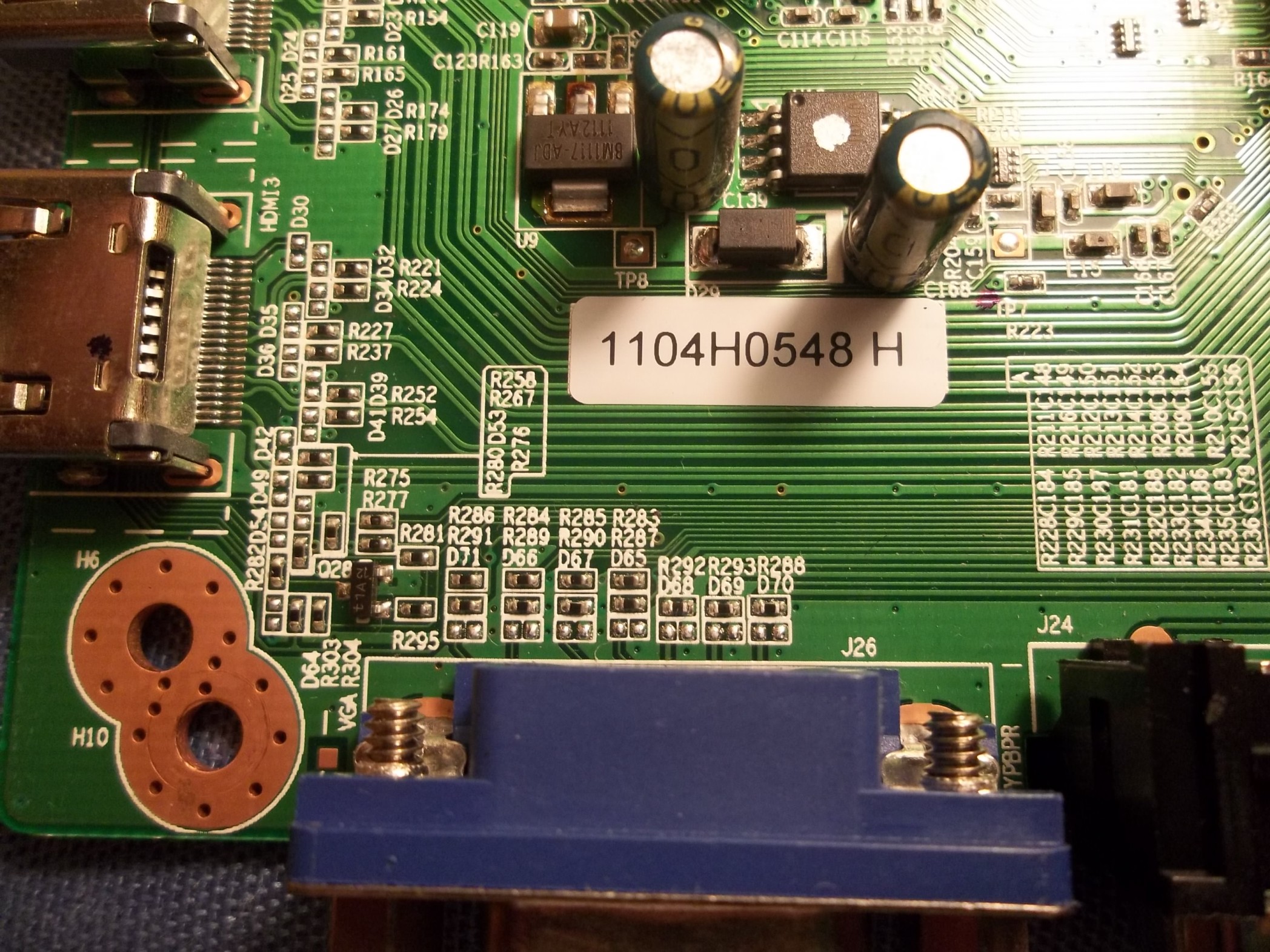

    a couple of observations. looking more closely at the circuit board, it appears that the tab of the smd is also connected to TP8, which on the back of the board says 3.3V stdby. would this smd be providing the 3.3v stdby? also, near the smd is a 8 pin device labeled U10. could this device be faulty. it's almost impossible to read any markings on the device.
    I may attempt Budm's way of trying to find the shorted device. the trace is almost impossible to track between devices. it's not obvious where the trace is going from device to device.

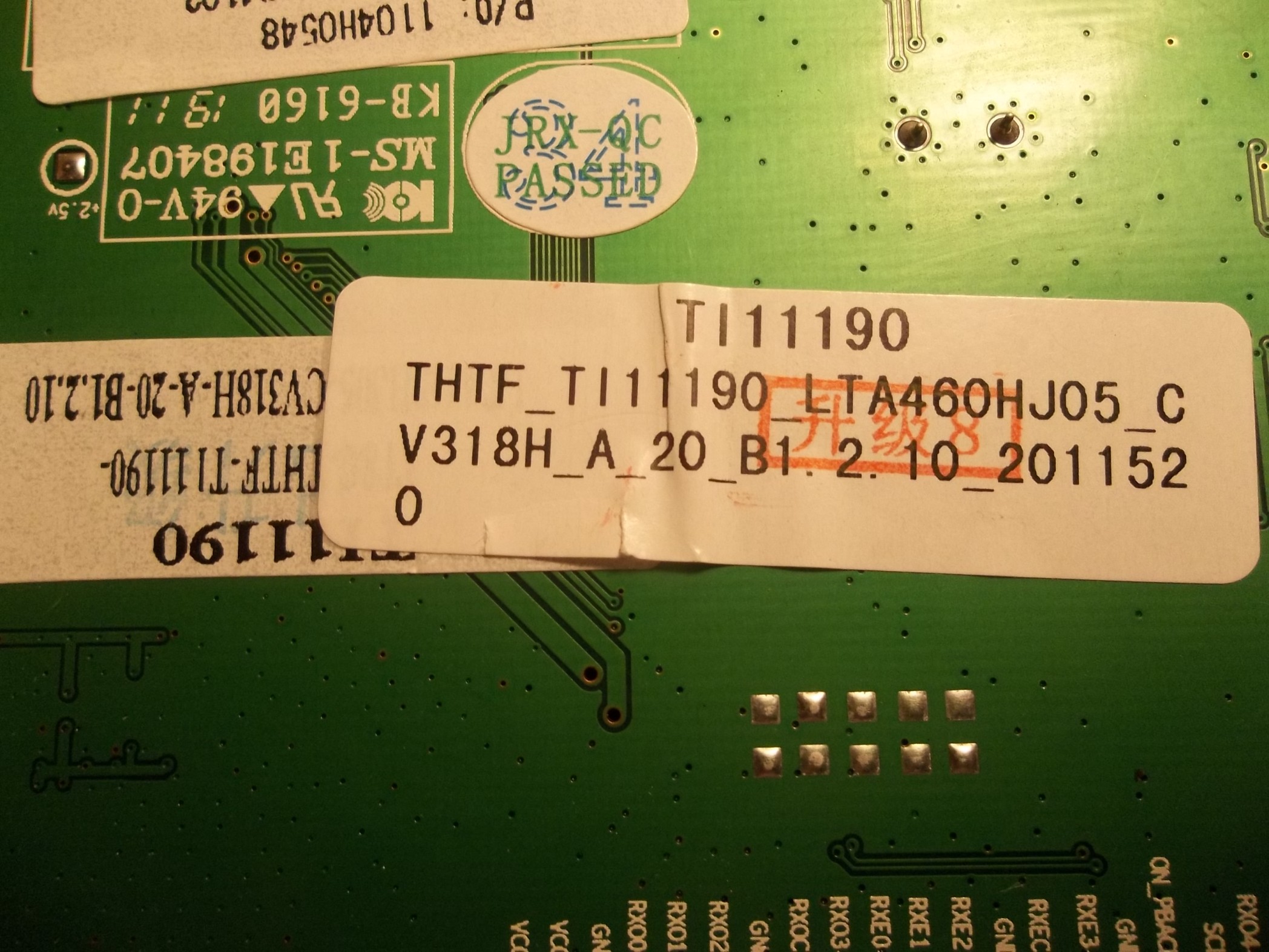

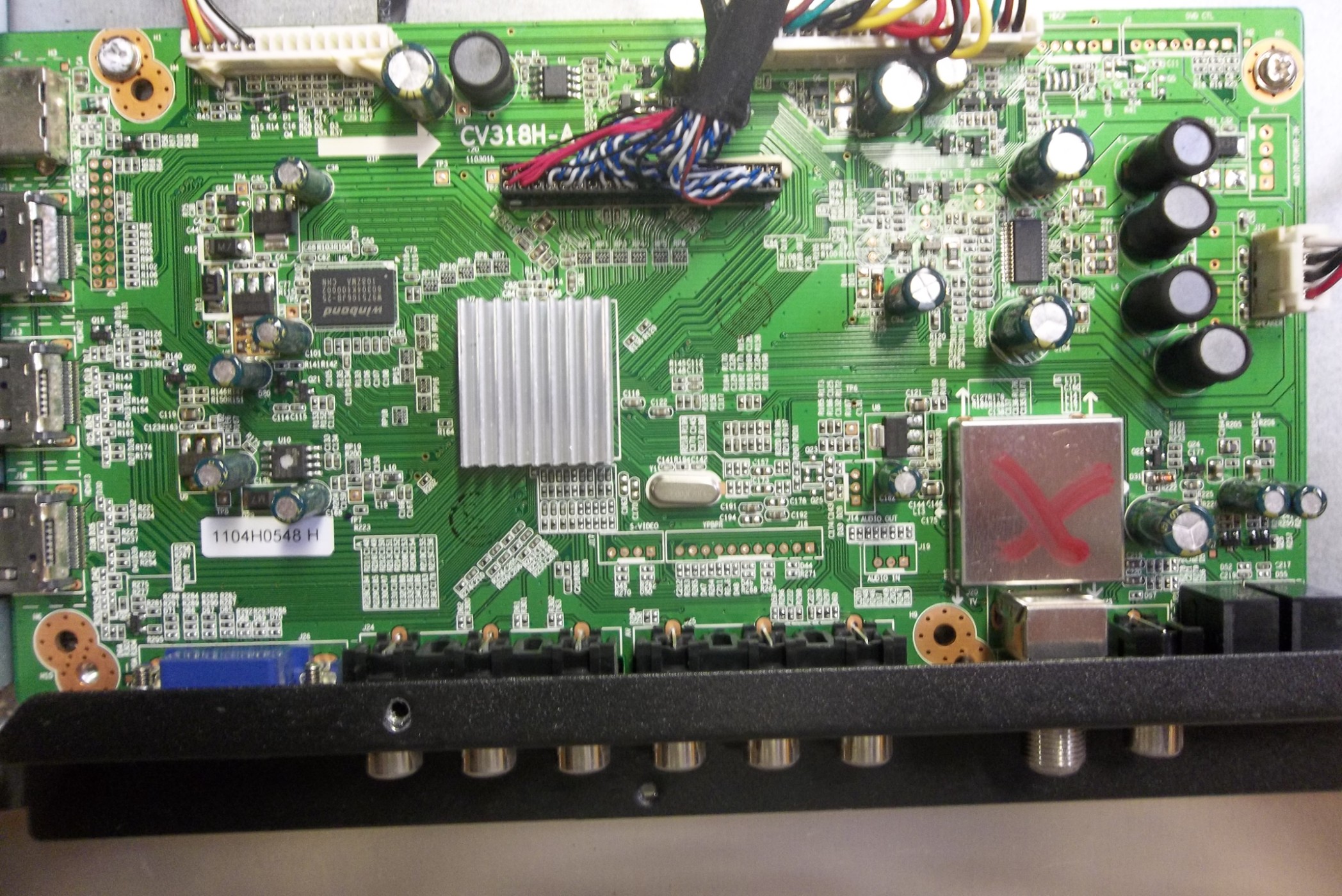

        Re: ELEMENT ELEFQ462 led/lcd power problem

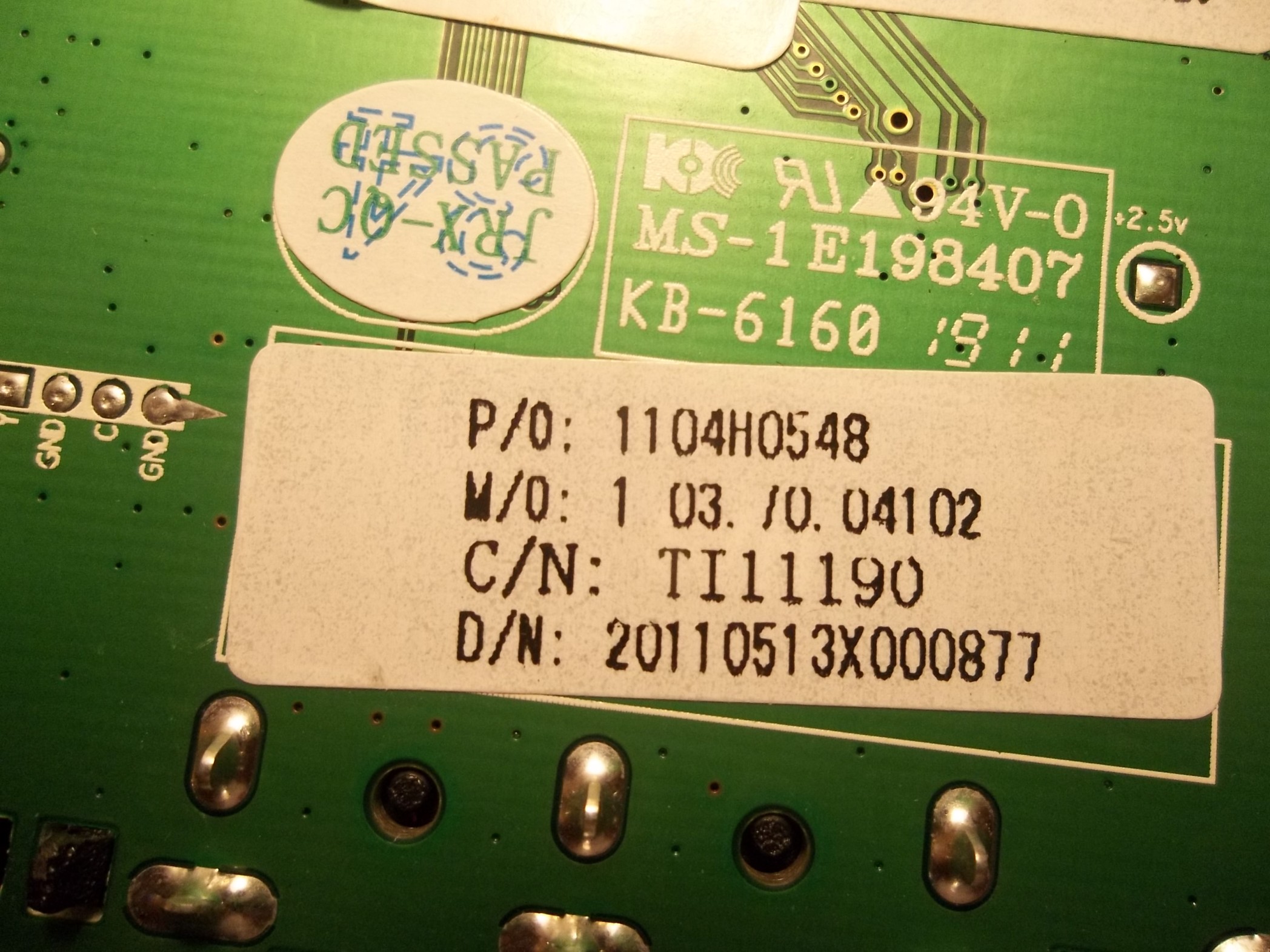

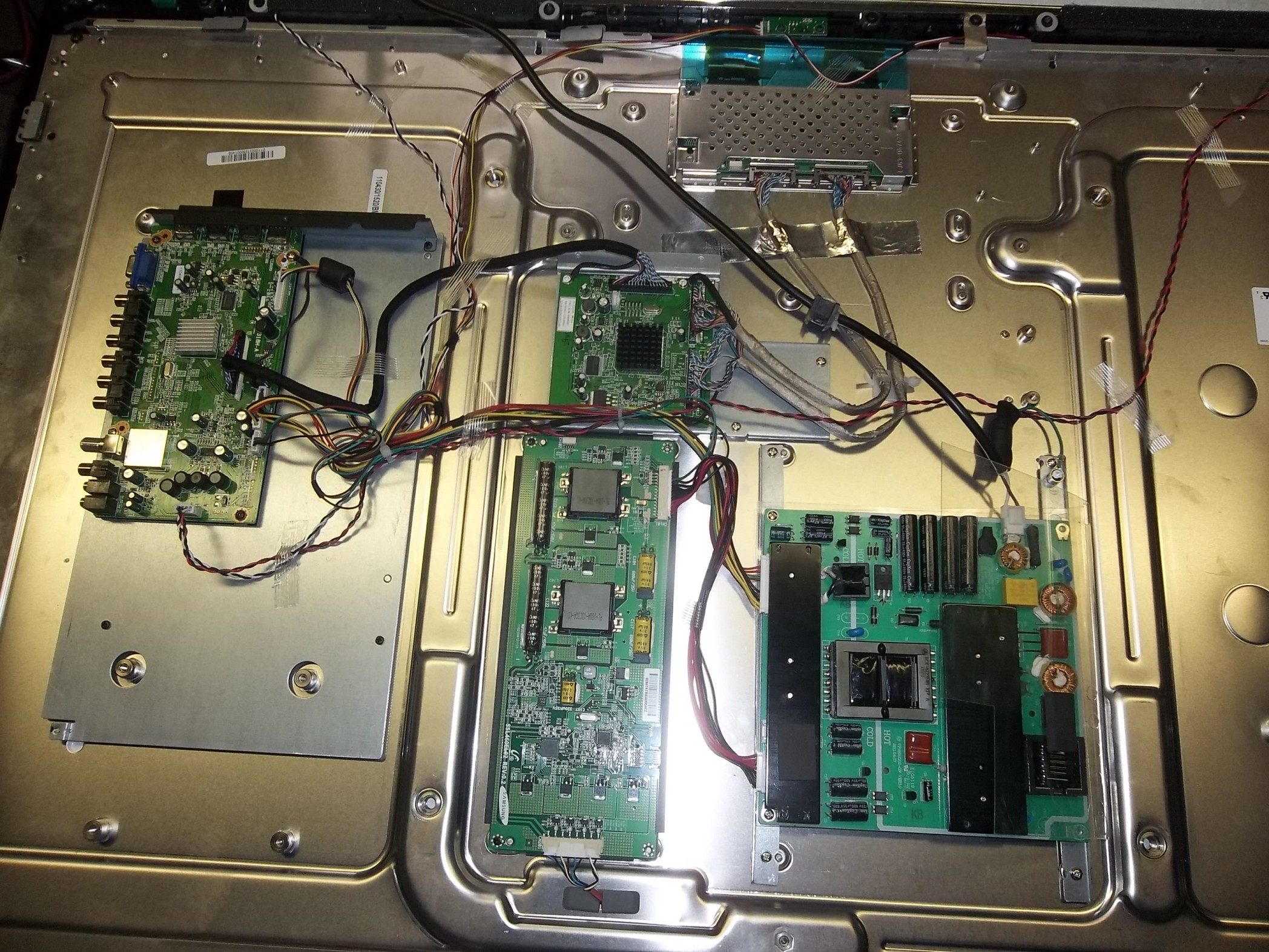

        Tom66,
        pics of the main board. I found a few online that are exactly the same in appearance, but the number on the white label is different from mine.
        mine is 1104H0548H, not compatible?
        frank
          #64
          If the board is the same base type (CV318H-A) plus it uses the same LCD panel e.g. Samsung it will work... good TV parts companies will note the panel the parts are pulled from.
            #65

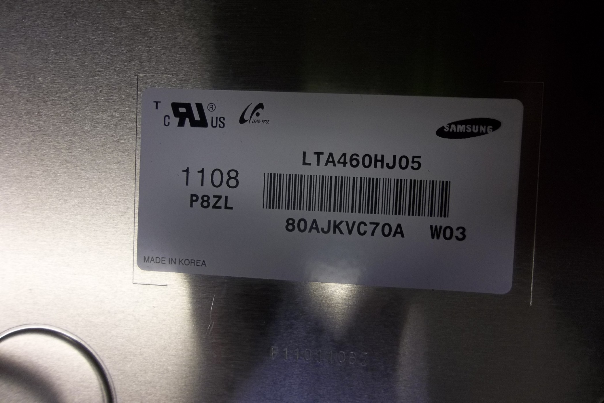

            Tom66,
            Thanks Tom that's very interesting. I did see a number of CV318H-A boards with different numeric numbers than mine. how important is that number when hunting a board? what is that number 1104H0548H labeled on then board.
            is this the panel number in the picture? I saw one board with 1107H1071 and it had all of the same connectors and appeared to be identical.
            you never answered my last question about the 3.3v stdby that seems to be connected to the tab of the smd and is shorted to gnd, as being the cause of the TV not working? does that have anything to do with bl_on?
            thanks a bunch, not giving up on this one yet!
            frank
              #66
              Yeah, that's the panel number.
              I don't know about the 3.3V, I'm not sure..
              I also don't know what each number means, every manufacturer is different.

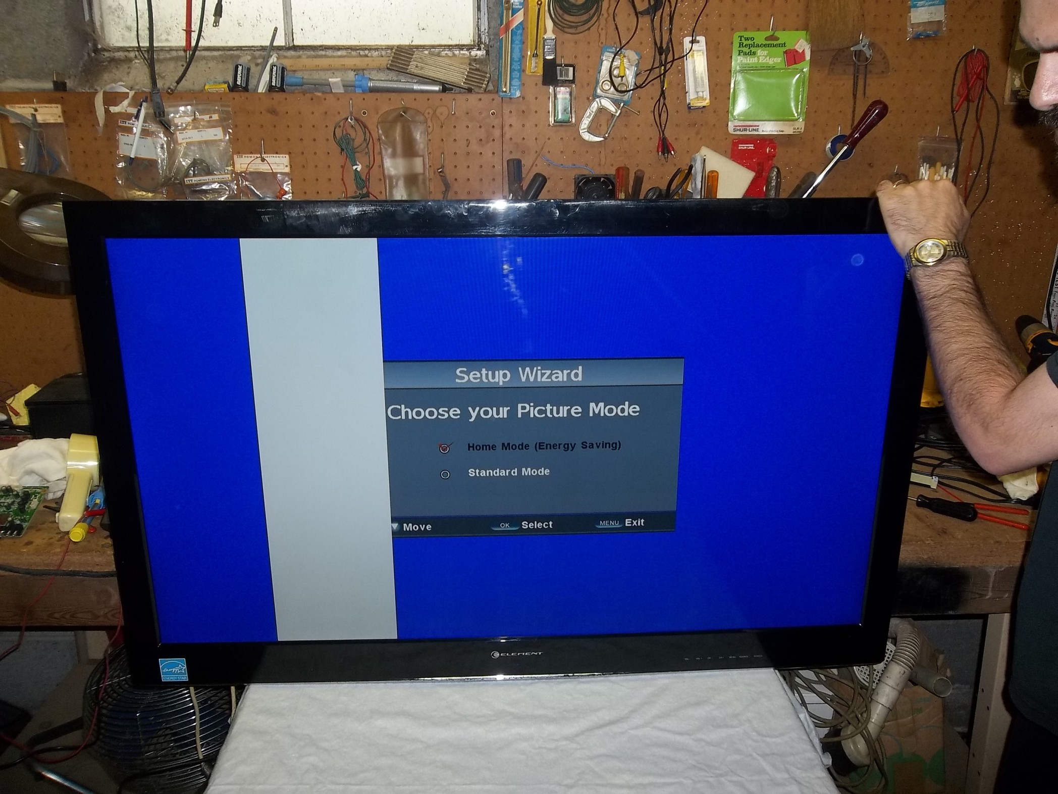

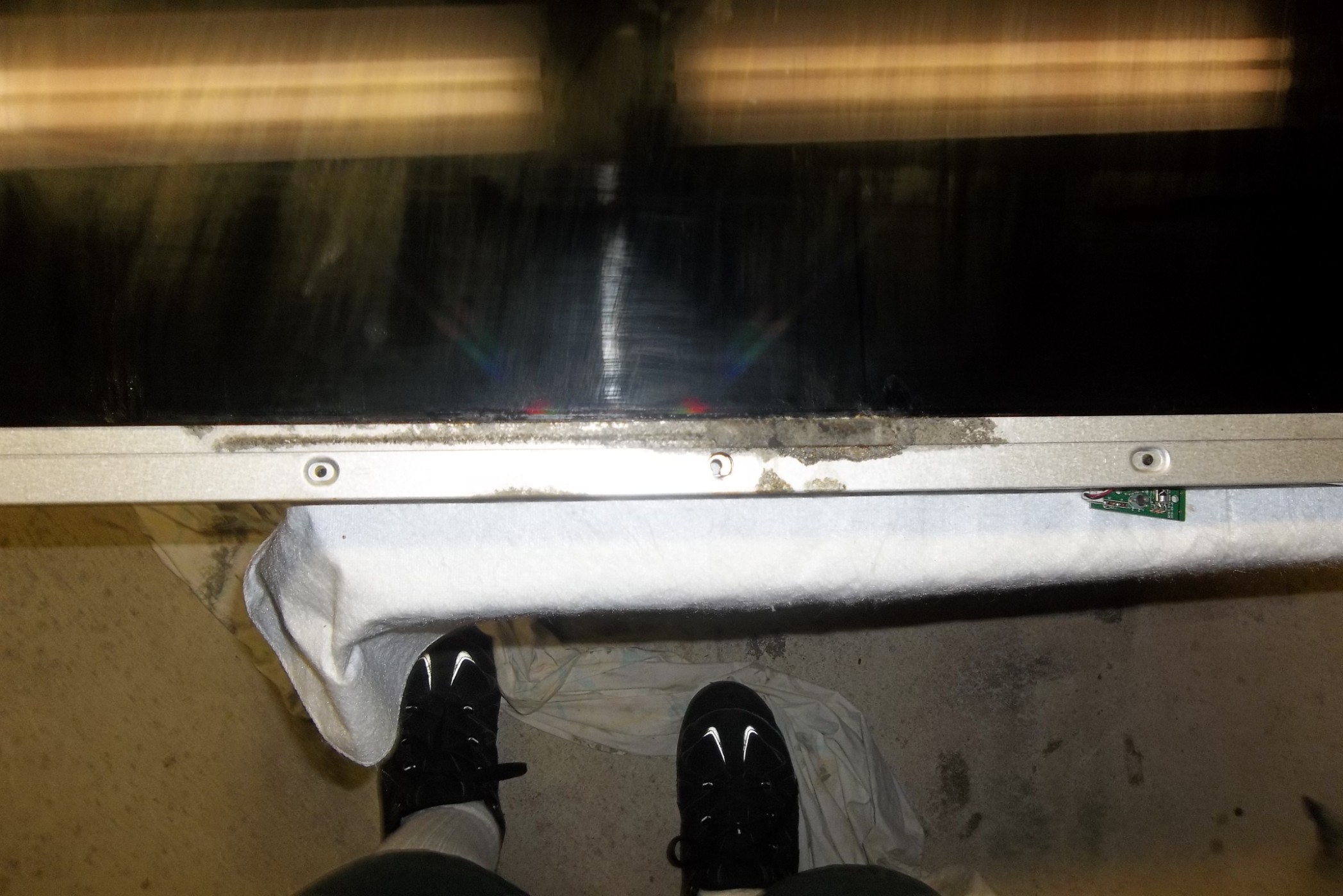

                  Tom66-Budm and company,
                  I ordered a main board from shopjimmy, slapped it in and it worked (I think). I have a blue screen and a menu displayed on the screen. however, as you can see from the picture, I now have about a 6 inch vertical stripe of just white.
                  what's next? I tried to flex a connector on that side of the screen, but no change. help!
                  thanks very much
                  frank
                    #69
                    Sadly, I think the panel is bad -- possibly water damaged. If you're careful, you may be able to clean off the water damage around that flex, by taking off the frame around the LCD.

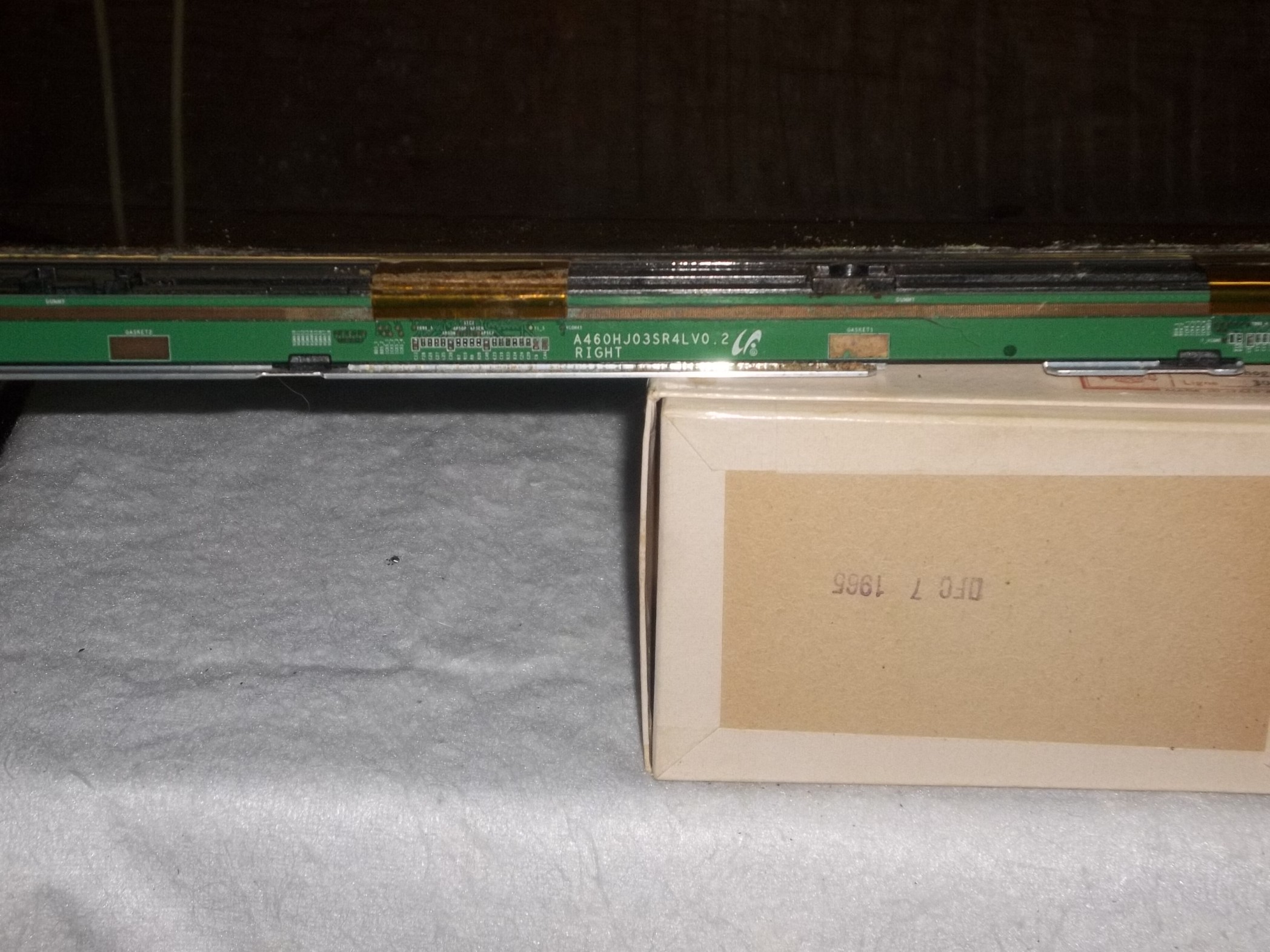

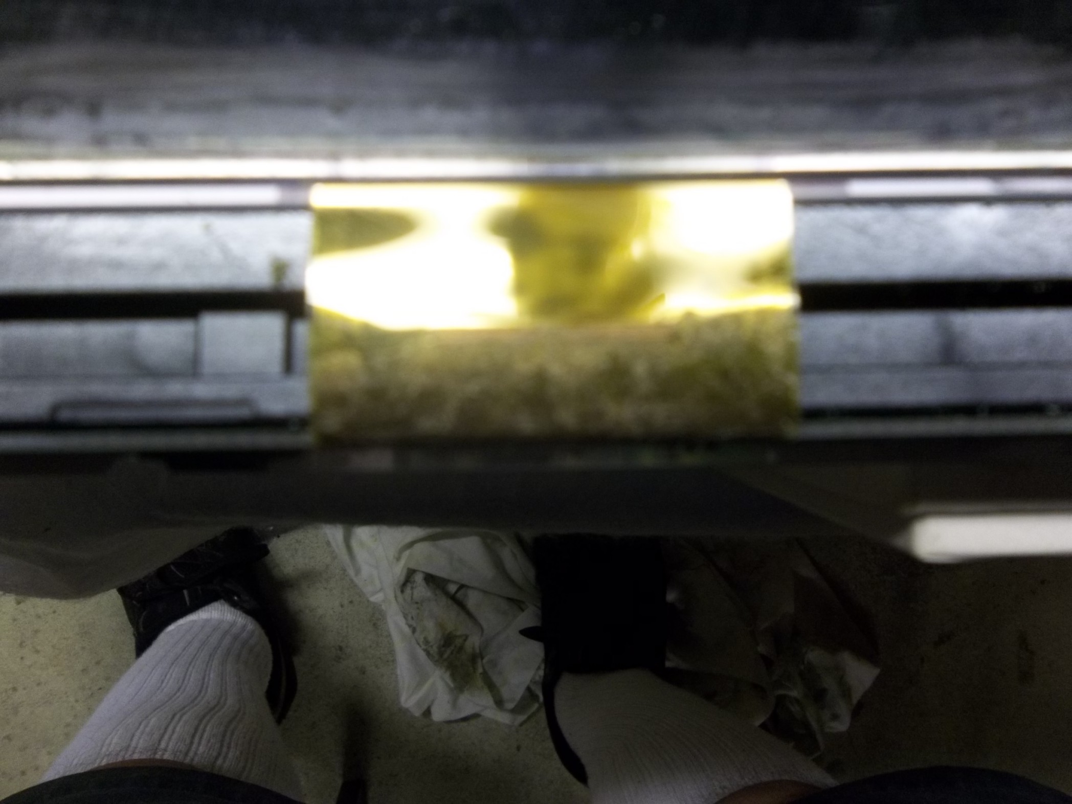

                          Tom66,
                          I guess you live and learn from mistakes. I'll try and remove the frame. do I keep the tv face down (screen down) like I have right now. from my last picture of the complete set, the bottom of the screen is at the top of the picture (closest to the work bench). are the connectors I need to access at the bottom of the picture, or where the T-conn board is? sorry for the dumb questions.
                          thank you,
                          frank
                            #73
                            The panel is upside-down on these models (t-con and tabs at bottom); this makes it a lot more vulnerable to water damage. It's designed to stop early tab bond failures but increases water damage problems, converting a problem which is generally fixable into one which is much harder to fix.

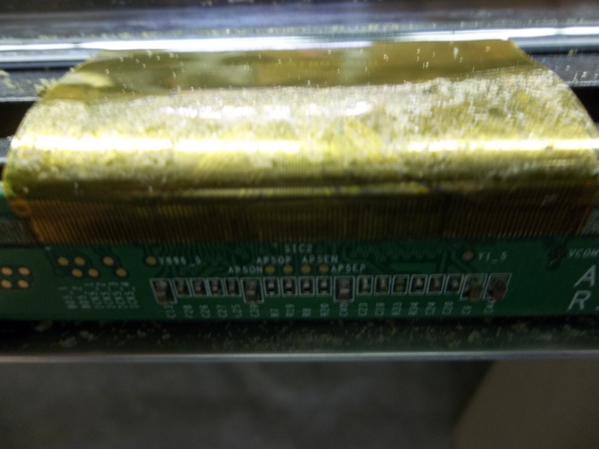

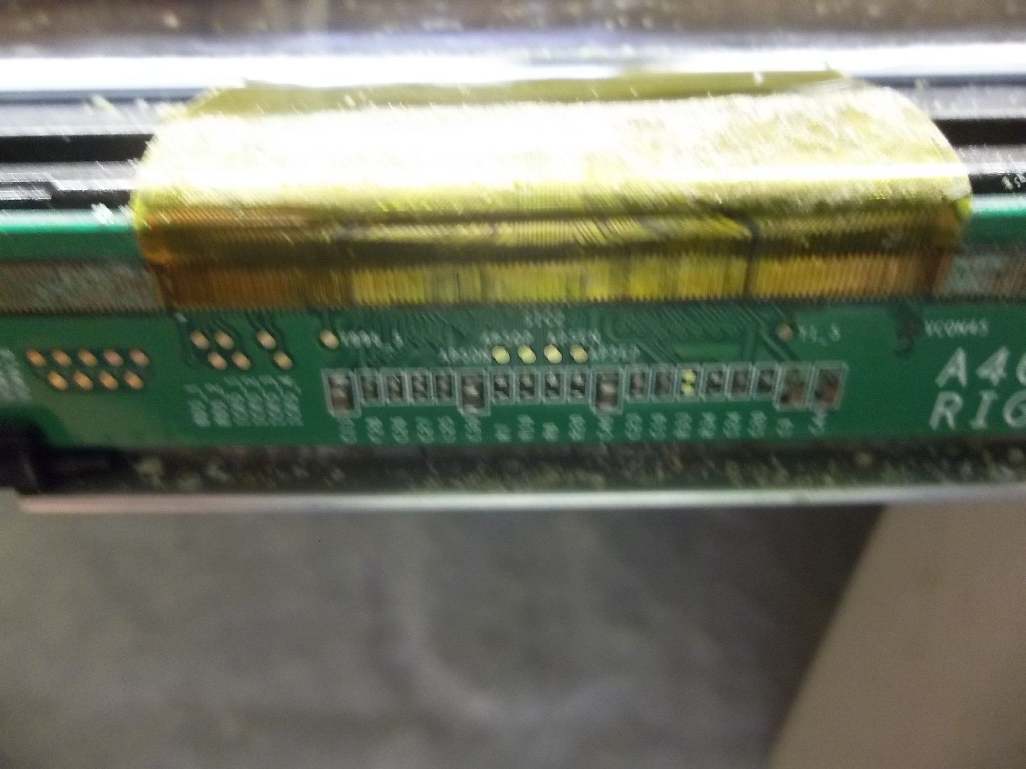

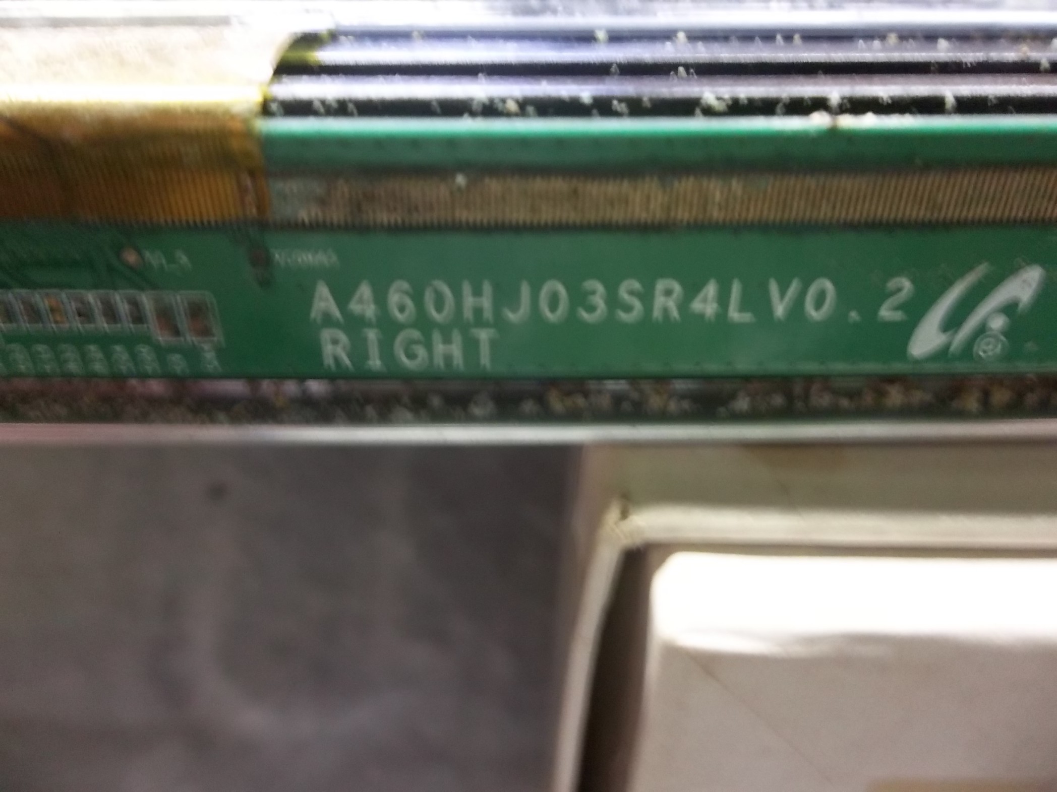

                                Tom66 & company,

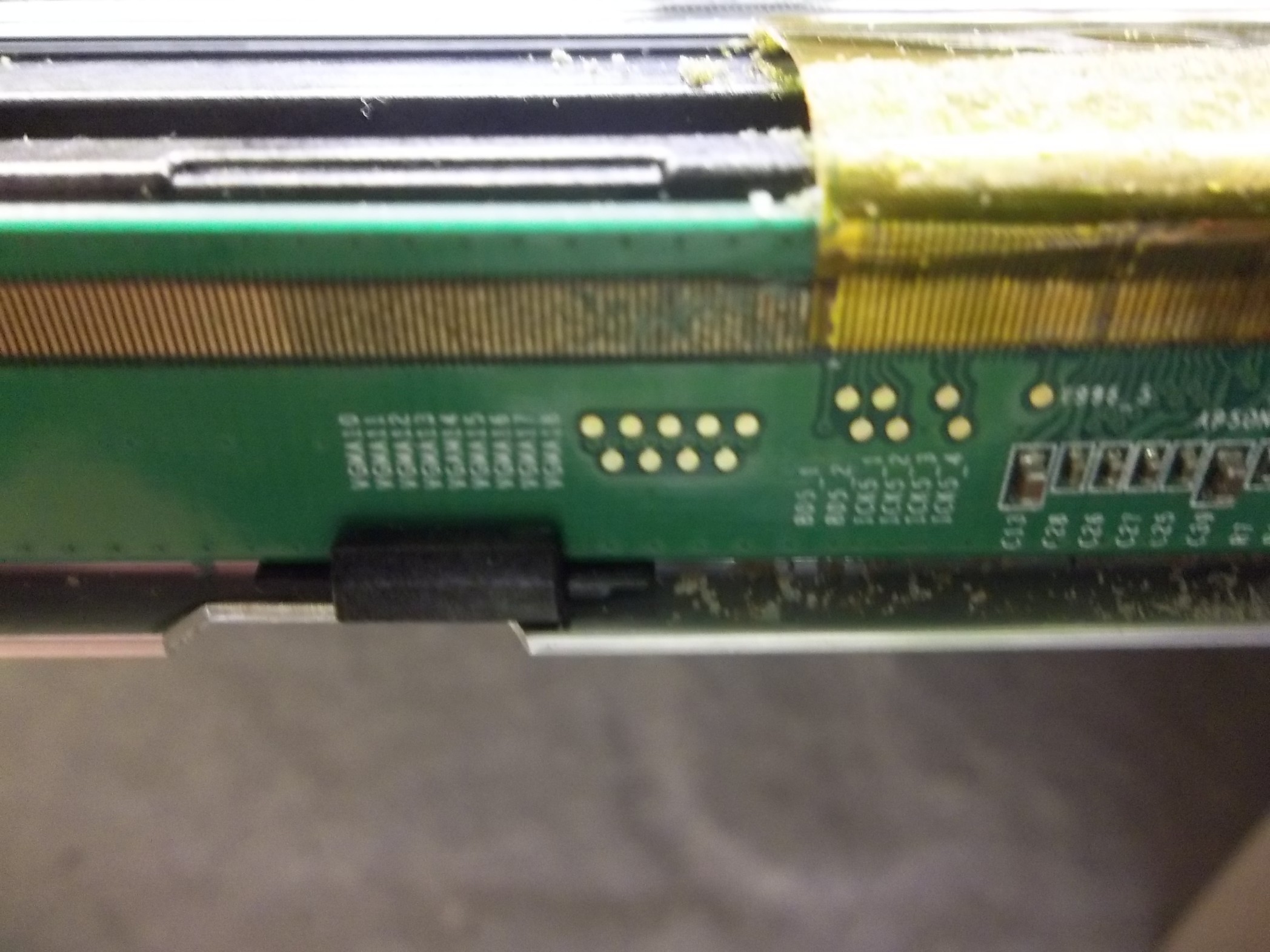

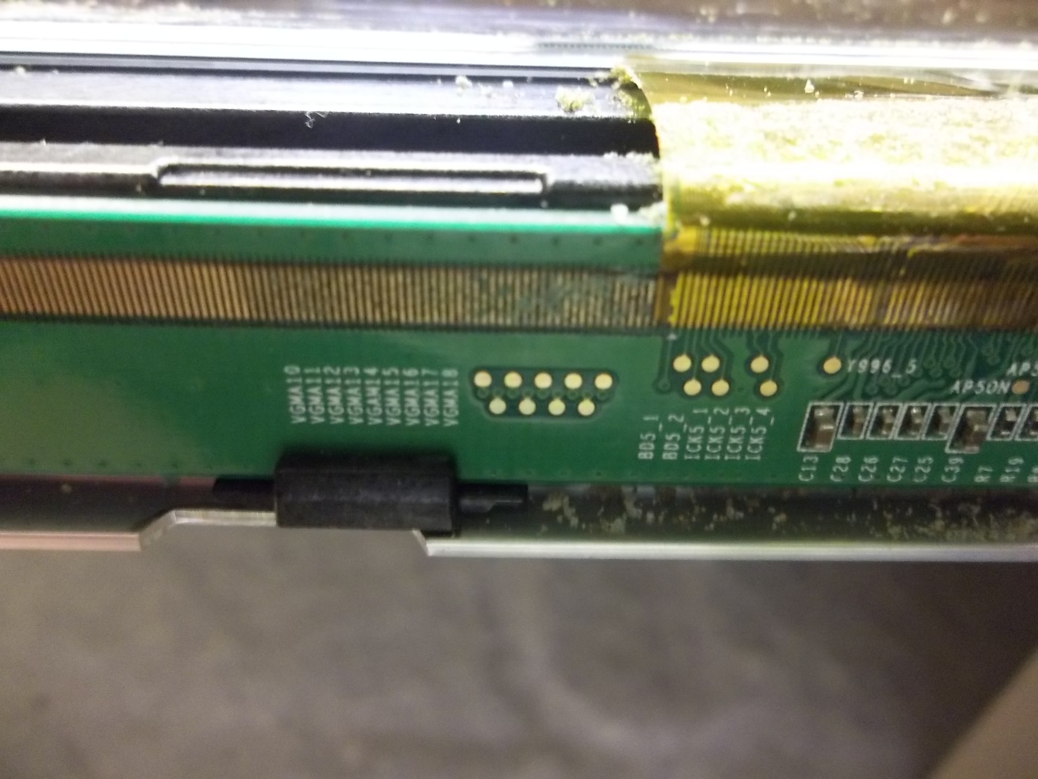

                                Tom, you were right on the money, corrosion and more corrosion! what can be done about it? a few pics. some of the lands that are not within the connector have corrosion between them, is it worth a shot to try and clean any of it if possible? am I doomed?
                                thanks for your patience and understanding,
                                frank
                                  #76
                                  You can try using isopropyl alcohol to clean that, but I fear it is not repairable. One user did have luck before, though.

                                    Tom66,
                                    can I remove the one cable from the t-conn board to allow a little more swing out room on the narrow board that has the 3 the tab bonds for the left side of the screen? is it the in between corrosion of the tab bond connection on the narrow board causing the problem? what about using a small eraser???
                                    thanks very much Tom.
                                    frank
                                      #78
                                      You can remove the t-con connector, careful not to break the latch. The panel connectors (tab bonds) must not be disconnected.

                                          Tom66 & company,
                                          NO good Tom, the corrosion etched away a bunch of the thin connections from the board to the cable that was attached to it. looks like the operation was a success (board swap), but the patient died from other causes!
                                          I'll try and return the main board to shopjimmy hopefully to reduce the loss!
                                          I guess I could try and sell the remainder of the boards because I know they're good. is ebay the place to sell the boards?
                                          Thanks for all your help, and Budm and everyone who responded to this post.
