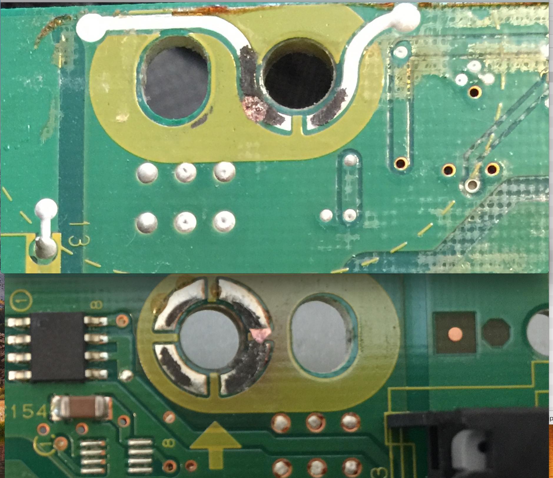

                        #131
                        Re: Panasonic TC-50PU54 8 blinks picture flashes then dead
                        Here's the D16041, R16051, and Q16051 that I've tested for continuity and it seems to have no issues.
                        And here's the mounting holes that the grounding pads are stripped. How do I replace this pads on the trace and around the mounting holes?

                          #132
                          Ok, somehow you added the number 16 in front of all the components. D16041 is d041. If you have no short at ss11, the white power connector, or at any other 3 legged transistor, it may be the ic driver. Scrape the black shit off with a razor blade and then re- tin it with new leaded solder.
                          • 2myCharlie
                            • Mar 2018
                            • 10
                            #133
                            Can I use lead-free solder? Or does it has to be leaded solder? How do I test the ss1?
                            Thanks for the help.

                              #134
                              Lead-free solder is the anti-christ of solder. You can use it if you want, but I never will.
                              That shit is the reason for me fixing 200+ plasma tvs. I make good money doing it, but as for using it myself on a repair, hell no!
