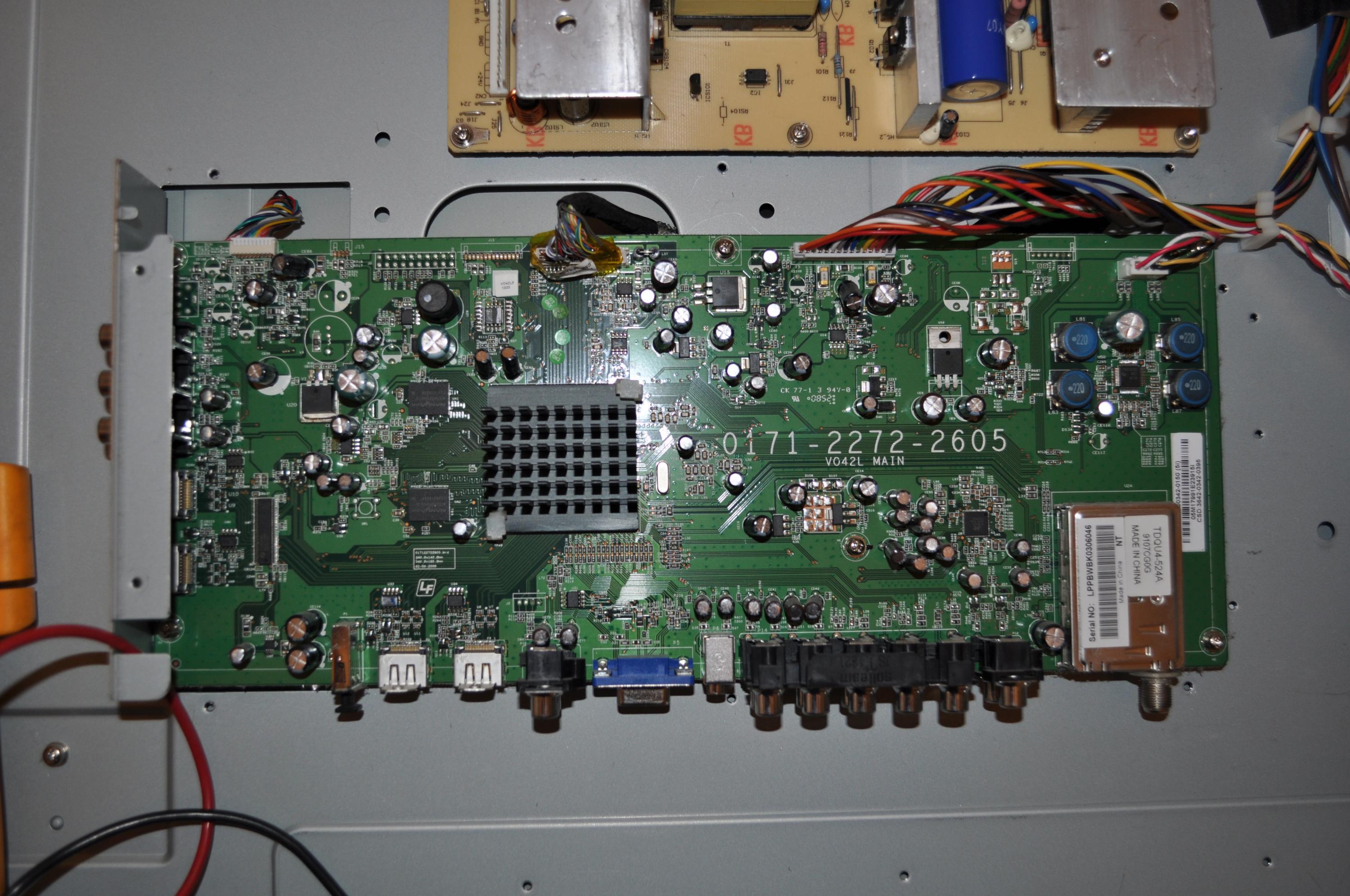

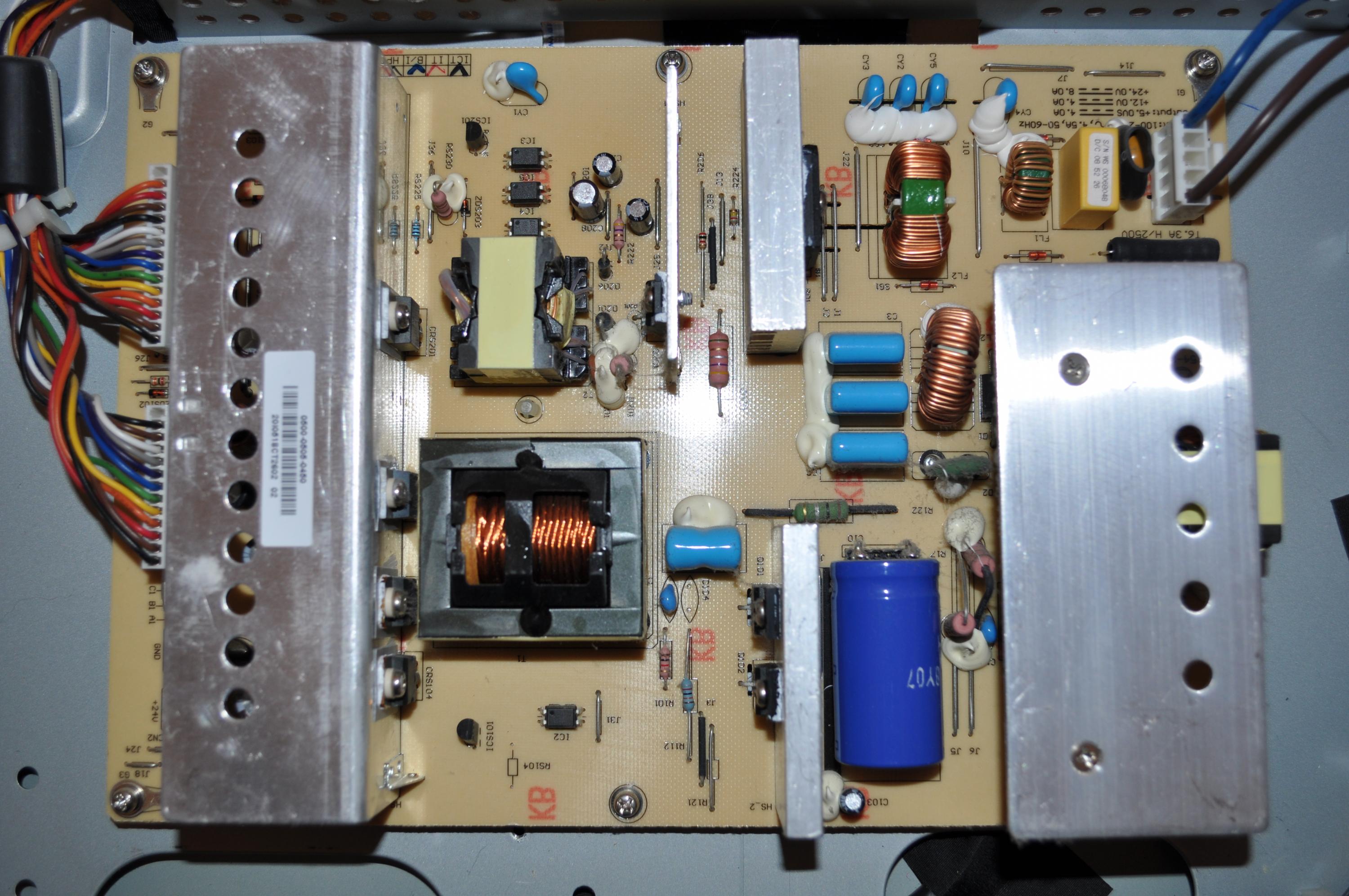

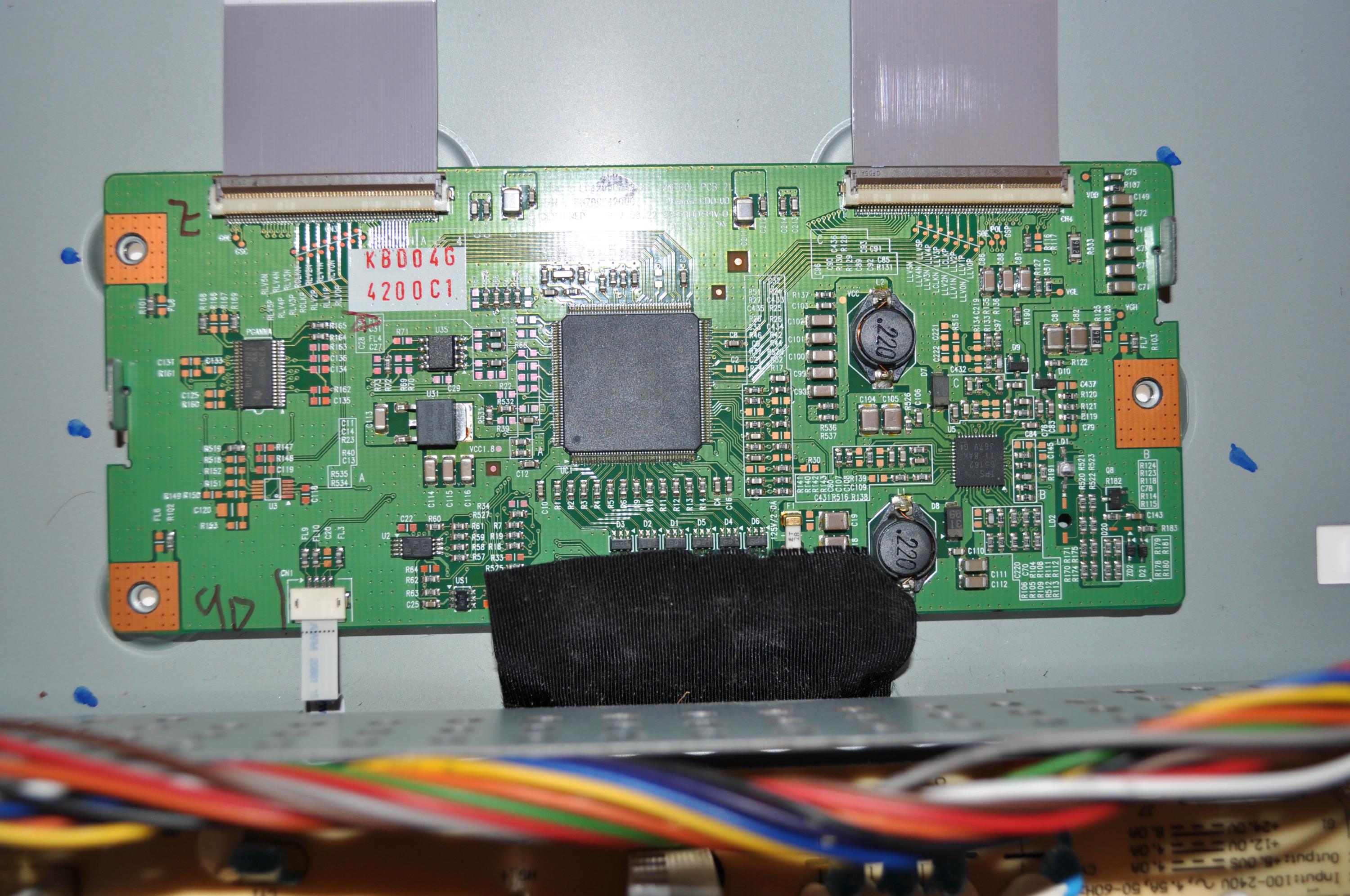

    Picked up a Vizio V042L Set powers up as normal. All PSU voltages are correct. Backlight comes on and stays on but no picture. Checked fuses on TCON all are good. No on-screen menu when menu button is pushed.
    Re: Vizio V042L No Picture has backlights.
    Voltage at each end of fuse?
    Checked voltage regulators?
    Once turned on, can you turn the set off from the remote or power button?
    • landyboy
      • Apr 2013
      • 443

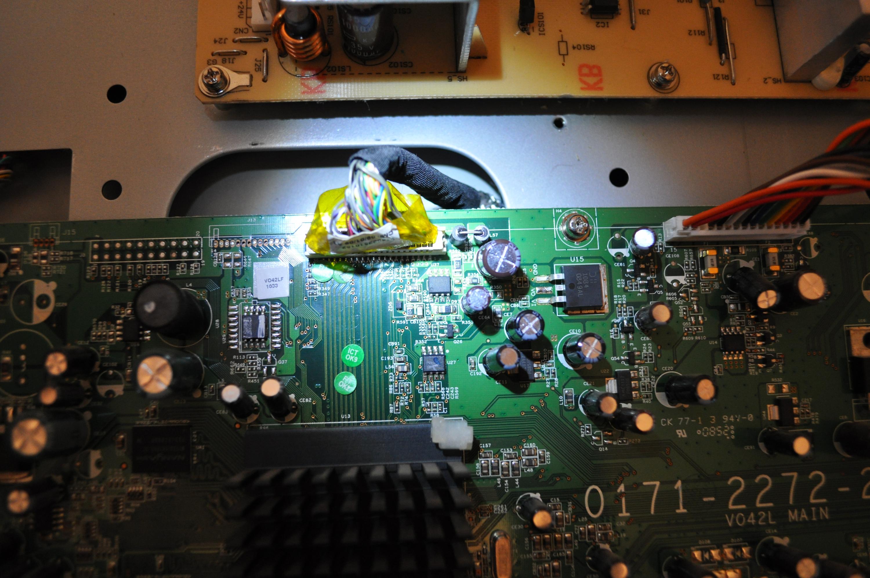

      Yes voltage at both ends of fuses. And yes you can turn the set off using the remote and keypad. Do you mean the voltage regs on the main? Here are some pics.
        Yep check the regulators on the main board.

                  I also tested F1 on TCON and only have .228 VDC is that correct?
                    The DC voltage on the T-CON fuse should be either 5v or 12v depends on the T-CON board design. So 0.228V on both ends of the fuse? If that is the case, then the MOSFET on the main board is not getting the voltage to it or it is not being told to turn on to supply the volatge to the T-CON board. You need to trace out that supply line on the main board.

                        U37 the 8 pin has 12.38 volts on 4 pins on one side and 0.228 on the other side. This is where I get lost a little. I am assuming that is where the 12v supply to the TCON goes through.
