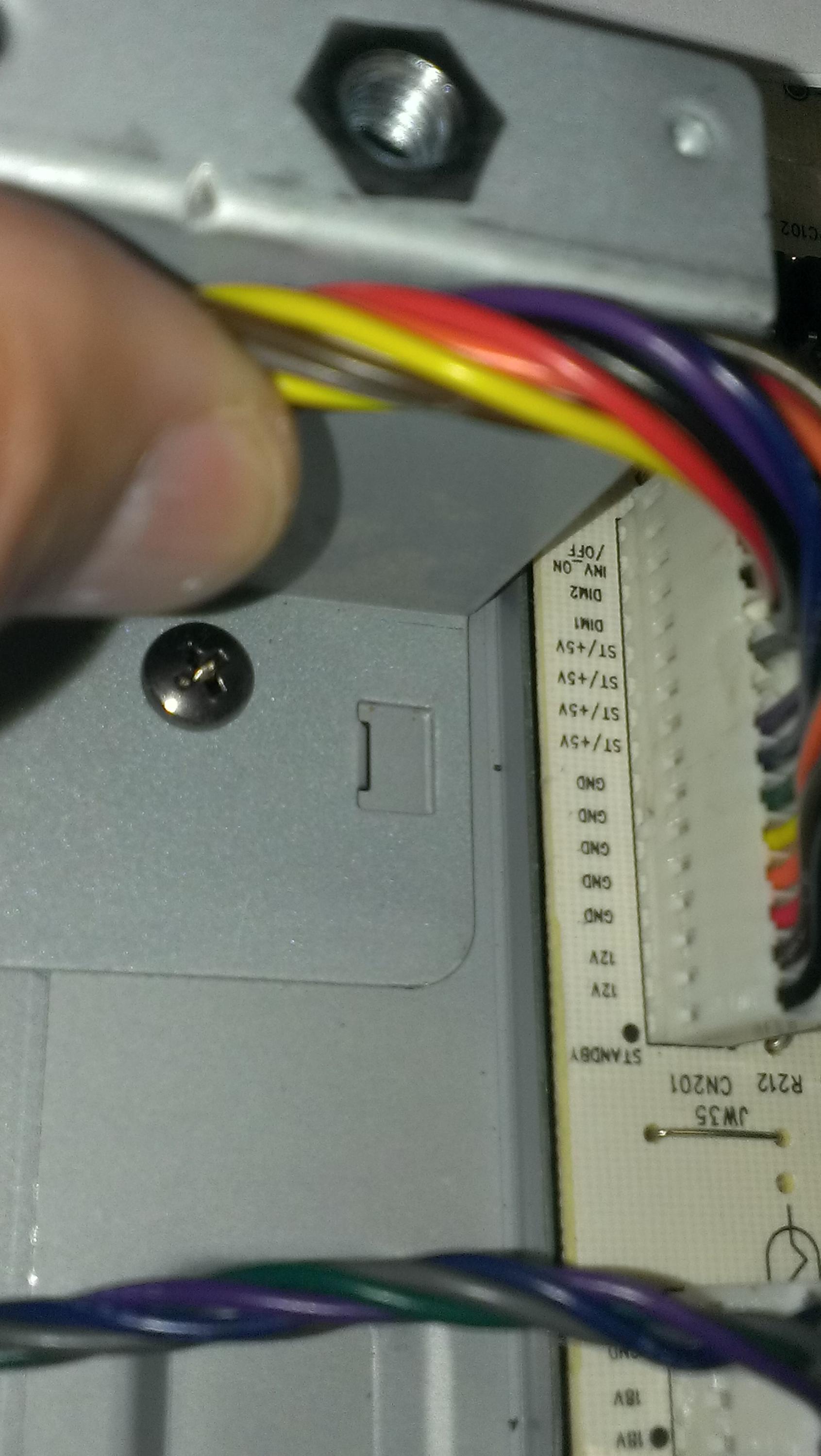

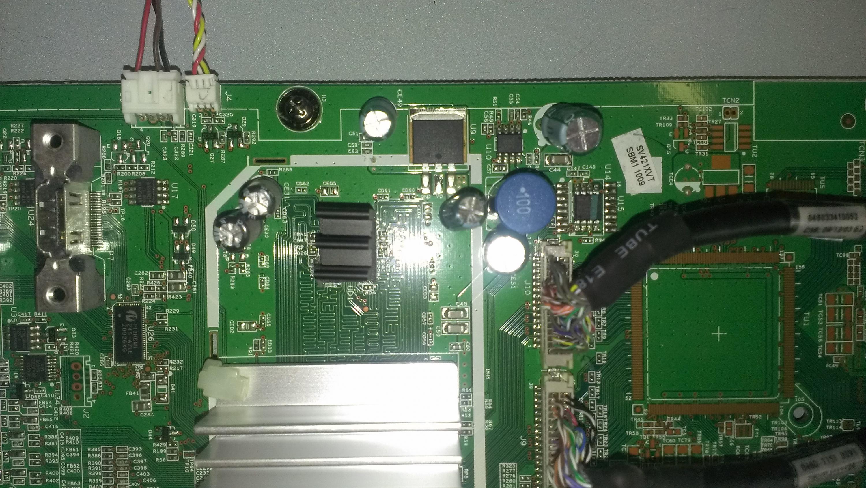

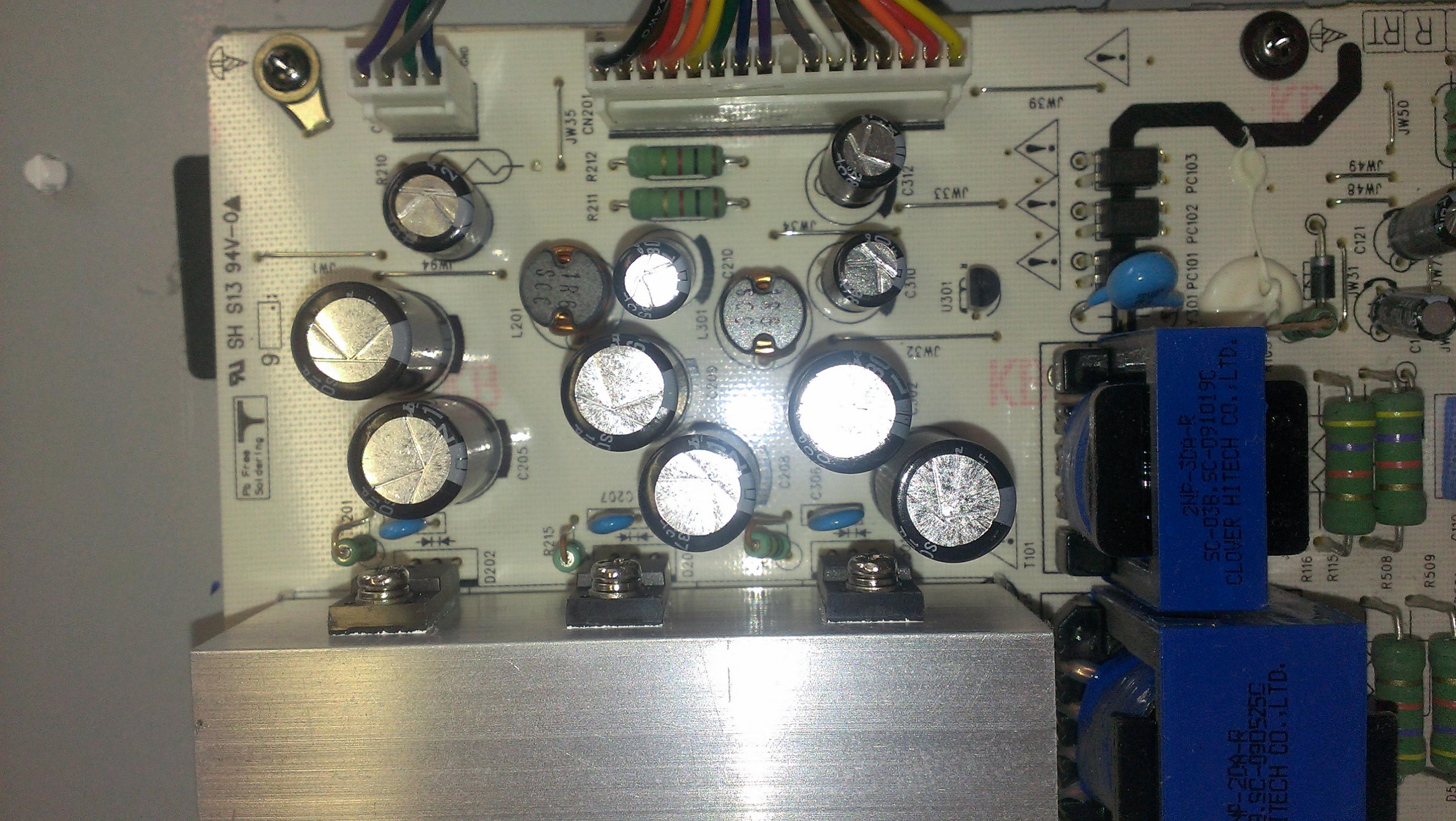

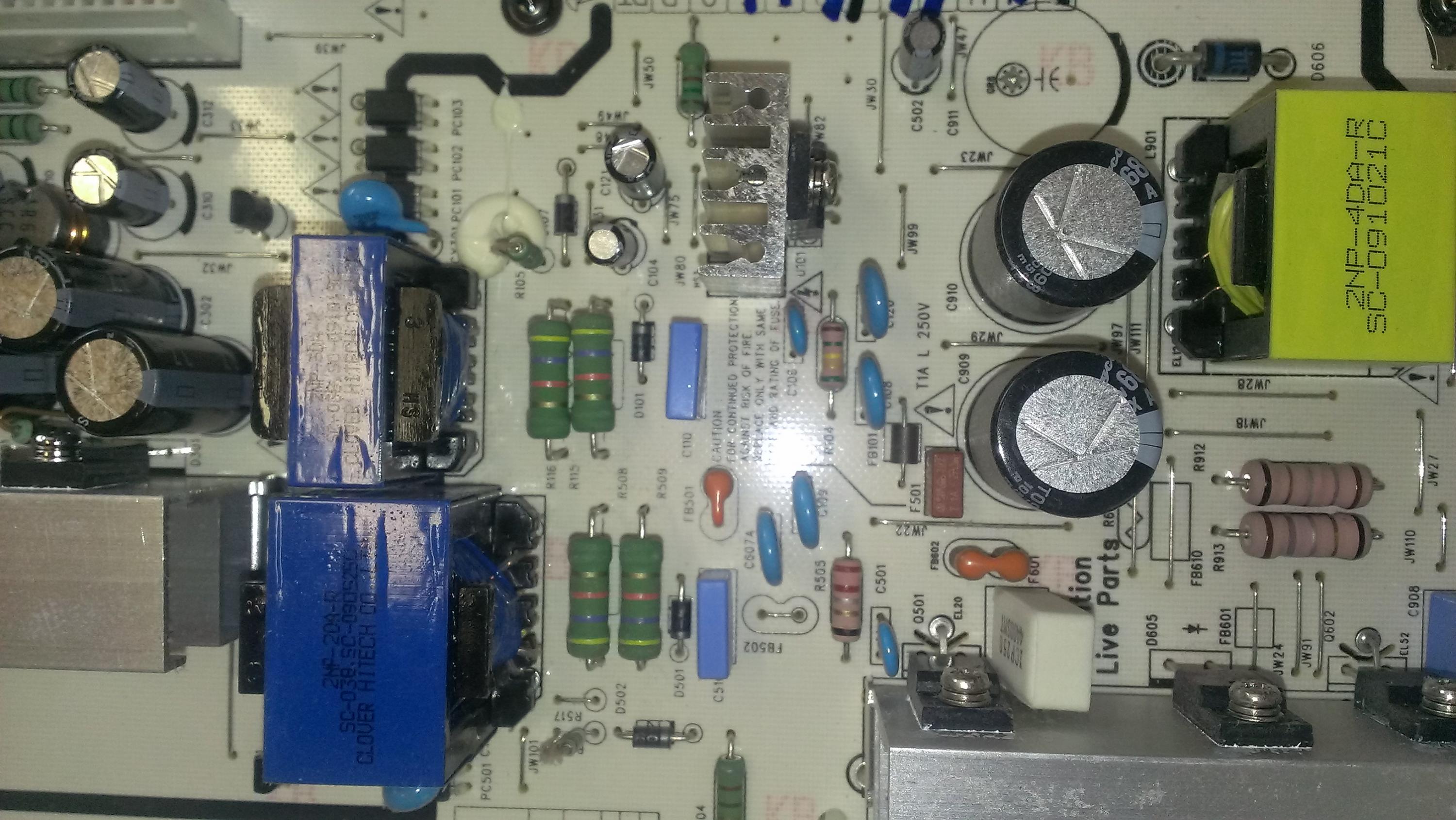

            attached is a picture of the silk screened values on the power connector (CN201)and here are my readings from it:
            (Label-reading)
            Standby-2.67v
            12v-12.08v
            12v-12.08v
            GND-0v
            GND-0v
            GND-0v
            GND-0v
            GND-0v
            ST\+5V-empty
            ST\+5V-5.15v
            ST\+5V-5.13v
            ST\+5V-5.15v
            DIM1-0v
            DIM2-0v
            INV ON\OFF- 1.75v
            I am really confused as to which board is bad. After first testing I thought that the power board was bad since Pins 3,4,12 on J1 were reading 0v. Now after retesting it I am also seeing that U3 and U4 don't look right, I am thinking main board is bad..!! or could both be bad?? I see in some threads with similar or exact tv where they tested the voltage on the PS_ON, where is this?
            sorry for all the questions but trying to fix a tv is new to me, obviously. thanks for all the feedback.

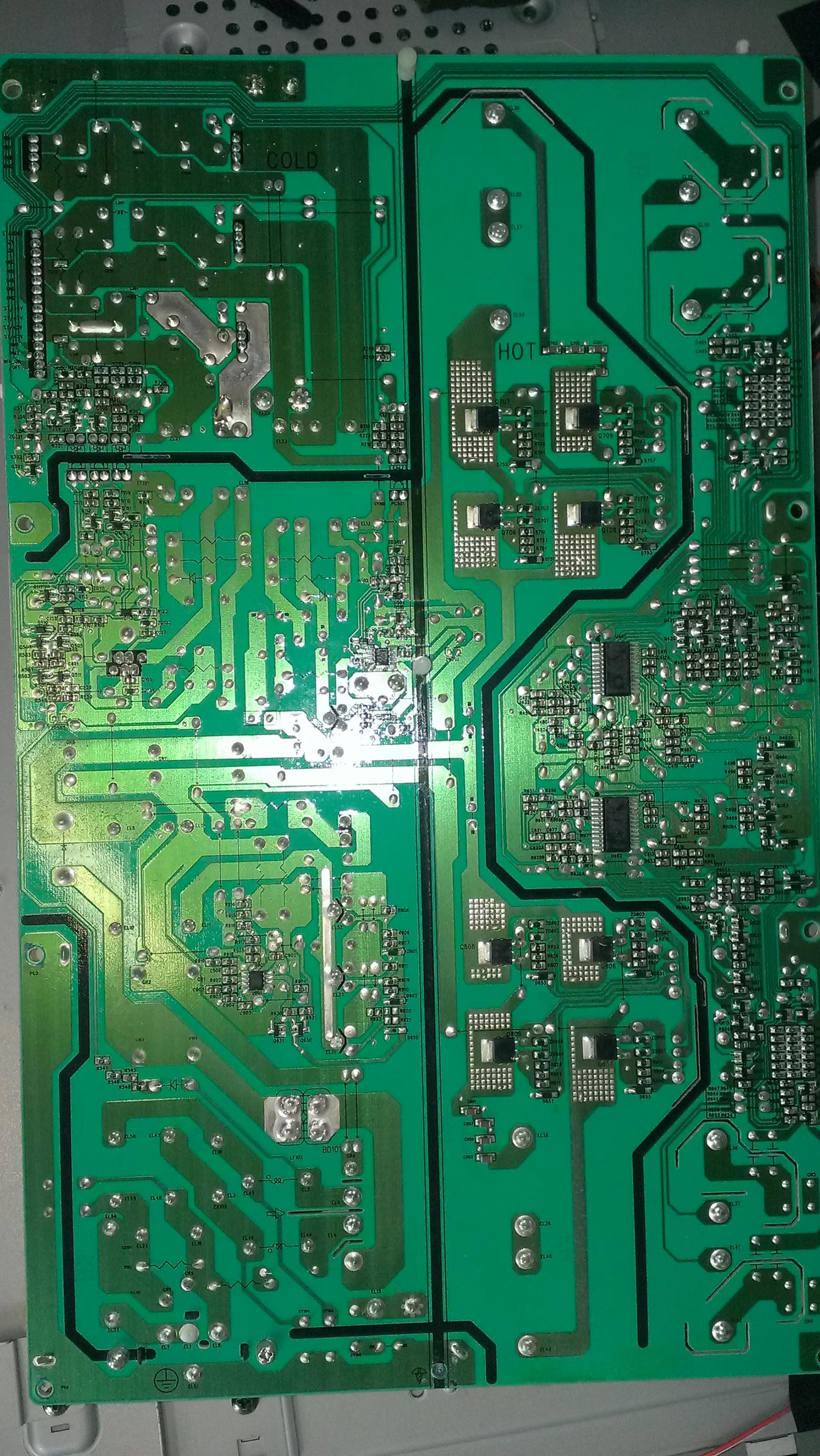

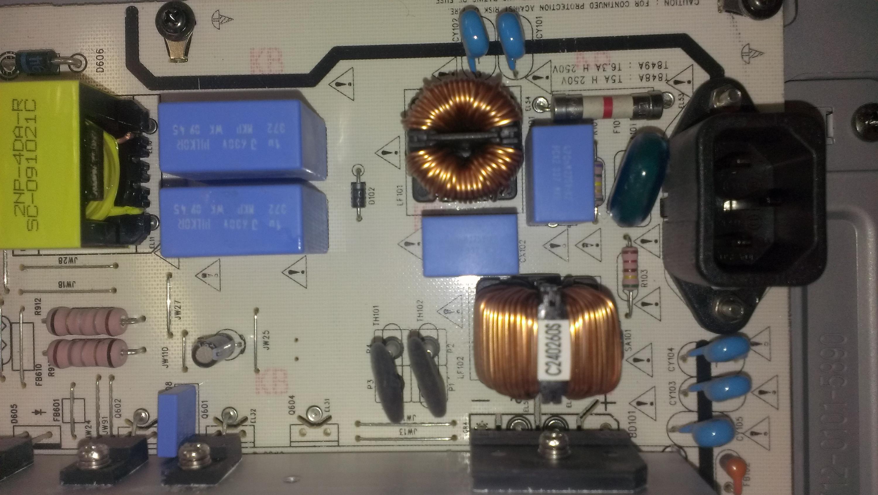

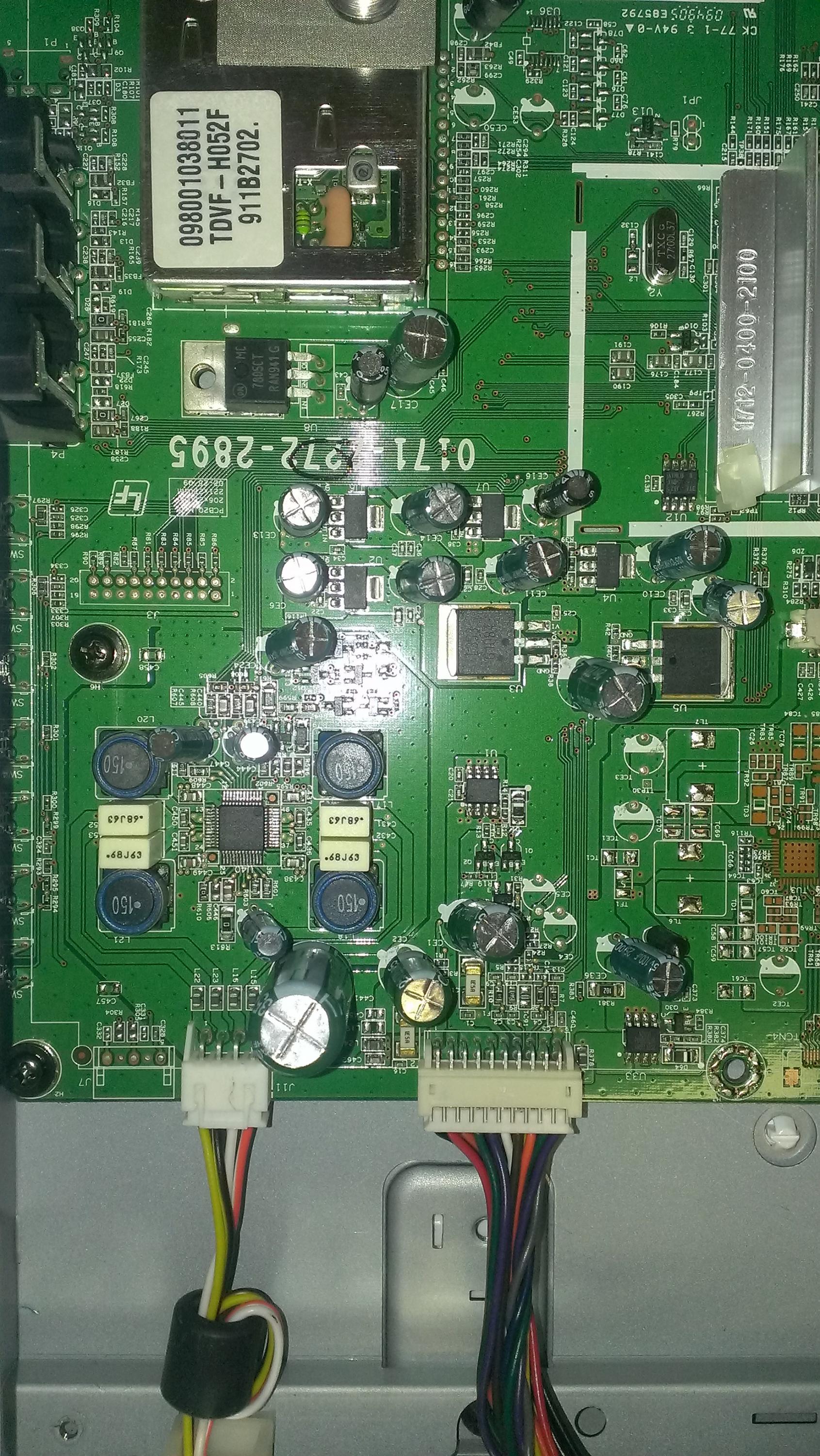

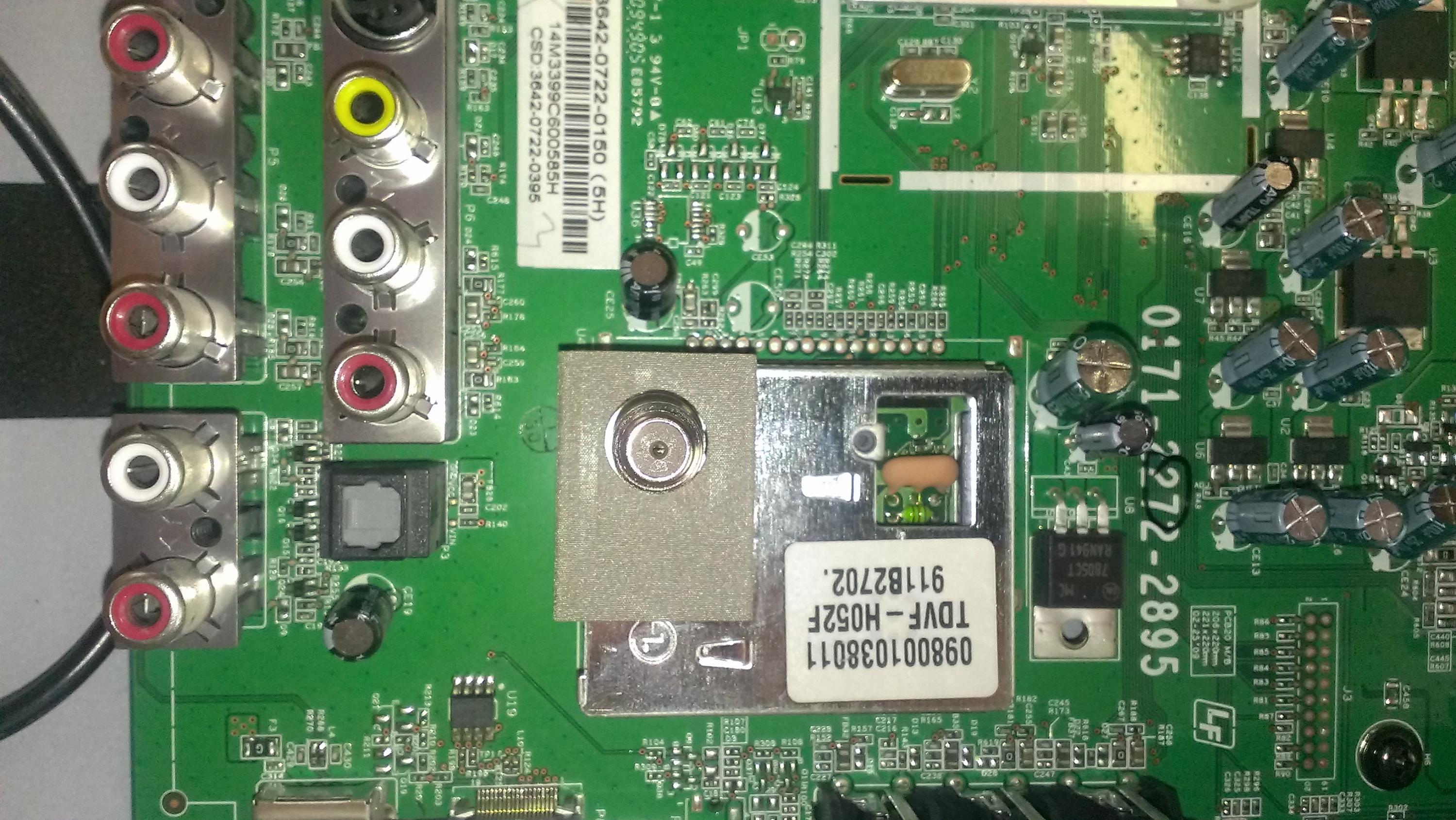

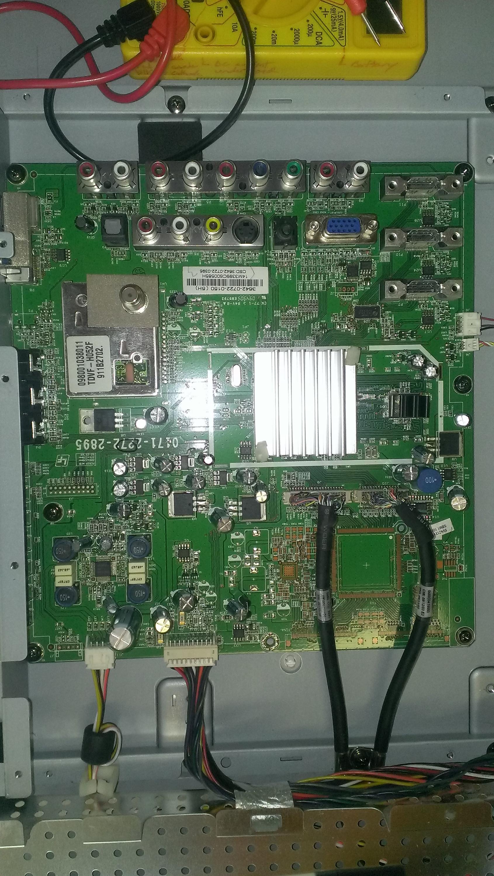

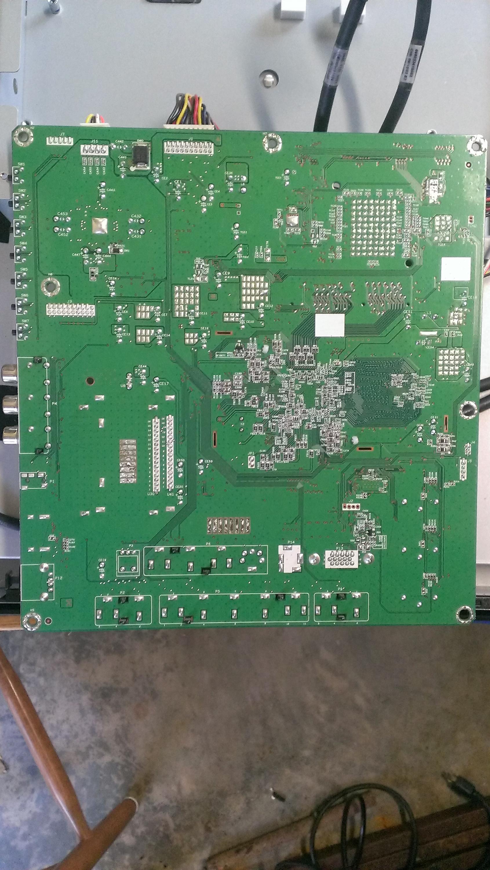

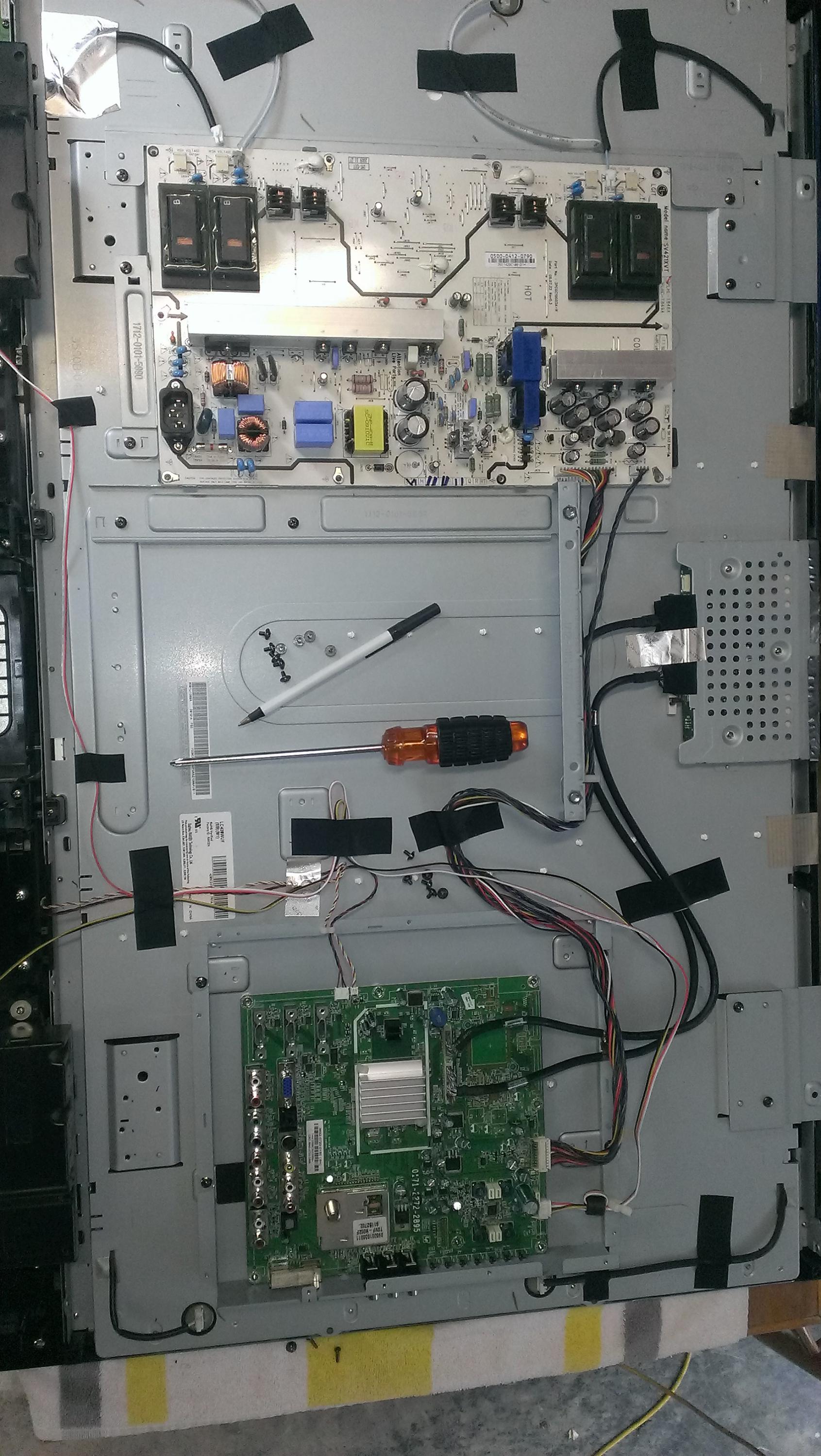

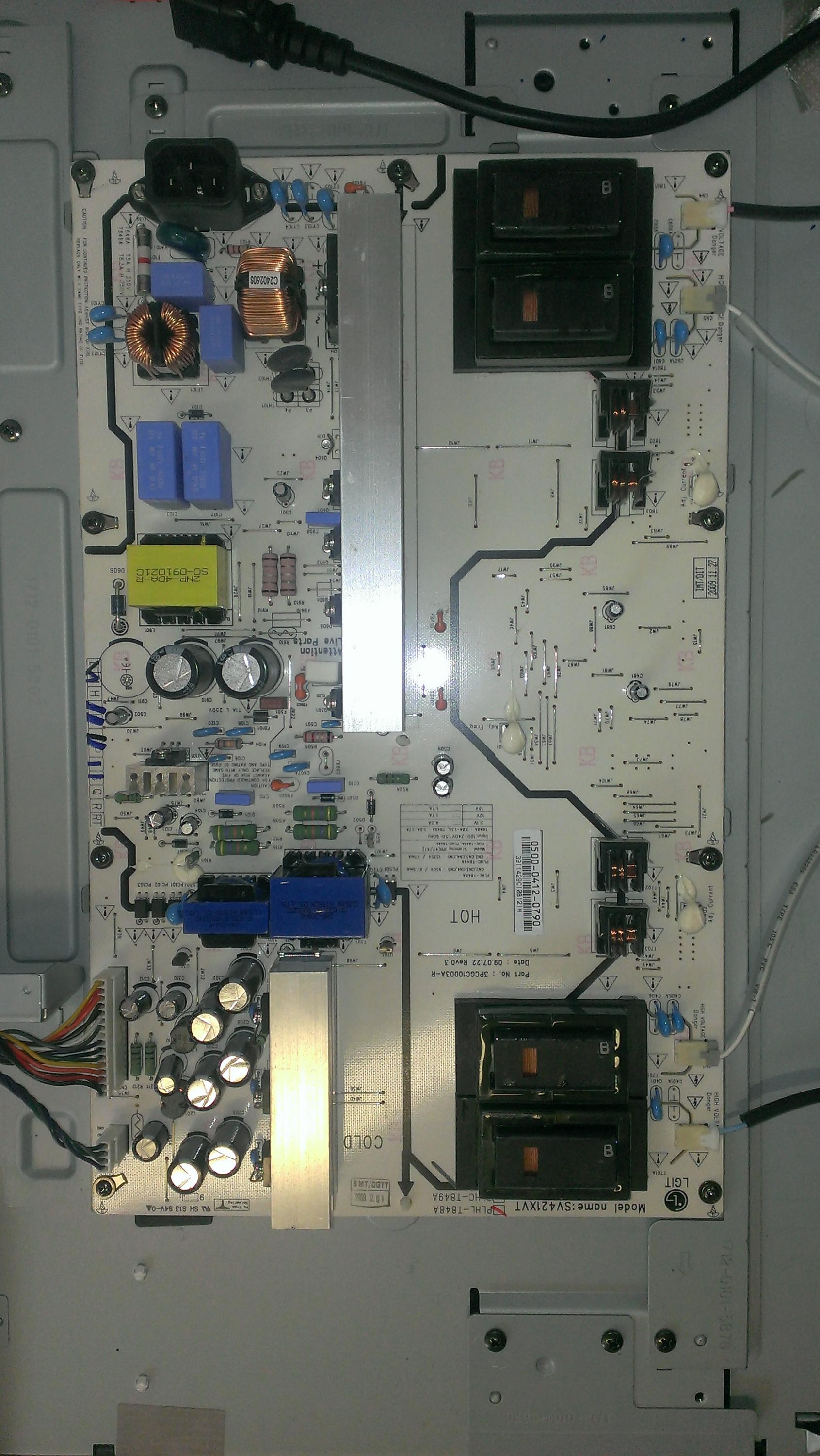

                here are 3 more pictures; overall board layout, bottom side of main board and power supply.
                anyone have any more comments on my analysis??

                  Are these reading with the main board connected or disconnected? I would expect the standby pin to be closer to 5V and the INV ON to be closer to 3V. Unplug the main board completely from the power supply. Then, connect the power cord and take the readings again.
                  After that, we can force on the power supply to see if the backlights come on and then proceed from there.
                  Based on my experience with Vizio TVs, I'm guessing its the main board but lets make sure.

                    Could you also post a picture of both connectors going from the PS to the main with the cables unplugged? I'm counting 15 labels but 16 pins. One of those has got to be the PS-ON pin but I don't see it. It's seems obvious that the PS is getting turned on though because you are getting 12V and 18V outputs on the connectors.
                    Is there indeed 16 wires coming out of that connector or only 15?

                      "Standby-2.67v" That is the PS_ON signal. You should see this voltage changes state when you turn the TV on and off, same for the inv_on/off.
                      See if they change state or not first, if not, then the problem is on the main board.
                        Re: Vizio SV421XVT will not power on, no backlight, no click when powered on
                        Upon further inspection I believe the PS ON is below that INV ON pin. Seems you have a wire there that isn't labled. Again, please check all 16 pins with the cable unhooked and post results.
                        Edit: Budm is probably right. However that inverter on/off voltage seems way to low to me. What you are going to need to do is jump from the 5V pin to both the STBY and the INV ON with the main cable unhooked. If you get backlights at that point then the main is bad. Pretty typical for Vizio.

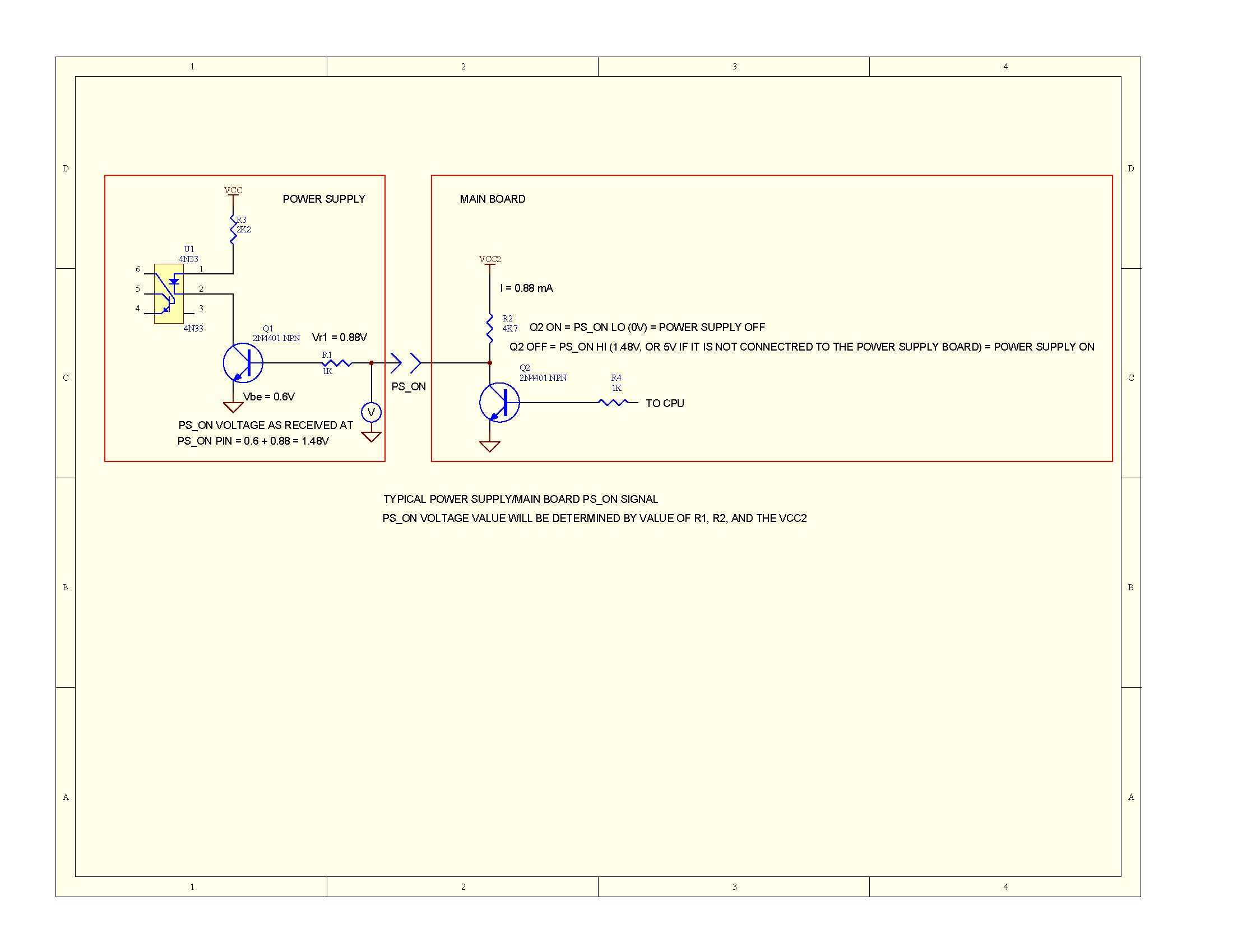

                            Here's the thing. If you force on the PS and the backlights and the screen lights up you are just about guaranteed it's the main at that point. I mean there's always a chance you have multiple issues but Vizio main boards are absolute crap.
                              The PS_ON or BL_ON can be as low as 1.5V as you can see in my diagram. So verify using force on to see if it will come on.
                                Nice. Didn't realize it could be that low and still function. I guess it could feasibly be a backlight issue. ncweasel, have you tried shining a flashlight on the screen when you power it up to see if you can make out any sort of image?

                                    Well, given your voltage readings it seems the main is telling the PS to turn on. That's why I brought up the flashlight test. Even if the backlighting doesn't work you should be able to make out the Vizio splash screen or no input message after it starts. If you can't, it points to an issue other than just the backlighting. The fact that you said the logo changes from orange to white indicates that the set is at least partially functioning.
                                    As far as unplugging the connector from the PS to the main....If you do that, verify 5V is connected to both the standby and the BL_ON, and still have no backlighting, then you are pretty much guaranteed a power supply issue.
                                    If you try that and get backlighting, then its almost certainly the main. I'm voting main on this one simply because it's a Vizio. Although I've had a couple with bad PS's too.

                                      Here are my findings on questions asked by BudM and Aaronwt6:
                                      Aaronwt6:Unplug the main board completely from the power supply. Then, connect the power cord and take the readings again.
                                      Answer: STB=0v, INV ON=0v
                                      Aaronwt6:Is there indeed 16 wires coming out of that connector or only 15?
                                      Answer: only 15 wires
                                      Budm:"Standby-2.67v" That is the PS_ON signal. You should see this voltage changes state when you turn the TV on and off, same for the inv_on/off.
                                      Answer: "Standby-2.67v" didn't change when I pressed power button on/off.
                                      Aaronwt6:What you are going to need to do is jump from the 5V pin to both the STBY and the INV ON with the main cable unhooked. If you get backlights at that point then the main is bad
                                      Answer: jumped a 5v pin to STBY and a separate 5v pin to INV ON and I didn't see any backlight. I did the flashlight test.
