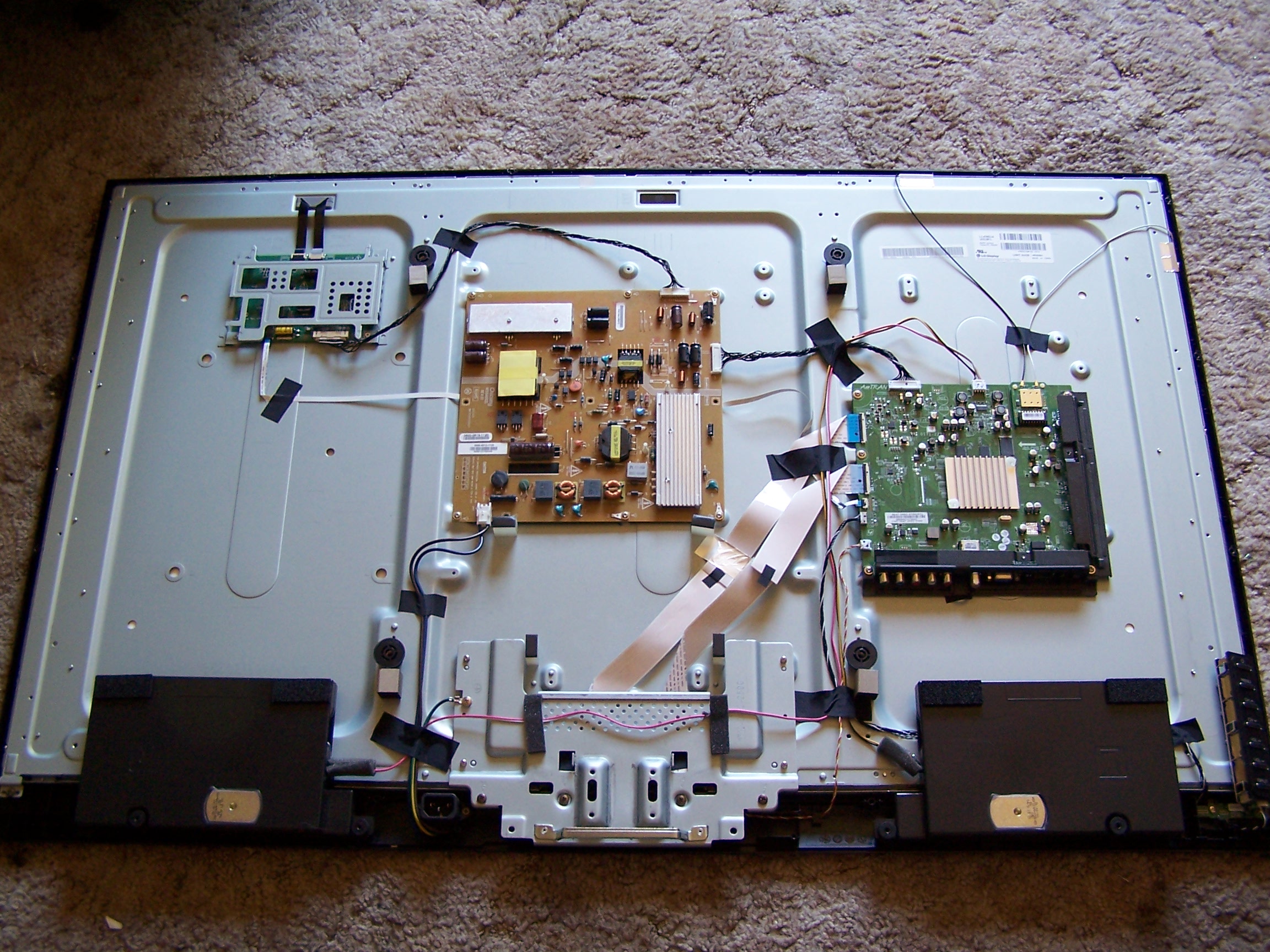

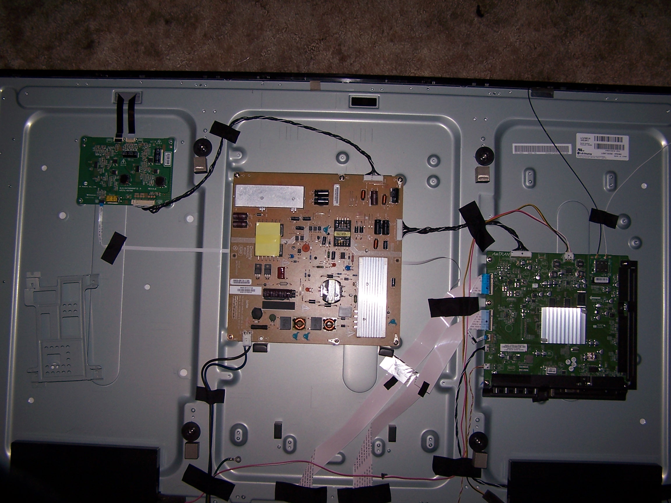

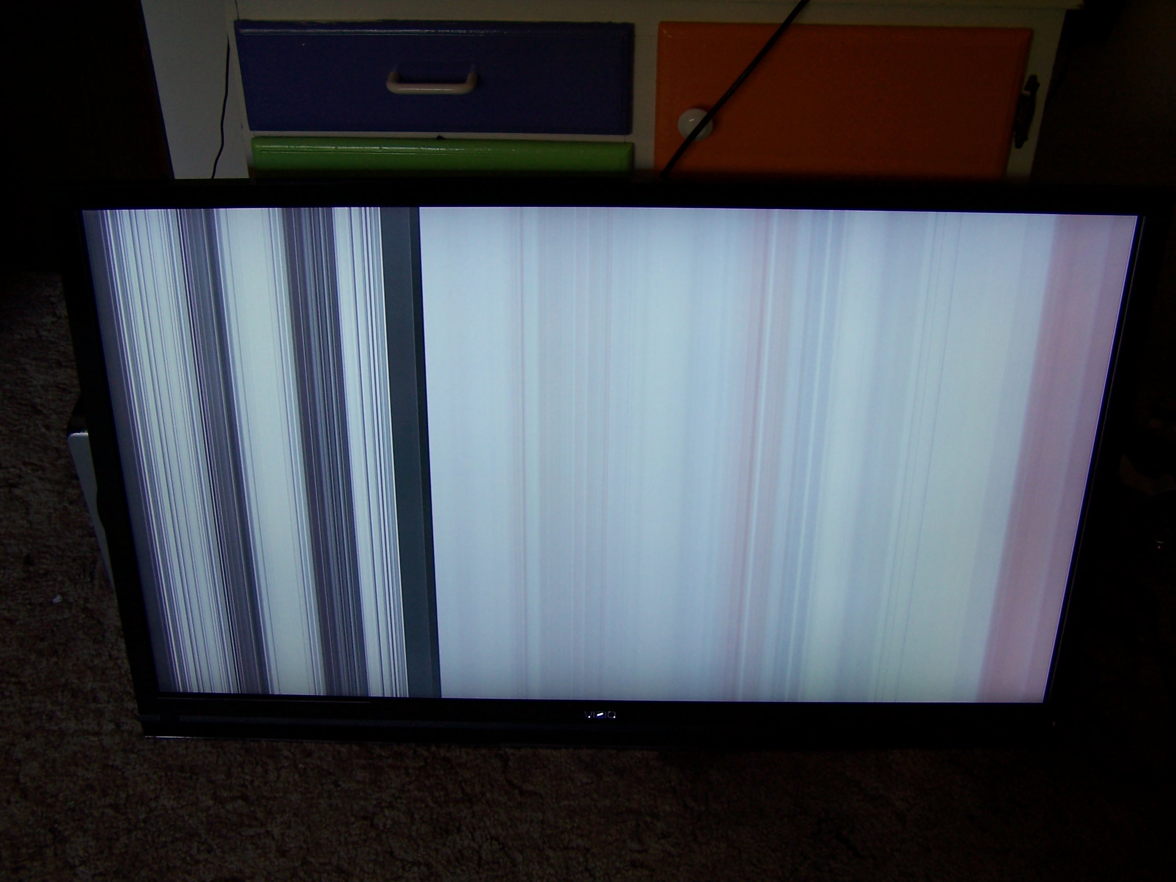

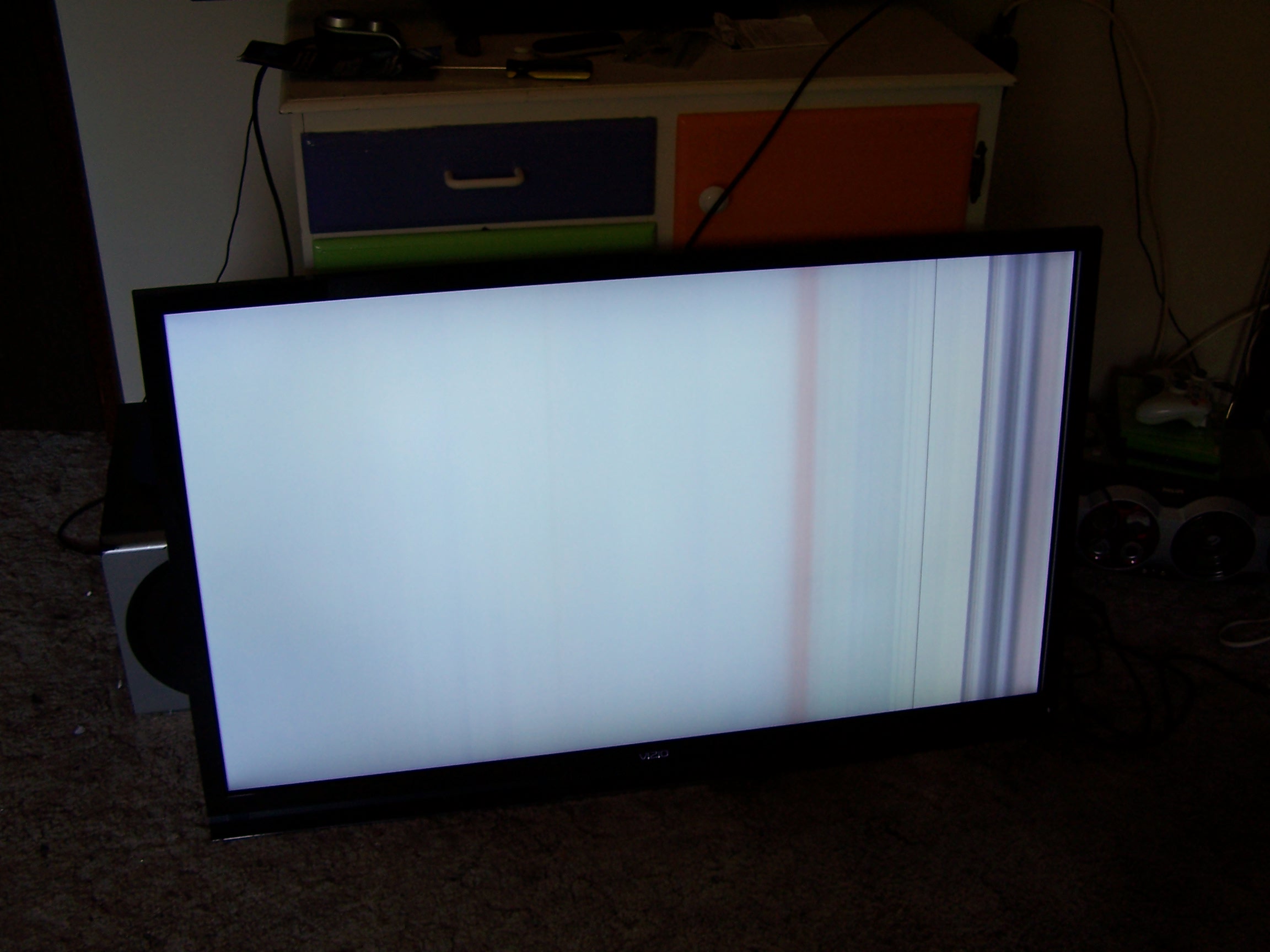

      Re: Vizio M470SL, has sound, no white moving picture.
      Here are the pictures you've asked for. This is with my DirecTV hooked up via HDMI. First picture is the TV just turned on. The second pic is with the menu popped up. The white screen moves side to side but stays white for the most part.
        Did you buy this TV used, and did you ever see it working correctly? The first two pics of the panel don't look good.

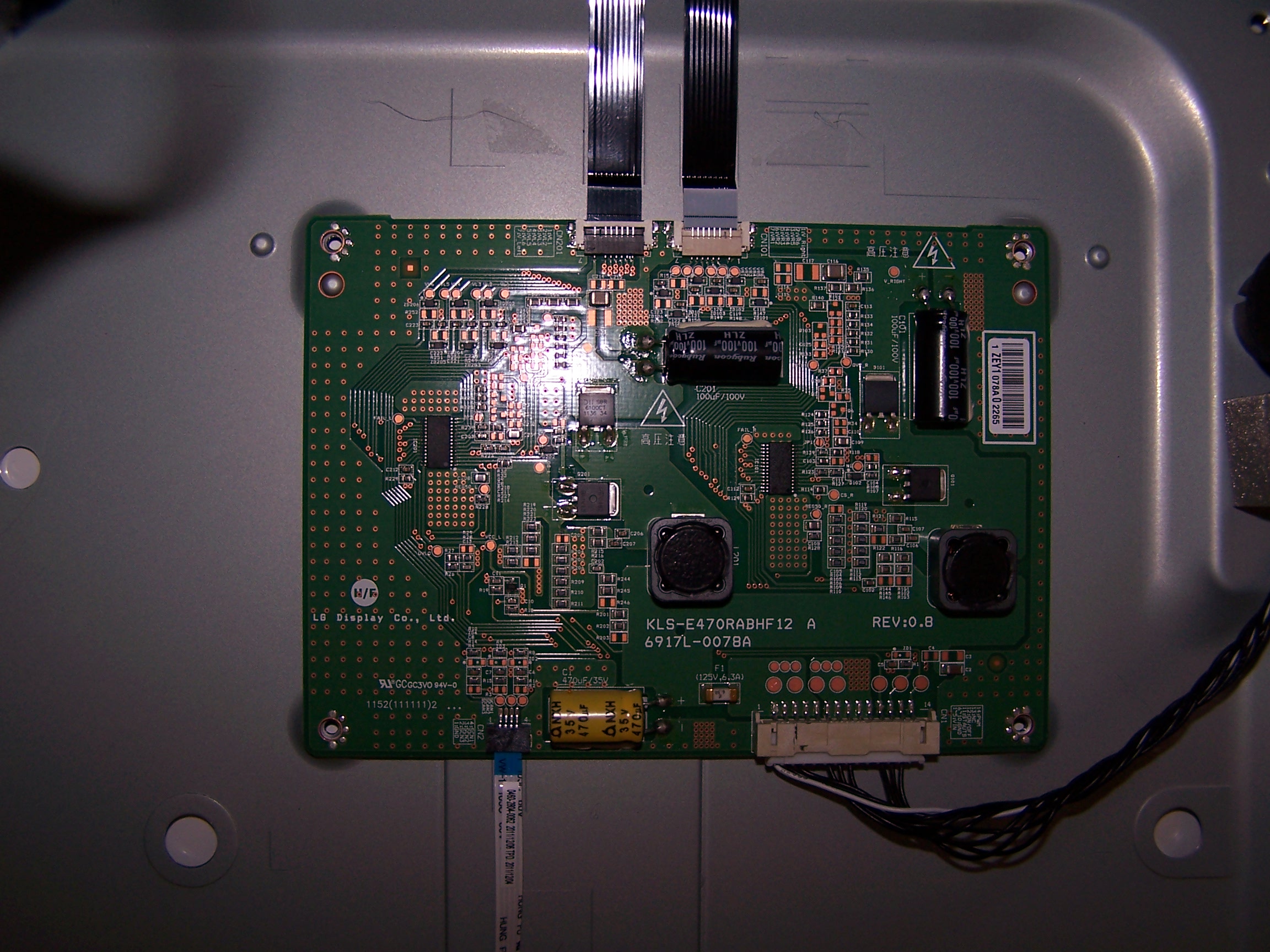

          It belonged to a friend before he gave it to me when he bought a new one. It worked a week ago, then started doing this out of the blue. Here is the other board without the shield on.
            Some of these panel issues are hard to diagnose, but I'd say you have a bad t-con (LED driver board), which is the board in the last pic you posted, or you have a bad panel. The t-con should be fairly cheap to replace.

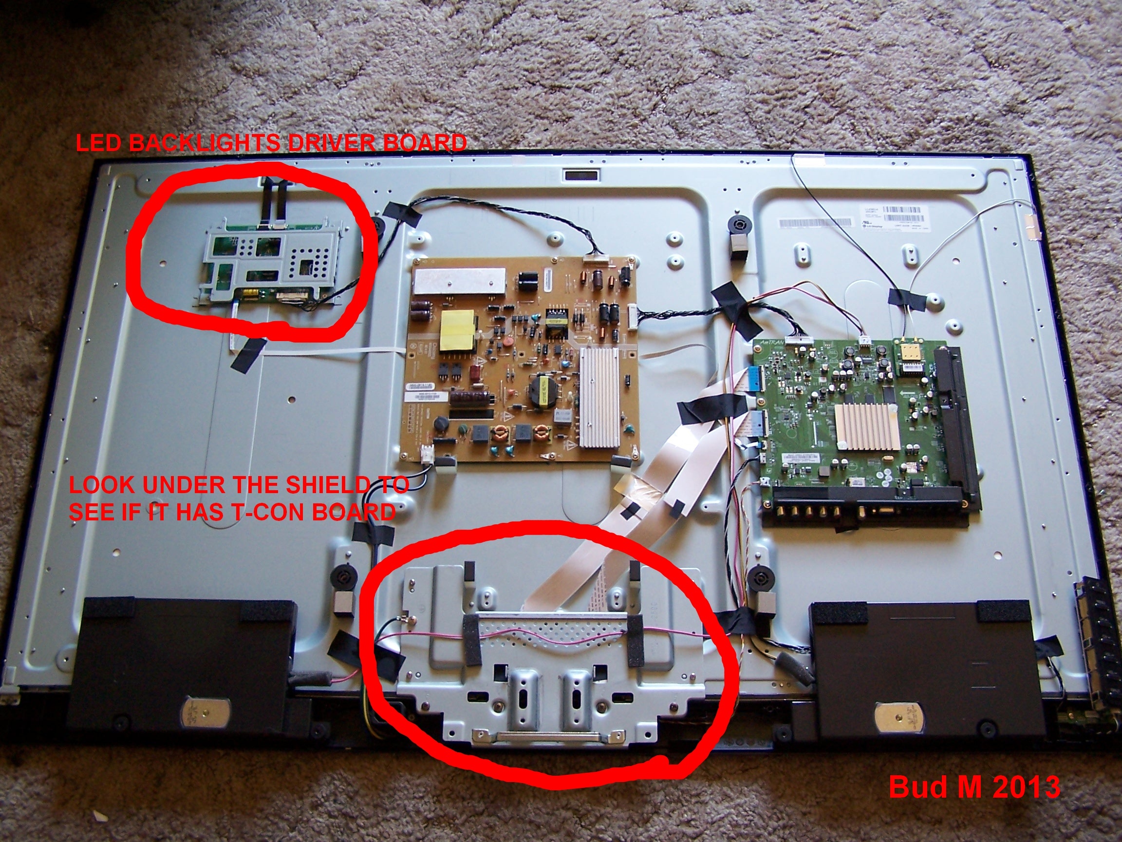

                            That board you tested is not the T-CON board, it is the LED Backlights driver board.
                            This TV may have one of those LCD panel with built-in non- replaceable T-CON board (or the T-CON is on the main board). You need to look under the metal shield.
                              LOL. Boy, I totally missed where the cables were running.
                                Lol so did I. I'll take a look under that shield. I'll report back in a few.

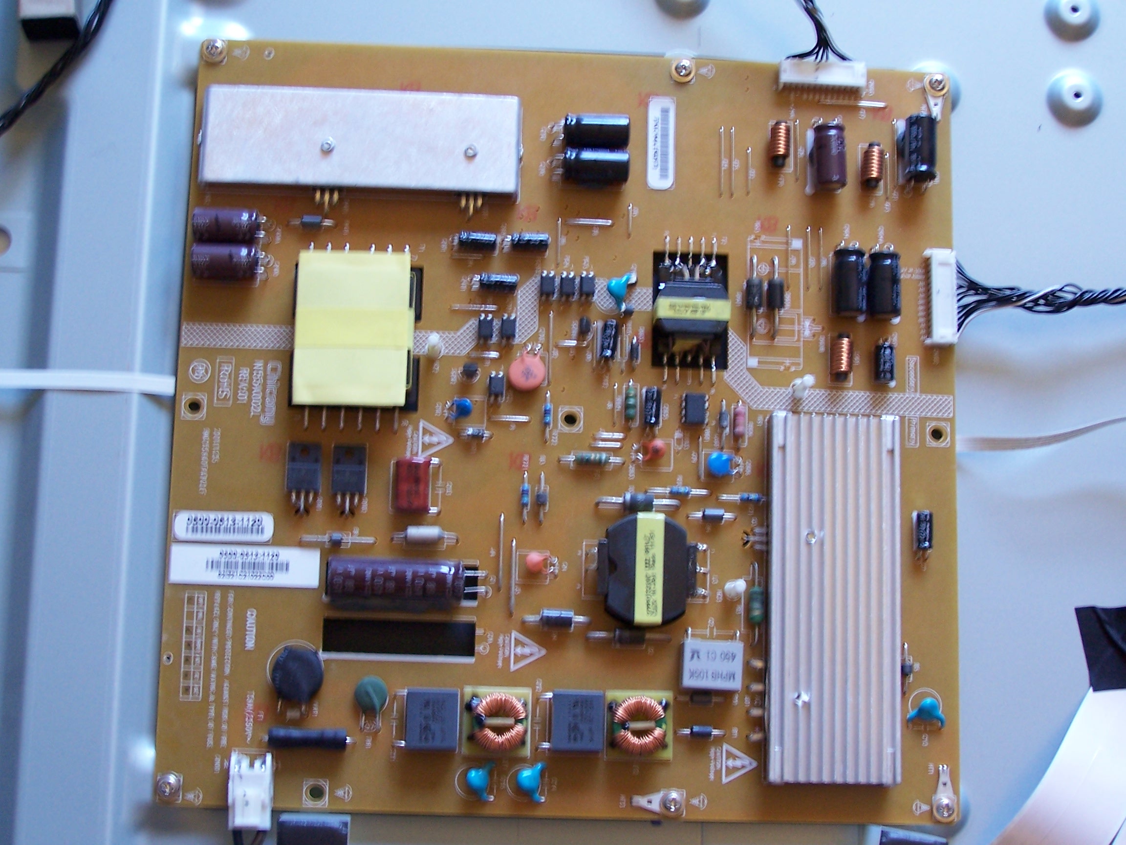

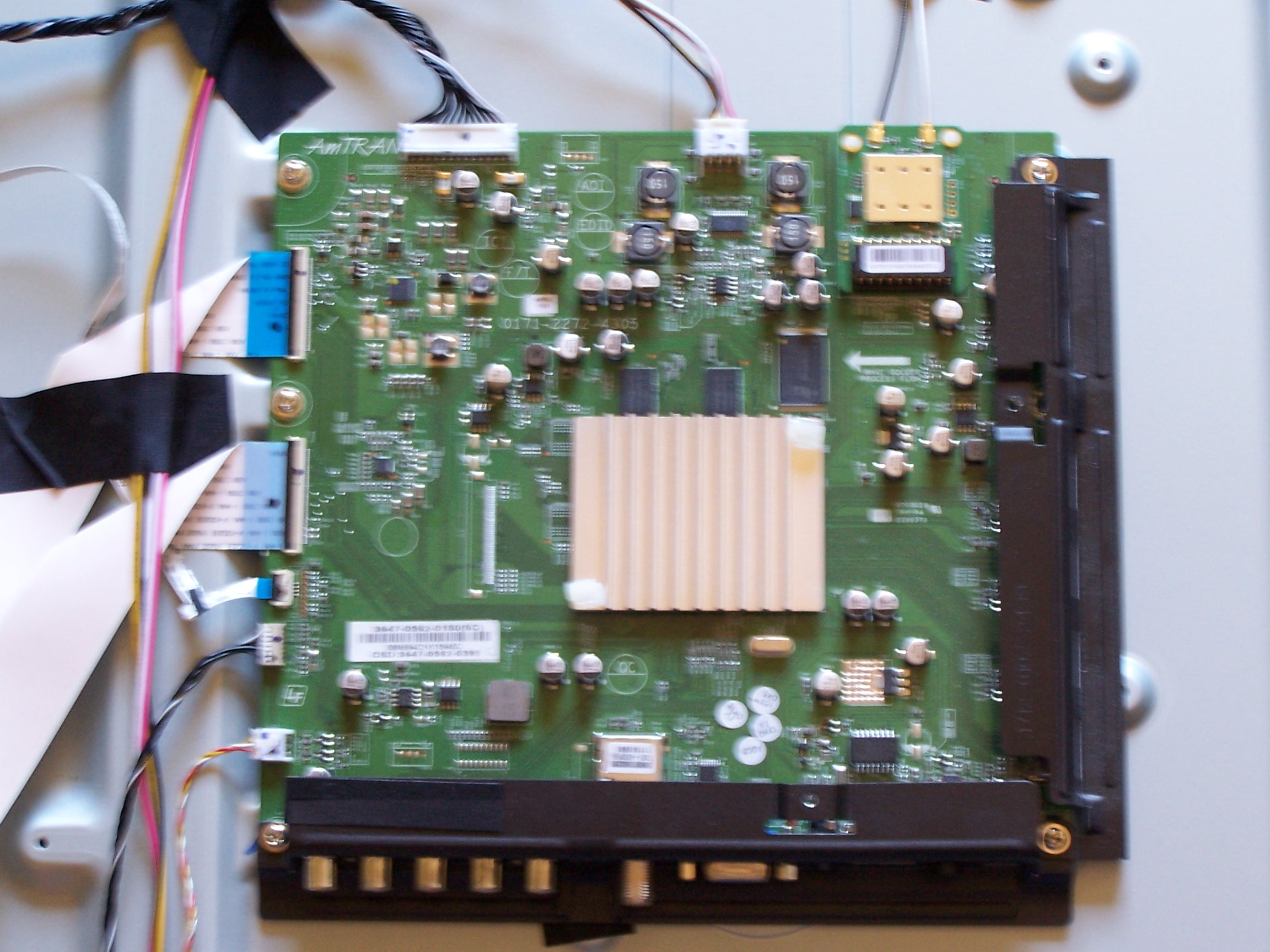

                                  Here is what is under the shield.
                                  Edit: They just attatch to two clips off the side of the panel. The main board does have two in one it seems. it says primary and secondary.
                                    I am not sure if the T-con is on the Main board for sure or not at this point, but it sure does look like it. One way to find out is to look for the spec sheet of the LCD panel. You need to look for the sticker on the panel some where.
