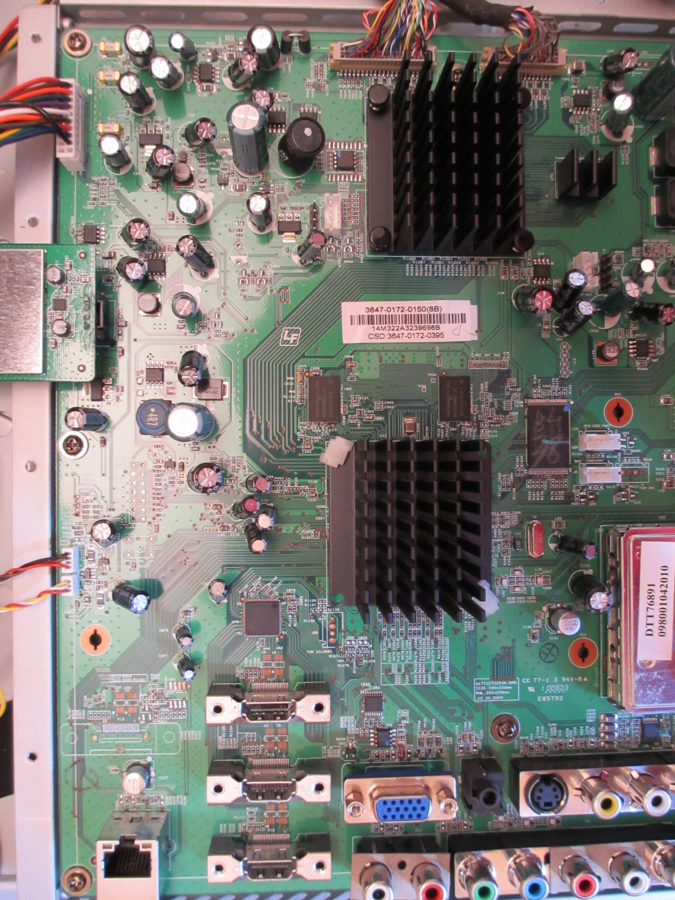

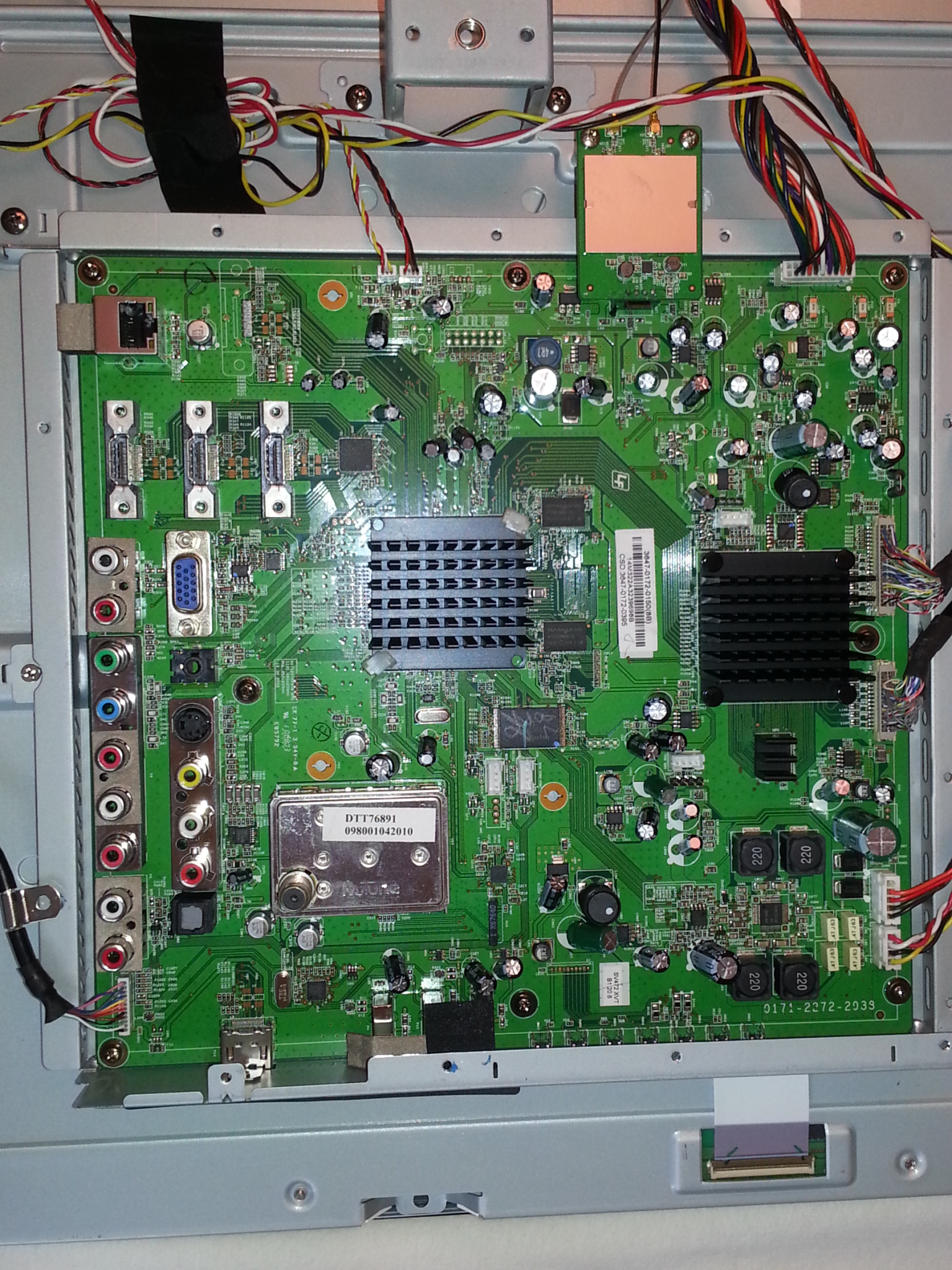

    We can power up/force power up the PC and can get sound, but no picture so we are assuming a problem with the backlight. we cannot get to bluescreen or see the menu and when we hook it up to cable the screen is dark gray.
    in looking at the other postings and a number of videos on this topic, we started checking out the fuses and the voltage regulators on the main circuit board.
    Fuse F4 was 11.90 and 11.88
    Fuse F10 was 5.143 and 5.128
    Fuse F13 was 5.145 and 5.141
    we then moved on to the 3 voltage regulators we could spot on the main circuit board
    U5
    L501 G1117
    pin 1 .270
    pin 2 .433
    pin 3 .004
    U7
    L501 G1117
    pin 1 .000
    pin 2 .000
    pin 3 .004
    U71
    L501 G1117
    pin 1 .000
    pin 2 .000
    pin 3 .067
    this may be asking the obvious, but i am assuming i need to replace U7 and perhaps U71. I am a novice, so wanted to see if there was anything else i should check prior to proceeding with this replacement.
    also, i contacted digikey to find out what i should order, and they could not find reference to L501 G1117. so if that is indeed what i need to replace, would appreciate any help on what to order.
    many thanks again -- i have found the reference postings on here outstanding, and they gave me the confidence to try to fix this LCD TV.

    Re: Vizio SV472XVT no video, but have sound
    Those regulators are not getting input voltage to them, you will need to find out where the b+ that feed the input pin of the regulator is coming from.

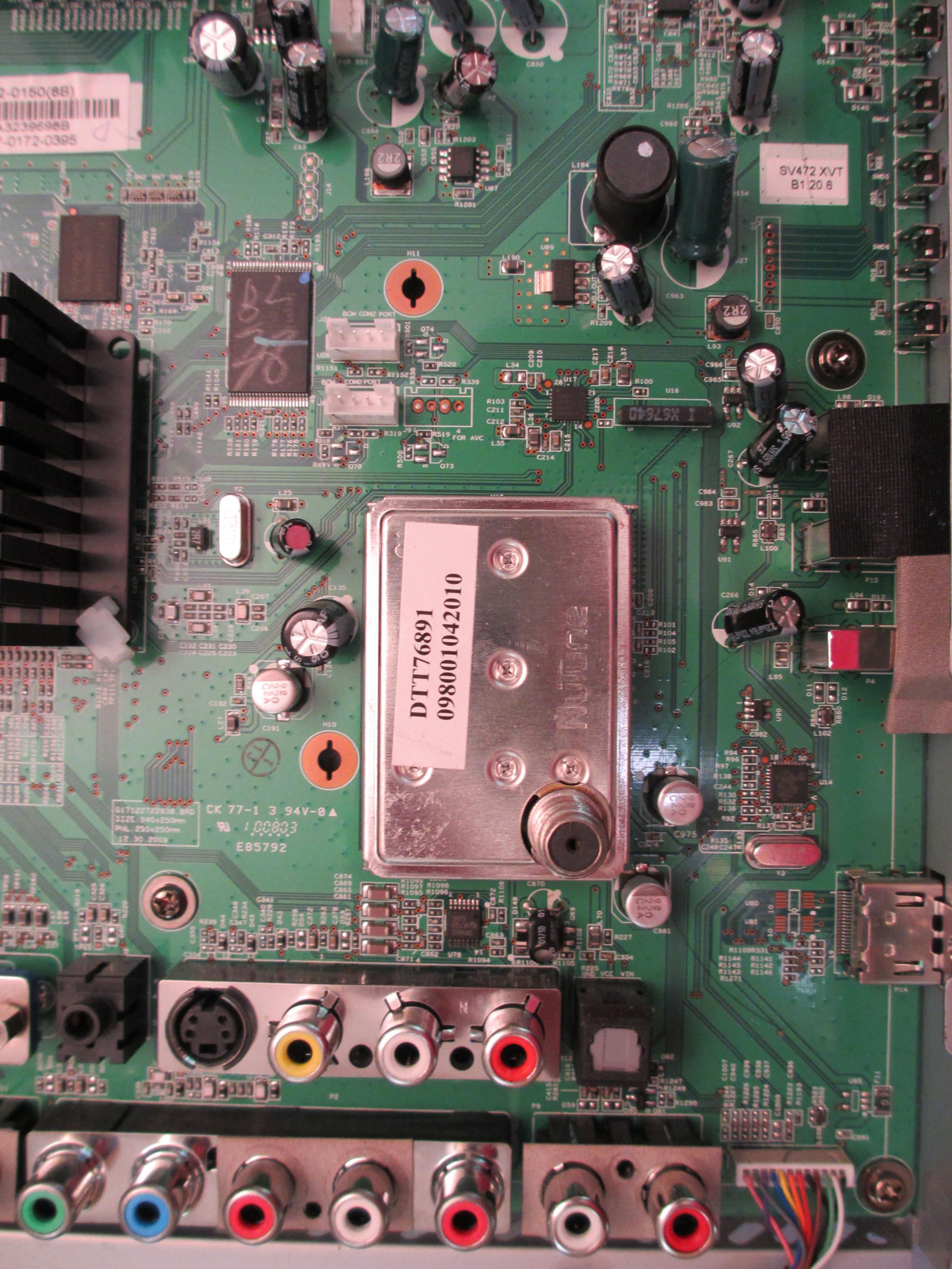

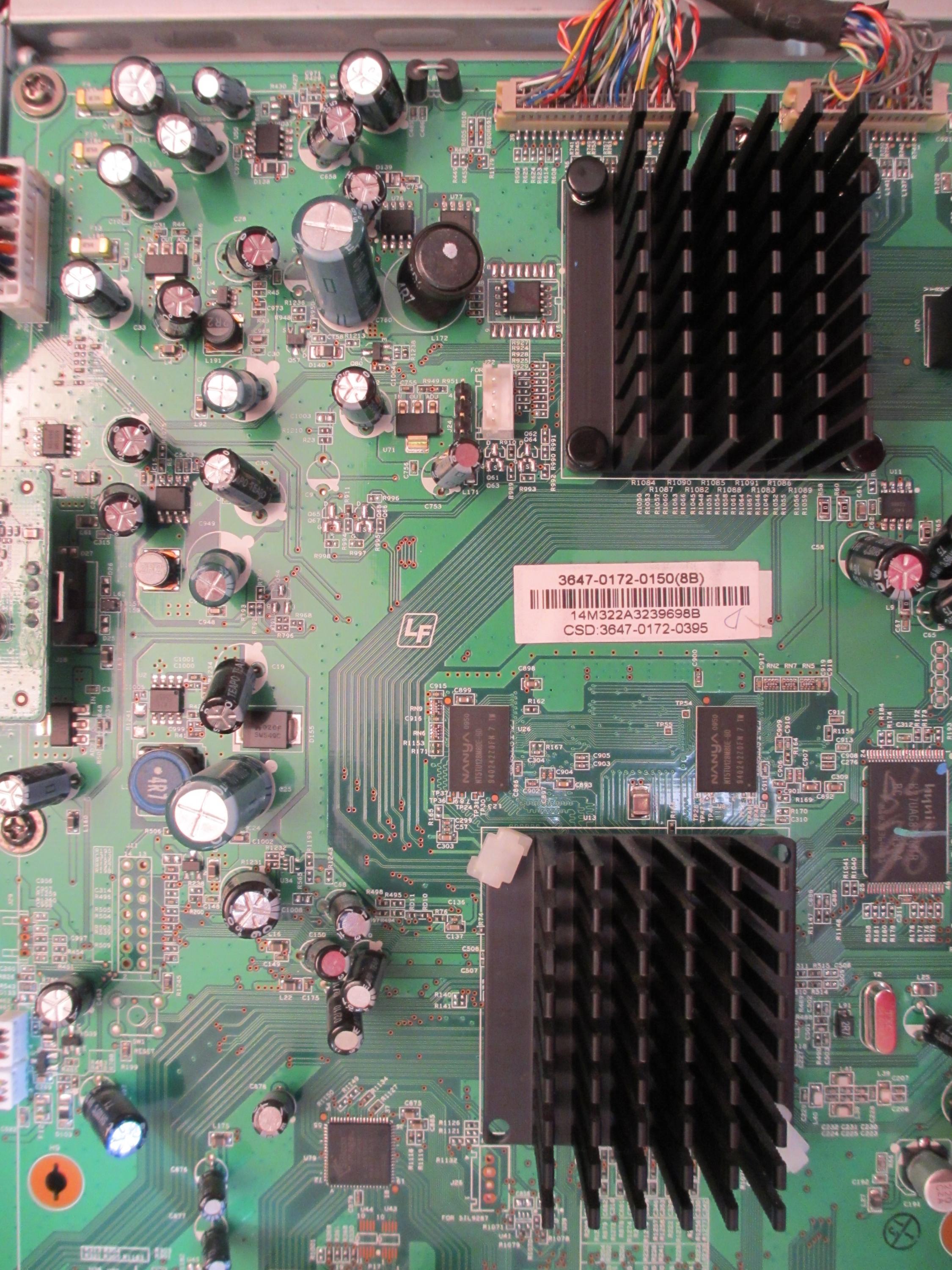

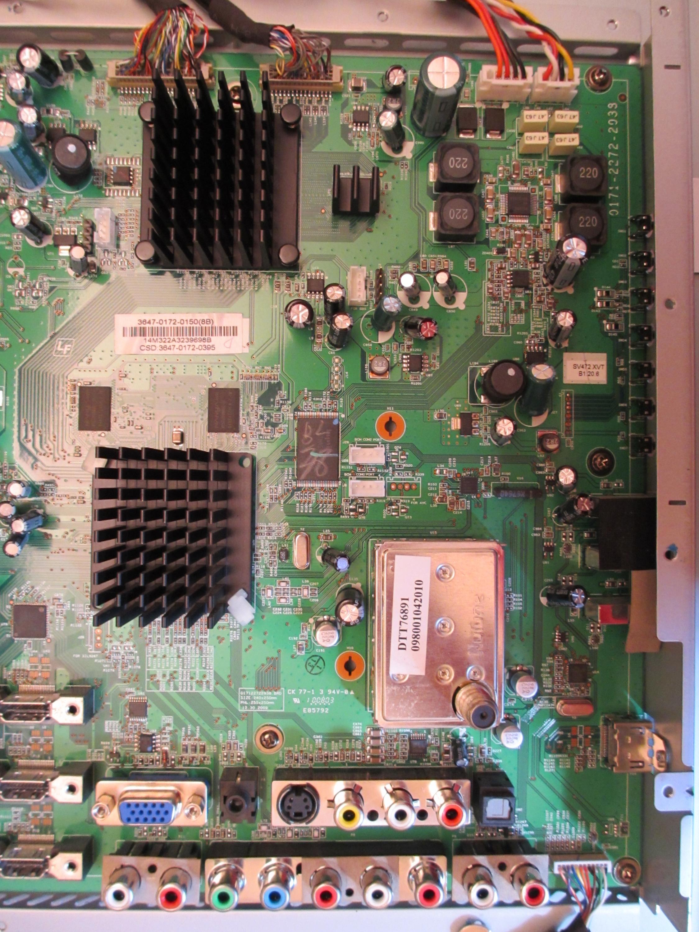

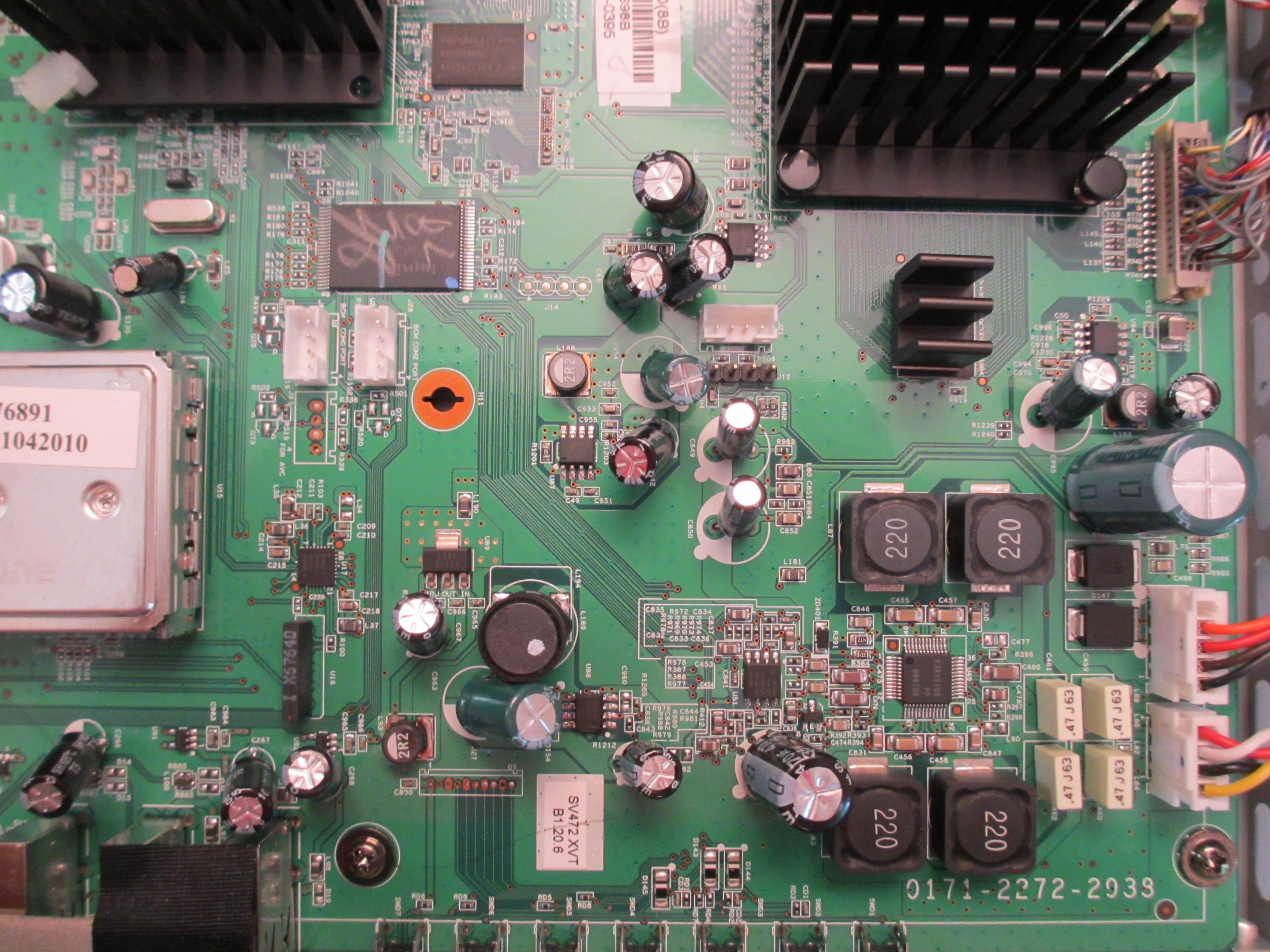

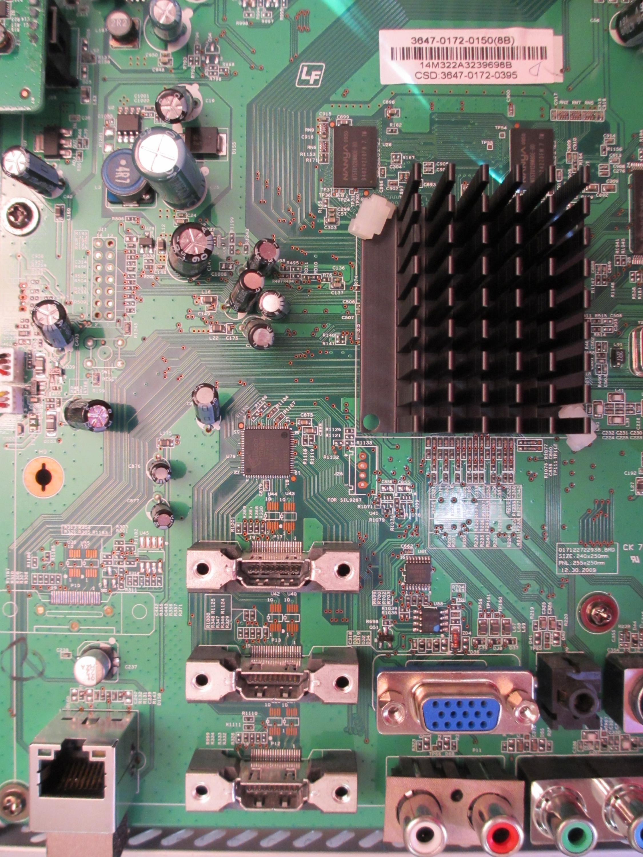

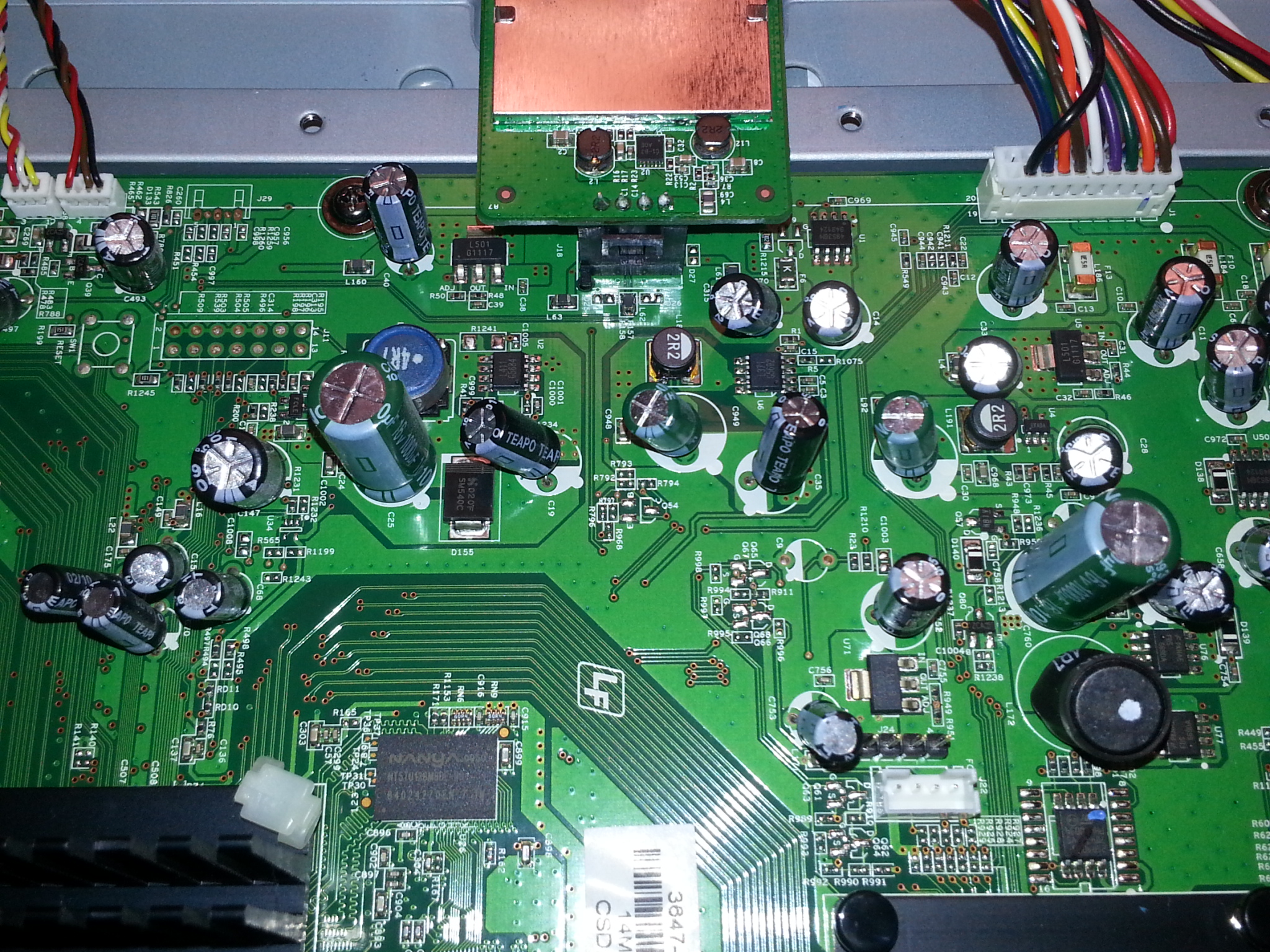

        There are many fuses on that board, how is that black fuse F6? Can we get good focus shot pictures of the whole board both side and also in 1/4 section or less so we can easily see the components?

          many thanks for the patience and advice. we went through and re-tested all fuses and voltage regulators on the main board, as we suspected we may have had only standby power on yesterday during some of our tests. The following readings are with the TV fully powered on, and we did see the blue glow of the backlight in the back of the TV, though the screen is still black in front when fully powered up.
          Our validated results are as follows:
          U5 L501 G1117
          pin 1 2.069 (adj)
          pin 2 3.309 (out)
          pin 3 5.124 (in)
          U7 L501 G1117
          pin 1 1.251
          pin 2 2.495
          pin 3 5.125
          U71 L501 G1117
          Pin 1 2.062
          pin 2 3.303
          pin 3 5.084
          U89 L501 G1117
          pin 1 2.062
          pin 2 3.305
          pin 3 4.935
          Fuses
          F4 11.90
          F6 5.130 (marked K)
          F10 5.143
          F11 3.340 (marked G)
          F12 5.131 (marked K)
          F13 5.145
          So, with these readings, does it indicate anything we need to replace on this board? We noted that fuse U7 has lower readings, even though there is a 1.25+diff between adj and out -- should this be similar to the other voltage regulators as they are the same model, though adjustable?
          Also any thing look unusual on the fuses? noted that one was a 3.3 v so don't know if that is ok.
          Is there anything else you'd suggest we check on the main board, or does it look ok and we should move on to check something else.
          many thanks for your continued help -- we are trying to save this TV from a rubbish heap and give it to our son for his 1st apartment.
          thanks again!
          janis
            Regulators are fine, they are within 3%. At this point it points to the T-CON board may not be getting the voltage to it, it will be the board under the metal shield.
