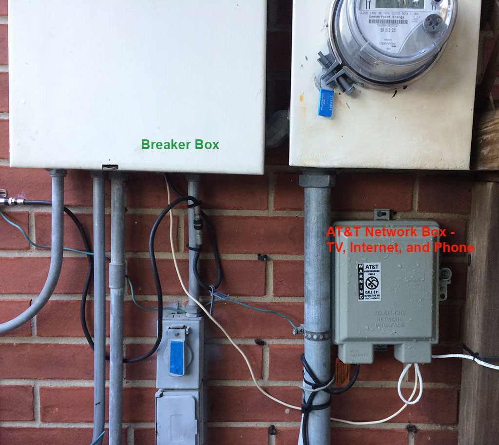

    My apologies for the AT&T reference, as it's country-specific. AT&T provides service for my TV (IPTV), Internet, and telephone. I attached a picture of the network box that's on the back of my house. It has a cable connecting it to the breaker box. The signal comes in from the network box through two bonded-pair copper wires, into a gateway (modem/router combo), out a coax cable, into a set top box next to the TV, and then into the TV via an HDMI cable.
    I figured it was probably a coincidence that the TV went out at the same time the tech was here, but I had to wonder.

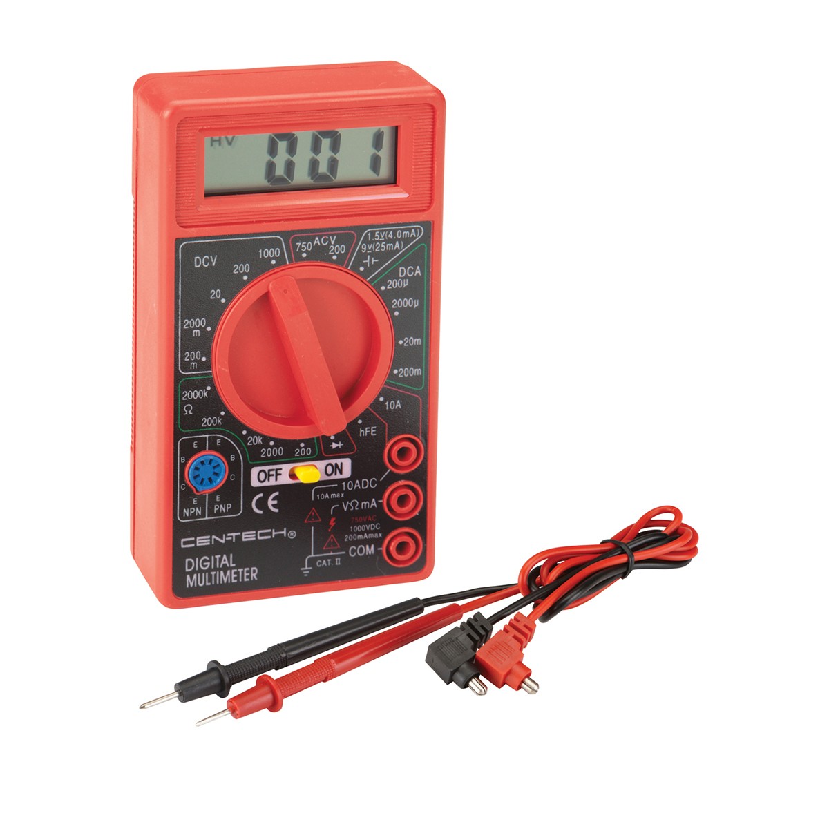

    Last night, I read this entire thread. If I remember correctly, isolating the problem to the SN board required using a multimeter, because the blink codes can indicate that other boards (A board or P board) are the problem
    , when they actually aren't. I have a cheap multimeter, which I've never used. I can read up and learn how to use it. Do you think it will be sufficient to correctly identify the problem?

          post a photo of the meter you have so i can see what ranges it has.
          No soldering, just screws, clips and latches. I don't think you should try board repair, not worth it for the cost Modus charge. You could remove the board and see if a tech will fit it. I would not expect any wty and they may not be interested if they don't do the job start to finish. You can only ask or maybe you know someone who is handy doing this kind of stuff?

              I attached a picture of my multimeter. Will it do the trick?
              I can't work on my TV tonight, but hope to pull the back off sometime tomorrow.

                Should be able to get somewhere with it. I'm hoping for something real obvious like a dead short across SN2 pins. Time difference my be a nuisance for me. 1pm Tuesday to your 1030pm Monday. I'll be at work when it tea time for you or tonight for me but early morning for you which is not ideal as most would be going to work.
                If we don't hook up, take the back of, locate the SN2 connector and set the meter in diode . measure across the 2 pins, if it reads like 0 or 0. xxx then change meter to resistance, go mid range and see what value. If your meter goes 1, means out of range.

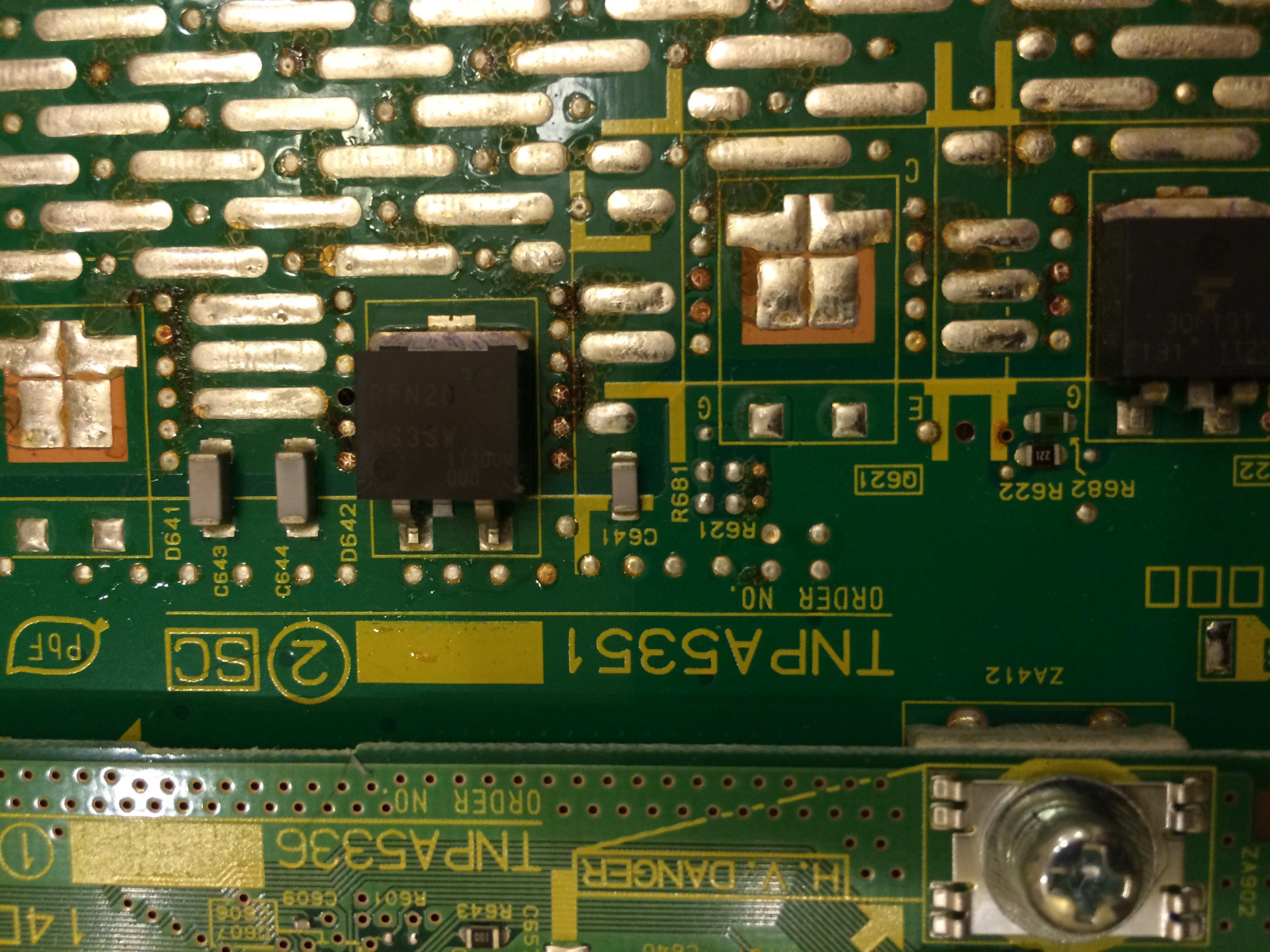

                  Hello, I have a P50S30 that is not quite three years old yet, here is the background:
                  About a week ago it started having an issue where the screen flickered in an odd way, especially before the set got warm. It's hard to explain the flicker, it's like the colors would fade out in certain parts of the screen. Well yesterday my wife goes upstairs for a few minutes with the TV on and comes back down and the screen is black. Power LED is on but won't respond to anything. After pulling power and holding down the power button we got 14 blinks.
                  I found this thread and have read through, so I'm hoping with your help maybe I can fix this myself. Here is what I have done so far:
                  • Checked the resistance on the SC2 connector pins. Resistance is .6 ohms so doesn't look like there is a short there.
                  • Disconnected SC2 and SC20 connections and powered on. Got 8 blinks.
                  • Disconnected SC2, P35, SS11, and all A board ribbons and tried to power on. Got nothing at all. This seems to be different than the other poster, he got a solid LED. Guessing either he didn't list all right connections or my issue is different enough to cause that?
                  This is all I could see to try for now. I'm still thinking it's probably a bad SC board but I'd like to be more sure before ordering. Are there any other tests I can perform to verify?
                  I also uploaded a picture of my SC board, if that helps.

                    Sometimes the power on or front panel is routed via one of those ribbons to the A board. Without checking I hazard a guess why that test did nothing. I would say you've proven the SC is bad and would be the cause of your issues. Since you had intermittent issues may also very well been loose screws(bad earthing)for the board which has been reported.
                    So i'd head down the path of getting a SC or get repaired at Moduslink PTS, do the Sd/SU buffer board checks for shorts before installing as they if shorte d can blow a Sc board too.
                    maybe check the screws, there are new kits available and also check the mountings on the SS, can't hurt to play safe and have a look.
                    If looking for a board check the revision of yours, each size has a variation of the same board. Most likely there is a white sticker with 5351 and xx after for the version, if no suffix then it's just the board number (no suffix). Don't go purely by the screen print of the board as that is the blank PCB number, can be configured a variety of ways.

                      #130
                      Re: 14 blinks TC-P50ST30
                      Ok, here is what I have found. I downloaded the Training manual, and performed the procedure on slides 71 and 72. No matter what I get a short on both TPSC1 and VF-5V. Slide indicates that means bad SC board. I then went ahead and did the buffer board pin tests you asked for. Disconnected all connections between SC and the SU/SD boards, plus the ribbon between SU/SD. I got a short on all pins on the SU41 and SD42 connectors. Is that what's expected? I wasn't expecting that so I started questioning if I was doing it wrong. However I get continuity just fine between two grounding screws so my multimeter seems to be working fine.
                      The label on my SC board starts with 5351AM. Thoughts?

                        "I got a short on all pins on the SU41 and SD42 connectors. Is that what's expected? "
                        All pins? can you expand on this? there's 9 pins, are you saying all 9 pins when referenced to the vfo-gnd that's the metal pads the bolts hold these board are all dead short? That's a bit unusual. If a board was bad I'd expect Vfo to be bad usually dead short
                        These are the pinouts,
                        based on my 2010 as a guide.
                        Vfo I'd expect 1.8meg or more
                        Vscn-f around 221K
                        Vf5V inthe Meg could be high like over 5meg
                        SD42
                        pins
                        1 Vfo
                        2 Vscn-f
                        6 VF5V
                        SU41
                        2 VF5V
                        6 Vscn-f
                        8 VF5V
                        I've had one 2010 FHD model with top and bottom boards shorted and the Sc. That was the TV I did not check and they killed a brand new board.
                        If in doubt replace them but you should be able to work out if bad or not.

                          Well it turns out some of my newbness with my multimeter was showing. I had it set on 200 ohm. Unfortunately it caps out at 2000k which I'm assuming would be 2 Meg. At that setting I was able to see one of each connector start with a resistance in the low 100s k and then increase until it went above 2000k and off scale. I was expecting to be able to see the 221k one you mentioned but that one showed off scale all the time. I am supposed to be testing the pins on the sd and SU side, correct? Maybe I have a crappy multimeter...

                            yeah it's always tricky trying to guide someone with cheap meter and lack of experience, not making fun of you just requires a bit of work to be sure we get valid results.
                            You should be able to measure the 220k, try reversing the probes but if it start high and continues out of range it's not shorted or low ohms and that's the main thing.
                            If you're going to do this work from time to time a good auto ranging meter like a fluke is like a lifetime tool if taken care of. Always good to have, with solid results. I'm sure there'd be plenty of others I just know fluke.
                            If it went o 2meg and OL then I'd claim that as a pass
