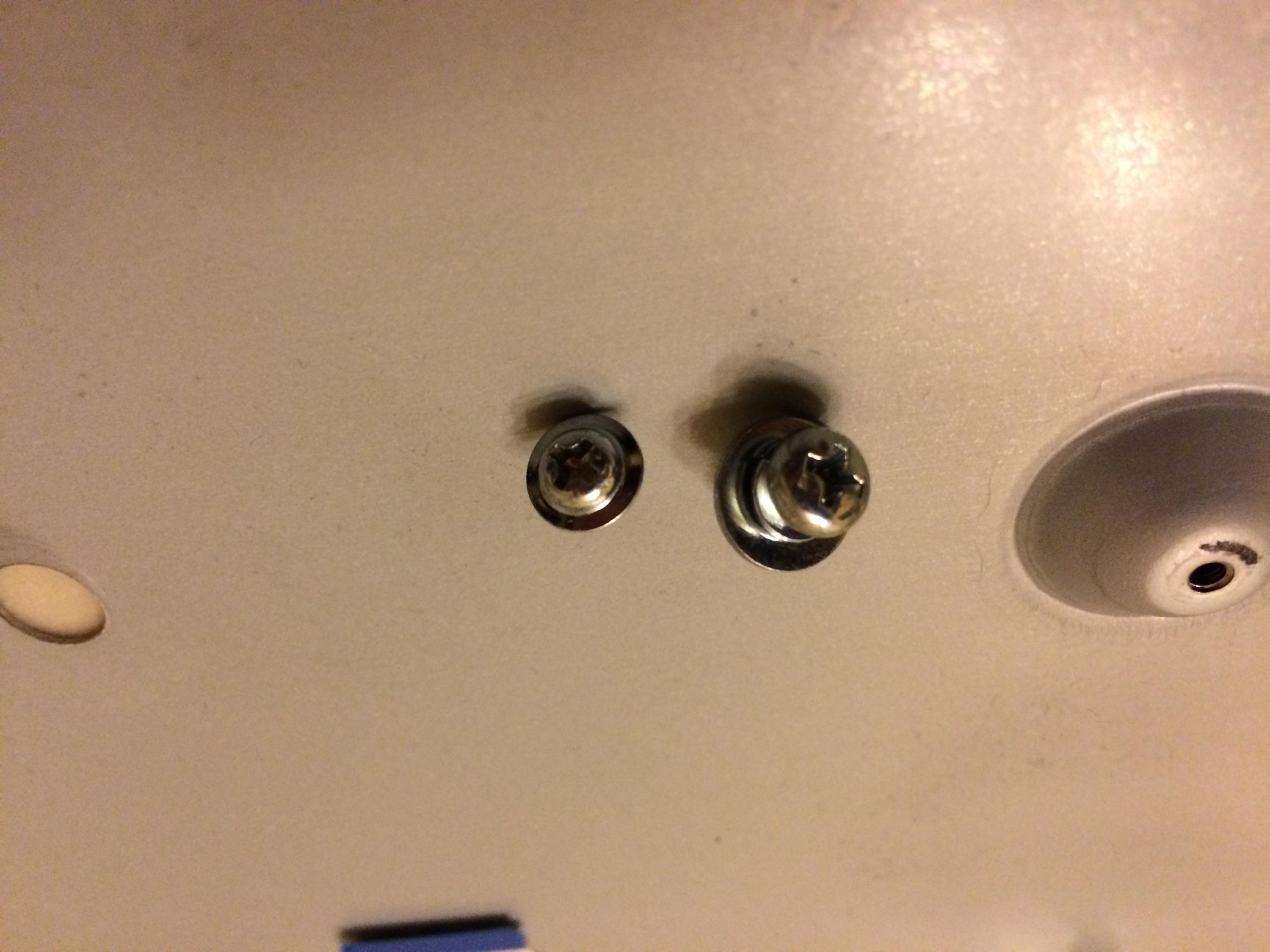

              Forgot to mention - when I took the board off one of the mounting screws was very loose, barely touching the board at all I think. I'm guessing this may have been the cause of the failure. I'll be sure to check and tighten all screws when I put everything back together.
                got a picture of the screws used? I'm not 100% sure if this model has the issue but there are screw kits available, maybe washers are missing or incorrect lentgh? I'm not sure but I'd check it out , might as well while you're in there.

                  Picture of the screws are attached. The ones with the washers are only used where the su/sd boards are stacked on top of the sc board. All other sc board screws are the smaller ones with no separate washer, just a wide head.

                    Got the repaired board and installed it and the TV powered right up. Working great! I made sure to tighten every screw on the back completely, and scraped away any buildup from the mount points. Thanks for all of your help!

                      The screws are a known issue. In your picture above you can very clearly SEE where the board earthing has arced and made a black spot.
                      This black spot should be well polished off with some emery before refitting the repaired board or much the same will happen again.
