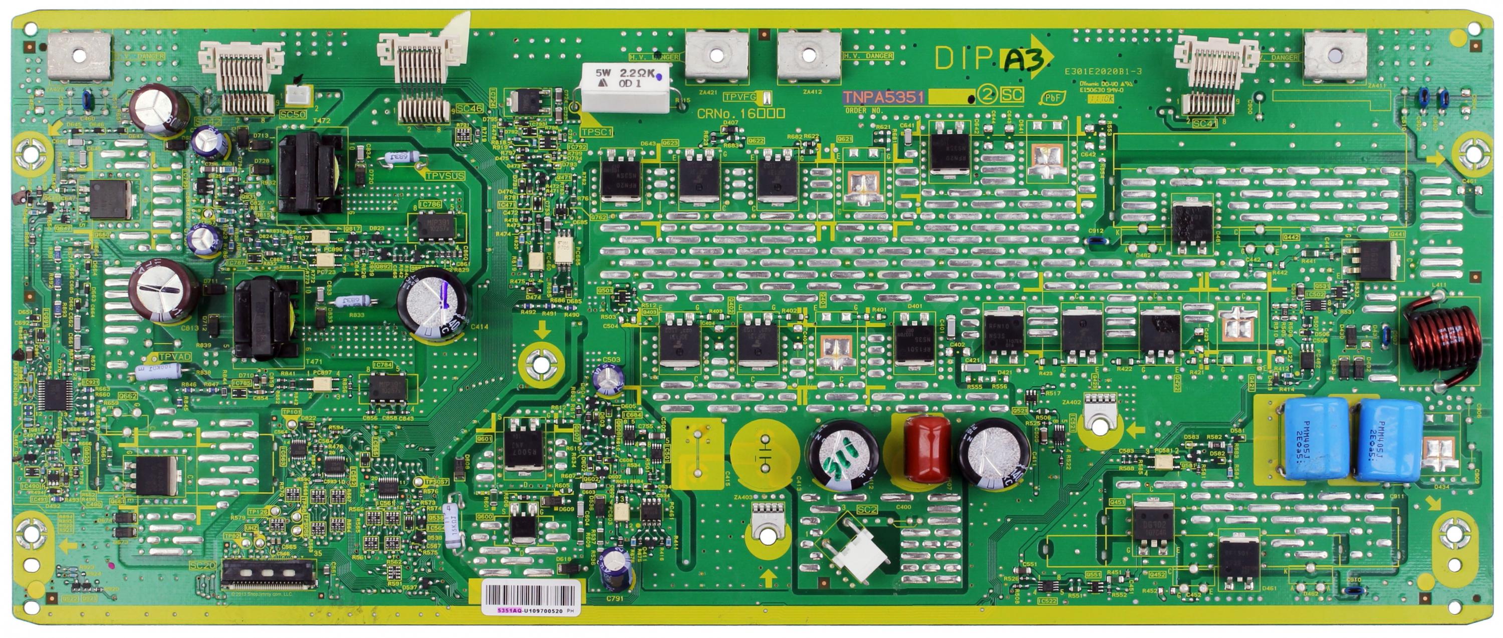

    TC-50ST30 manufactured May 2011 six months over one year warranty was watching it and screen just went out. Unplugged and plugged back in red power light comes on but no reaction to remote or anything. holding power button down for 5 seconds then red power light flashes 14 times. Have to unplug to turn off. Have downloaded repair manual but still want to call Panasonic before I touch anything. Could it be as simple as just replacing a fuse? Nearest Panasonic repair is over 200 miles away. Was retirement gift from kids and I am dying without it, found CRT in dump for now.

    Sounds like shorted Vsus at startup, highly likely it won't be a fuse.

                First step is if you have a multimeter , measure the resistance at Vsus lines to the SC and SS and see if dead short. TV off .
                If shorted then you'll have to isolate Vsus power to each board (SC , SS) and check at the SC and SS connectors.
                Or , remove the Vsus power lead from the SC, turn the TV on, if the front LED starts flashing like it's starting up and then stops with a different SOS code (other than solid or 14 blinks) that would indicate what was just removed was shorted.
                If no change, reconnect (check there's no residual voltage present), do same for SS
                Could be SC or SS.

                        Greenlee 210A multimeter 140$, I am into it now for better or worse.
                        shorted SC card. unplug and hit start switch get 7 blinks.

                          Does anyone know wht the resistance should be between pin1 ans pin 3 at SC2 . Where vsus enters the SC board.
                          Cannot see anything visual but no resistance twixt pins.

                            You can see from a few hundred K ohms to M ohms. I assume twixt means between.
                            So you're saying you have dead short on that connector? If so that is the fault.
                            next trick will be to also check the buffer boards for shorts as well and to locate a SC board.
                            Board maybe repairable, had a guy over here who found 3 shorted FETs and got away with replacing just those. generally it's not that simple.
                            Is your SC board, marked TNPA5351 AQ, or TXNSC1PHUU ? looks like I'm wrong about supply, quite a few out there now.

                              TNP A5351 DIP A4 . I do not see the AQ
                              nothing visible wrong on board. I have the schematics but are hard to read. Looks like 3 caps to start the circuit but look ok. The manual you posted has one checking a transistor looking discrete device for shorted but in my case that part is ok.
                              I have an 800 number for parts that the Panasonic supervisor gave me when telling me I am on my own 6 months off warranty.
                              ready to check buffer boards when you have the time. That photo is my board exactly.

                                        Thinking about removing components from sc board one at a time until short clears. I see 3 transistors in a row that may have been warm from the looks underneath but the legs do not ground. However the six down the middle of the board all legs are grounded.
                                        Any suggestions of a source for these components.
