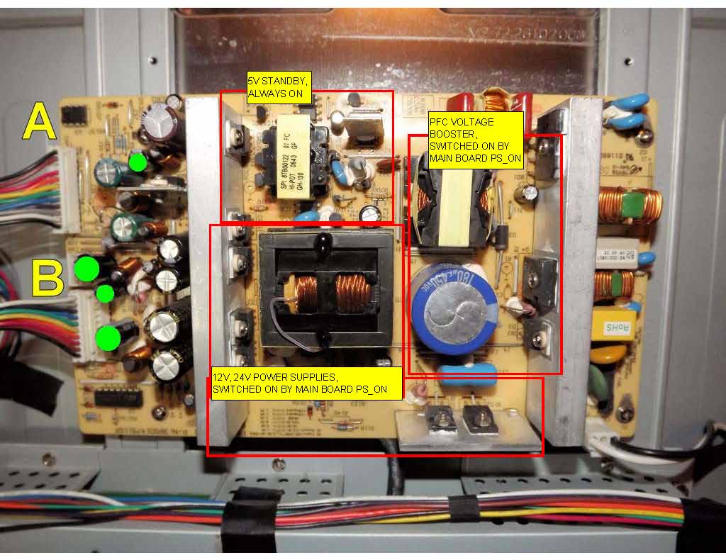

                Re: Sceptre X32GV-Komodo Turns on but then turns back off, after logo, with some flic
                The T-CON is under the shielded metal cover next to the power supply.
                So we need to look at the 5VSTBY output to see if it is steady or not.
                Is there any voltage labels on the power supply board connector that goes to the main board?
                The connector on the main board that has a ground wire attached to the screw is the one that supply the signals and voltage to the T-CON board, you will have be real careful when trying to remove the connector because it has very small wires attached to it.
                            Hello Budm, johnboy1313,
                            I bought a new CEN-TECH multimeter at harbor freight for 20 bucks. I put everything back together and I did the following.
                            1. Clipped ground to the chassis, and put the positive lead on the 5v line.
                            2. I plugged in the TV, for the first 2 seconds, I get 5V DC, then it falls down to 2V DC, and slowly continues to decline after that.
                            3. If I hit the power button at that moment, it will power up, the line will read 5V DC again, and then the TV will power down again.
                            Thanks!
                              OK, can you give all the voltage labeling on both two white connectors (one is CN4, another I cannot see the number)?
                              Then the good closed up shot of both sides of the power supply board, and also 1/4 section shot of both side of the board so I trace out the connections. I suspect you may have bad start up cap in the 5VSTBY section which is generayed by the smallest yeallow transformer on the board.

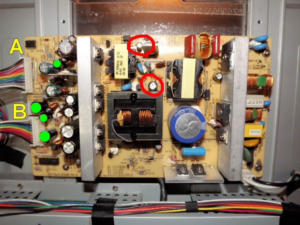

                                Try replacing these two caps (in red circles) or trying heating them up with hair dyer for 2~3 minutes then plug the TV into the outlet and see if 5v will stay at 5v. I got the pictures from other thread.
                                • guyonphone
                                  • Jul 2013
                                  • 12
                                  Oh Man,
                                  That worked!
                                  Thank you Budm, now allow me to explain why this is hilarious and why I feel seriously stupid right now.
                                  I thought I had replaced those capacitors, and in fact I had replaced one of them, the fatter one 50v 100uf. However the smaller one 50v 1uf, which had no signs of damage physically, i didn't replace apparently, and then I looked through my old pile of capacitors next to the tv and found the capacitor from the kit I was supposed to replace it with, which means that i need to now go back to the store i bought the kit from and return my refund :-)
                                  Thank you Budm I seriously appreciate your help, you got my tv working again!
                                        Hello! Not new here, just couldn't find my old log in information!
                                        I replaced all of the "bulging capacitors" on my board, still having power issues. No power light, nothing works when plugged in.
                                        I can heat up the capacitors in the above picture but, I only get the blue power light to flash for a second when I plug in the power and then it turns off.
                                        Any ideas? Guessing I should replace the 2 capacitors pictured above?
