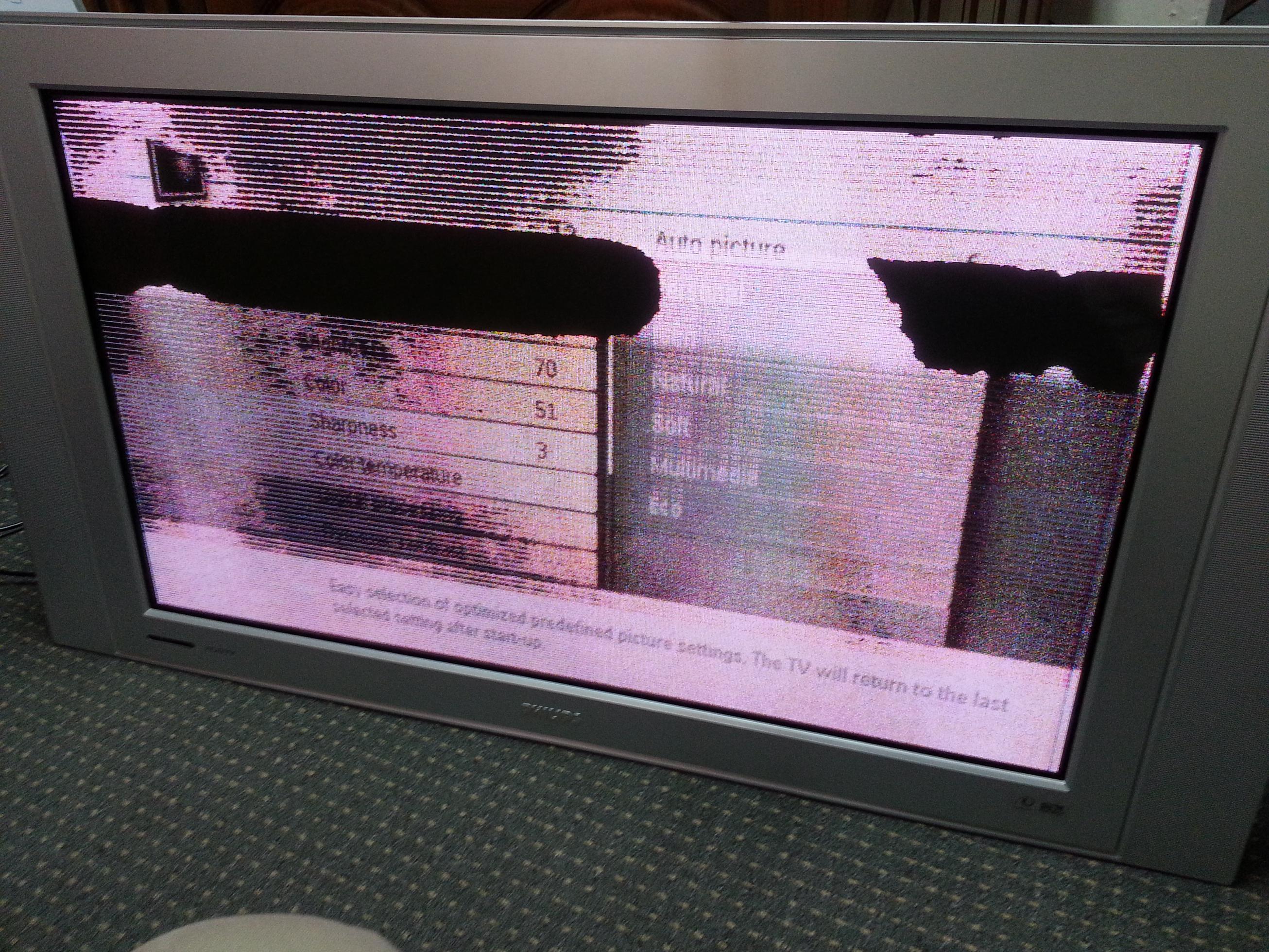

    I just need some Good Advice on how to proceed with Properly Identifying the problems associated with this Plasma TV.
    I have little experience with these matters and no equipment to test, sorry.
    I opened it up looked at the Boards and none of them look like they are burned / no smell either.
    There was some work done to this TV last year.
    I changed the sound board - due to the loss of audio and
    A local tech fixed a power issue by soldering some caps and putting in some heat sinks - to help with the overheating. That was another cost by itself.
    tomm66, said :
    "Yes - bad X-main, replace the X-main. Post a thread if you need more help." and
    "Looking at the picture, it also looks like the Y-buffer may be bad, but the X-main is causing the discolouring too."
    based on his evaluation of the photo, I am prepared to purchase these boards and replace them myself.

    I was alarmed when I saw the thick Black horizontal bar - thought it was the screen that failed. Why is it in 2 parts and not one continuous solid line ?
    How will I know when the screen fails ?

    The X-main fails on these sets fairly often. When it fails, the gas in the panel doesn't fully discharge -- it almost looks as if the panel is broken, but it isn't. The gas isn't completely even, so some parts discharge and others don't when the X-main isn't providing enough energy for the panel to fully discharge. If the panel were broken, you'd see no image at all and instead hear a loud buzzing sound from the glass.
    As far as repairs go, I'd highly suggest you replace the X-main first. The Y-buffers can be replaced after replacing the X-main if distortion is still an issue.

                I'm pretty certain the X-main is at fault as well, you would not see the black part of panel with Y-buffer fault.

                    X-main is common vertical, Y-main is scan vertical. It is a little strange, the X-main would be more accurately called a Z-main (LG use Z-sustain) or common driver. It has nothing, at all, to do with the columns.

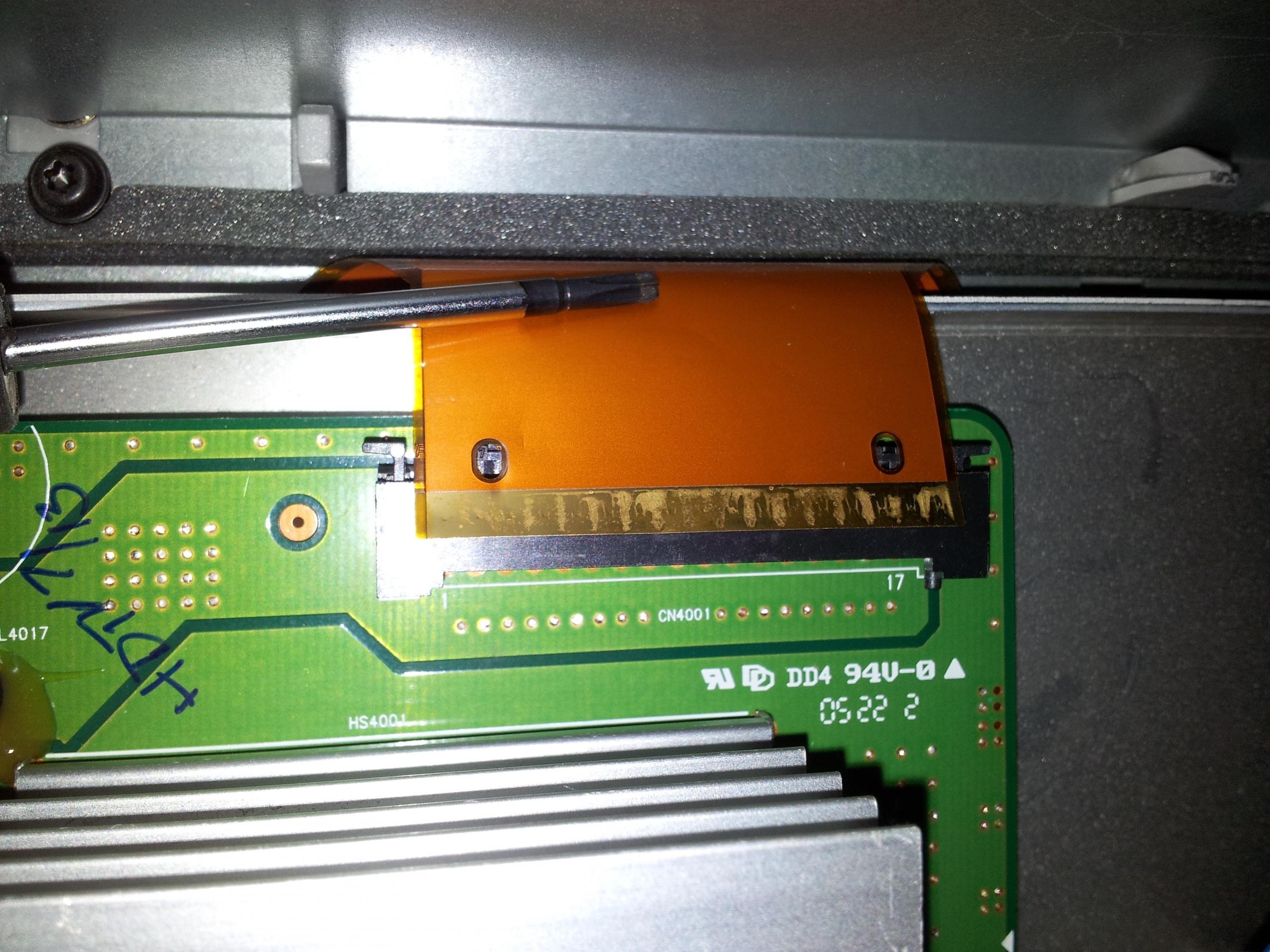

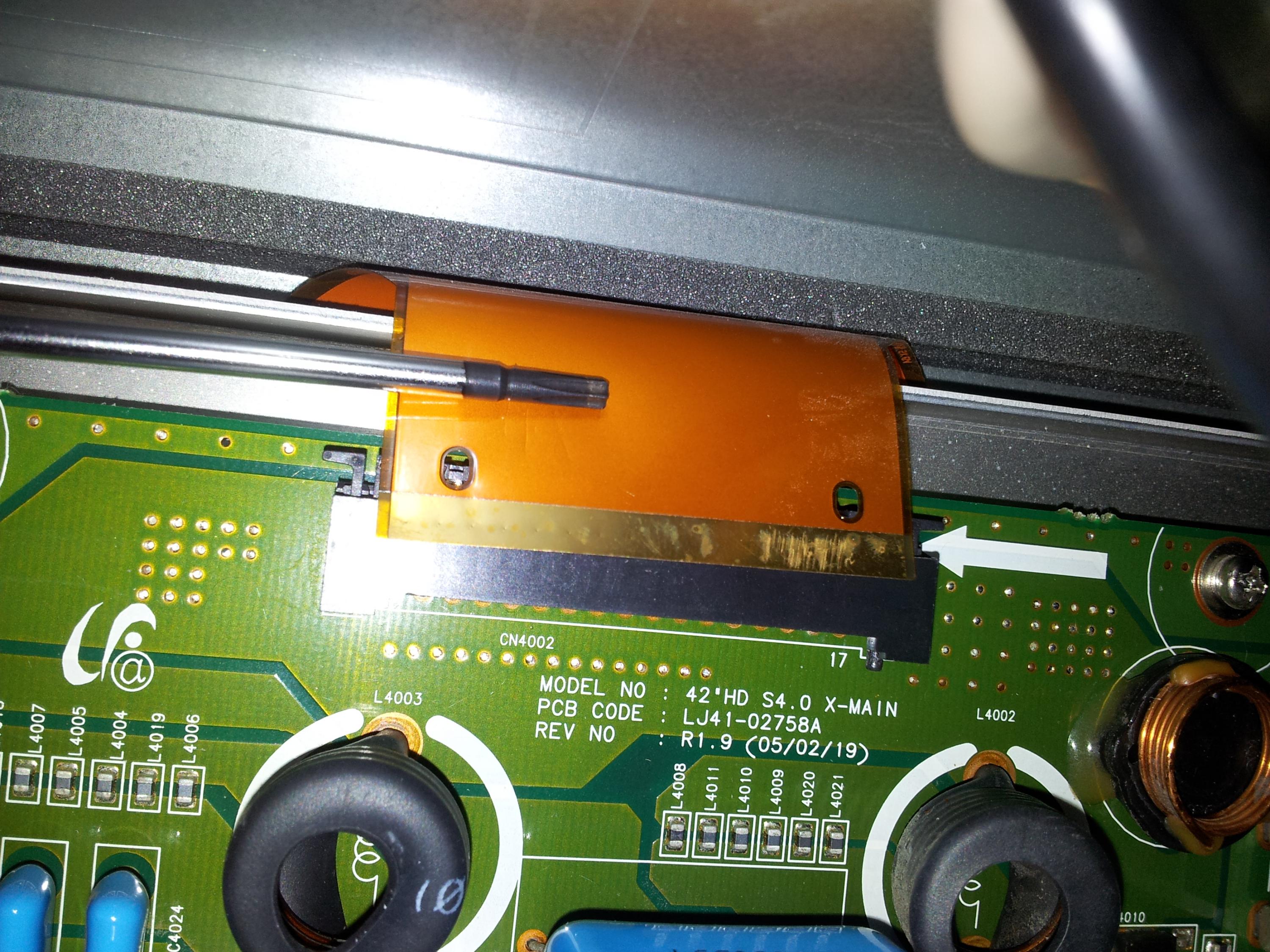

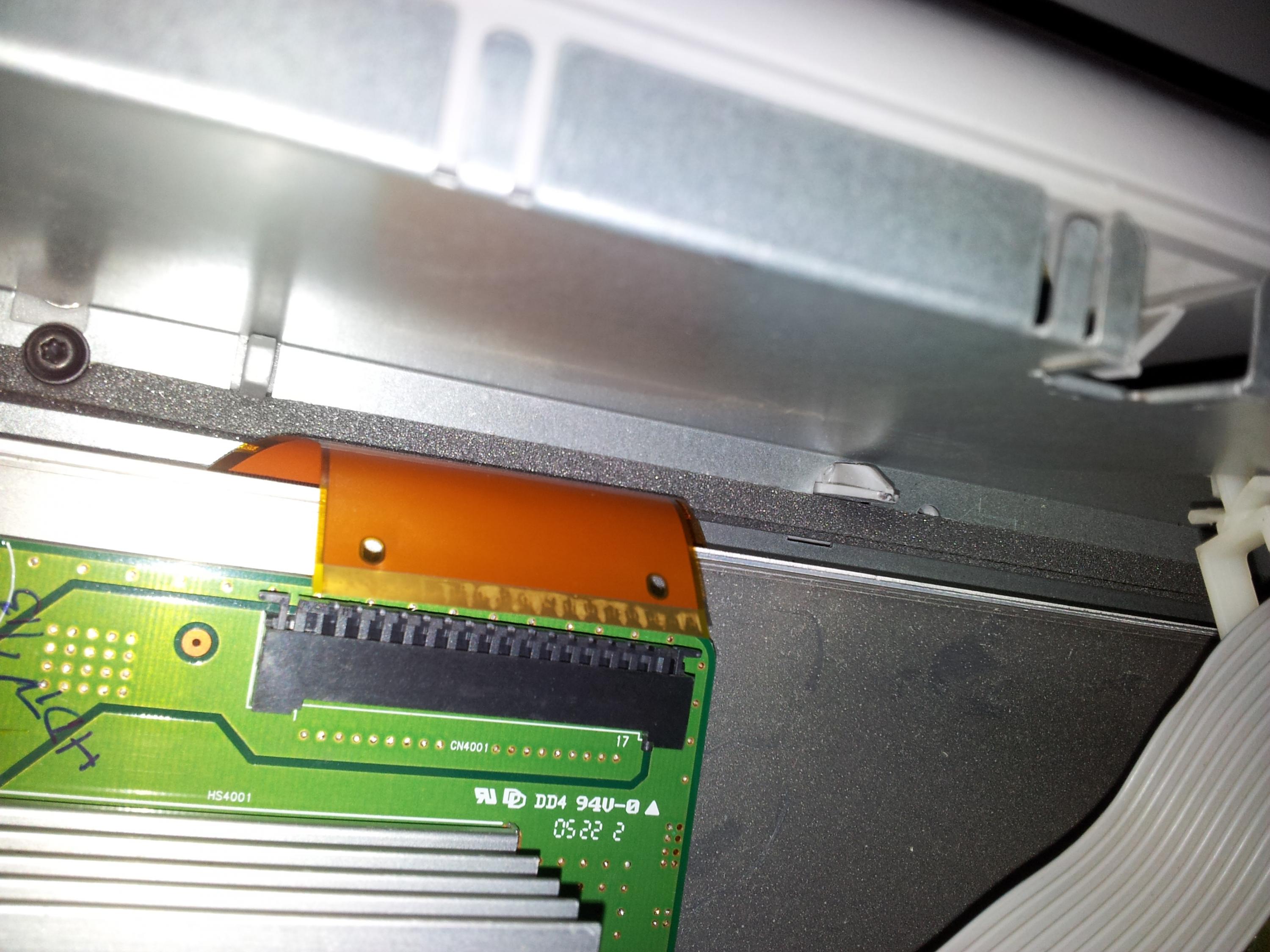

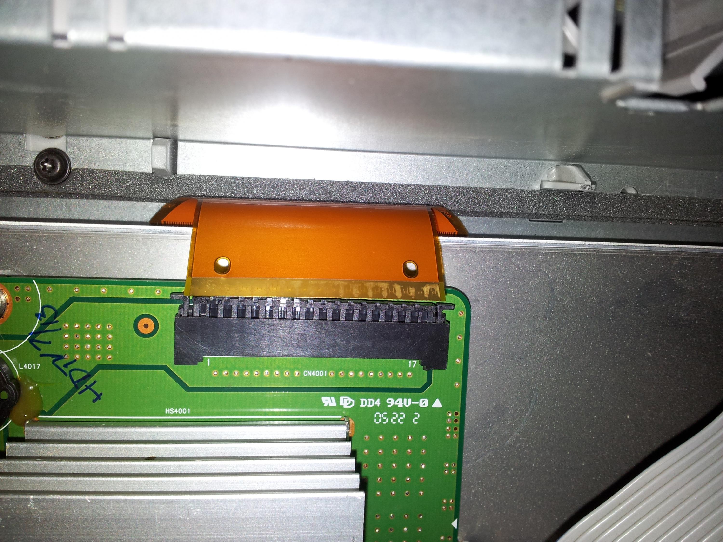

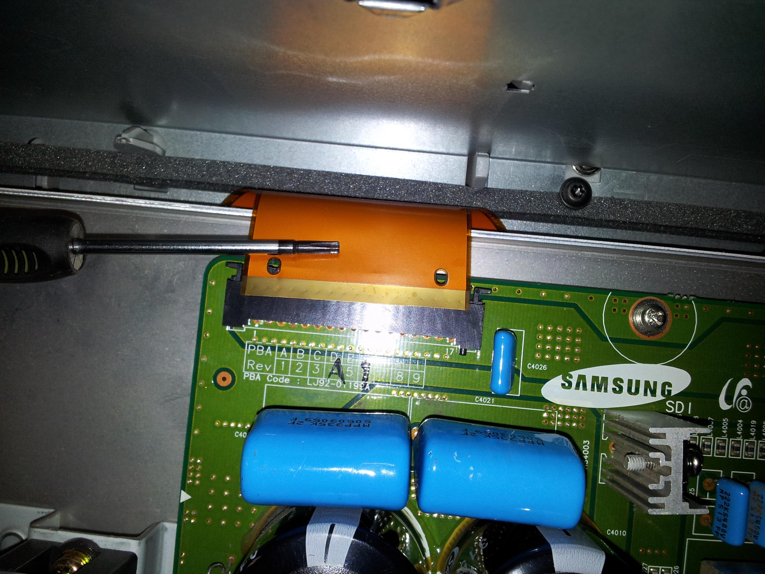

                      Ok, got the parts and did the following :
                      Changed the X main board - but there was no difference in the display
                      left the X-main in and then changed both the Y- buffers - this caused the screen to turn totally red and began flashing in 1 second pulses.
                      I did notice however when changing the X main, that of the 3 ribbons on the right that connects the screen with the board :
                      The Top one was OK ie. the gold band was in tact - mostly
                      The Middle one was lacking some gold on the band
                      The Bottom was in a bad state - about 50% on the gold on the band was missing - interspersed across the band.
                      It looks that it was consumed - missing parts for proper connectivity to occur.
                      Please tell me, your thoughts ...

                              Re: Philips 42" Plasma - Model 42PF7320A
                              Can we see a picture of the corrosion/deterioration?
                              • Injustice
                                • Jul 2013
                                • 18
                                • Trinidad & Tobago
                                working on them now
                                see attached now
                                    You should just be able to clean those with isoproypl alcohol. So you saw -no- change in picture after replacing the X-main and Y-buffer?
