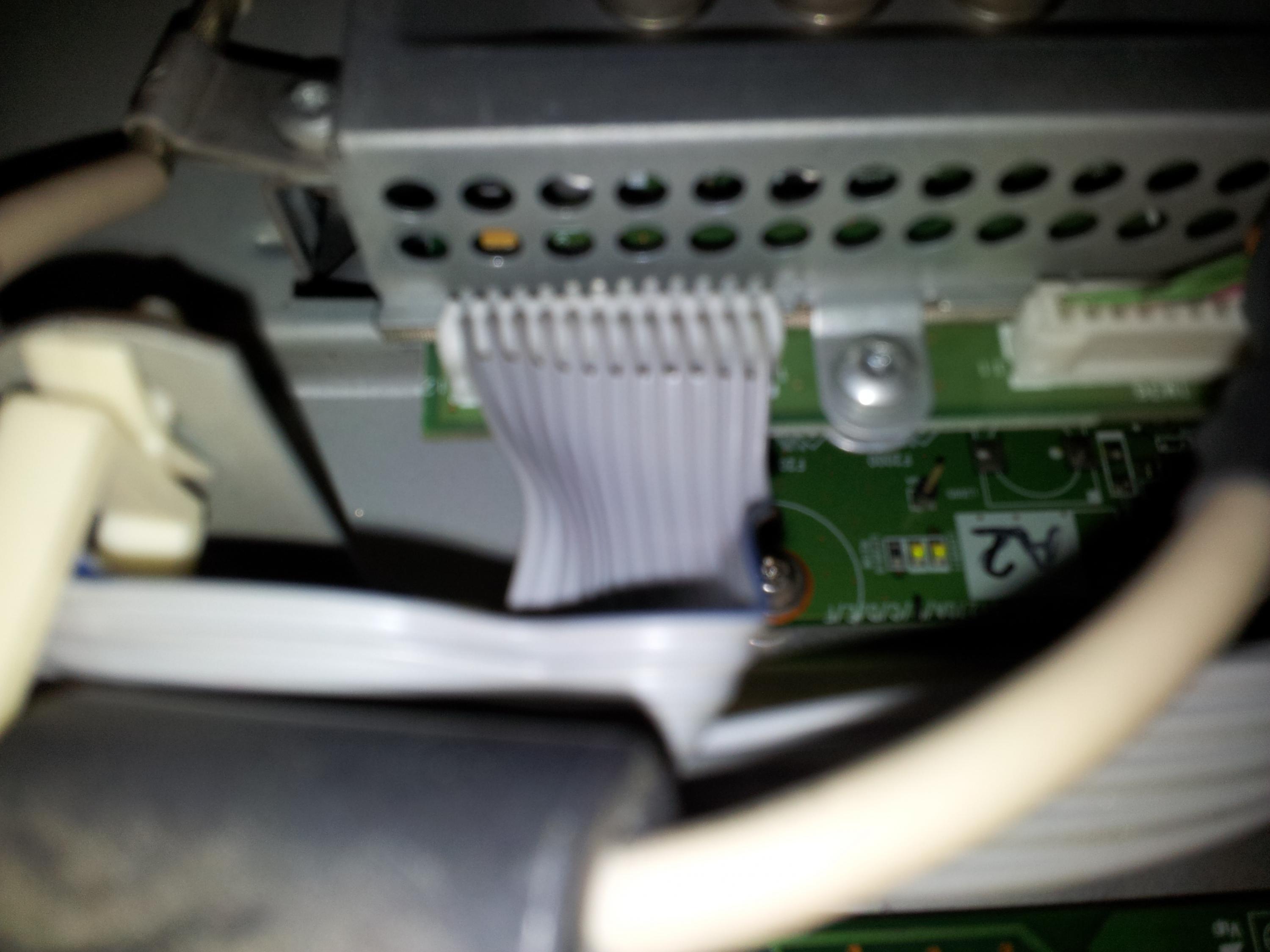

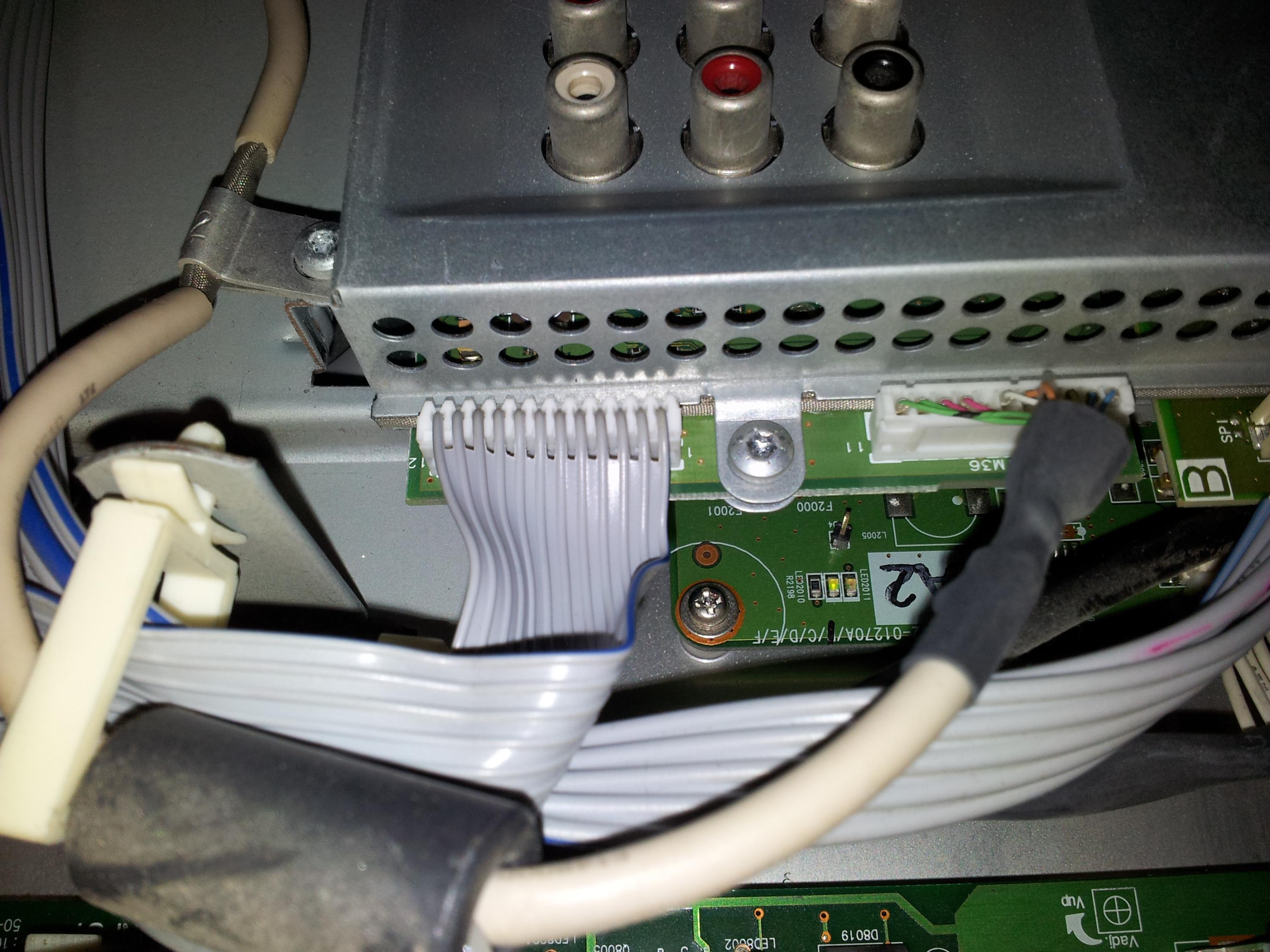

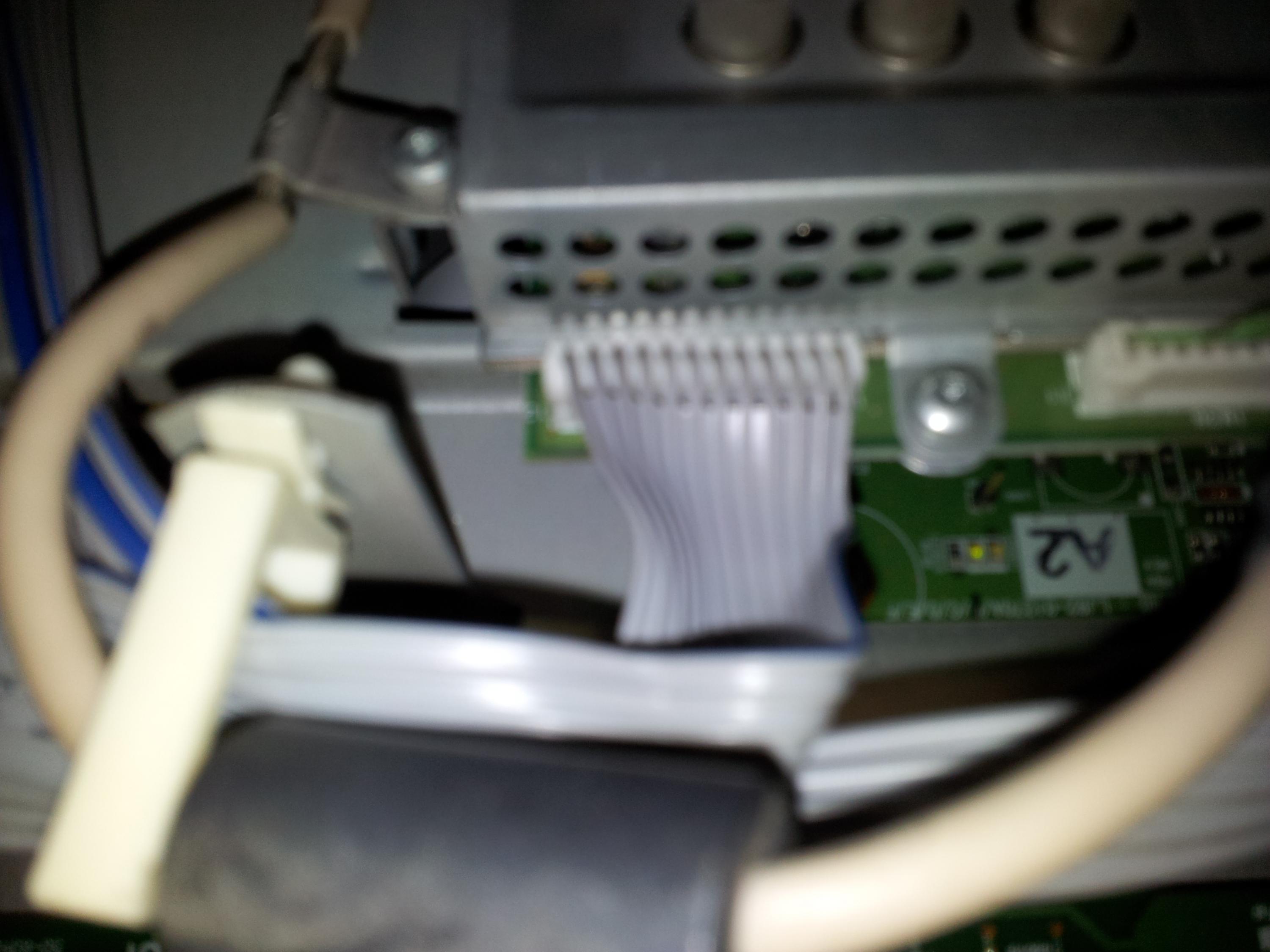

      Re: Philips 42" Plasma - Model 42PF7320A
      Right,
      I changed back to Original Y buffers first - No change - Still Flashing Red Screen
      Then I changed back to the Original X Board - No Change also - Still Flashing Red Screen
      I did notice that there were 2 Green led lights on the "A2 board" don't know it proper name - [ photos attached ]
      One was Solid green ( inner ) and the other was blinking (outer, closer to the A2 writing ) in the same sequence as the flashing of the screen.
      Also there was a Humming sound coming from the Y Main board area, the hum was in the same sequence as the flashing of the screen. and blinking of the green light.
      Does this mean anything ?
        It sounds like you got a defective Y-buffer board which has caused damage to your Y-main board.
