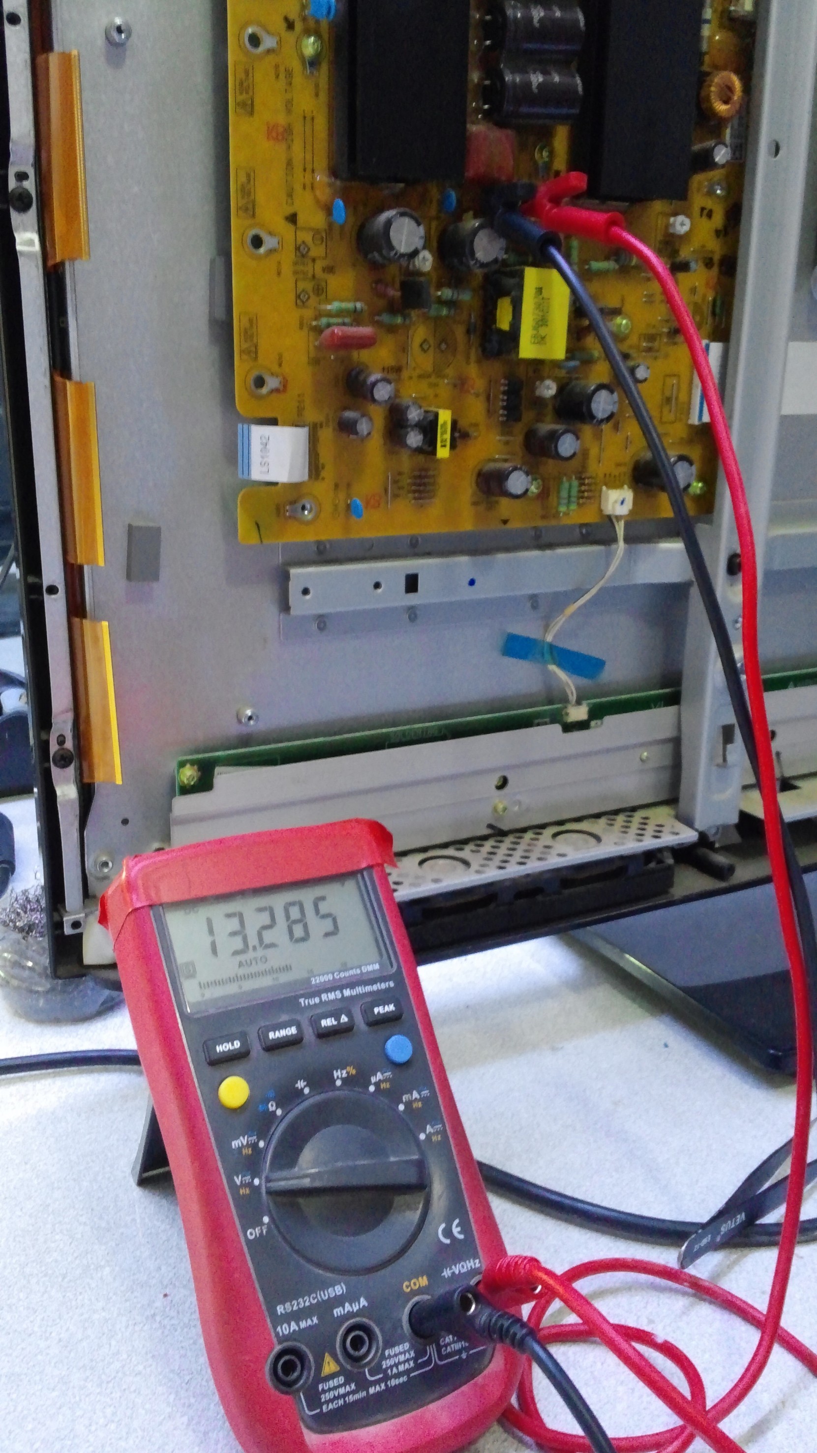

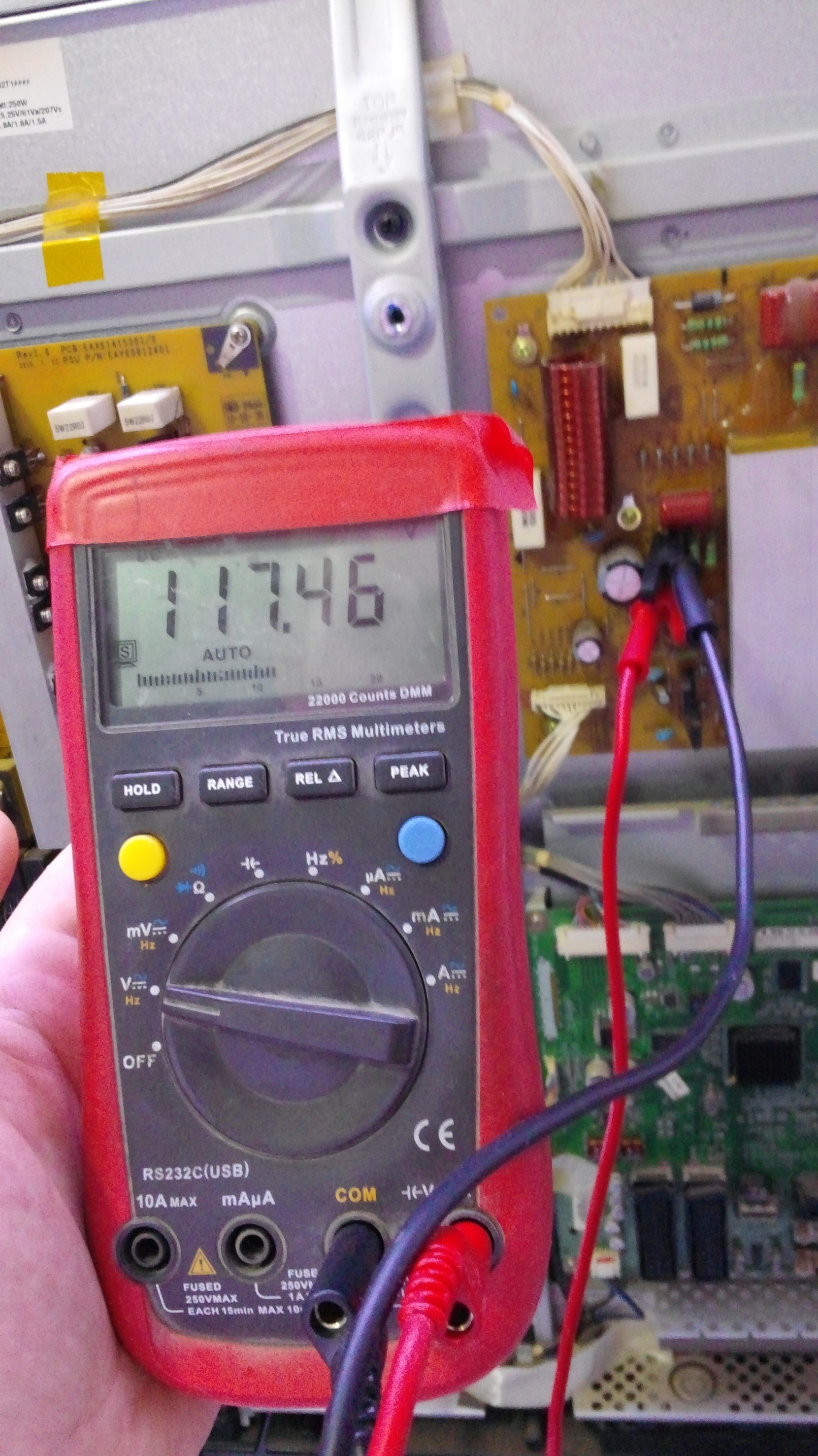

        Hello!
        Another case of NO picture 42PJ350.
        Voltages:
        vs - 205v
        va - 60v
        vsc ~20v
        vzb - 117v
        -vy ~15V
        As Tom suggested in post 11 i disconnected the buffer board and saw only a slight decrease in voltages of vsc and -vy, but these remain still too low.
        I have minimal experience with plasmas and troubleshooting this is an enjoyable experience.
        I have the Ysus in my hand, where do i start?
        thanks in advance!

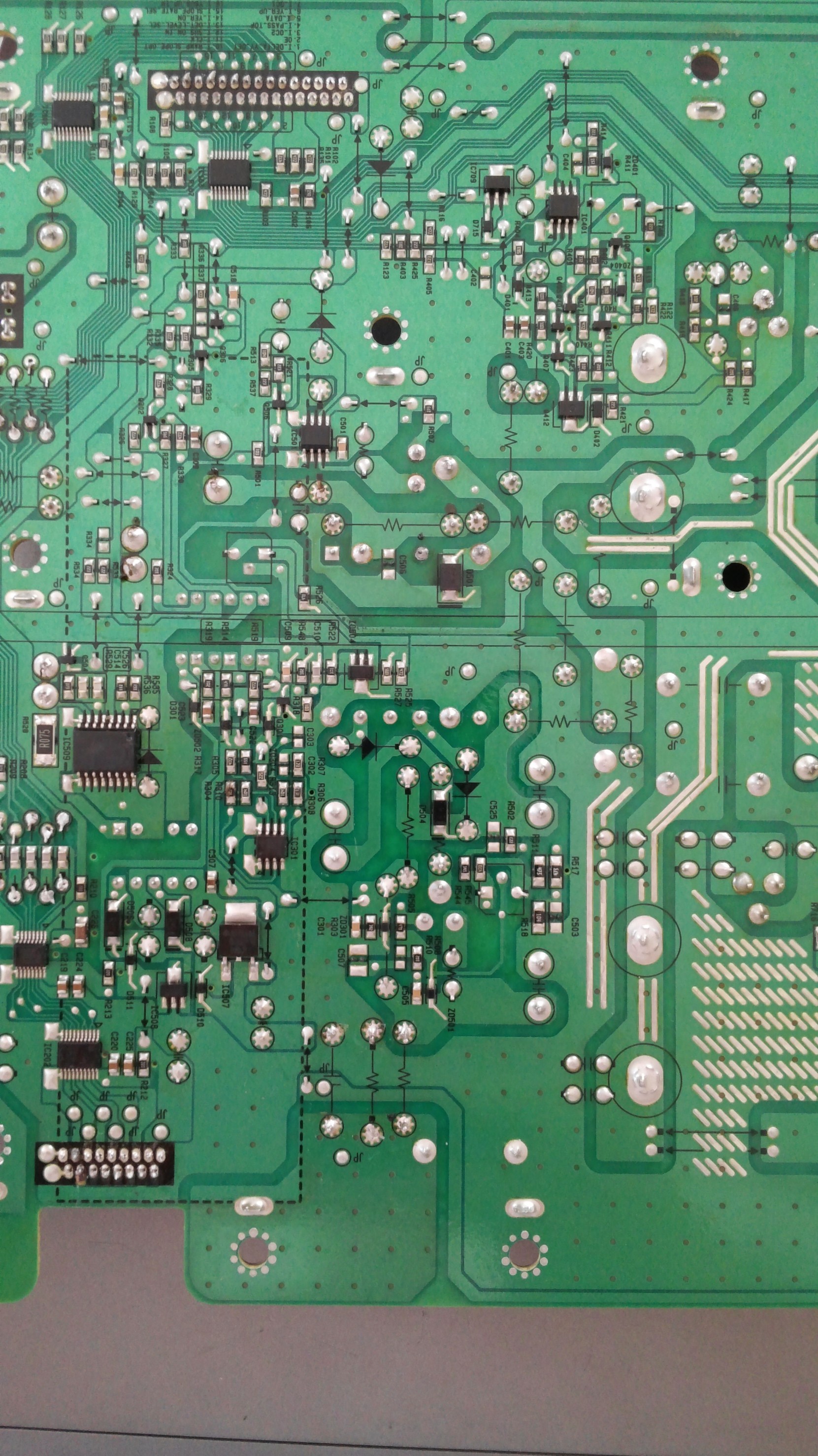

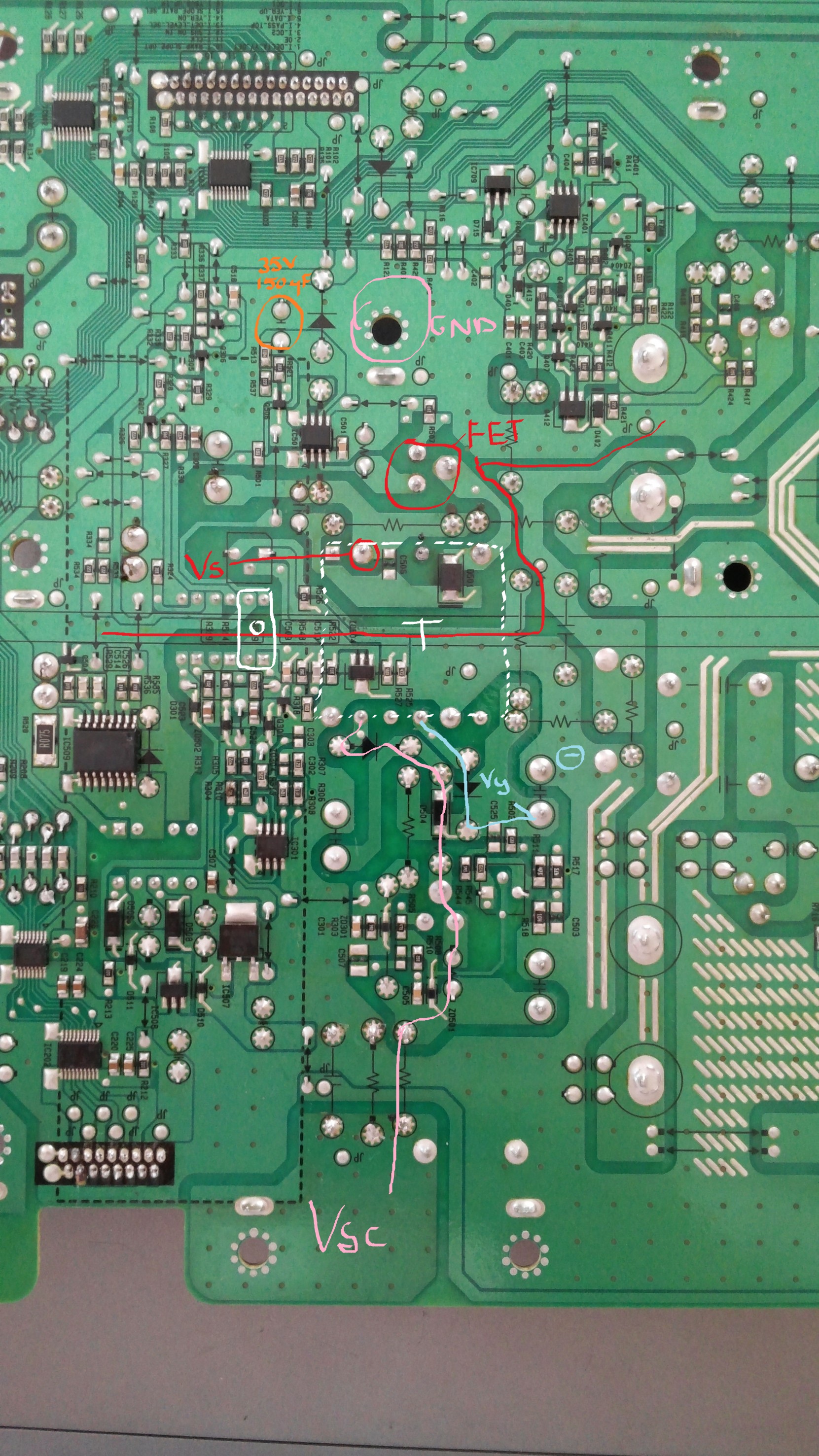

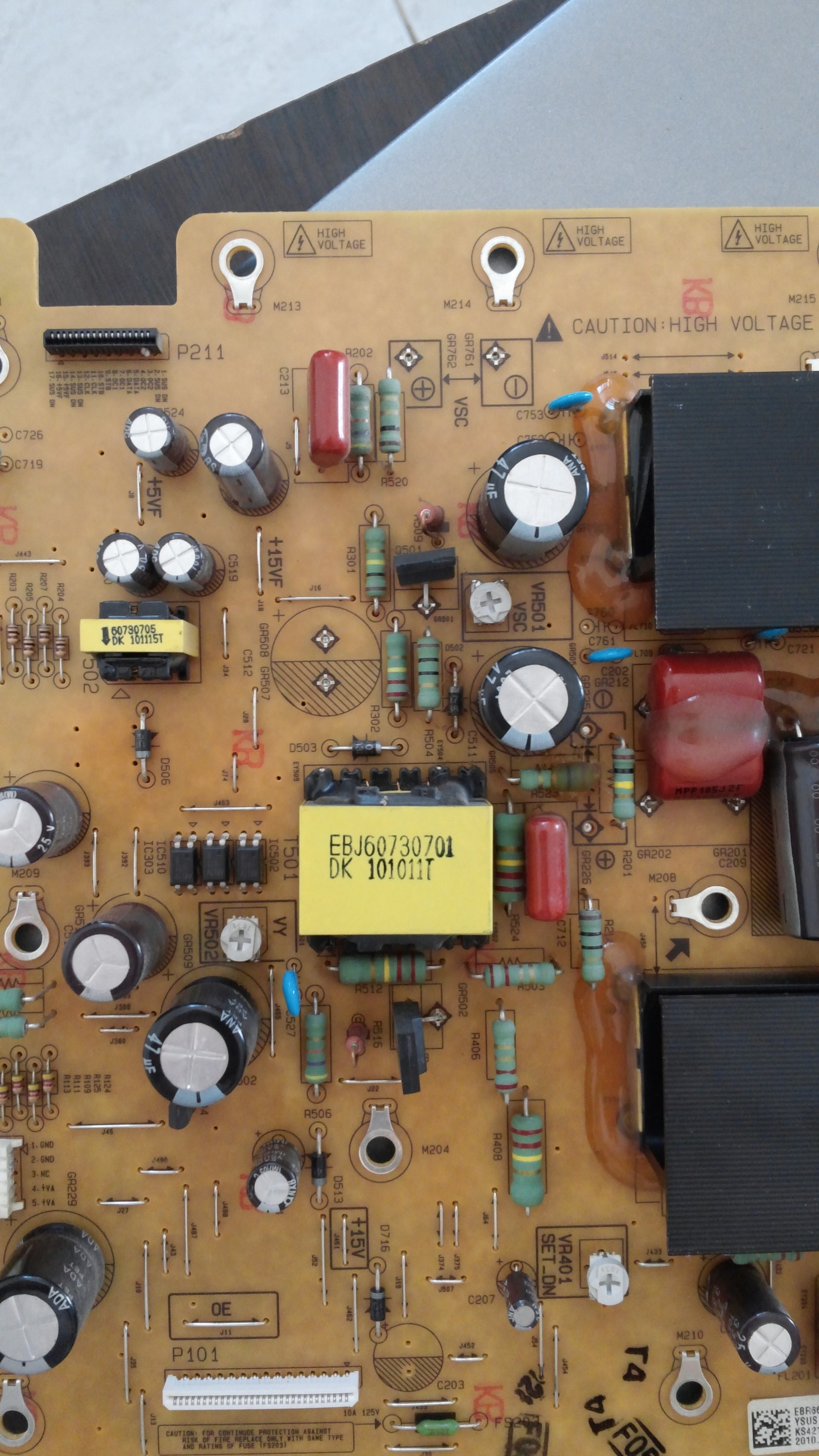

          Today decided to go further. I am inspecting the place of interest, the smps of the Vy.
          Here are some pics. In the last pic i made a small debrief of the components an traces.
            Re: LG 42PJ350-UB Sound, No Pic
            Try checking the YPS FETs (or YPN FETs) if they are shorted the Vsc/-Vy can go down.

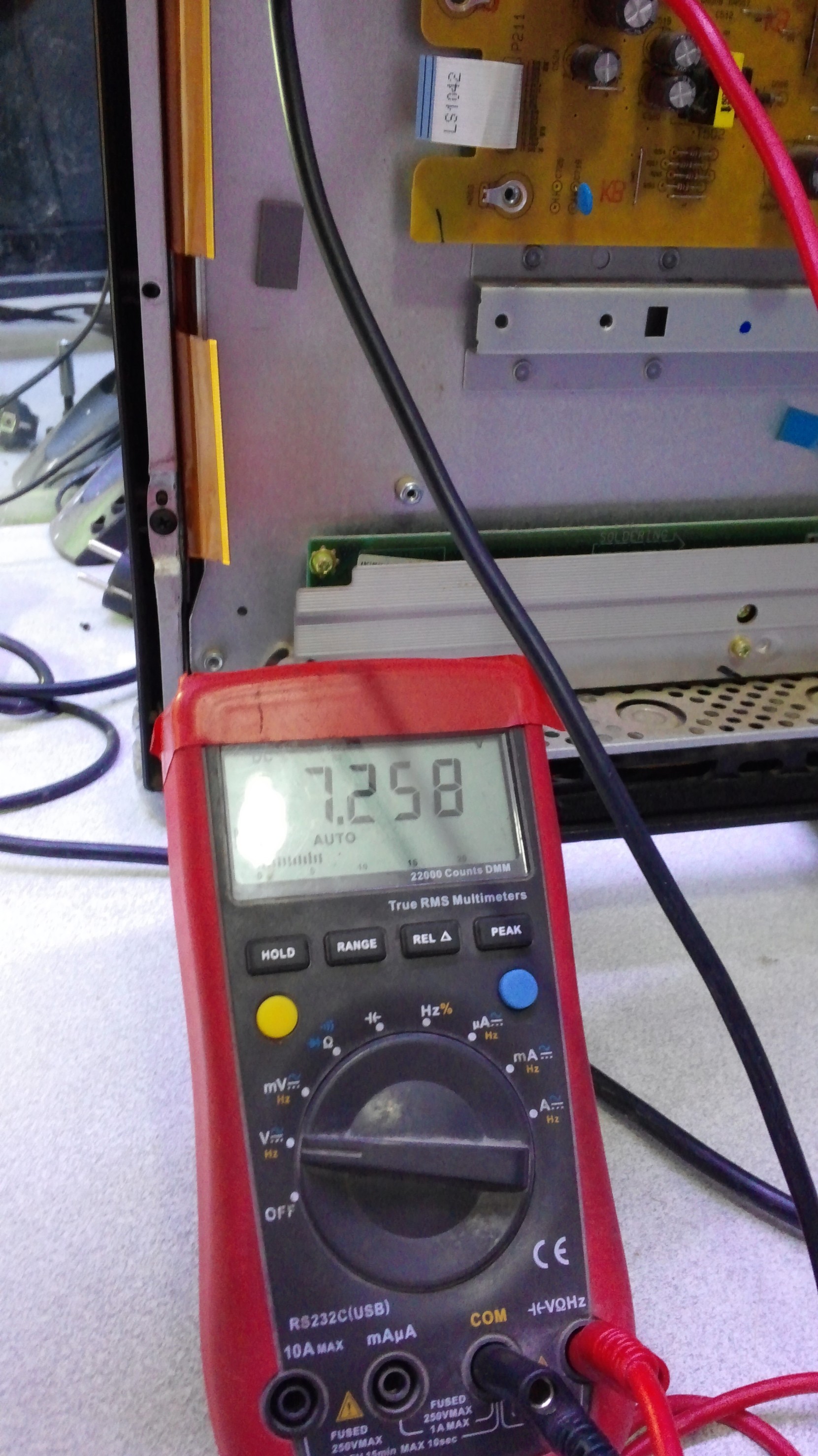

              sorry for the noob question Tom, but which are the YPN/YPS Fets?
              At the moment I am suspecting sth. The voltage at the smps IC capacitor is fluctuating between 6-9 V. The other leg of the diode is steady 18V.
