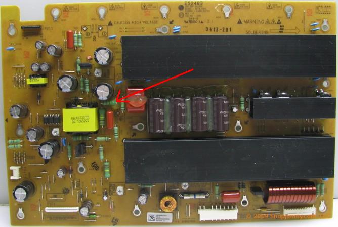

    I haven't found where to test -195V. Good fuse on Y-Sus. Good voltages at Z-Sus. Power comes on and off with power button. Panel does not appear to prime. No buzz, no obvious cracks in panel.

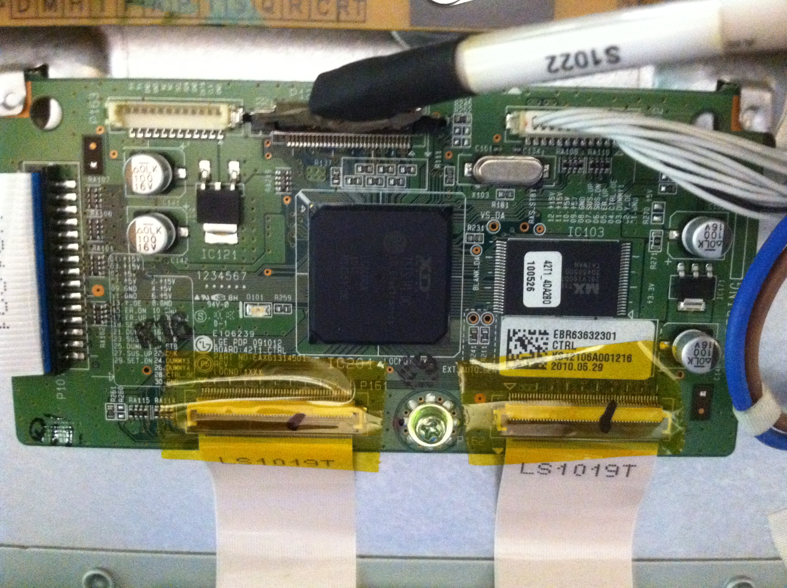

    I disconnected the LVDS cable and used a 219ohm resistor to short EXT and AUTO GEN on the control board. Still no picture.
    I'm thinking Y-Sus. Have any of you had any luck fixing the Y-sus on these?

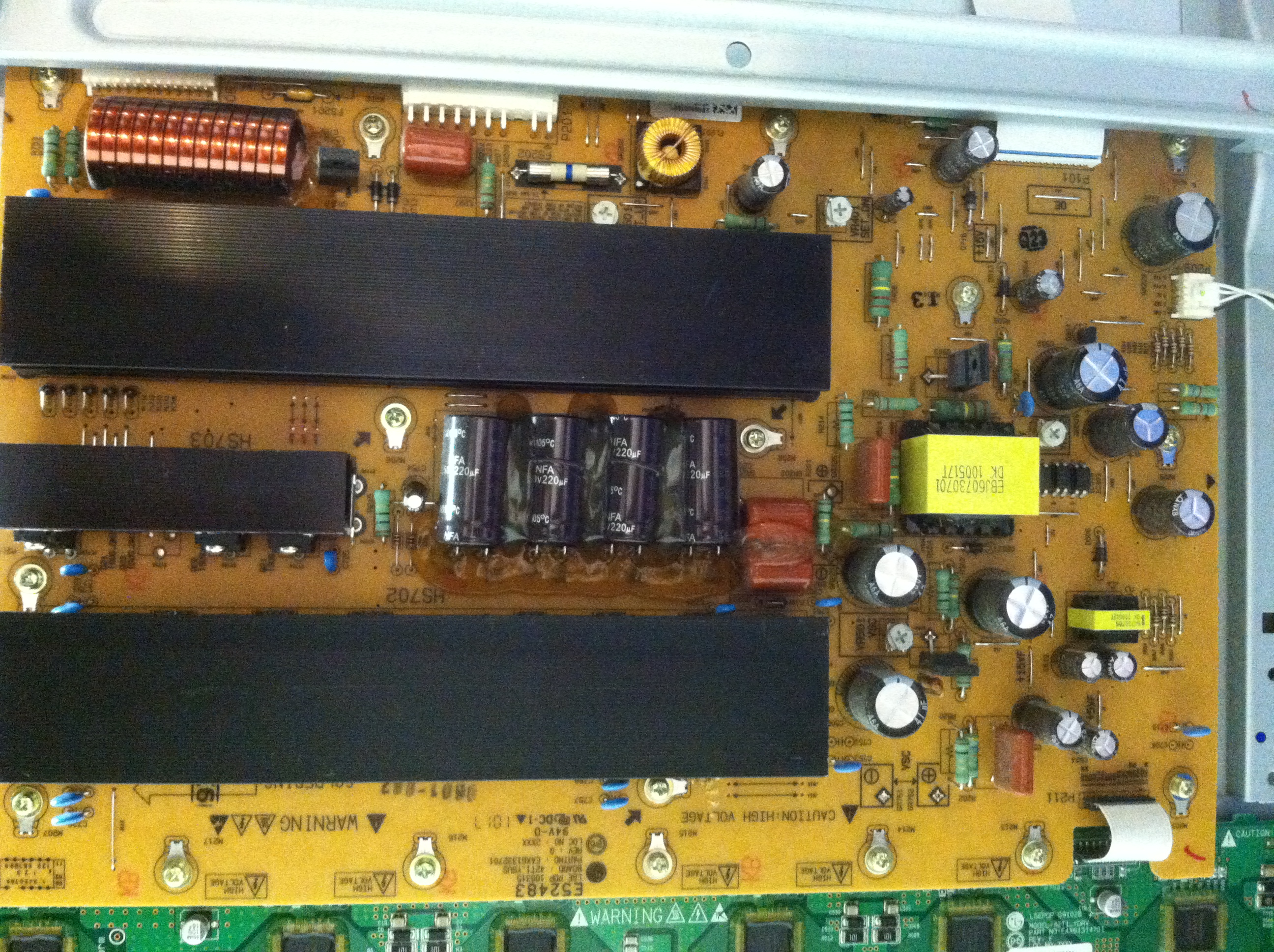

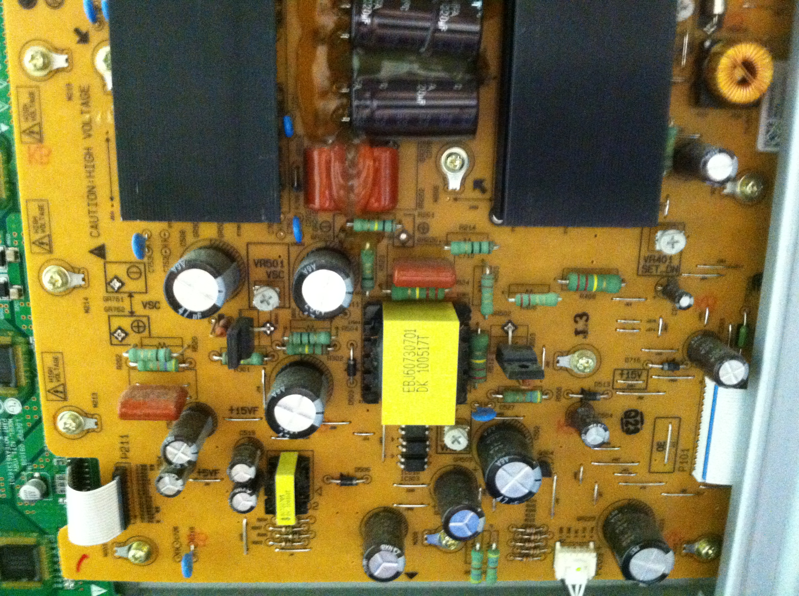

    The -Vy (-195V) test point appears to be located below the row of large caps on the Y-Sus. The "-Vy" label might be covered in silicone.

      For EXT AUTO GEN, a wire jumper works best.

        Bad control board.

                Re: LG 42PJ350-UB Sound, No Pic
                Thanks, i will open it up soon and check those voltages first, can you mark on the control board what 2 i need to jump please
                  Two holes adjacent of the "XD" LG chip: marked EXT AUTO GEN. Just put a wire between them, and disconnect the silver-and-black connector at the top of the board.

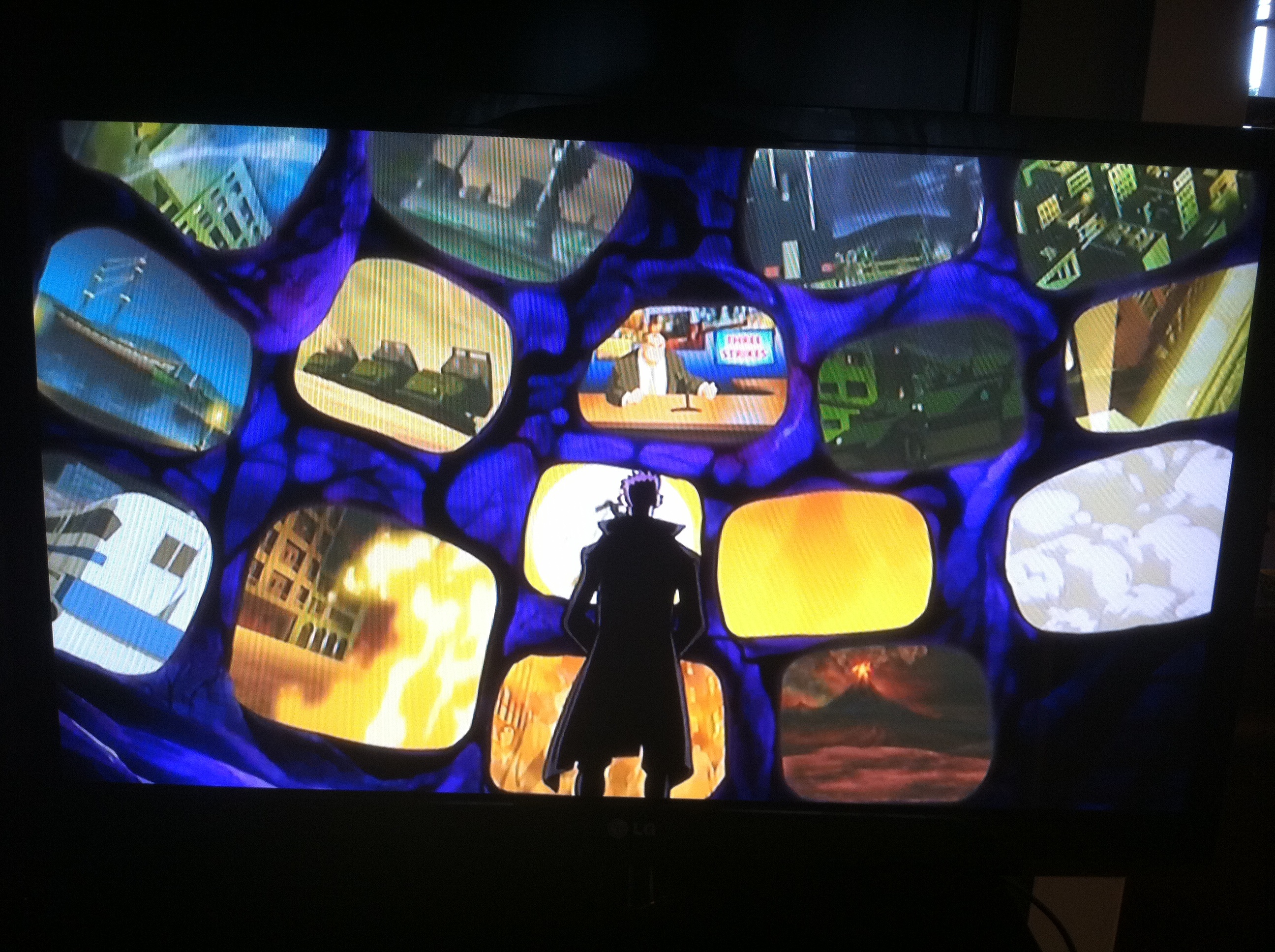

                            I have the same problem on my lg, i check the voltages and i have this:
                            vs - 213v
                            va - 63v
                            vsc - 150v
                            vzb - 120v
                            now, i put a wire on EXT AUTO GEN and 3 images appears but just for 1 seconds
                            1 - http://imageshack.com/a/img838/6903/f319.jpg
                            2 - http://imageshack.com/a/img839/7836/b6dc.jpg
                            3 - http://imageshack.com/a/img854/7278/g7kw.jpg
                            someone knows how fix it?? thanks..

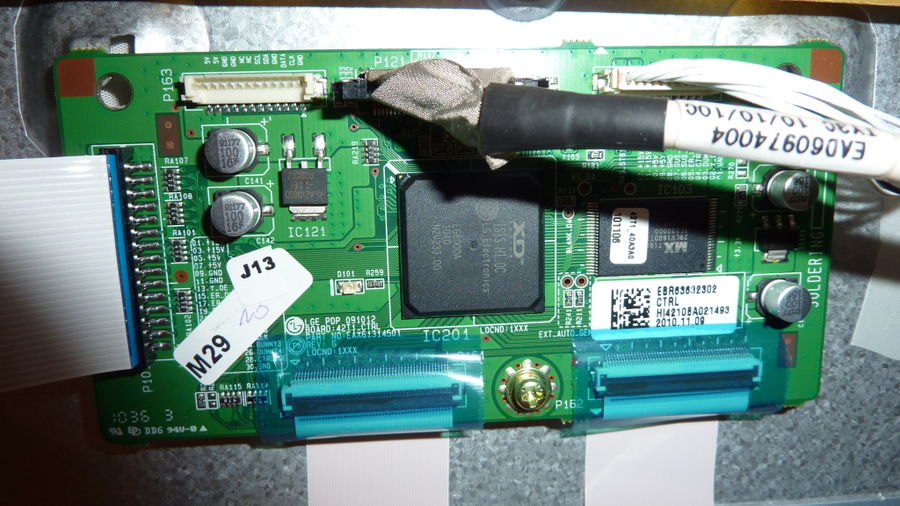

                                    I have no flashes at all on the CTRL board although the voltages to it appear to be fine also the onboard regulators are working and giving out 3.3v & 1.2v as would be expected.
                                    I have linked Stby with RL_ON and M_ON at the mainboard with 220R resistors in order to make the screen glow but to no avail. I still get no buzz or glow.
                                    I scoped J43 on the ZSUS board labelled "ZSUS_Waveform" for all I don't know what to expect here I get a pretty constant 17.75volts and no waveform.
                                    From the above, I am almost sure PSU, Mainboard (Computer) and YSUS/buffers are all ok.
                                    Can anybody add anything I can test here to confirm my suspicions of CTRL board faulty or ZSUS board. I can't be sure which it is.
