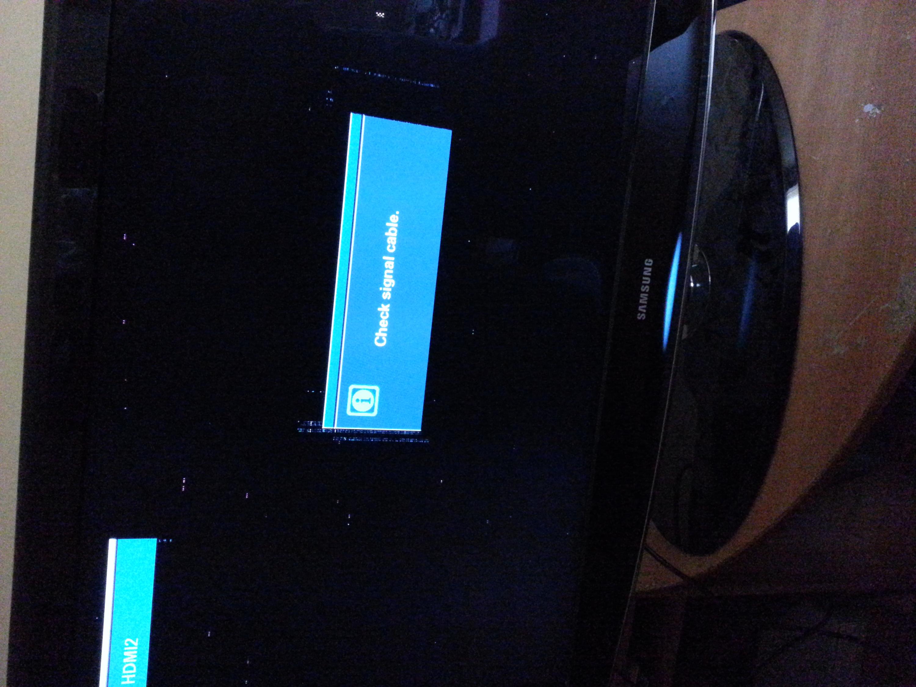

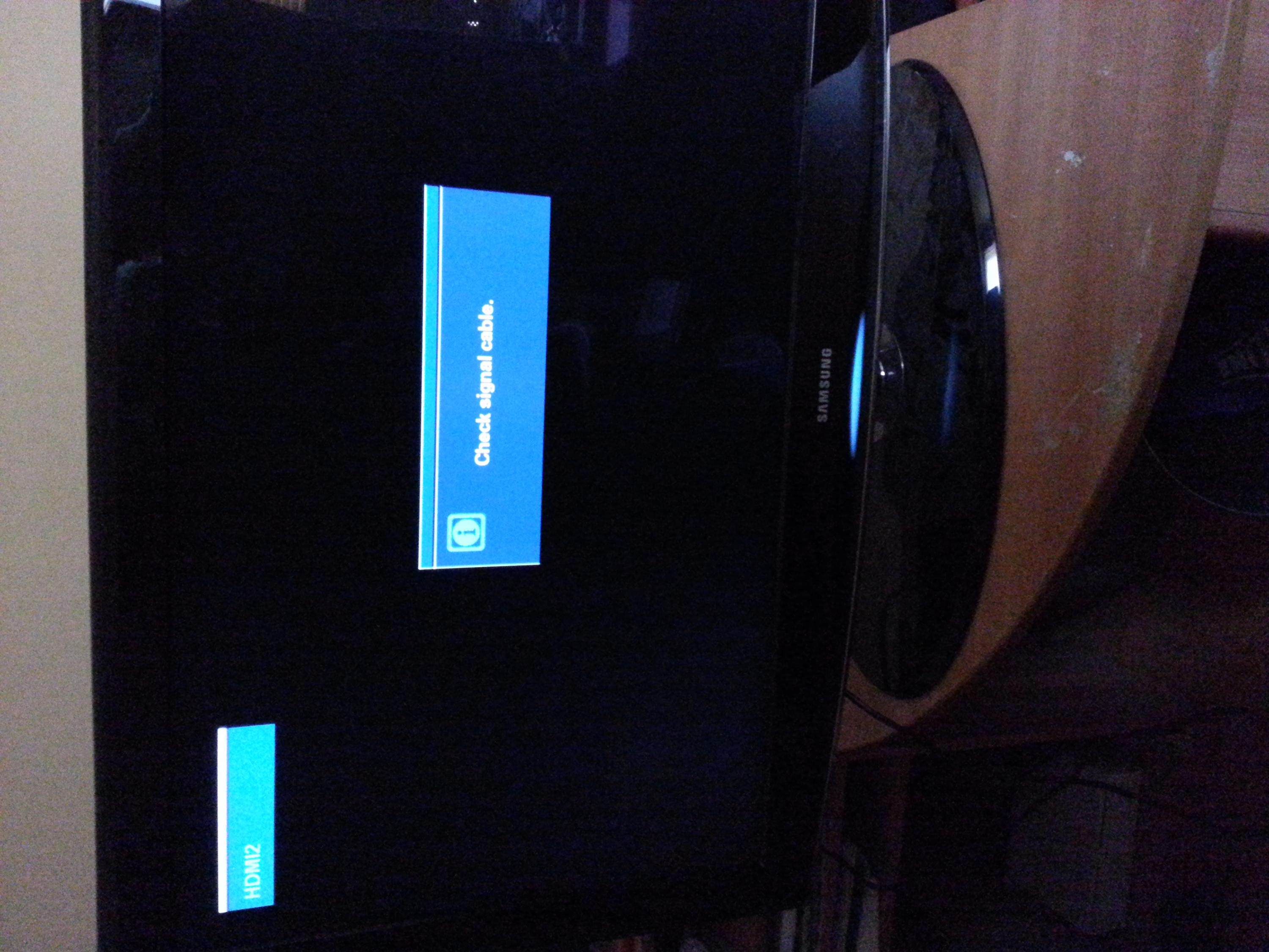

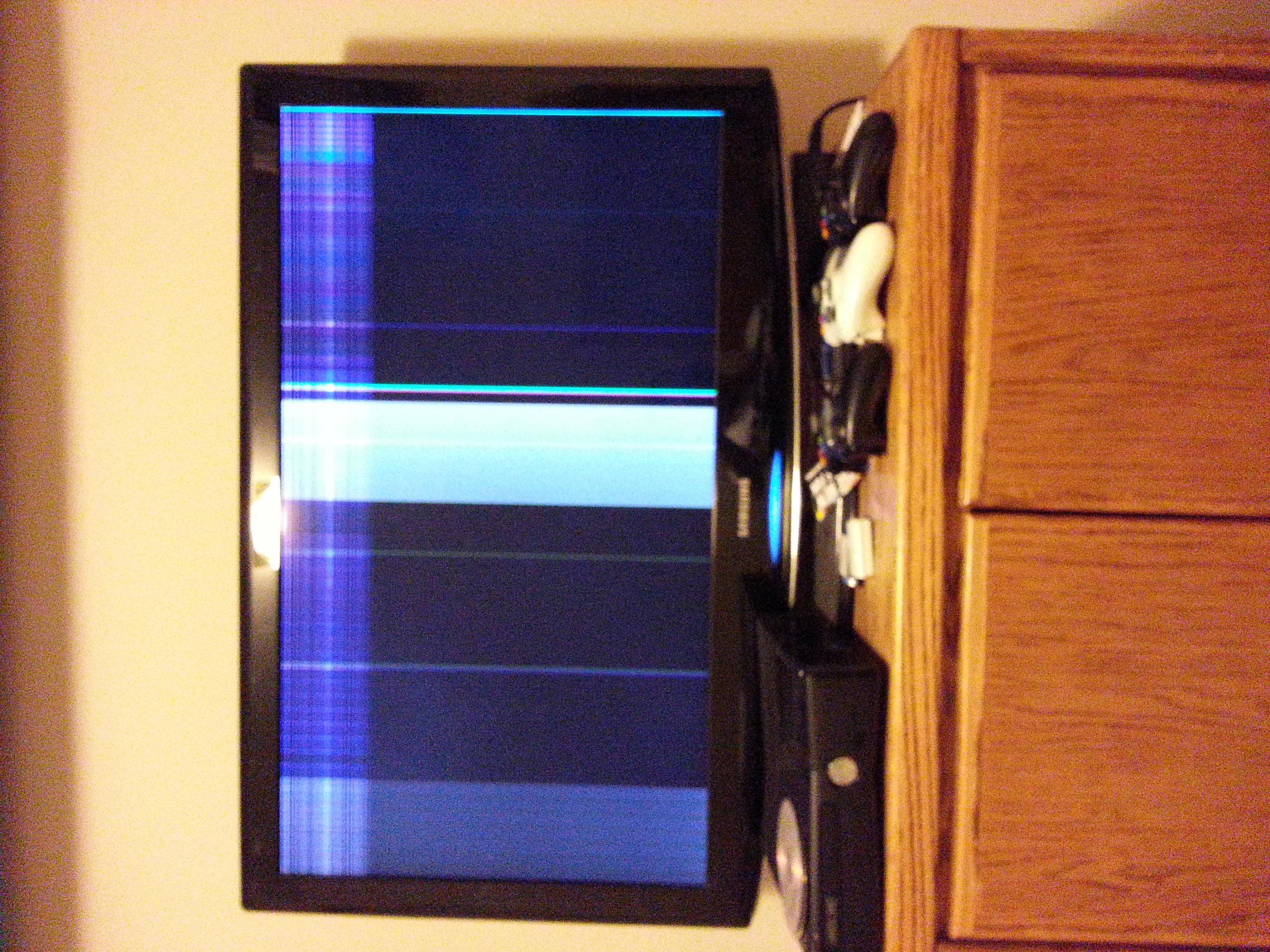

    Here are the issues I am having which is a 3-4 step process for the tv to have perfect display
    When I first power on the tv I get all these wonderful colors on the screen like I am on some drug
    Pleas see first 2 pics
    I have to let the tv "warm up" for about 3-5 minutes
    Then I turn it off for 1-2 minutes

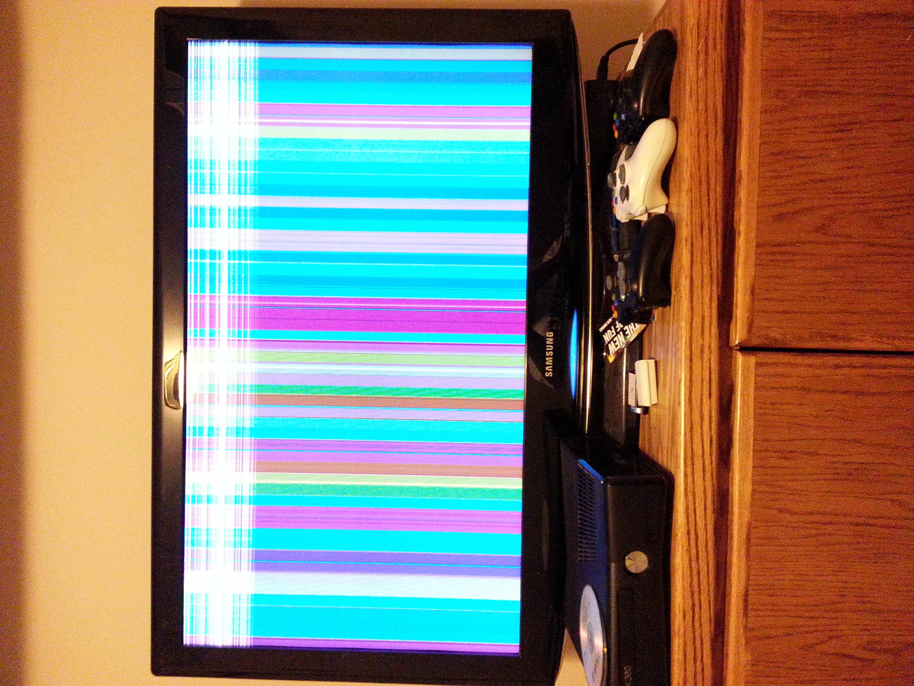

    I power it back on then the colors are gone but you can still see some of the pixels are off color
    See 3rd pic
    Then I have to turn off tv for another 2-3 minutes

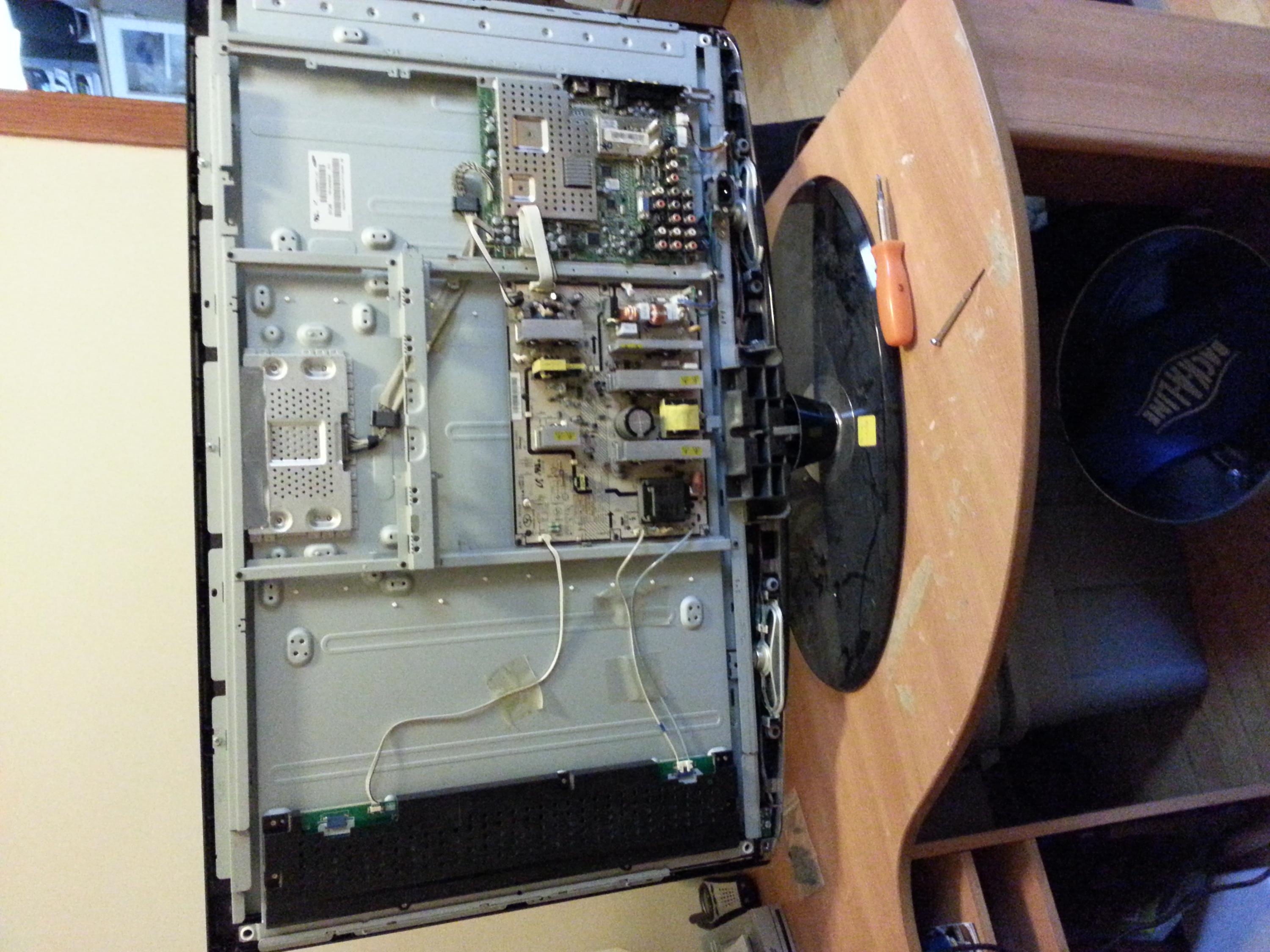

    At this point I power on the tv and the display is perfect with no rainbow colors or pixels
    Please see 4th pic
    I really don't care about the process it takes to turn on since its my sons tv but I would like to fix it

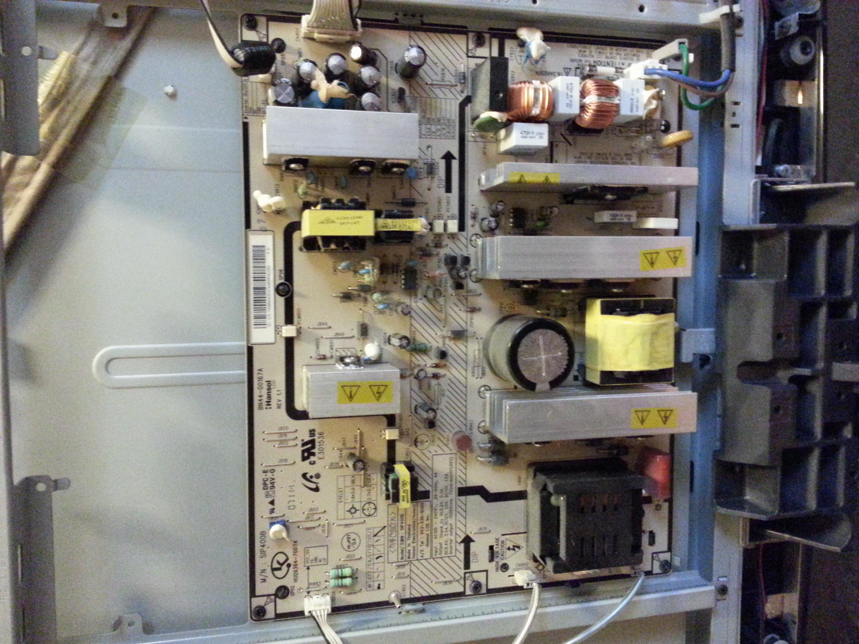

    I took apart the cover and found some blown caps on the power supply
    I ordered the caps hopefully I get them on Monday
    But I dont think the caps are causing the rainbow colors I think its a bad tcon board but its just a guess
    Thanks for the help

    Sorry for the angle of the pics
    When I upload them to this site they get turned on an angle for some reason

      It could be the t-con, but you'll obviously know better after the caps are changed.

        I forgot to mention that the rainbow colors do NOT come back when the tv is on
        My son can be playing xbox for hours and the colors do NOT come back
        Only after the tv has been off for more than an hour the colors come back
          Re: samsung LN-T4066F rainbow colors on screen
          Bad capacitors can cause this issue, so I would definitely change them for Panasonic FR/FM/FC before doing any other diagnosis.

              Just recently repaired this model TV. Sometimes it would not turn on and or give a colored screen. Changing the capacitors fixed the issue.

                Yes tom66 and glitcher is correct
                it was the caps
                I replaced all 8 and now the tv works perfectly
                Thanks for all the help
