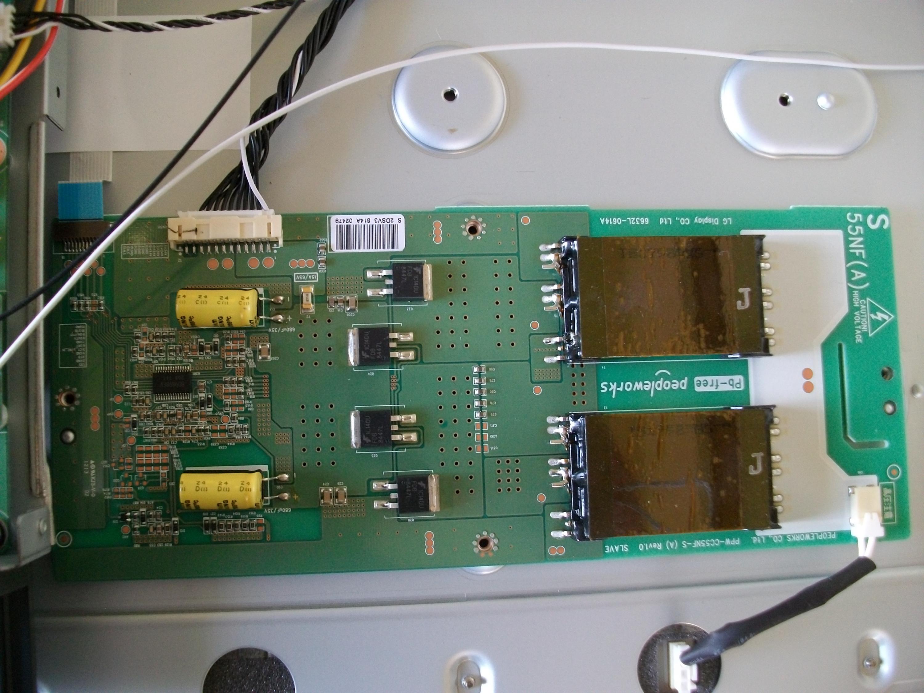

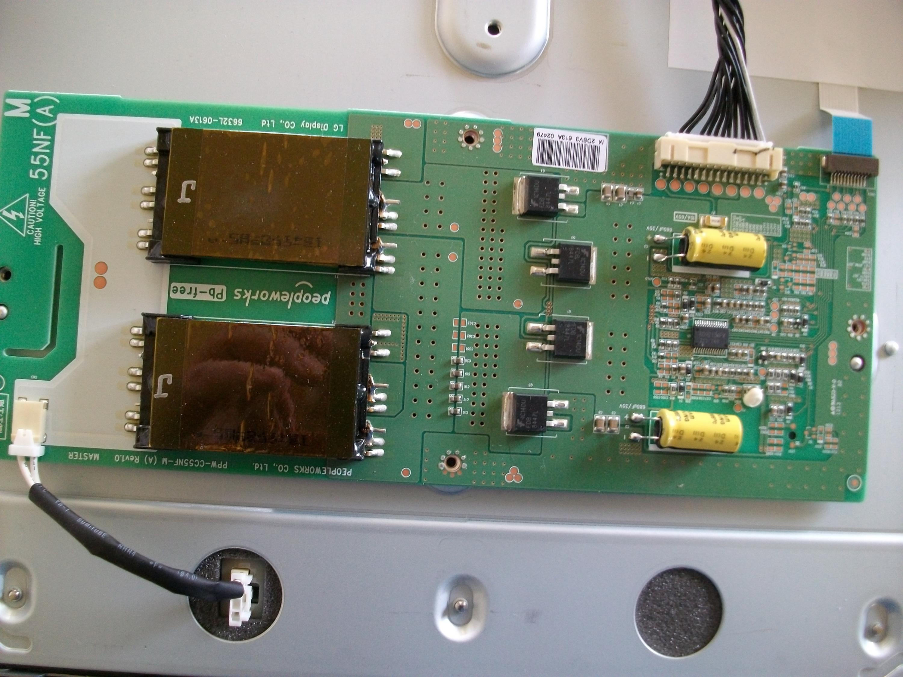

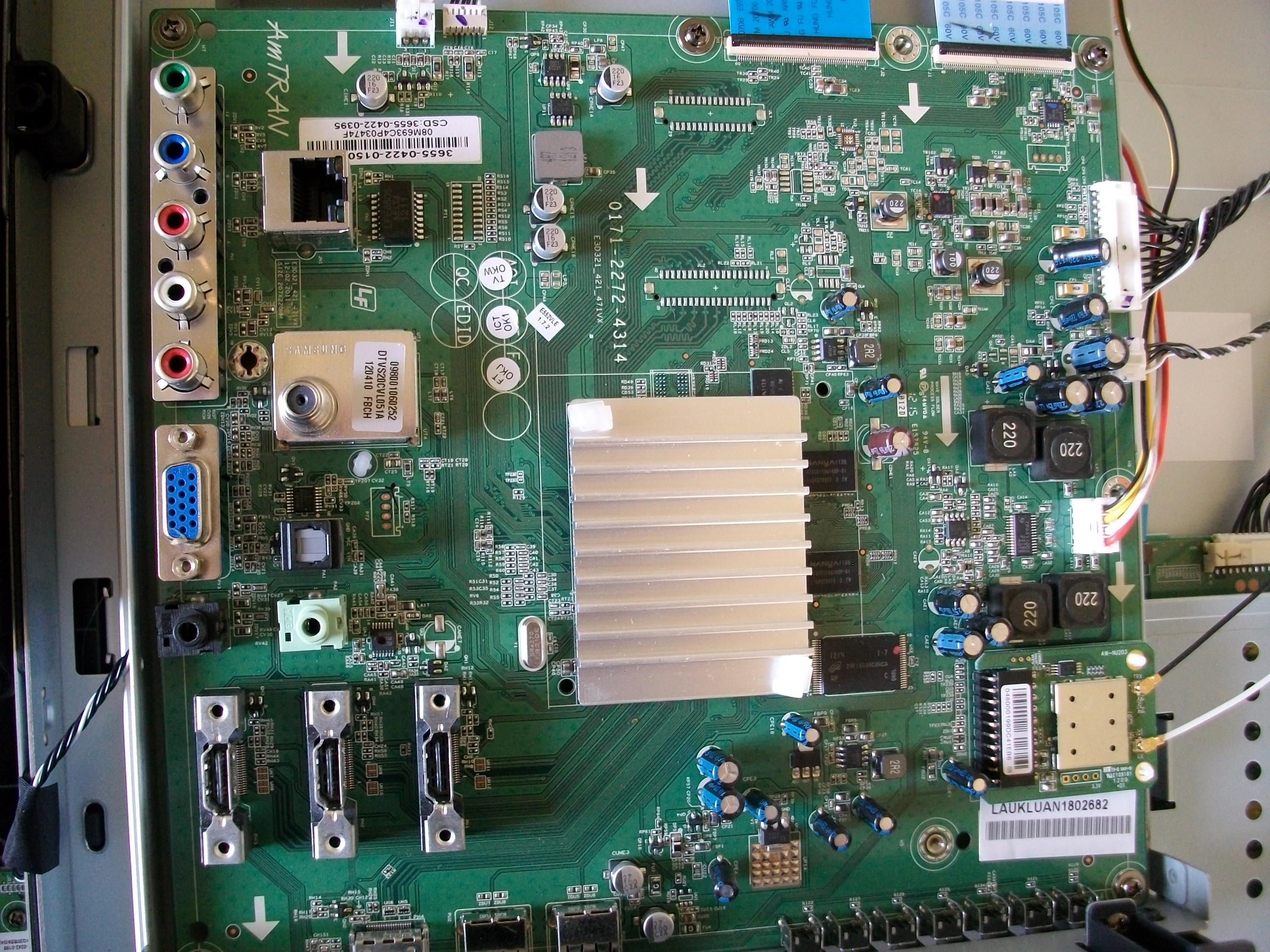

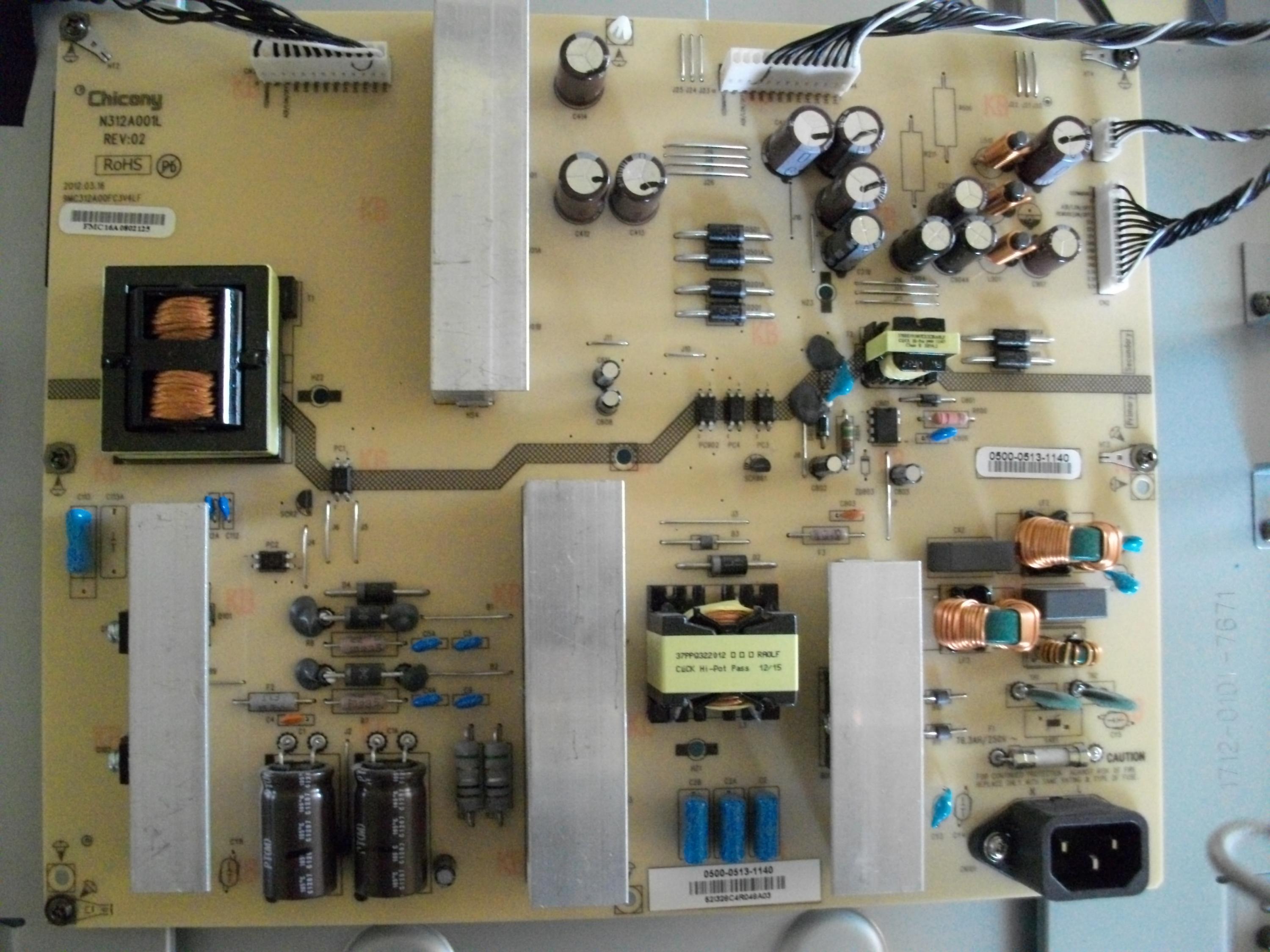

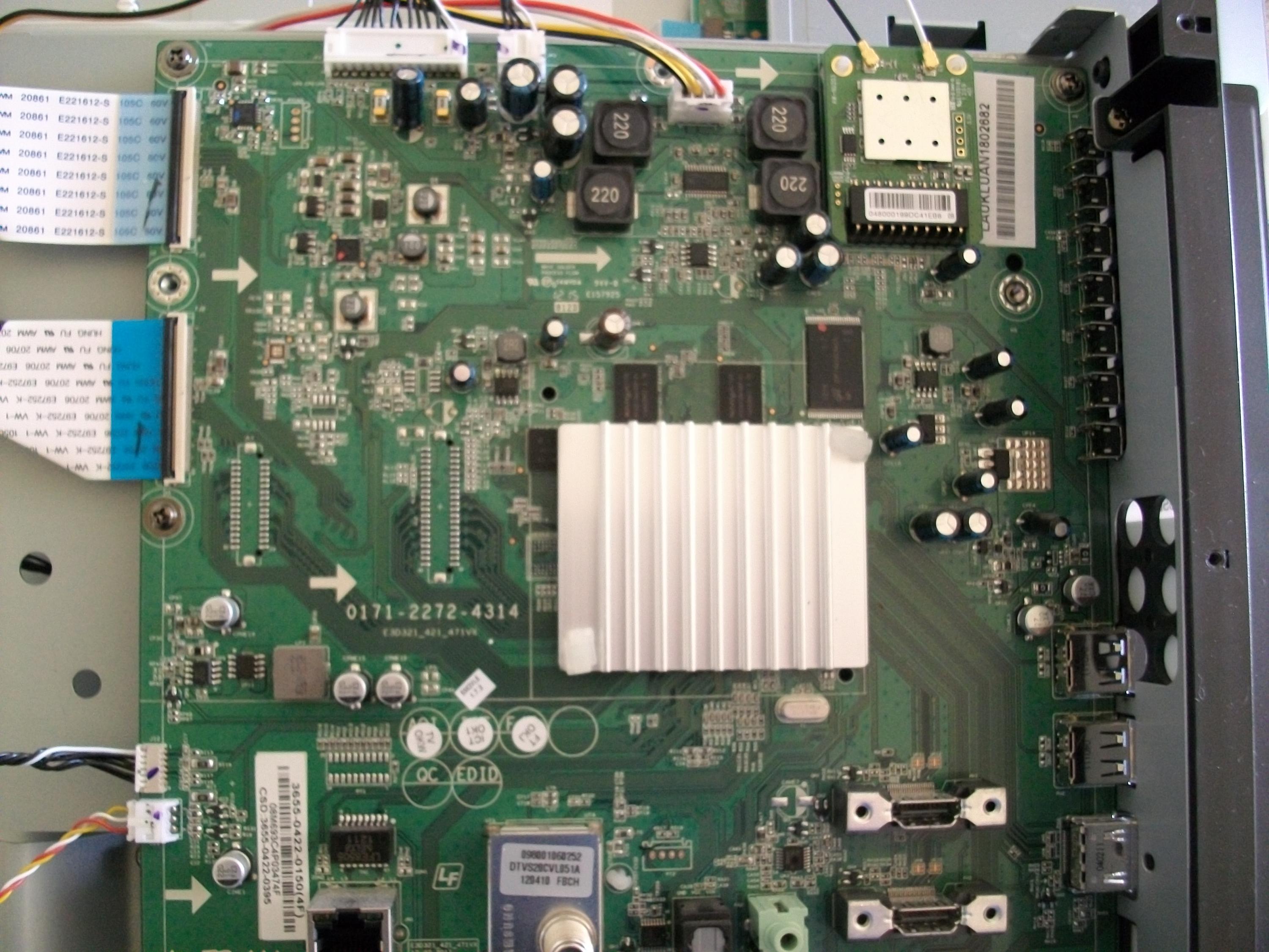

Well have another for you guys. Here's the history. The guy I got this from said it is only 8 months old. He said it just stopped working.They had a repair guy come out wanted 250.00 to repair.Here's what it's doing. plug into outlet orange vizio light comes on.Press power button vizio light turns white,then get vizio slash screen for a second then goes off and back to white vizio light.white vizio flashes once and when goes back to orange vizio light. it does this every time you hit the power button. no other buttons work menu,av etc. Only have 5.v no 12v 18v or 24 volt I have read the threads on this matter for other tv's some say main board others say PSB or inverter. Hope you guys can help sort this out. this is a nice tv.I will post pictures

Since you have backlight even briefly, you -will- have 24V. You need to check if it is stable or not.Please do not PM me with questions! Questions via PM will not be answered. Post on the forums instead!

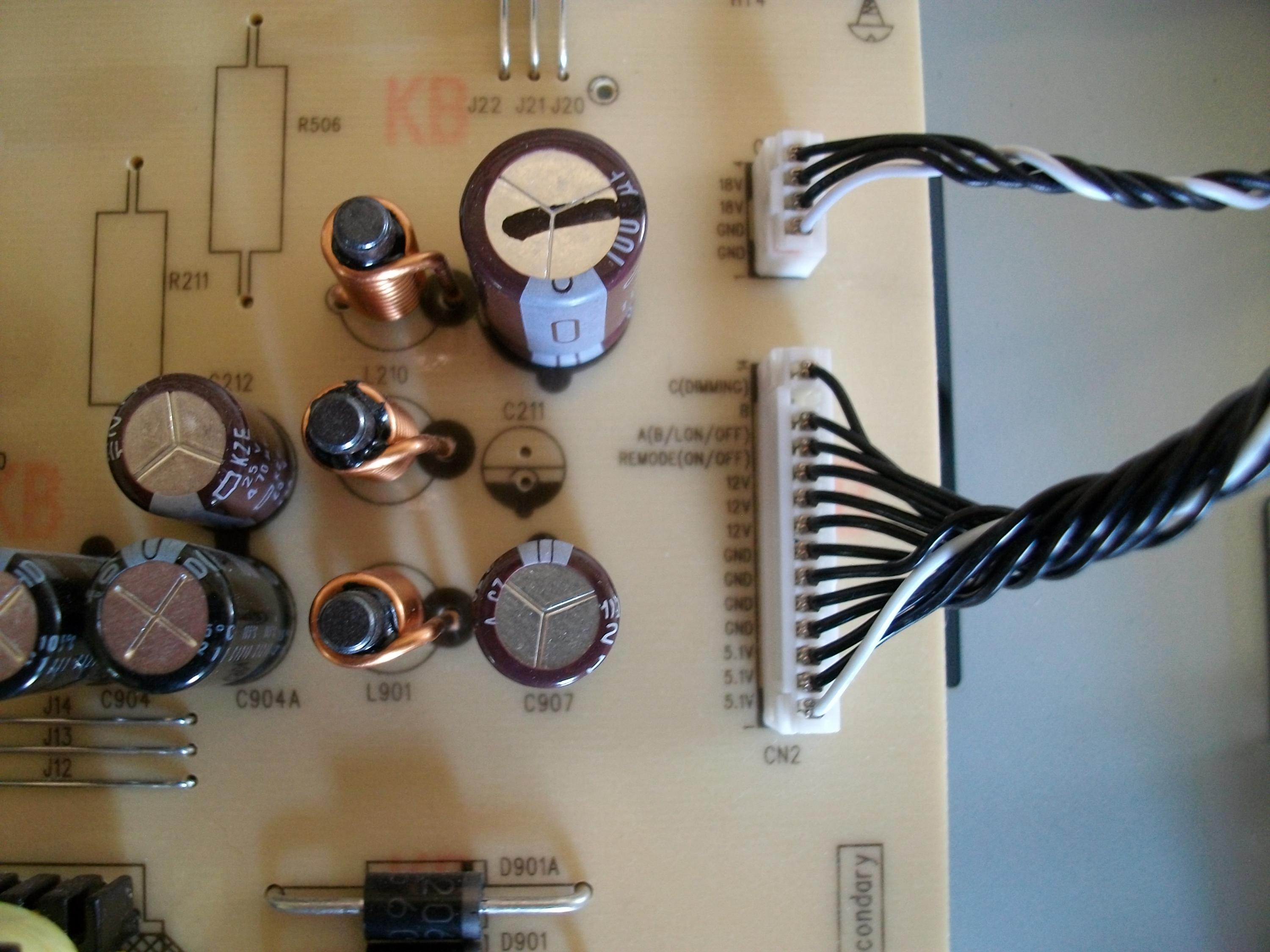

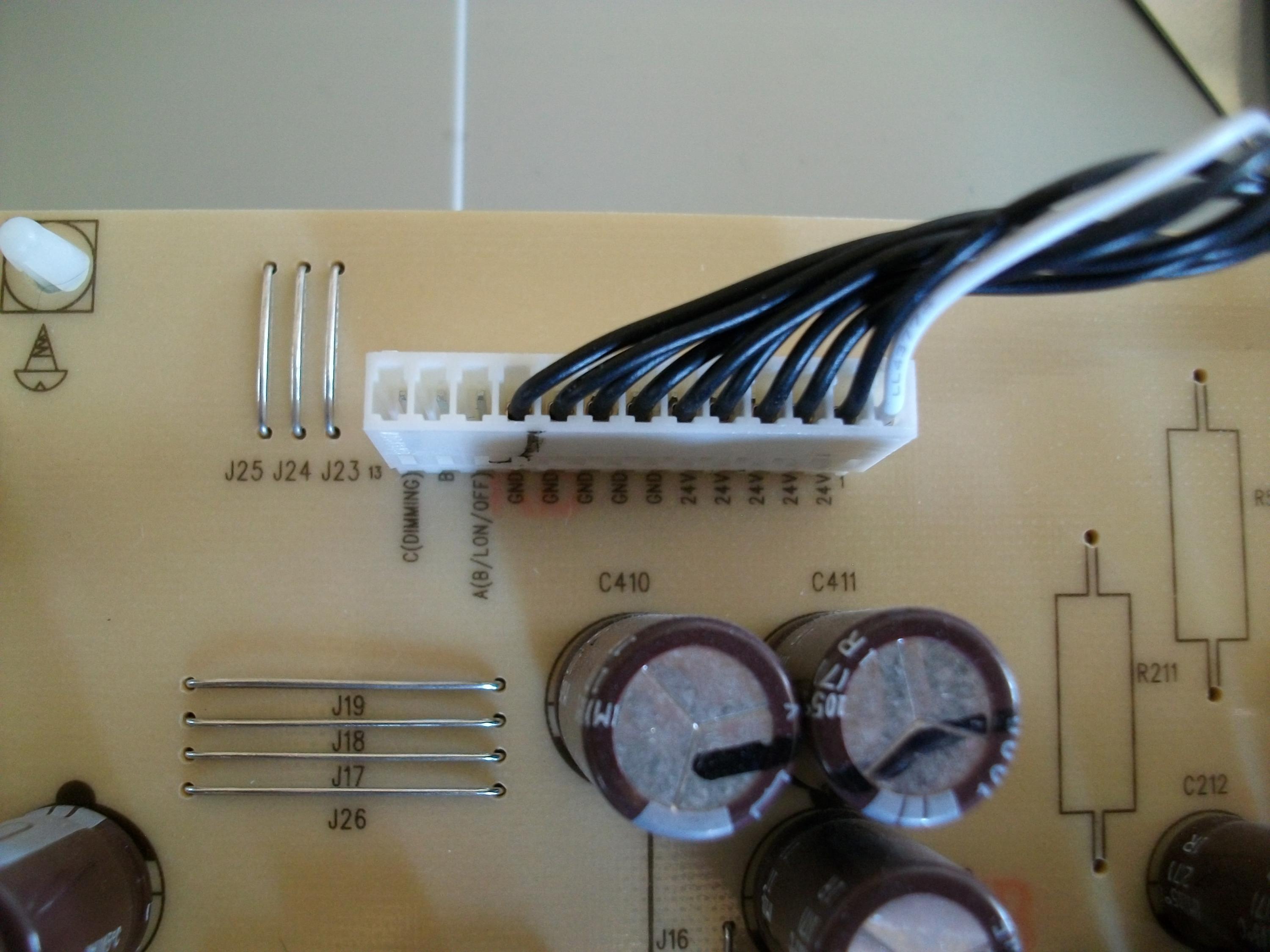

Tom66, I checked 24v on power board at CN4 all the black wires read o.o but there is a white wire that's labeled 24v and it is not stable it is reading 0 volts to 30 volts and it just keeps cycling from 0v to 30vComment

OK. Next step. Locate the PSON line and see if that is stable.Please do not PM me with questions! Questions via PM will not be answered. Post on the forums instead!
For service manual, schematic, boardview (board view), datasheet, cad - use our search.Comment
Re: Vizio E552VLE turns on then off
Hmm... Odd labelling... I think it is REMODE. A possible typo from REMOTE, sometimes what PSON is called.Please do not PM me with questions! Questions via PM will not be answered. Post on the forums instead!

Mkay, you're probably looking at a main board fault.Please do not PM me with questions! Questions via PM will not be answered. Post on the forums instead!
