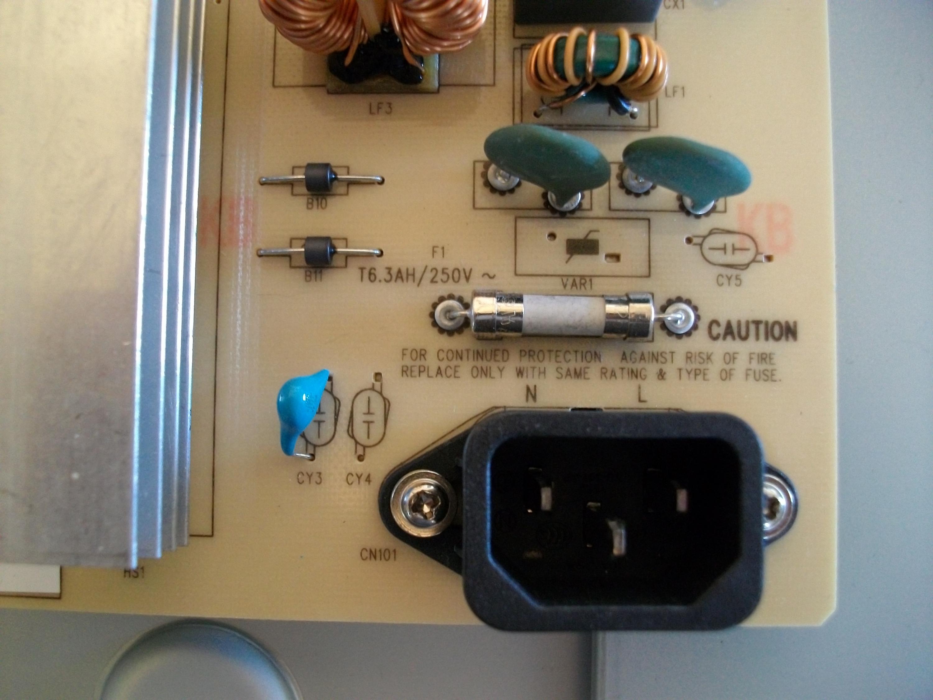

                      That most likely is the best thing to do tom66. Tom66 I messed up when testing the voltage regulators I touched the DMM probes together and blew the fuse on the power board. It is a T6.3AH/250 fuse it has the pigtail soldered to the PSB . where can I find the fuse with the pigtail . I found some on line but no pigtail

                              It' not a SMD, it' a ceramic fuse with silver caps,see picture

                                5mm x 20mm fuses are common but how did you blow that testing voltage regulators?? Even a short on the secondary would not blow the fuse.

                                  I was testing the voltage regulator with DMM and I touched the probes or pins together and it poped and I guess blew the fuse. I was testing the outlet pin.Where can I find the fuse with the wire on it like the picture ?

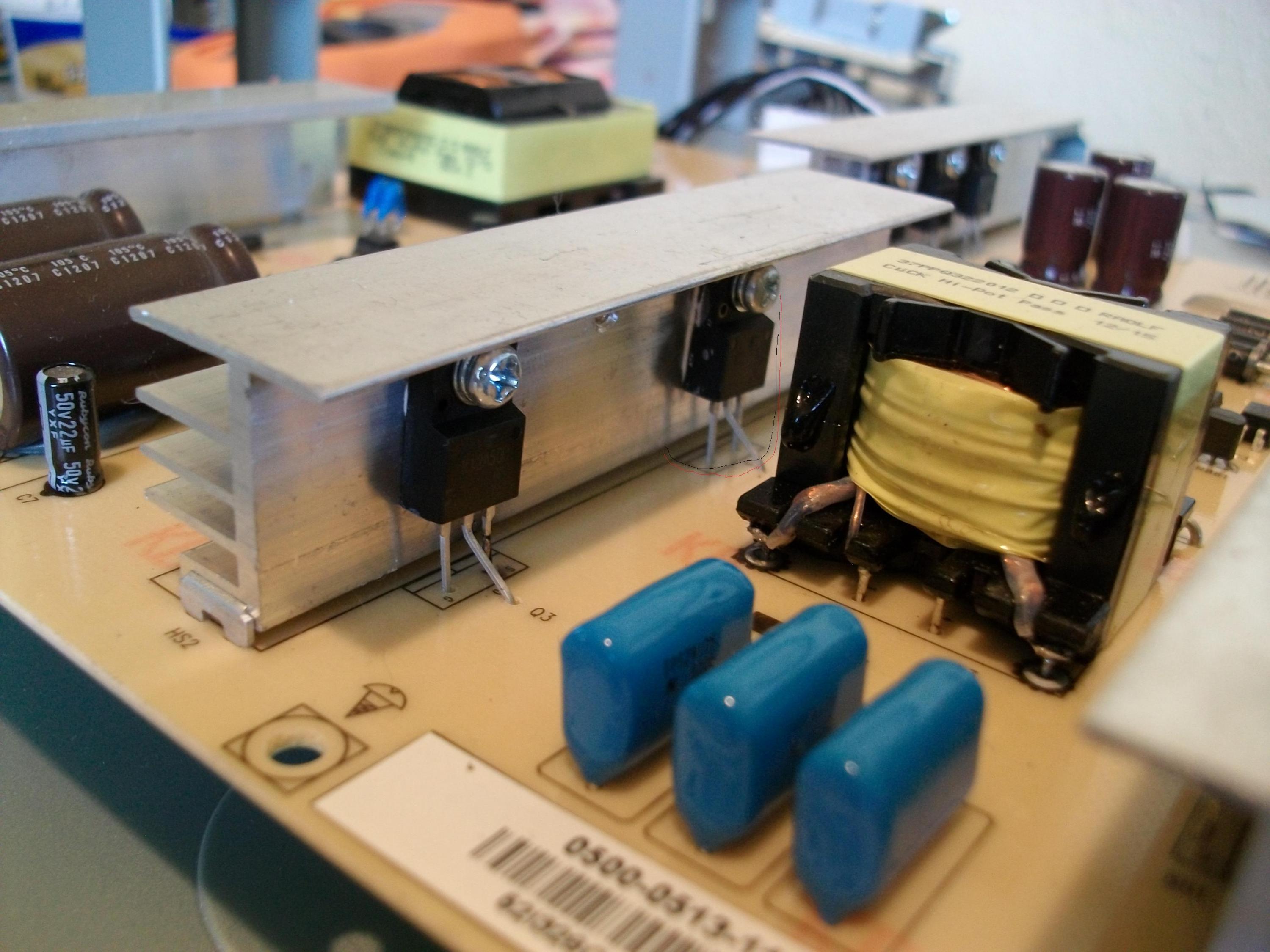

                                    Which voltage regulator? Can you highlight it on one of your pictures? More damage may have been done if the fuse popped.

                                      It,s the first one left of the blue things marked 03 in the front

                                        Huh? Highlight it please.

                                          Here,s the picture
