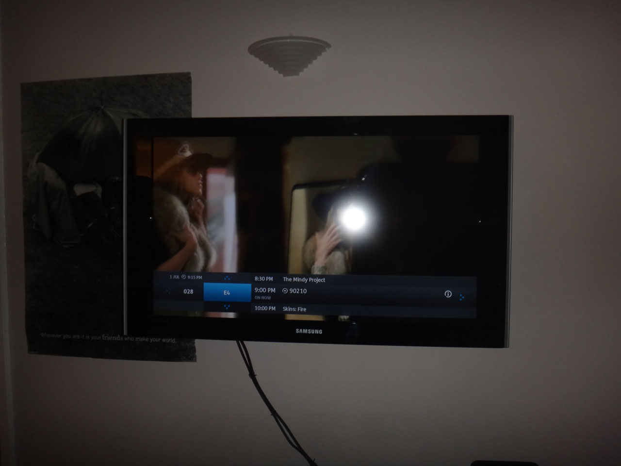

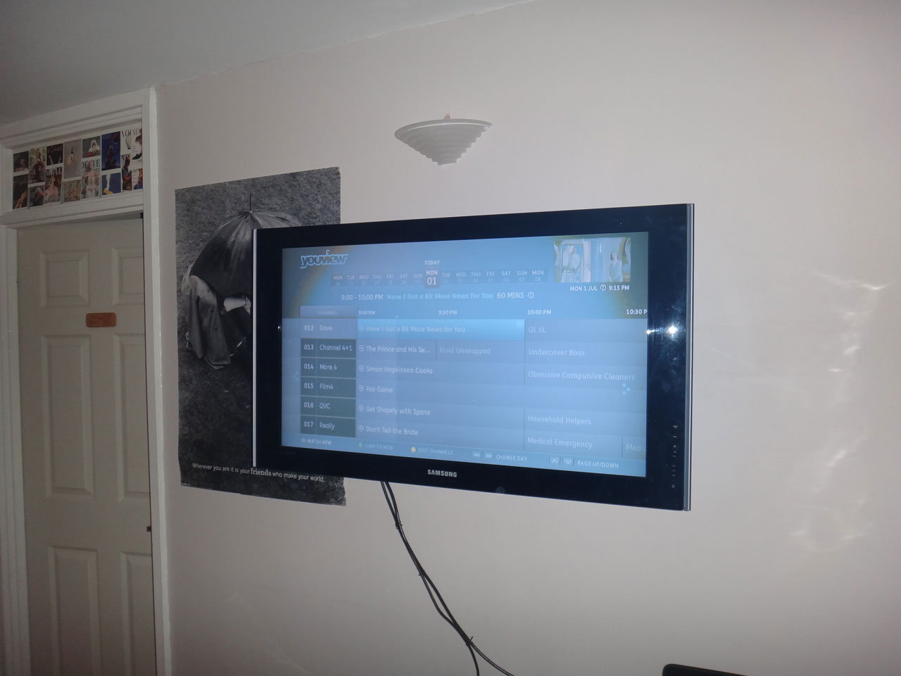

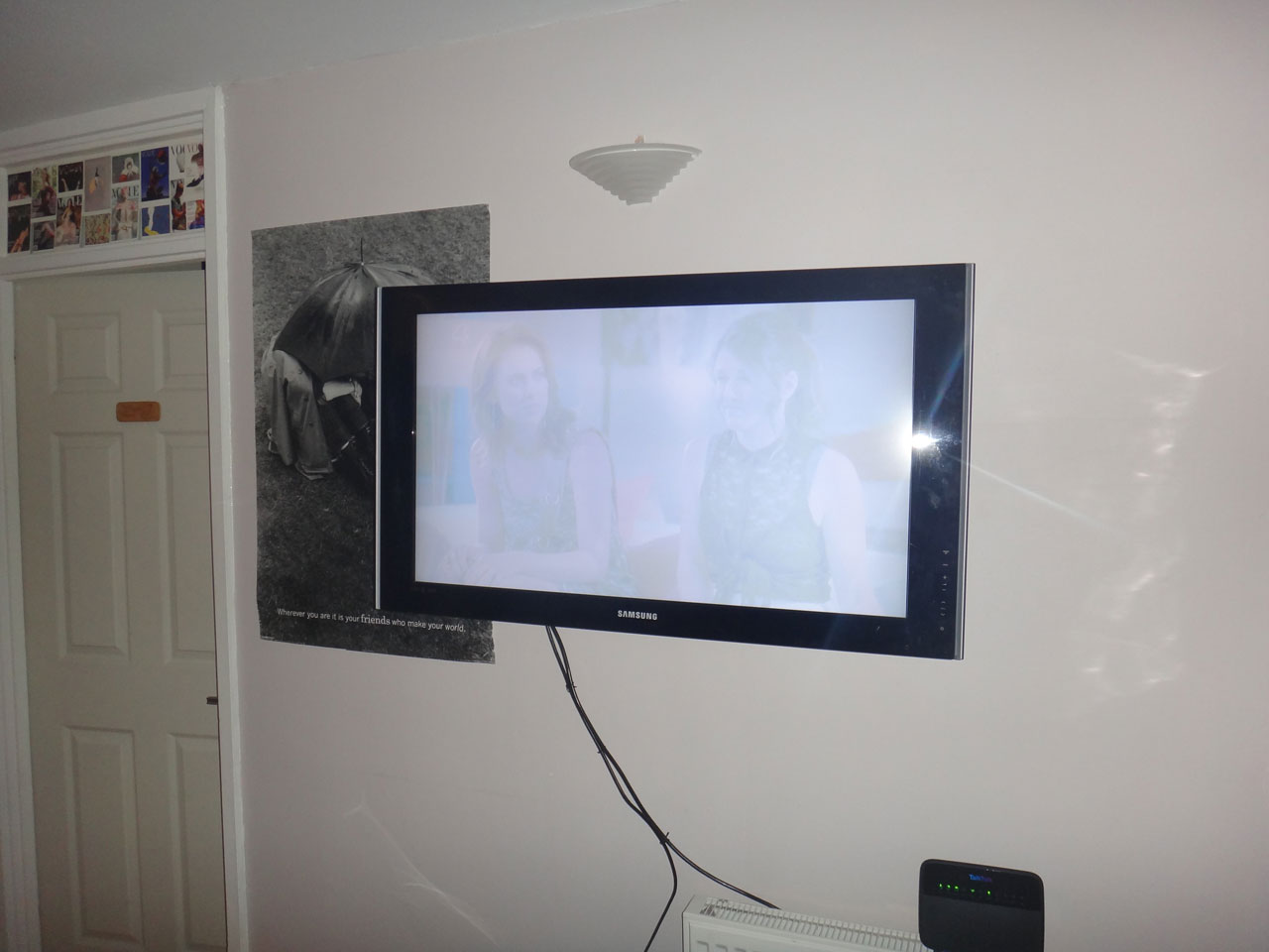

    Pictures of the TV doing its thing. First pic is as booted, second is after about 3 minutes, third is after 5 minutes

                        So the new T-con board arrived (The number on the barcode was slightly different) but both the numbers on the board itself were the same. Either way, i had nothing to lose so plugged it in and SUCCESS!!
                        TV booted up without a hitch and no longer fades to white! I am fairly sure it was down to that AS15 chip on the original board but it seems a new Tcon board has saved this one from the skip... at least for a little longer.
