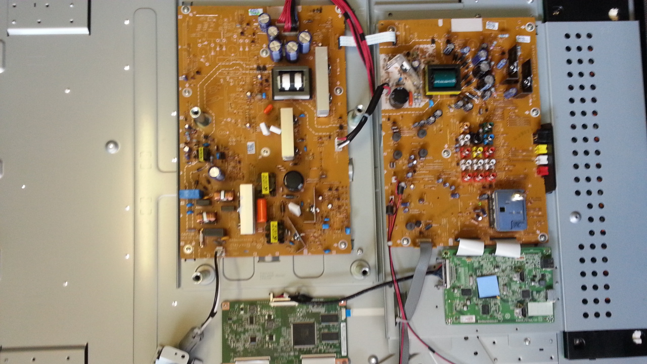

    Hi everyone I have a Phillips 42PFL3704D/F7 with no picture. backlight is working. I hear the " tick " when I turn the set on and backlight kicks in just no picture. seems like theres a " blue glow" on screen...but im not 100% sure. I only tested power to power " jack " board getting 11v ac on the 3 pins. any ideas were I should look next?

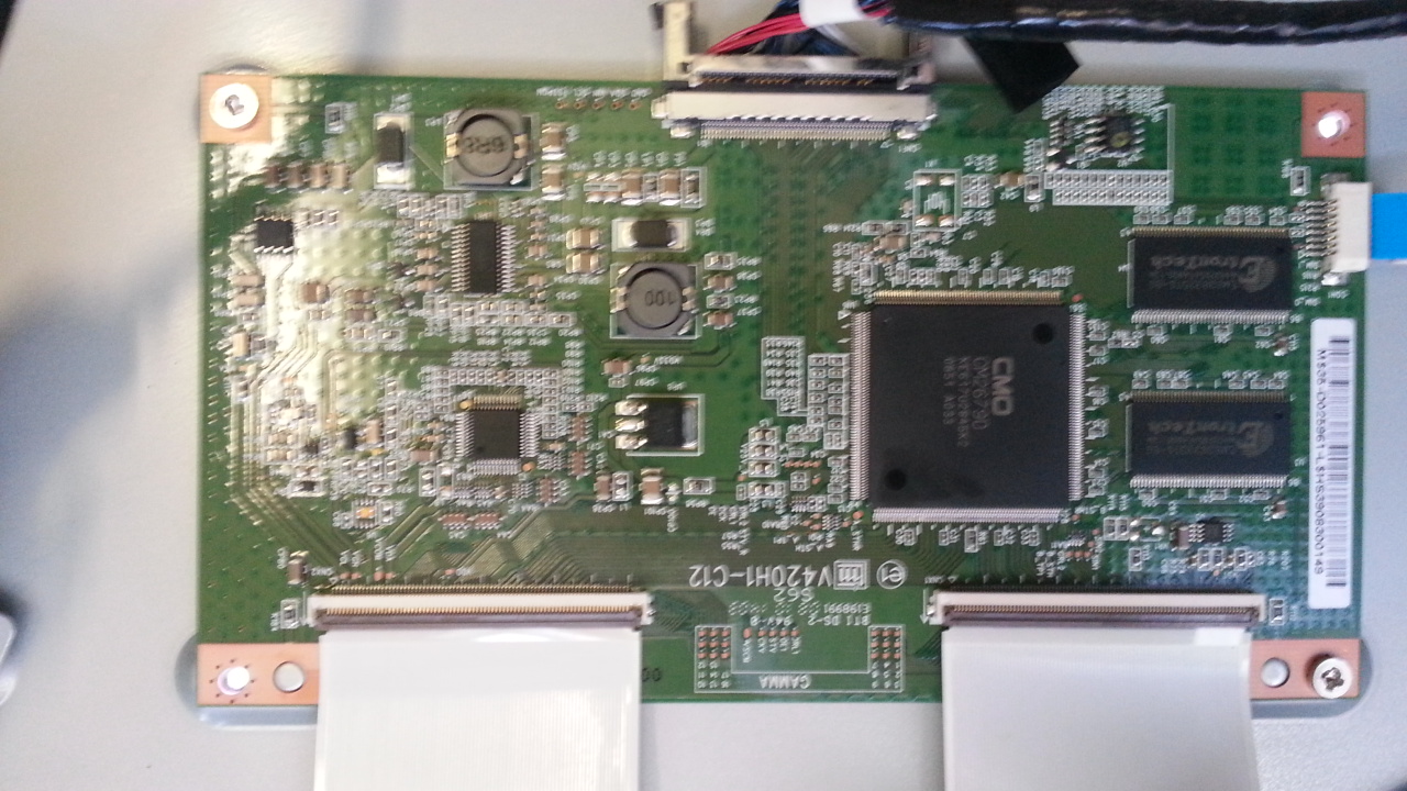

    Check for possible open smd fuse(FP1) on your T-con board located just above and right of your lvds cable which is black cable routing from digital/main board to T-con

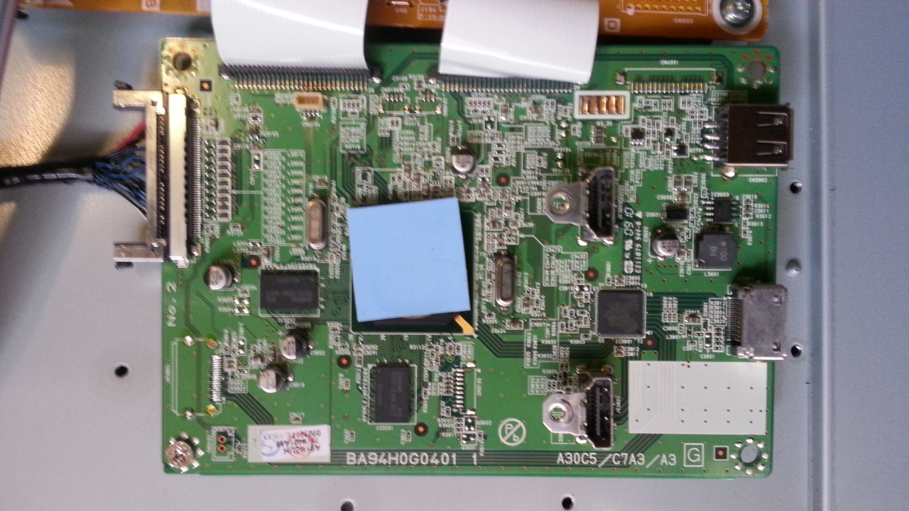

                    the back lights are working! I do not see a logo at all on the screen. there is kind of a faint blue glow to it. unfortunately I don't have a oscilloscope to test any further. I think I'll go ahead and order a new digital main since its pretty cheap.
                    • TimT
                      • Nov 2012
                      • 268
                      • us
                      Re: PHILIPS 42PFL3704D/F7 no picture
                      Replaced digital main still no picture. would a bad T-con cause no sound?

                            im going have say bad T-con when you first turn set on the Philips logo must come up this is control via the digital/main to the T-con. You've indicated your not seeing the logo but you have backlights with glow on screen,you've also confirm smd fuse on t-con good and have 12 volts dc on both sides

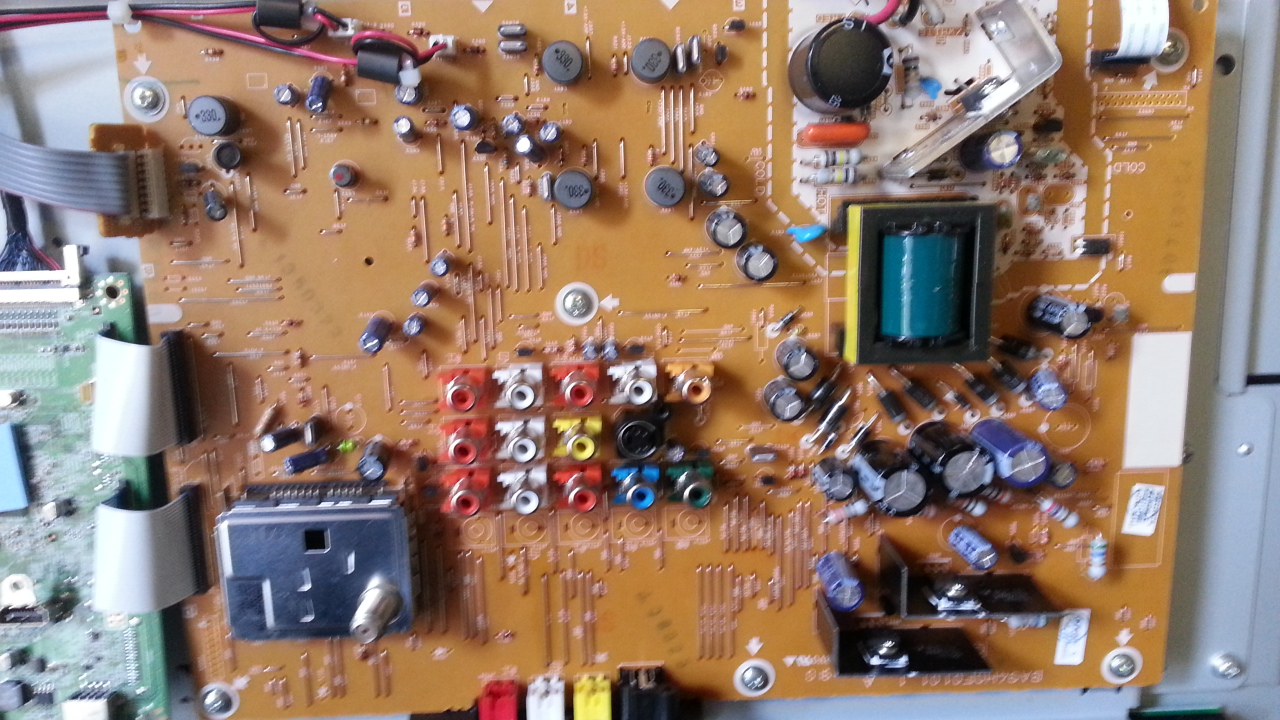

                                I had the same TV with it lossing HDMI video and audio both or one or the other randomly. I replaced the Digital board and it has worked fine every time so far. Customer has not picked it up yet. I looked at the schematic audio the RCA jack come from IC803 a
                                NJM4558M dual audio op-amp to Q703 qnd Q704 KTC3199-GR-AT/P comon emitter transistors.
                                On the Digital board IC3502 ouputs to the JackPower board to the above Q703/Q704 transistors. IC 3502 ouputs audio to the HDMI Switch IC to the HDMI jacks.
                                Hope this helps

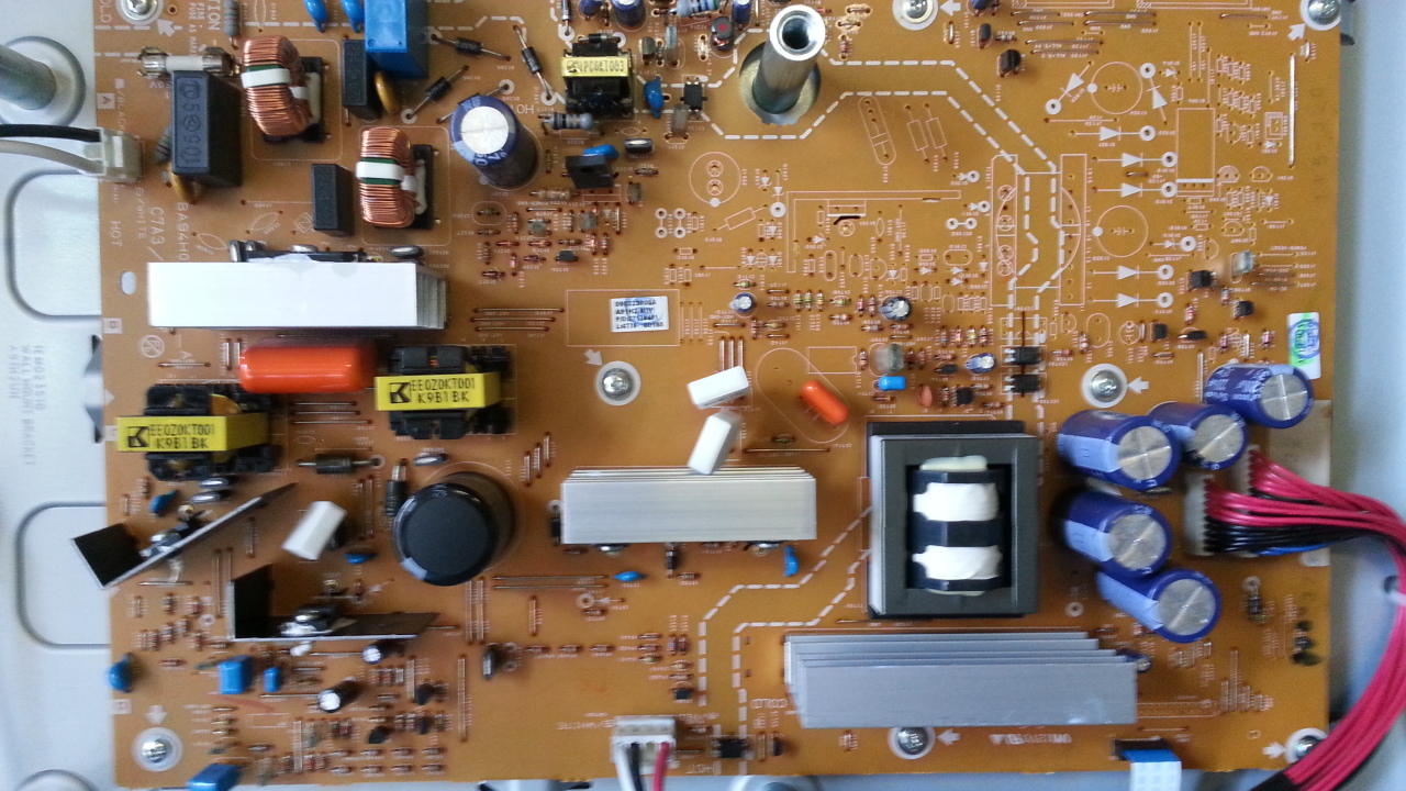

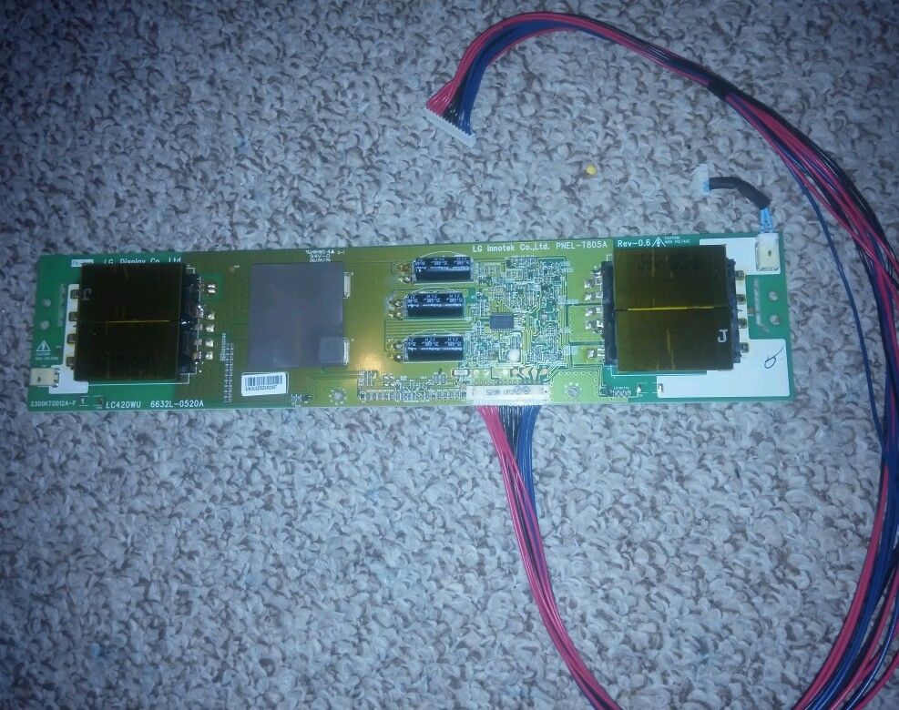

                                  I have a philips 42 PFL3704D/F7 that was in a lightning storm. I have replaced the main power board. I have sound and a picture if I shine a flashlight at the screen but no backlight. I have 24 Volts on both sides of the fuse on the backlight inverter board.Should I replace the backlight inverter board?
                                    But what do you have on BL-ON (INVR-ON), and Dimming control pin?
                                    Pictures of the boards?
                                    • pdford
                                      College student
                                      • Mar 2014
                                      • 10
                                      I dont know where those are or exactly how to check them Budm.I have attached a generic pic of the inverterboard in the TV.I know you need better and I will get them on here tomorrow. Thanks for the quick response.
                                        So is that you inverter board?
