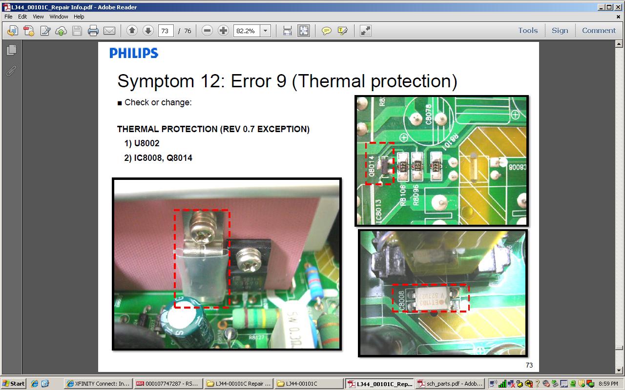

                    The resistors burned out after install, I removed one of the heatsinks and found Q8001 and D8004 to be shorted. There is a U8002 as shown in pic that is low ohms between pins, is that supposed to be low ohms if a thermal protection?

                      Well I replaced the 2 resistors again + the shorted Q8001 ande D8004. The TV clicked for a second then went off. Unfortunately no schematic for this one either. After checking, the diode and transistor shorted again, aswell as main fuse.
