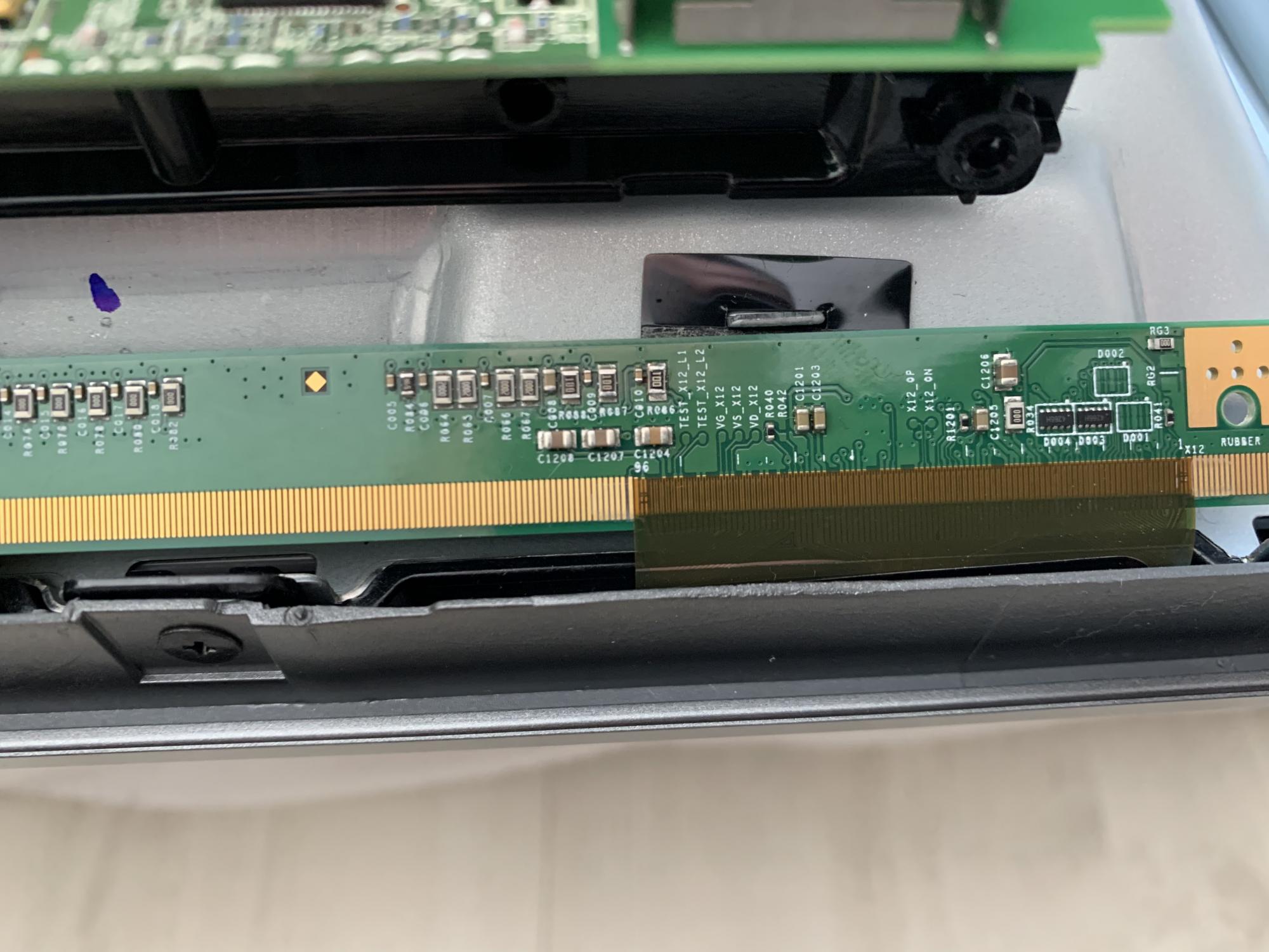

    Hello does anyone have a schematic of the bufferboard? or clear photos with resistors? I have one burnt resistor and one shorted smd cap.

    Re: Philips 50PUS6262/12 (chassis TMP17.7E LA)
    Post a good clear picture of your buffer board.
      The main thing is eliminate the short, I have replaced these caps with same physical size caps from donor boards, for resistor check the ohms of similar good resistors nearby, probably be the same.

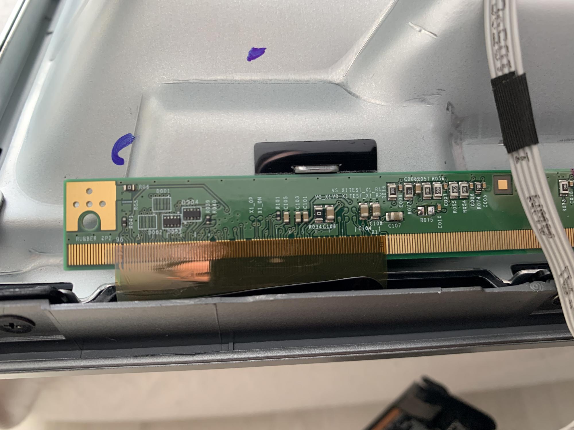

        I have part number 50t32-sod xr bd.
        Tomorrow I will post pictures

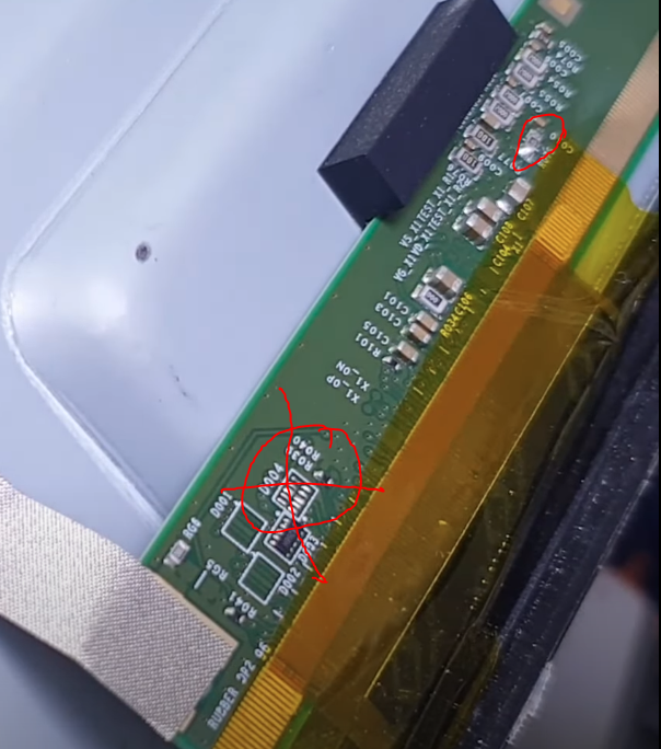

                    Remove the TVS protective diode assemblies and replace the resistor again with 100 (10 Om) - this is their disease in this panel and you will be happy.

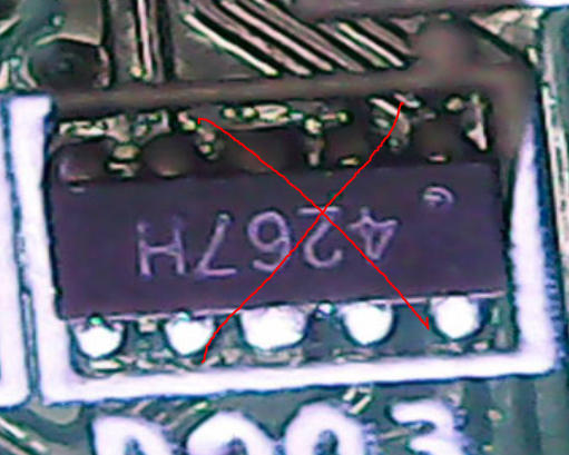

                        I changed cap c1204 and resistor r086.
                        I suppose I need to take out 2 diodes d004 and d003
                        And other side too.
                          I will try this thanx

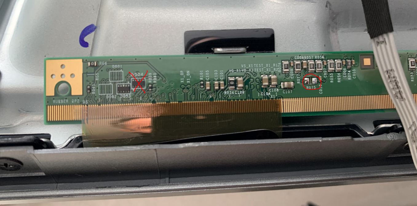

                            Yes, the resistors R075 and R086 mostly burn out, they must be replaced and the diode assembly D004 removed. The photo shows that R075 is missing.
                              I did not removed r075. Do you now the value? Is this 10ohm too?
                              And other side I only remove d004 too?
                              • lotas
                                • Jan 2016
                                • 4809
                                • Russia
                                Yes R075 - 100 (10 Om)
                                Remove from both sides D004.
                                  I have picture again. Thank you for helping👍🏻
