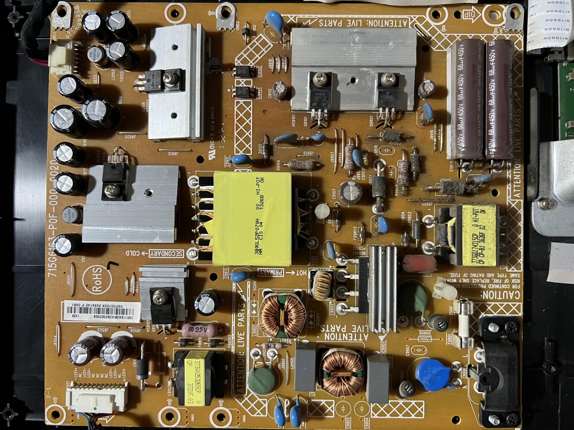

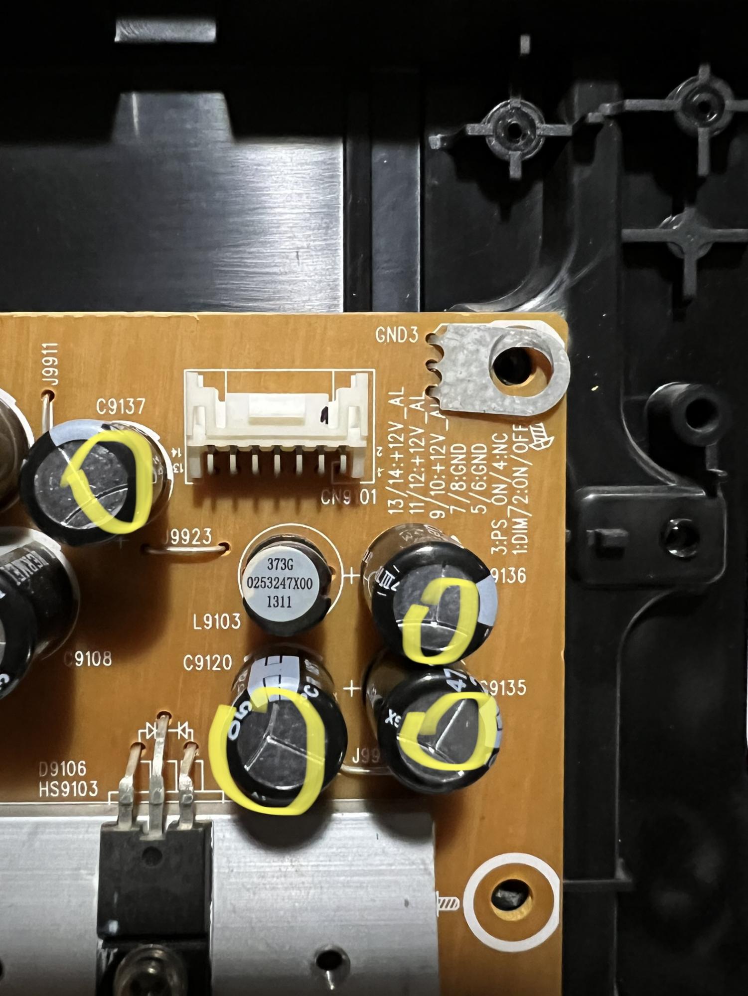

    I have this philips tv that doesn't turn on (no red led), it had 4 capacitors leaking on the output and I changed them but it still doesn't work, any suggestions?
    the output voltages I get are:
    11/12 11.3v
    9/10 11.3
    Ps on: 3.6v

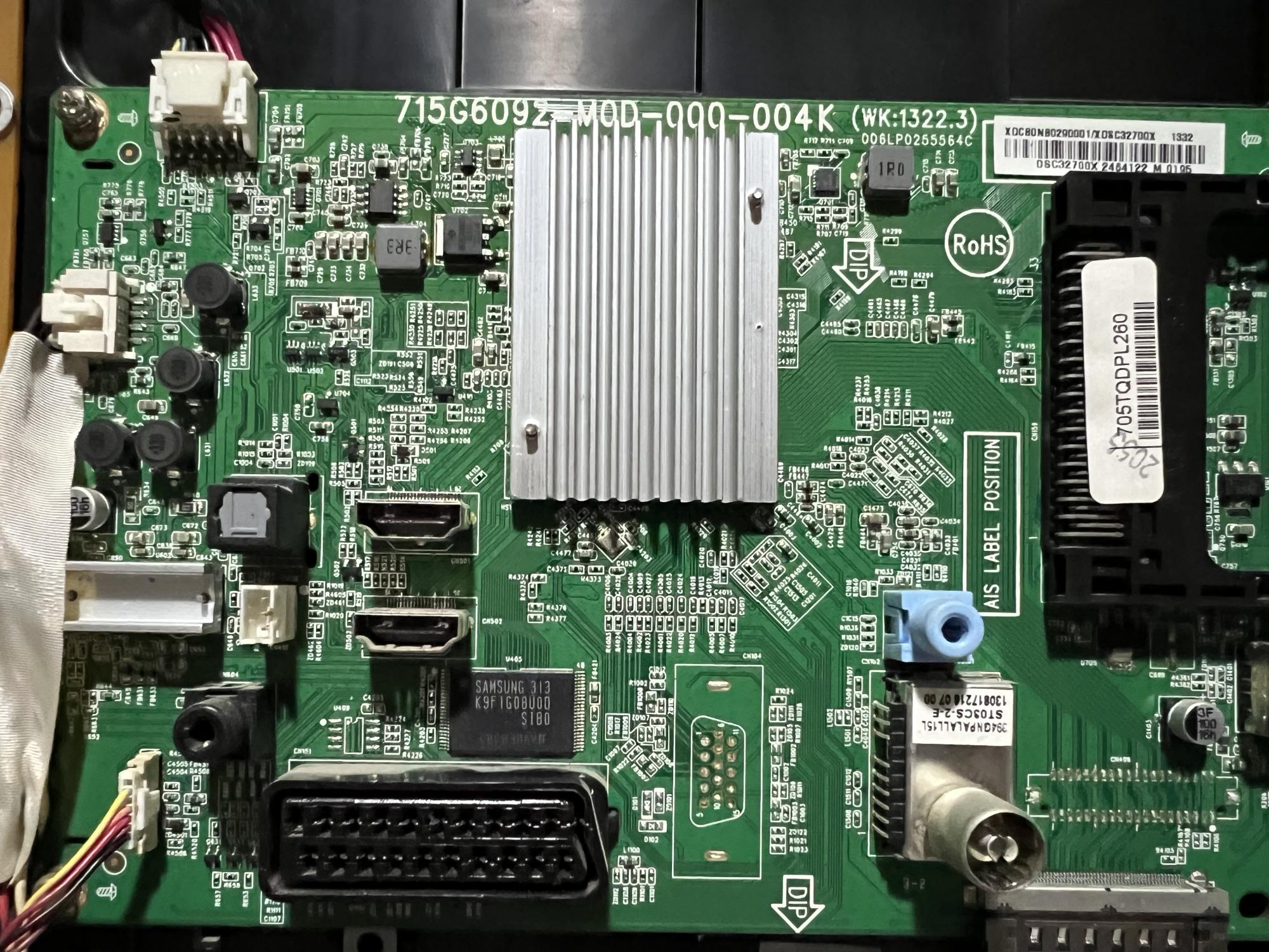

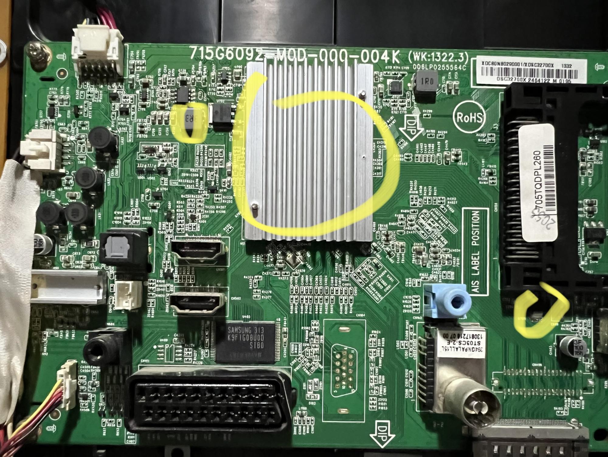

    the motherboard heats up on the cpu side

    the only zones that heat up (about 45 degrees) are these, is that regulator 1117 25 normal that it heats up?

        Re: Tv Philips 47PFL3188H/12 (chassis tpn10.1e la) No led No power
        Same old procedure, test all diodes and resistors on powerboard and check all solder joints, is a good start.
              Test it, meter on vdc, black probe on metal chassis ground, red probe on pin 2, on/off, tv in standby, take note, leave probe where it is power on tv, take note, do the same for pin 3 ps-on. Suppose dim could have various readings depending on settings.
                  ok, looks like you are missing 2 on/off, that's the backlight signal that comes from the mainboard, I would check the powerboard as stand alone.
                                      You can also do a dirty test on those caps you changed, set meter on 20k ohms and see if they all do the same thing with a probe on each leg, reverse probes, they should rise or fall in a steady manner.
