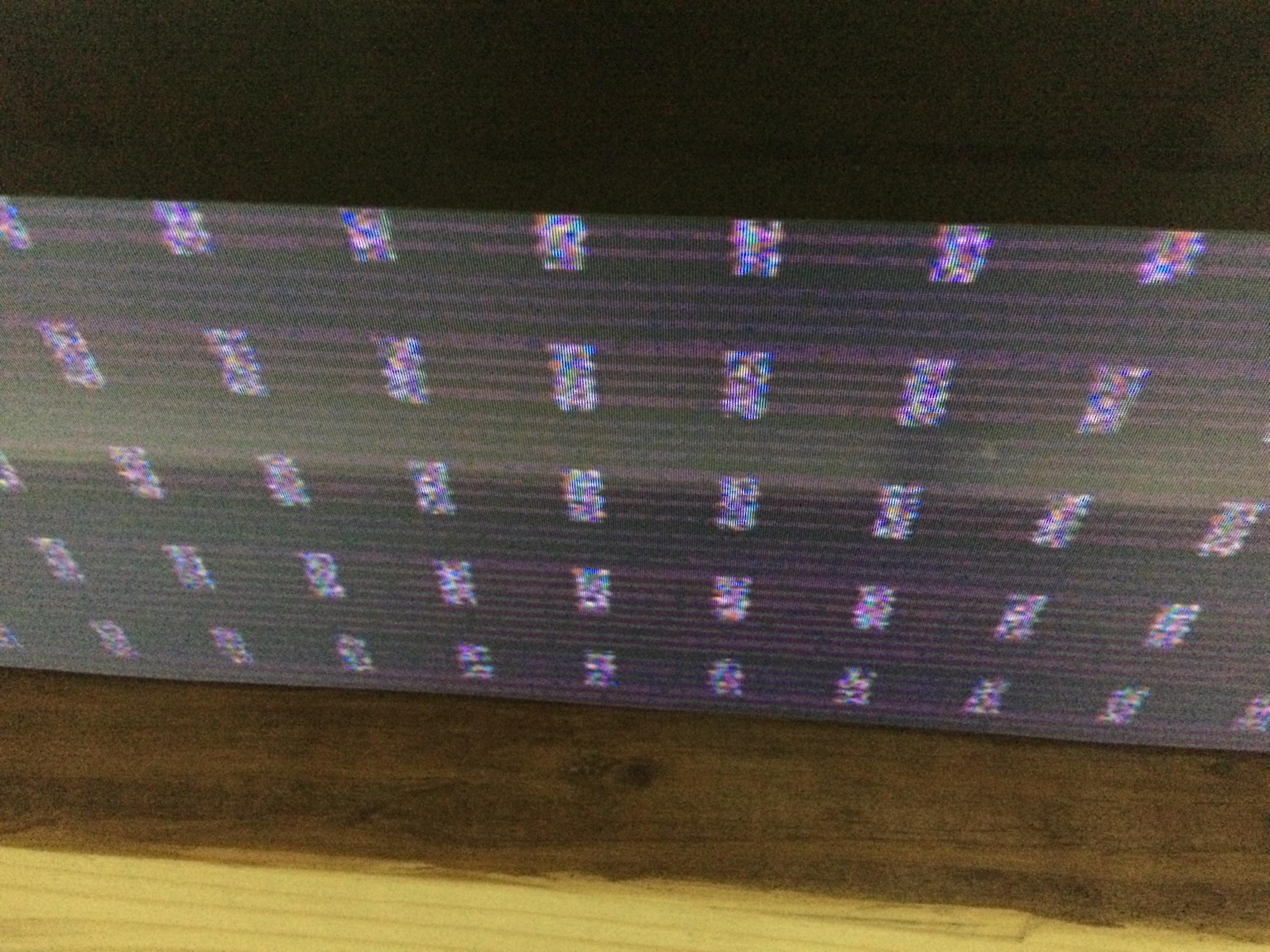

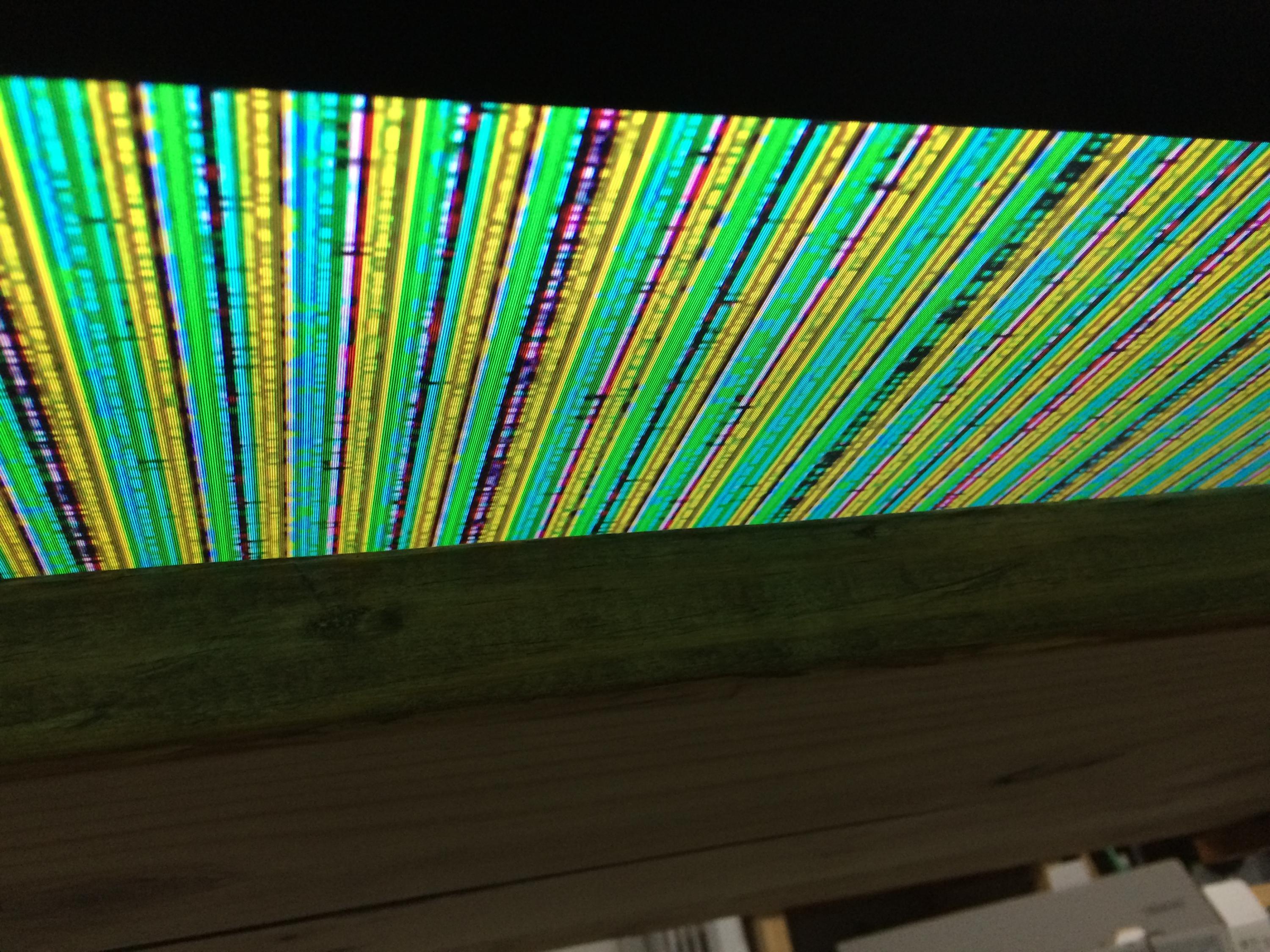

                            #53
                            Re: KDL-37XBR6 has no picture but has sound
                            Back from the dead!!!
                            Model: KDL-37XBR6
                            Issue:
                            Picture is almost normal when the TV is first powered on from being cold.
                            No picture after ~15 sec then alternation between funky lines and blank
                            Sound works when a valid station is chosen.
                            No blink code. Solid green power.
                            Tried throwing money at it as I was short on time
                            New T-con from shopjimmy.com produced the same issues.
                            Found this thread and broke out the multi-meter.
                            I have 12V on the T-con fuse.
                            I see where some fuses on the main board are listed. All of them check out on continuity and ohm test avg ~0.3
                            I'm guessing that the voltages printed near the fuses on the main board are what i'm supposed to find there. Most of these are not even close(i.e. calls for 36v has ~12v) ( calls for 24v has ~8v). I'm assuming something in a power circuit is to blame.
                            Looking for some help on where to look next. I looked at the service manual and my head started spinning.
                            Pics of the issues are attached.

                              #54
                              Post #31 points you to the service manual and the power supply can be found on page 70.
                              Check the voltages given on CN601 & CN602

                                #55
                                CN601 - checks out
                                24.2V on pin 1-4
                                CN602 - looks like higher voltage than expected on pin 4 and 5. Calls for 13v unreg.

                                  #56
                                  6-7-8-9-10 = GND
                                  10-11-12 = 12.3V
                                  16.3V seems a little high but it is an unregulated voltage so probably OK.

                                      #58
                                      I missed the very point I was trying to make earlier. ie pin designators mixed up Thanks for pointing out.
                                      2nd attempt
                                      Pins 6,7,8,9,10 = Gnd
                                      Pins 11,12,13 = Reg 12V

                                        #59
                                        2nd attempt
                                        You are correct.
                                        I was juggling my 6mo old while typing that reply.
                                        CN602 - corrected findings.
                                        pin value
                                        1
                                        2
                                        3 - 3.3
                                        4 - 16.7
                                        5 - 16.7
                                        6 - ground
                                        7 - ground
                                        8 - ground
                                        9 - ground
                                        10 - ground
                                        11 - 12.3
                                        12 - 12.3
                                        13 - 12.3
