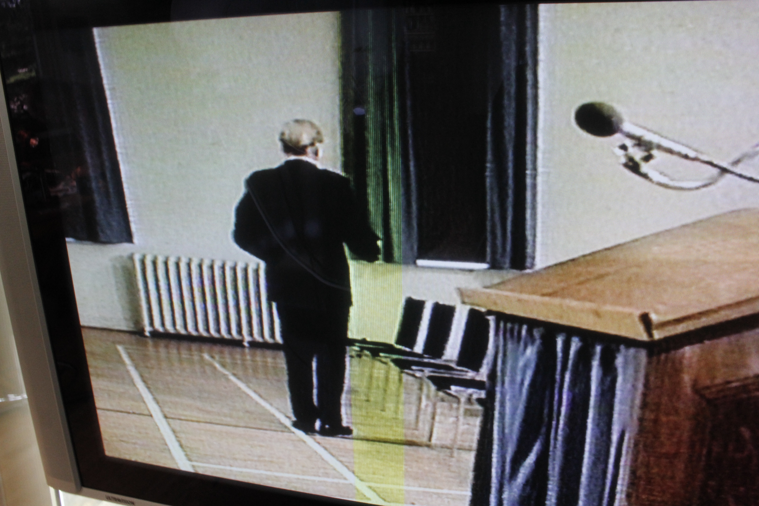

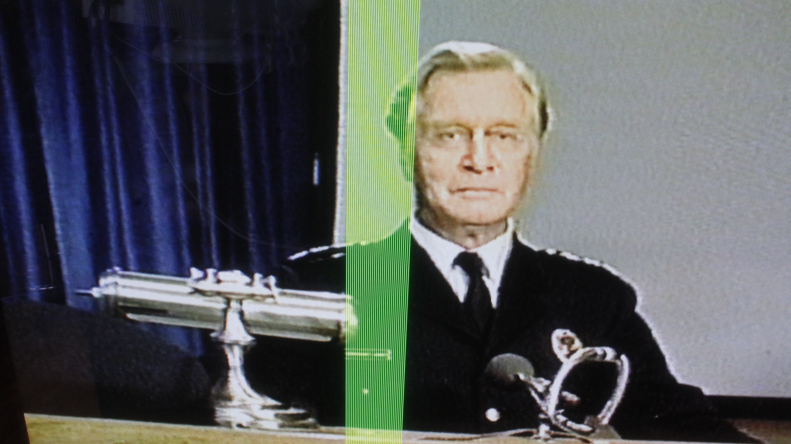

    I have a Hitachi 42HDS69 plasma TV that works perfectly for about 15-20 minutes and then in the near middle of the screen, about 2 inches wide from top to bottom, there are vertical lines spaced about 1/8 of an inch apart, so about 30 or 40 lines that you see.
    Now the odd thing is they are random in that they go away (mostly) and come back while viewing the source.
    This does this whether a signal is input or not. What would be the cause?

          I figured some pictures would better illustrate the issue. I took 2 photos. One shows the green lines, one shows when they get less noticeable/almost go away.

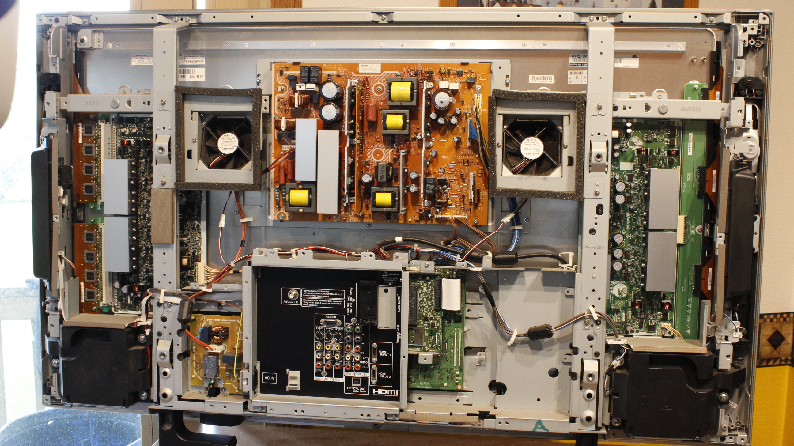

            OK, it is likely a loose connector... Post a picture of the inside of your TV.
              Re: HITACHI 42HDS69 Plasma random Vertical lines in middle of screen
              Ok here's the inside of the set.
                I'll let Tom chime in, but my guess at where he was going is that there are address boards that run along the bottom of the panel behind the A/V board. One of the ribbon cable connectors between the address board and the panel in the vicinity of the defect may be loose. I'd also check the connections between the control board and the address boards.

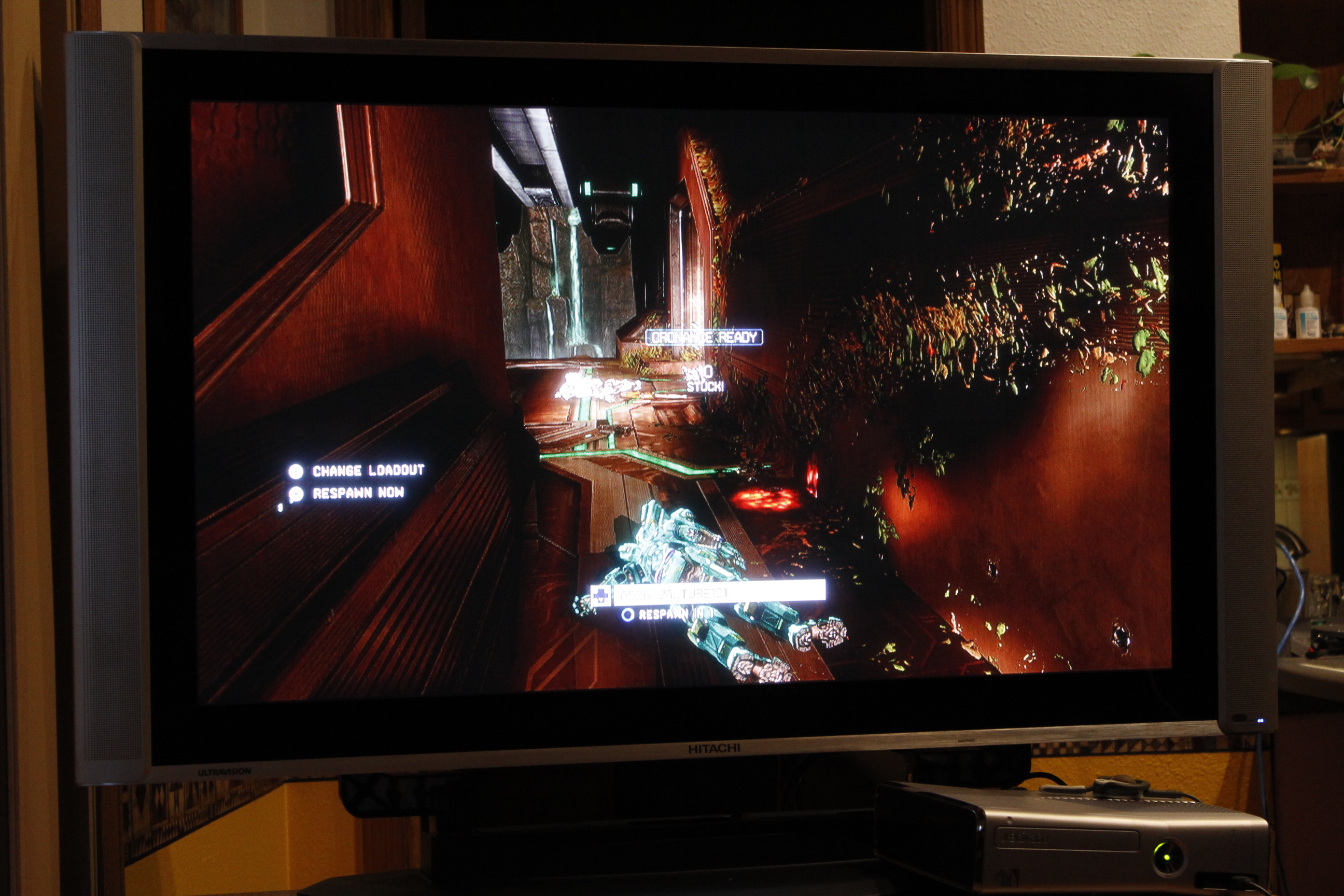

                  Well I thought you would all like to know, I went ahead and removed the input panel on the back of the TV, and saw the connections (think its called the Z buffer?) on the side of the panel that the issue was on (I marked the width of the bezel where the lines were so I could see the area while looking at the back of the TV)
                  The problem area was right where the connection to the buffer board went, I unplugged it, cleaned it with isopropyl alcohol, and plugged it back in and its working perfectly, heck, I even notice improvement on overall image quality.
                  Figured you would all like a pic to see the working product. Thanks to all for your help!!

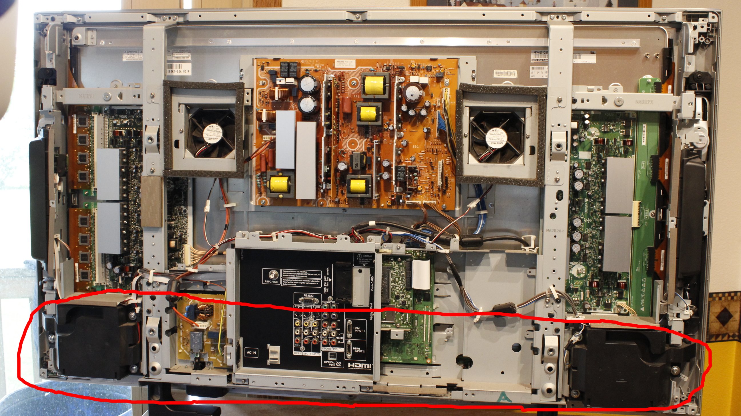

                          It's different for each TV. You'd need to look at the connectors underneath the main board/AV board assembly.
                            Sorry forgot to mention, I have the 42HDS69 as well so same exact tv with exact problem :-(
                              Connectors are under here. You need to remove a lot of stuff to get at them, before doing so take a piece of tape and put it on part of the panel which is faulty as a marker for which connector is likely causing the problem. The connections must only be adjusted with power off.
