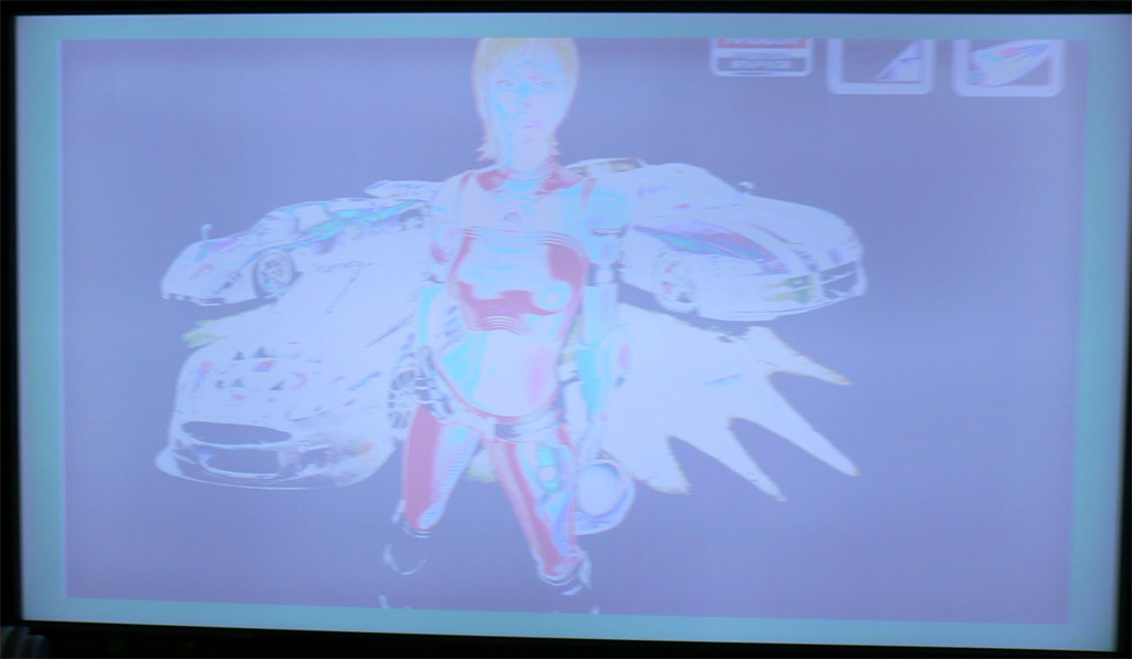

    I got this TV with colors at picture. Did some research here and found that mostly the synonyme is bad AS15-F chip. It is preset on the T-con, I guess it is the problem?
    Tried to push on the ribbons as well to see if they are not badly soldered but no change.

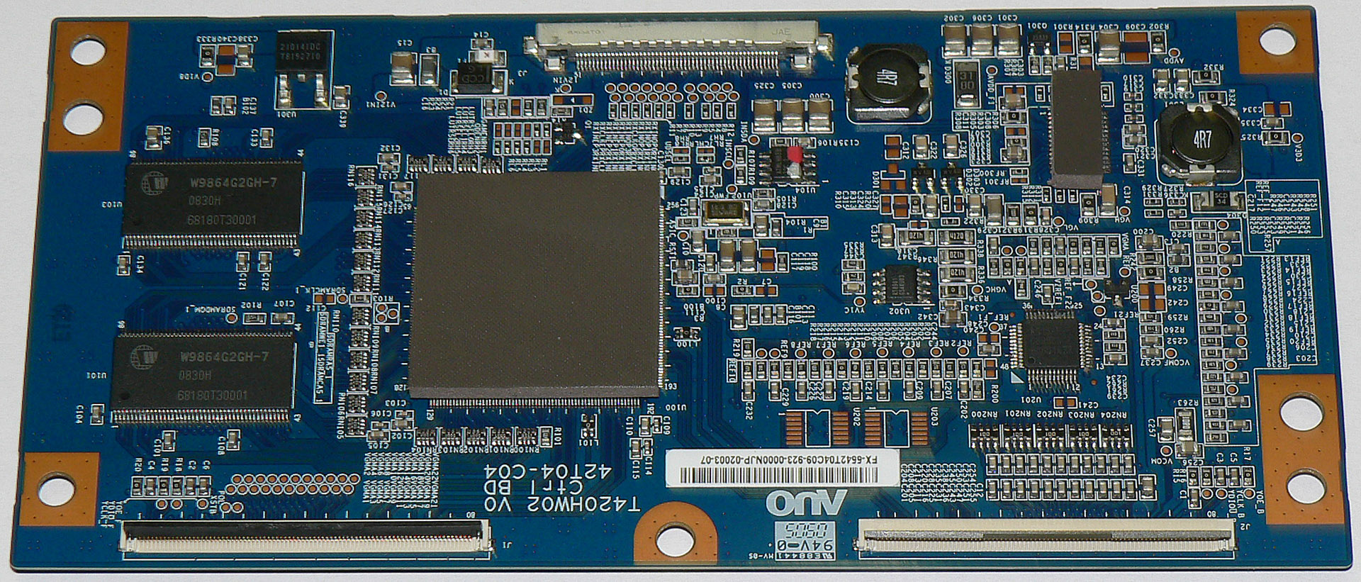

    I would consider it. If you post a picture of the T-con you can verify the IC is bad with a multimeter.

      Here it comes

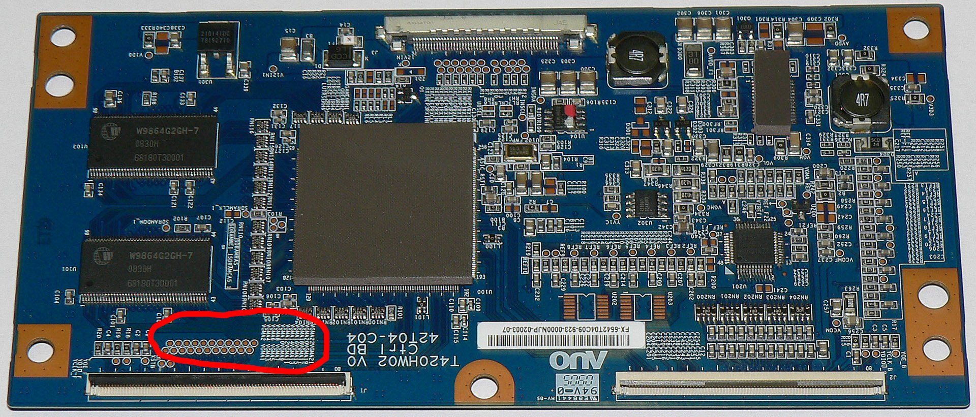

        OK, these points marked VGMA1 thru VGMA22?
        Measure each on DC 20V. TV powered on showing image, board fully installed. Your ground is the metal back plate of the TV.
        Report your readings.

          Re: LG 42LG5000, vomit colors, bad AS15-F?
          15,45
          15,45
          15,36
          14,53
          12,76
          10,66
          10,80
          10,85
          8,05
          7,42
          7,32
          2,08
          1,92
          2,56
          5,08
          5,27
          5,48
          7,00
          8,46
          11,77
          13,05
          13,64
          Also noticed, if I push the chip, color changes.
            Are those in order, from 1-22 or 22-1? If so, the chip is definitely bad.

                    Oh I think I got it. Output should be 4,92 V max so if it's fried it has supply voltage on output making the display showing overburn colors that's how I can tell it is bad?
                      No. The output can go up to 15V. However, it should go gradually from 15V to 0V. As you can see it starts high, goes low and goes high again. This will cause light and dark colours to both appear bright.
                      The gamma IC is used to make the light output look linear. The TFT in the panel does not have a linear response.
