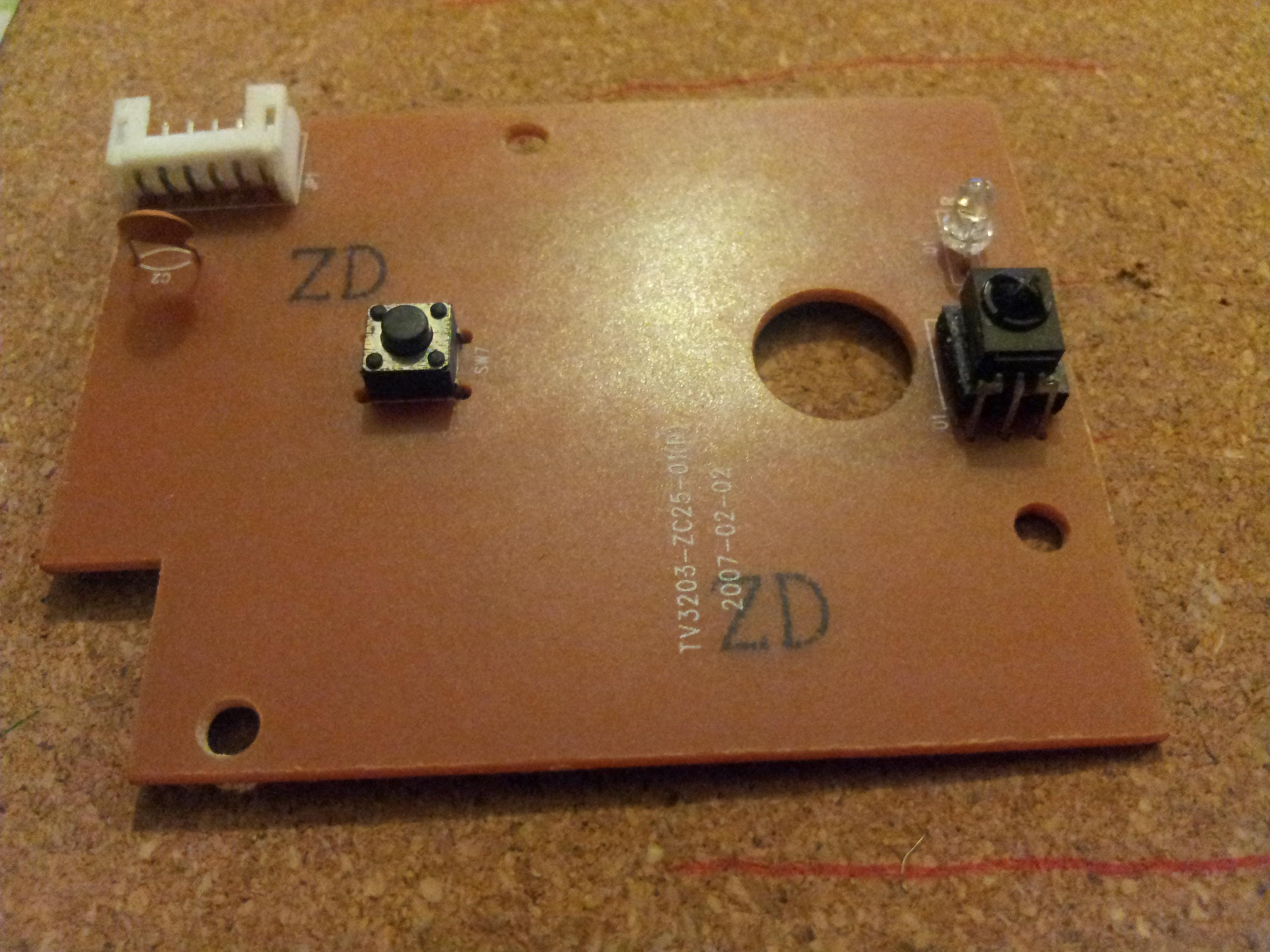

    Removed the IR board and found that the IR receiver has 3 pins:
    Output
    Gnd
    Vcc
    So there is 5v on the supply pin but only 3.6v on the output, which should be equal to the input until it receives a remote IR signal when it pulls down the output.
    As the output is already 'pulled down' or so it would seem as it only reads 3.6v without any remote IR signal I thought I would remove and check. Sure enough with a 6v supply on the input there is also 6v on the output until it receives a signal.
    So looks like I need to find what is pulling down the output on the SSB.

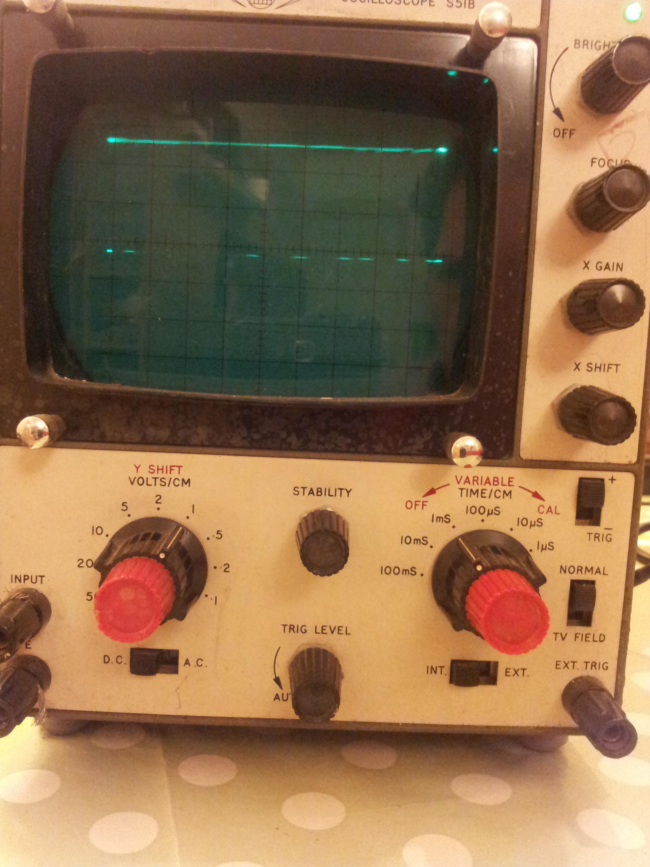

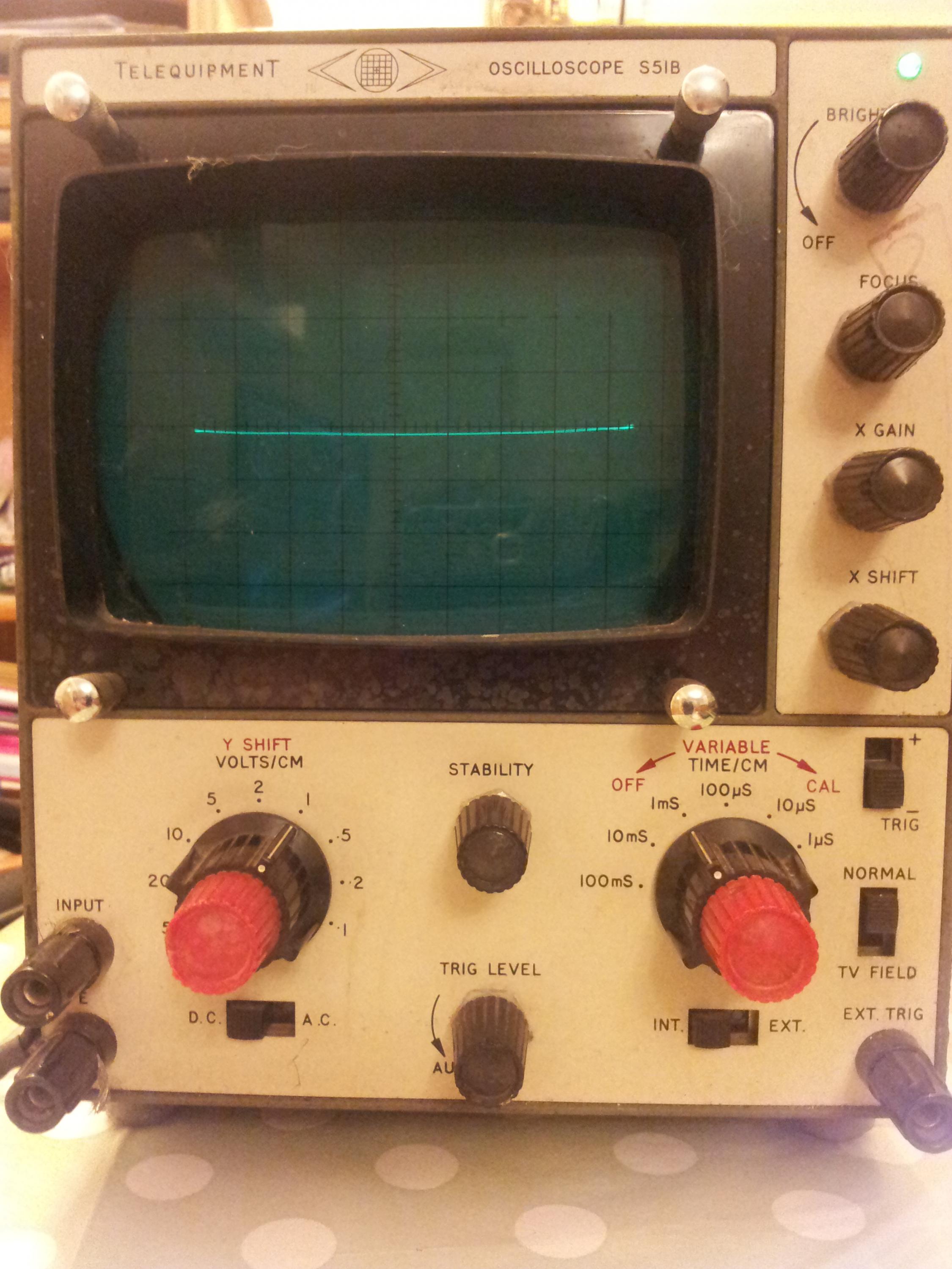

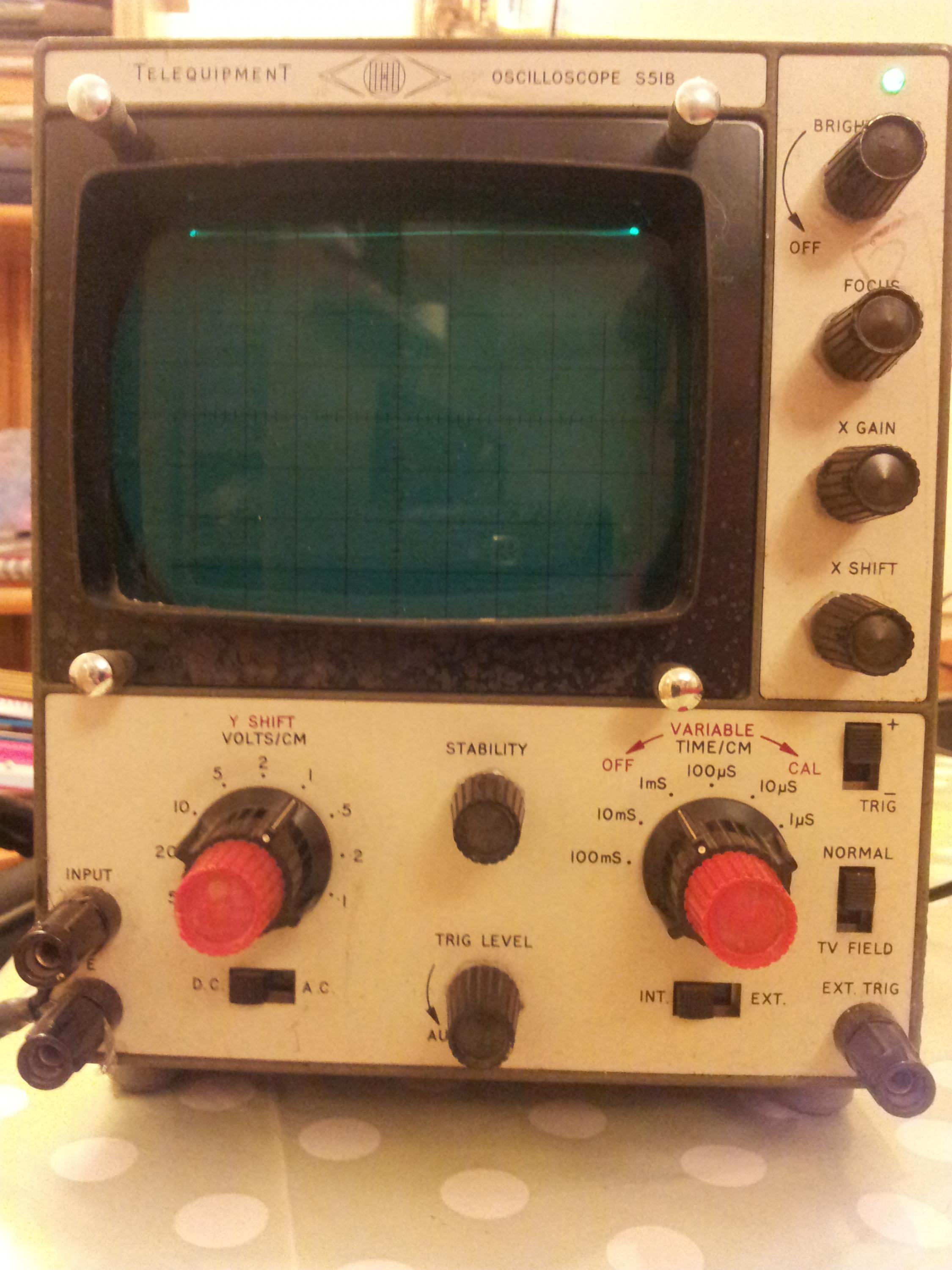

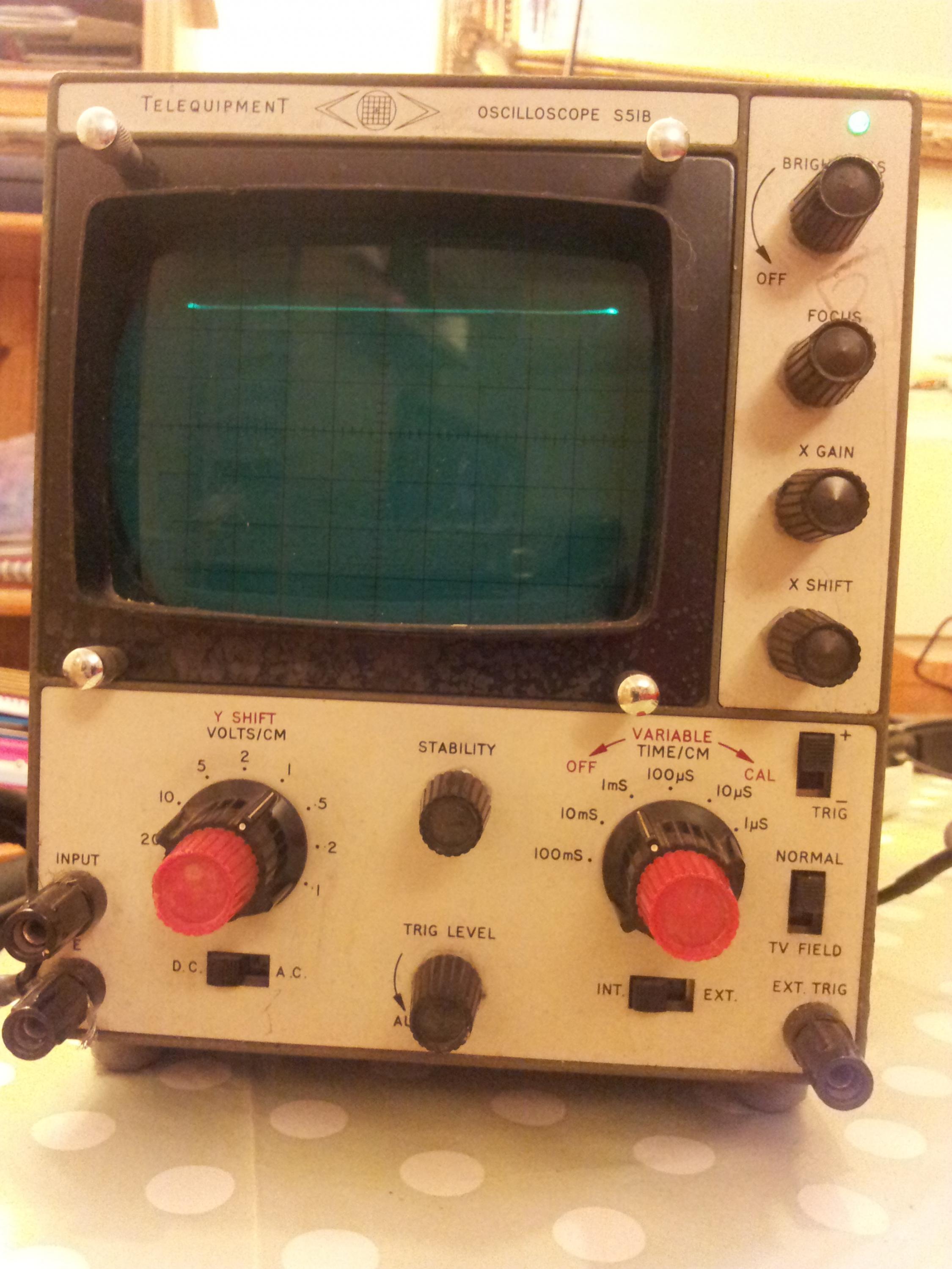

                    Re: Tevion LCD3209ID remote /IR receiver
                    So scope out for what its worth, lets see!
                    Pictures hopefully in order:
                    1. Probes shorted
                    2. Probes connected to IR board Gnd and 5v-s
                    3a and b showing probes connected to IR board Gnd and IRIN - the 2 pictures capture the solid line representing 3.6v roughly and the second photo with the voltage drop
                    I don't think this scope can capture the oscillation fast enough!#? Not sure
                    Scope set to 1v/cm, each grid is 1.5cm and 1ms time/cm, perhaps this should be slowed down to 1us time/cm.

                      Oh yes, 3b is showing the IRIN line with a universal remote in auto search mode, hence the drop in voltage.
