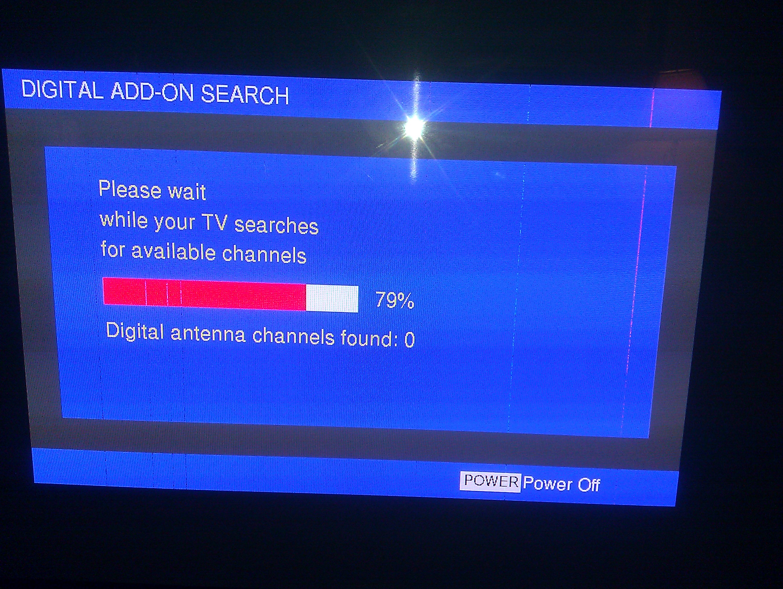

          Ther are a couple vertical pinstripes that are not visible in all images. They are in fixed positions, but randomly dispersed through the screen. Roughly 5 of them.
          I adjusted the "V" rheostats and it seemed to affect the intensity of the vertical lines, but they do not disappear completely.
          I looked through old posts with similiar gripes and you had mentoined in those cases that it is not repairable. Would that be the same case for mine?

              I tried to take a pic, but the lines are so thin (like 1 pixel wide) and they shift in and out of visibility.
              I tried to get them to show up on the white screen, but I haven't gotten them to show up on a pic yet.

                Found a screen that will show the lines well enough to get them to show up in a picture.
                • Twithers
                  • May 2013
                  • 69
                  • U. S.
                  #48
                  Re: DP50747 Troubleshooting
                  Here it is.

                    #49
                    Update:
                    I took a shot at adjusting Vs and Va as per the plasma guide. The sticker calls for 193v Vs and 60v Va, but if I set it dead on, the vertical lines are very bright and defined. If I drop Vs 15-20 volts, just before the red sparklies show up, they fade out around 60%.
                      #50
                      You probably have a defective plasma panel, this will not be repairable. Did you ever plug in any connector while the set was still energised?

                            #53
                            The lines could have been there before, but because I had a bad Y upper, I couldn't see the screen to tell if they were there.
                            If I put Va on 60vdc, as dictated on the sticker, the lines are worse. I have to drop Vs and Va about 10%, to get the lines to fade out about 60%.
                            The lines are always in the same place.
                            Could it be caused by the ribbon cables from the display to the Y upper being a little out of alignment in their connectors? I had a tough time getting them seated properly.

                                    #57
                                    Since lowering Vs and Va makes the lines less visible, is it in any way detrimental to leave the voltages that far off from the sticker voltage specs? In other words, if the lines can't be fixed, am I also causing more damage to other parts by running the voltages that low or will it be ok that way?
                                    The picture is on its way.
                                      #58
                                      Can't see any harm -- except as the panel ages you may get more misfires (dead/lit pixels) or maldischarge - pink/purple tinted clouds visible on pure white. I'm surprised you can reduce line visibility with lower Vs/Va.

                                        #59
                                        Yeah, if I put Vs and Va on the sticker specs, the lines are bright and solid. But if I lower the voltages to just before it goes red sparkles, the lines are significantly reduced and only really show up in certain color/image schemes.
                                        Maybe that could be a tip for all those people who have the lines due to an irreparable display.
