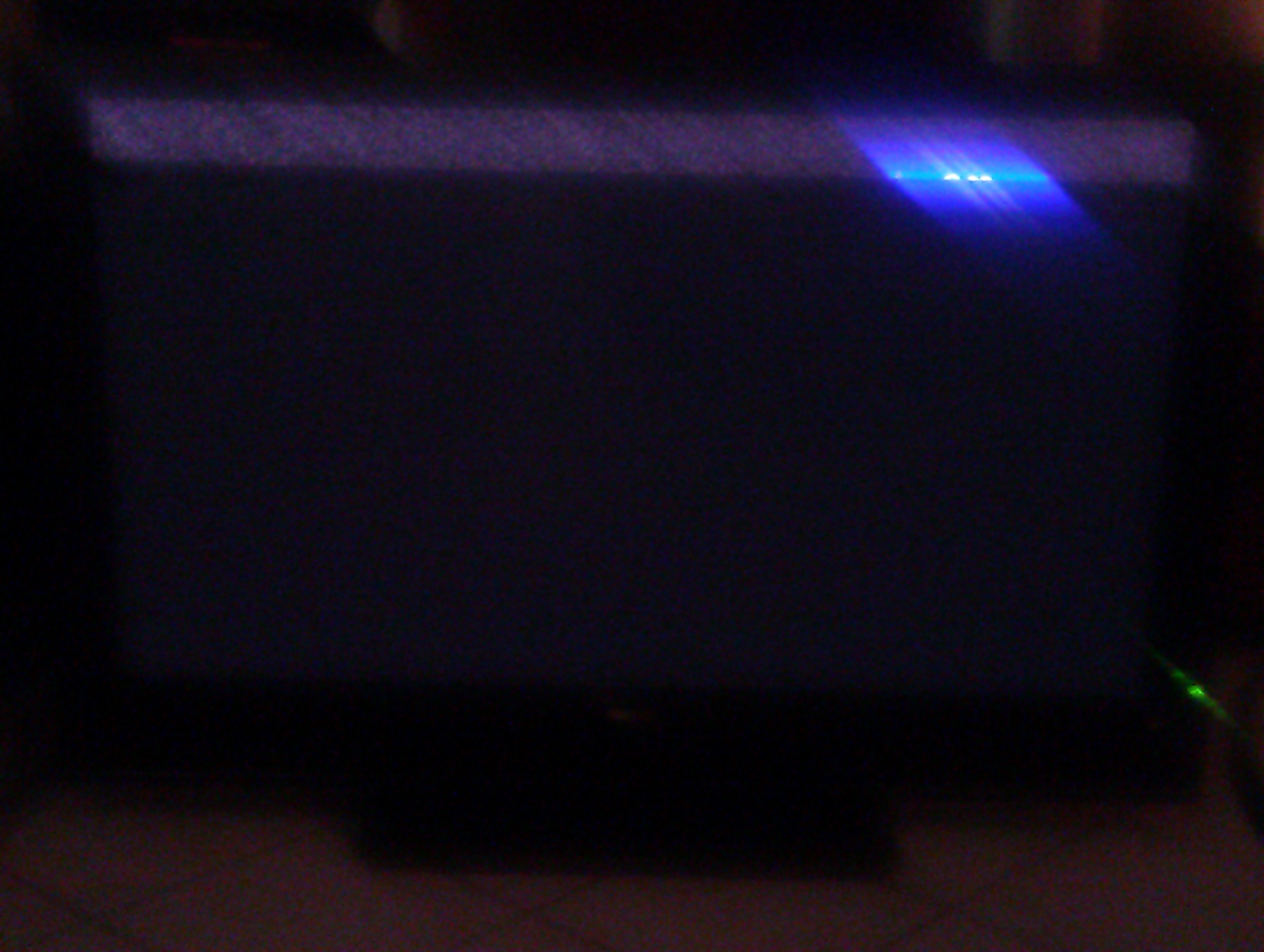

    Here's the pic. Looks very similiar to the pic in that post I linked.
      Re: DP50747 Troubleshooting
      The bottom of the screen that's not working still glows?
        Yes
          It would appear to be a buffer board fault then.

            Is there any way for me to further verify that?
            The buffer board, meaning the Y upper or the Y sustain?

                              If I understood correctly, the "good" part of the screen (the very top edge on mine) corresponds with that buffer on the card, does that mean that all the buffers on both upper and lower cards are bad except the buffer that corresponds with the "good" part and that "both" upper and lower buffer cards should be replaced?
                              If I'm way off, I apologize, I'm a bit slow.
                                #35
                                Each buffer IC chains a signal from one to the other.
                                So top buffer IC is OK. But second one isn't. And this isn't sending a signal to each of the others.

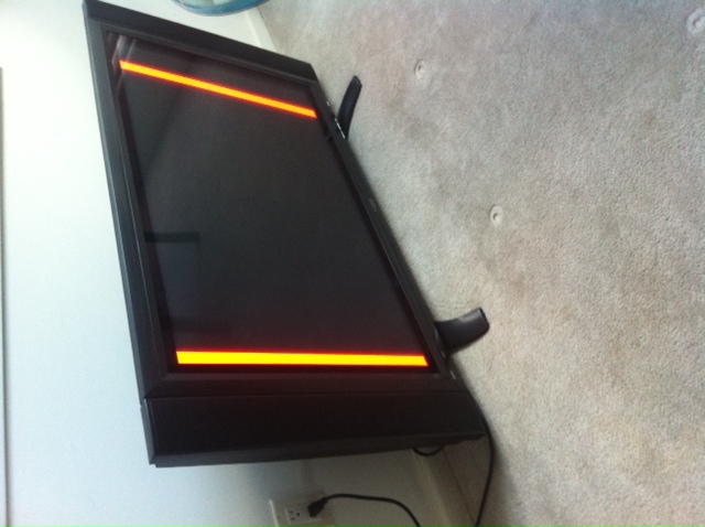

                                  Would I need to start a new thread to ask you about the set in the picture?
                                  Apparantly the picture and sound play fine, but it has those 2 stripes in the way.
                                    #37
                                    Yes. New thread. Defective CTRL board or bad plasma panel.

                                      Hey Tom, the buffer ICs you mentioned earlier, are they located individually under their own aluminum heatsinks? So that there are 5 in a row on that upper card?
                                      You were saying that the fault should lie in the path between that first buffer IC (because there is video in that corresponding sector) and the 2nd IC (because that's the corresponding sector where the fault starts) or the 2nd IC itself.

                                        Depending on the design they are sometimes heatsinked, sometimes not. Each buffer IC is a separate, multi-pin chip. The chip contains a shift register, latch, and high voltage output switching (64 to 96 channels capable of switching ±200V signals.)
                                        1. I have never seen such a fault on the buffer board.
                                        2. Yes.
                                        3. It would be unlikely.
                                        4. No, only the Y upper buffer at the moment.
