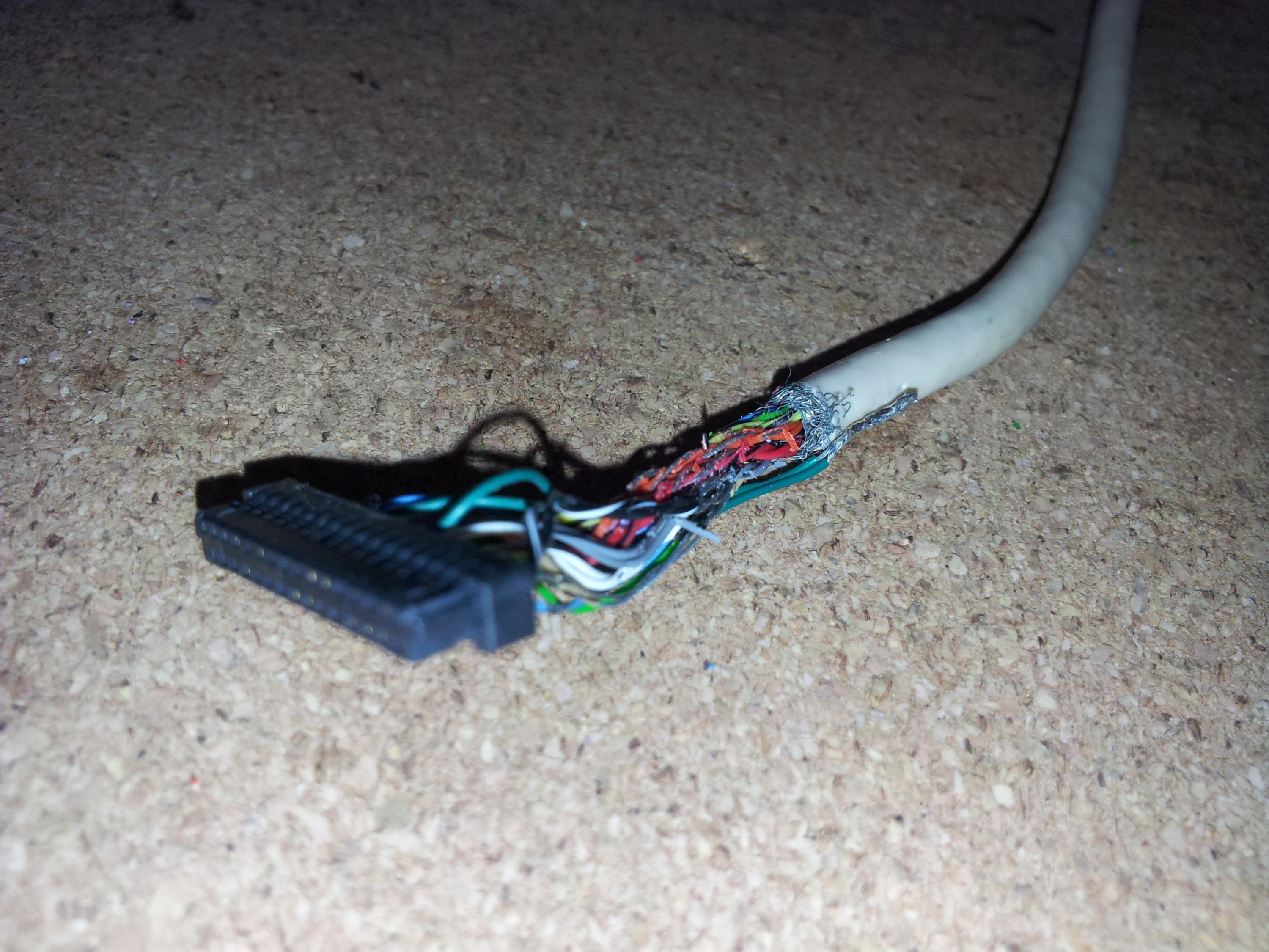

                              I have found an issue which is the cause or at least not helping so shall resolve before proceeding further.
                              It appears that there is a wiring harness that goes to the logic board with burnt out wires, LVDS perhaps?.
                              Not sure I will be able to repair as its immediately next to the connector so may have to source another.
                                Re: Philips BDS4231R/00 PDP S423D-YD07
                                So having removed the shroud it has revealed further damage to the wiring insulation.
                                  Having repaired the wiring harness the tv has no change on picture.

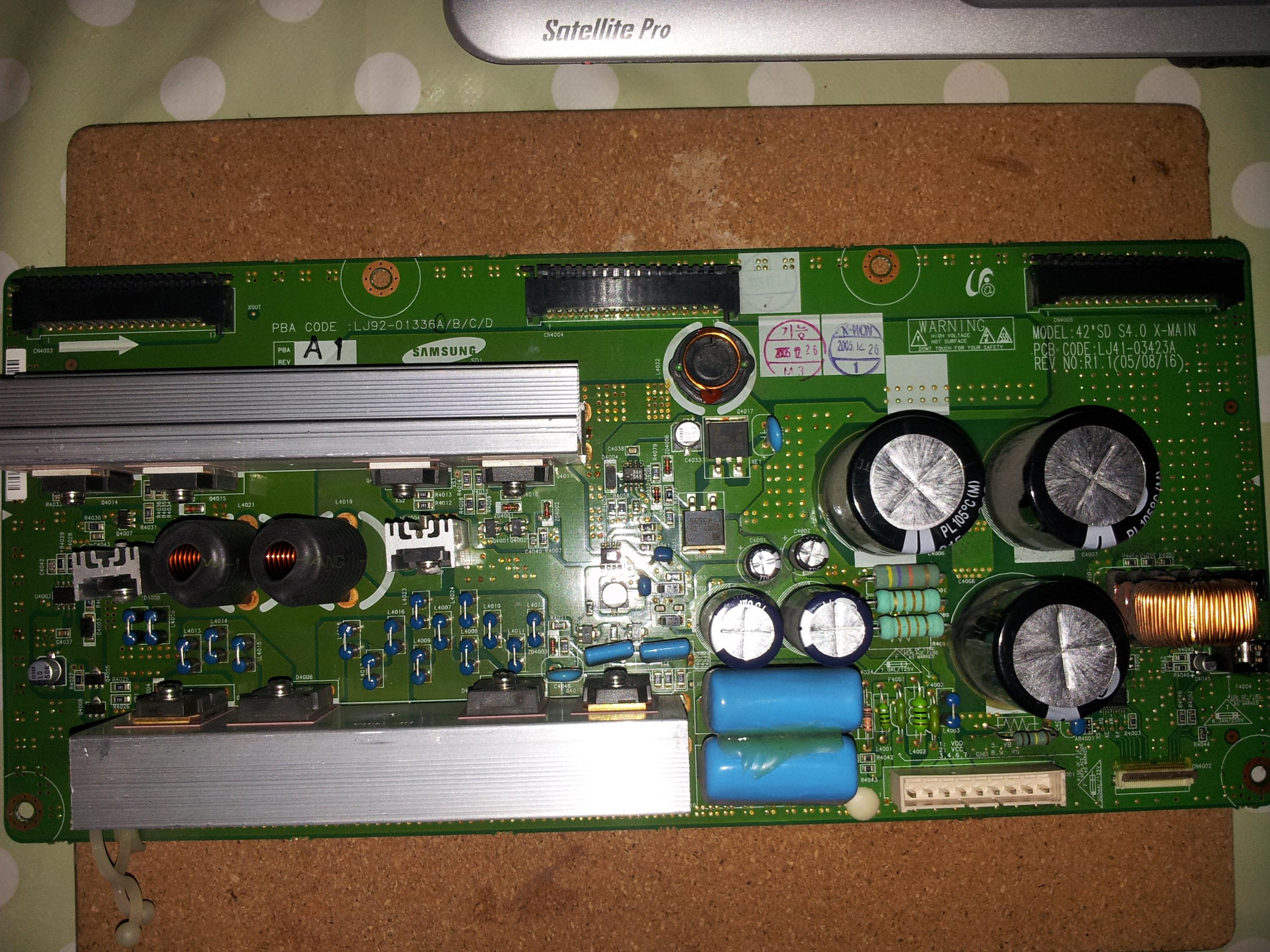

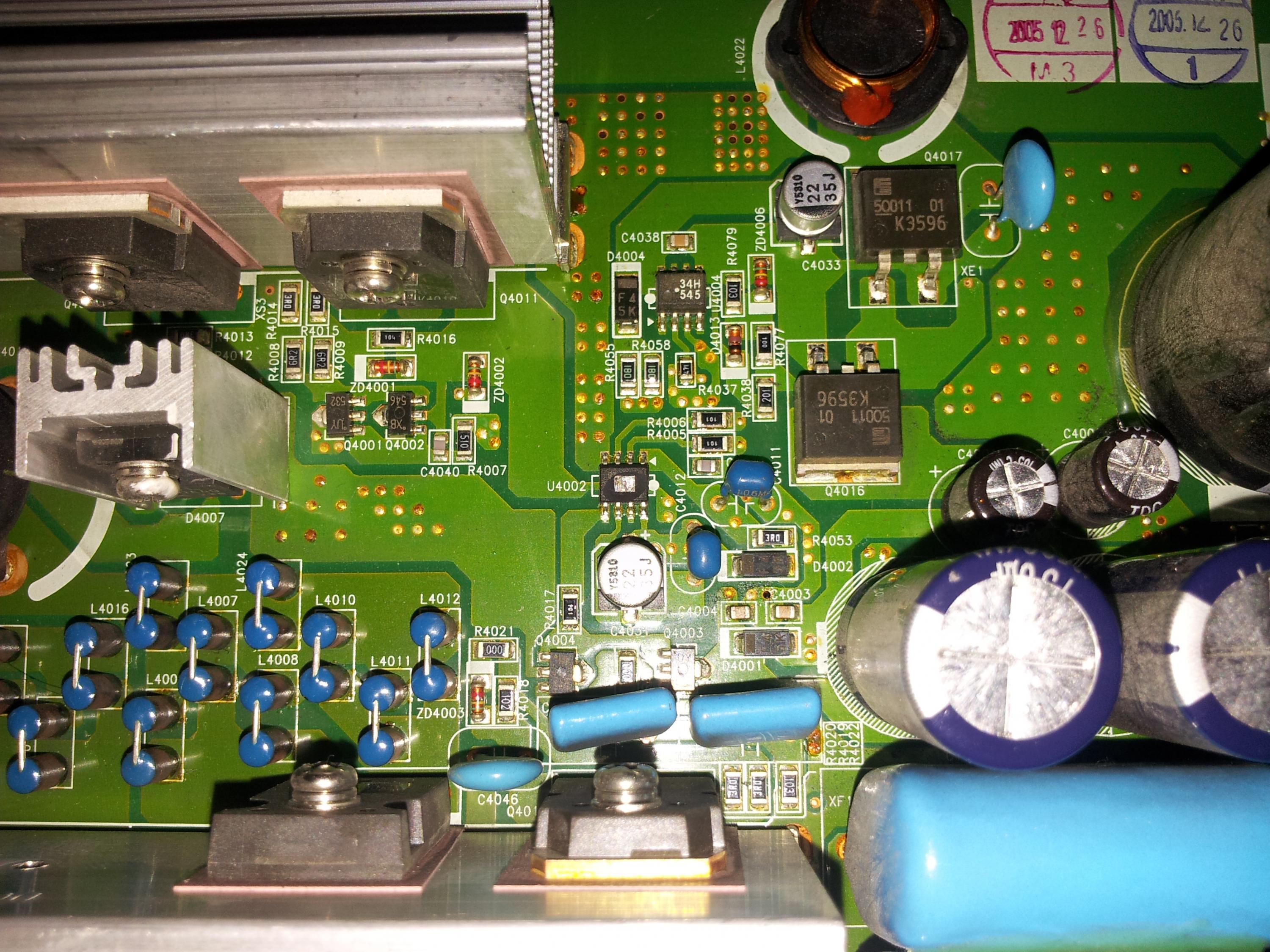

                                    One for the bin I think, X-Main now blown a fuse and I.C.
                                    Kind of my own fault actually, forced the tv to power up! hey ho such is life
                                      X - Main board
                                      I.C U4002 blown
                                        Tv starts up but poor picture due to x-main out and picture is still constantly switches on and off, not the tv just the picture.
