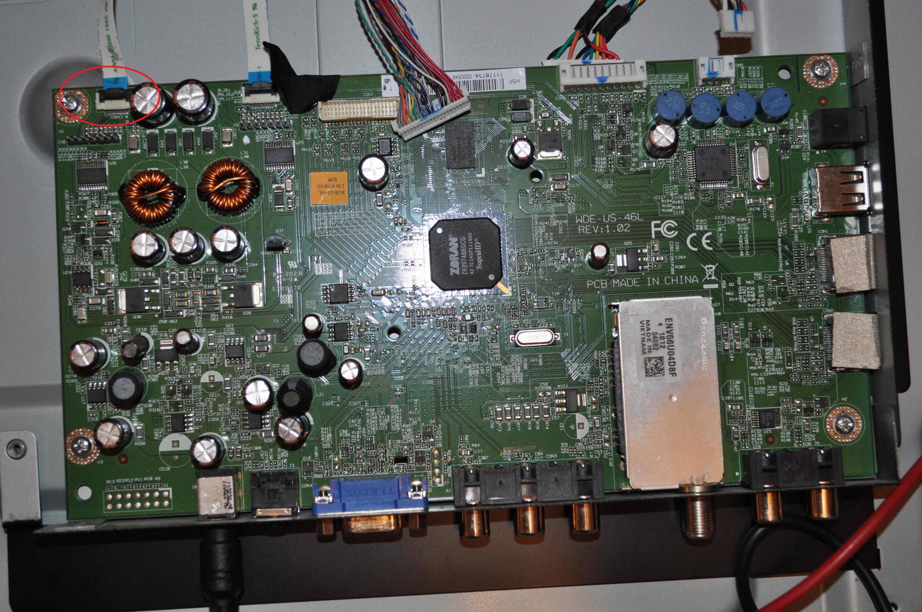

    Picked up a Westinghouse LD 4655VX for free today did some basic troubleshooting I leaned on this forum. The power supply is good but I get nothing at all when I hit the power button. After taking all the cables off the board I would have the 5v standby voltage. After doing the cables one by one I have determined that hen I unplug the ribbon cable circled in the picture the set will come on and it appears to me that this ribbon supplies the left back light. The right back light of course comes on with the left disconnected. So I think I have a bad back light and if so is it repairable?

      Thanks for the thread reference. That was exactly the problem. The ribbon cable was bad going into the socket. I simply cut the existing cable, stripped and reinserted it in the socket and all Led's came on!

        The set I'm working on is a version of your set. The model I have is Westinghouse LD-4680.......as far as I can tell it is the same as the LD 4655VX except sold at Walmart and or Costco, but suffers from the same problem.
        I made the mistake of using a power supply with the same rating as the tv factory one, except it was for a laptop, and it didn't have the short circuit cut off like the TV's factory one. When I had the back of the set off and plugged that wrong supply in, I saw smoke coming from the ffc that runs the led's for the left side. That's how I found the short, but I'm afraid the cable is toast now. The thread I referred you to just confirmed what I found out the hard way. Now I'm looking for a new cable, long enough to reach.
        Ebay has some.... I wish I had found that tread before I did that stupid stunt, ignoring my troubleshooting chops.......that will cost me $20.

          Is the cable only carrying a positive and negative, or has it got multiple lines?

              I would make my own wire harness and I would solder all the wires to both PCBs.

                  The ribbon cable is feeding approximately 20 leds per side.
                    Re: Westinghouse LD 4655VX odd problem
                    The ribbon cable has 12 contacts, so 12 wires.

                        12 wires but maybe 6 for positive, 6 for negative?

                          Mine was just the cable.

                              Follow the link in post #2. You may be able to just wrap the cable with some tape to prevent the wires from shorting.

                                Yep, read the link. But which end? Mine was not dropped. I took the outside part off the panel to see the other end of the cable and it looks fine.

                                  I'm only going by what I've read in the thread. It looks like where the cable wraps around the metal casing of the panel is a problem area. If the ends of your cable don't look damaged, this could be your issue.

                                      The LEDs have an Aluminum strip below them and the ribbon touches that strip at the edge.
                                      Just disconnect the ribbon cable at the LEDs end and look at it.
                                      Read, what I have written at post #76 in that thread.
