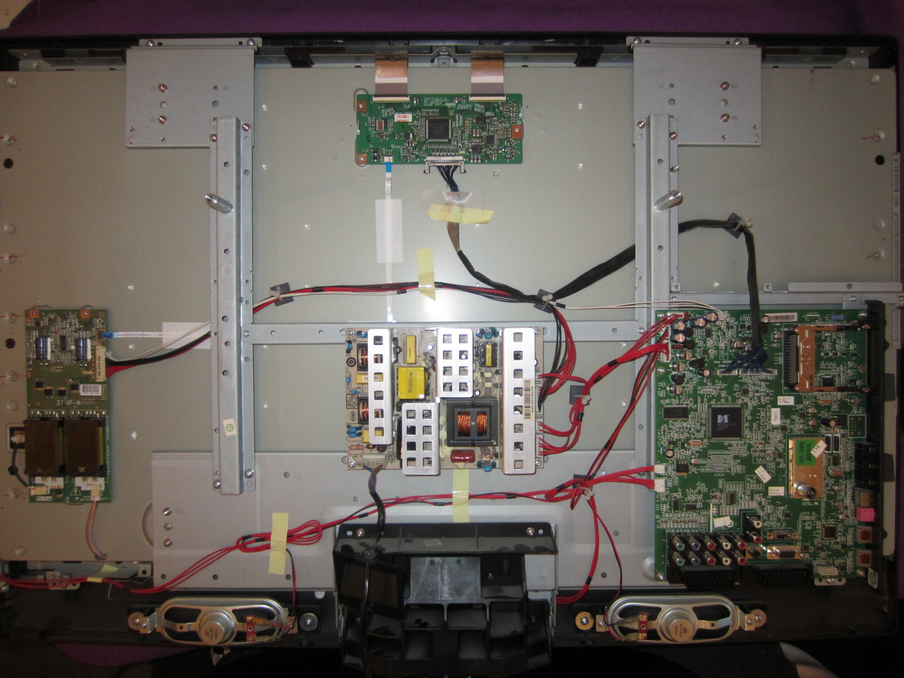

        Re: Wharfedale LTF37K1CB Picture problem
        OK, at this point we will require you to remove the cover off the rear of the TV and take a detailed picture of the chassis layout and perhaps one of each board. Then we can indicate where to make tests.

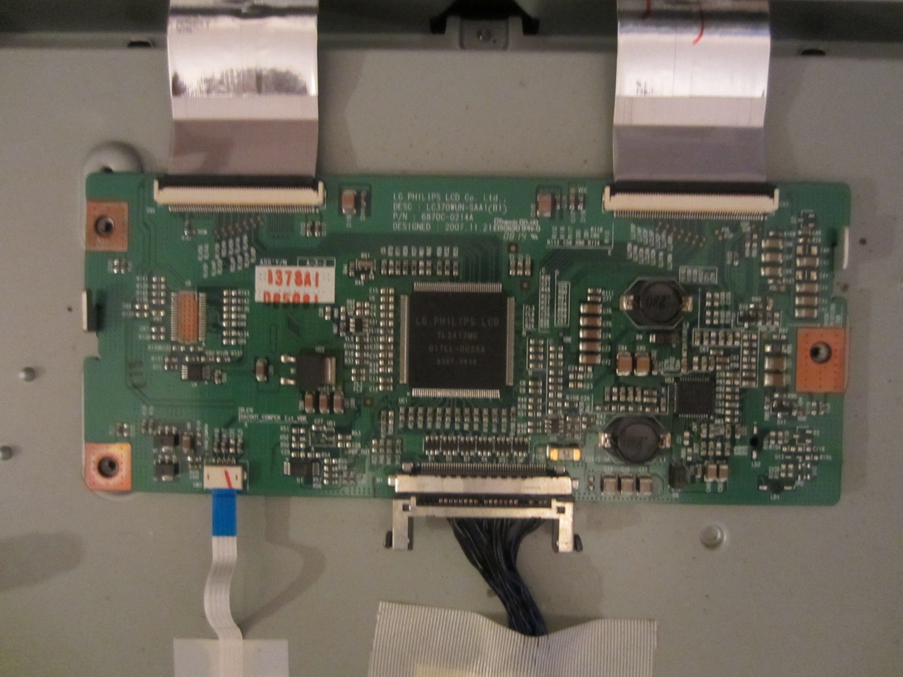

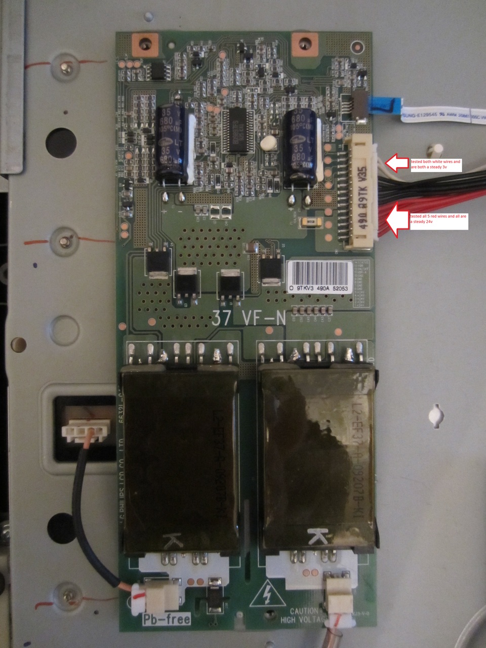

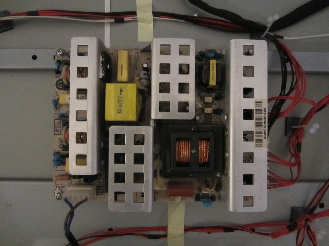

          WHOLE LAY OUT:
          POWER BOARD:
          INVERTER also shows where I have already tested)
          MAIN BOARD:
          PICTURE IMAGE BOARD: (well I think that is what it is for)

                  So when the backlights go out the 3VDC on those two pins still present? I'm beginning to think you may have bad soldering works problem on the lamp assembly or lamp sockets if it uses socket type.

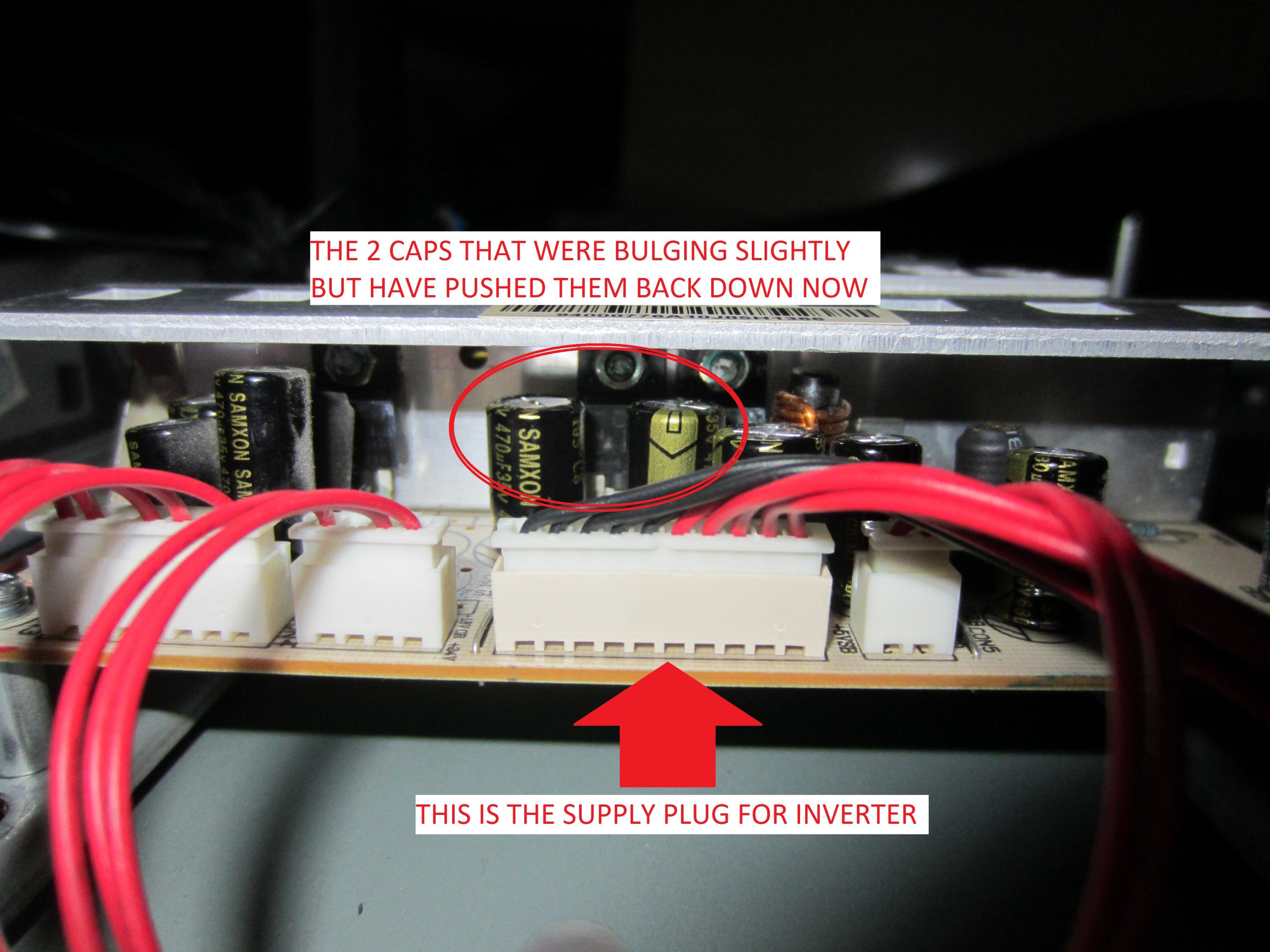

                    I have spotted a slight bulge of a cap under the right hand shield on the main board that I didn't see at 1st until I took it off for a closer look. It is just to the left of the output wires that lead to the inverter. Possible cause?
                    The cap is a SAMXON 470u F35v 105c and I did read that brand are quite troublesome?
                      Yes, bad Samwha on the inverter can easily cause your problem.

                            What caps are going to be best to use if I need to replace them?
                            Oh and yes the voltages to the inverter are fine when the light goes out.

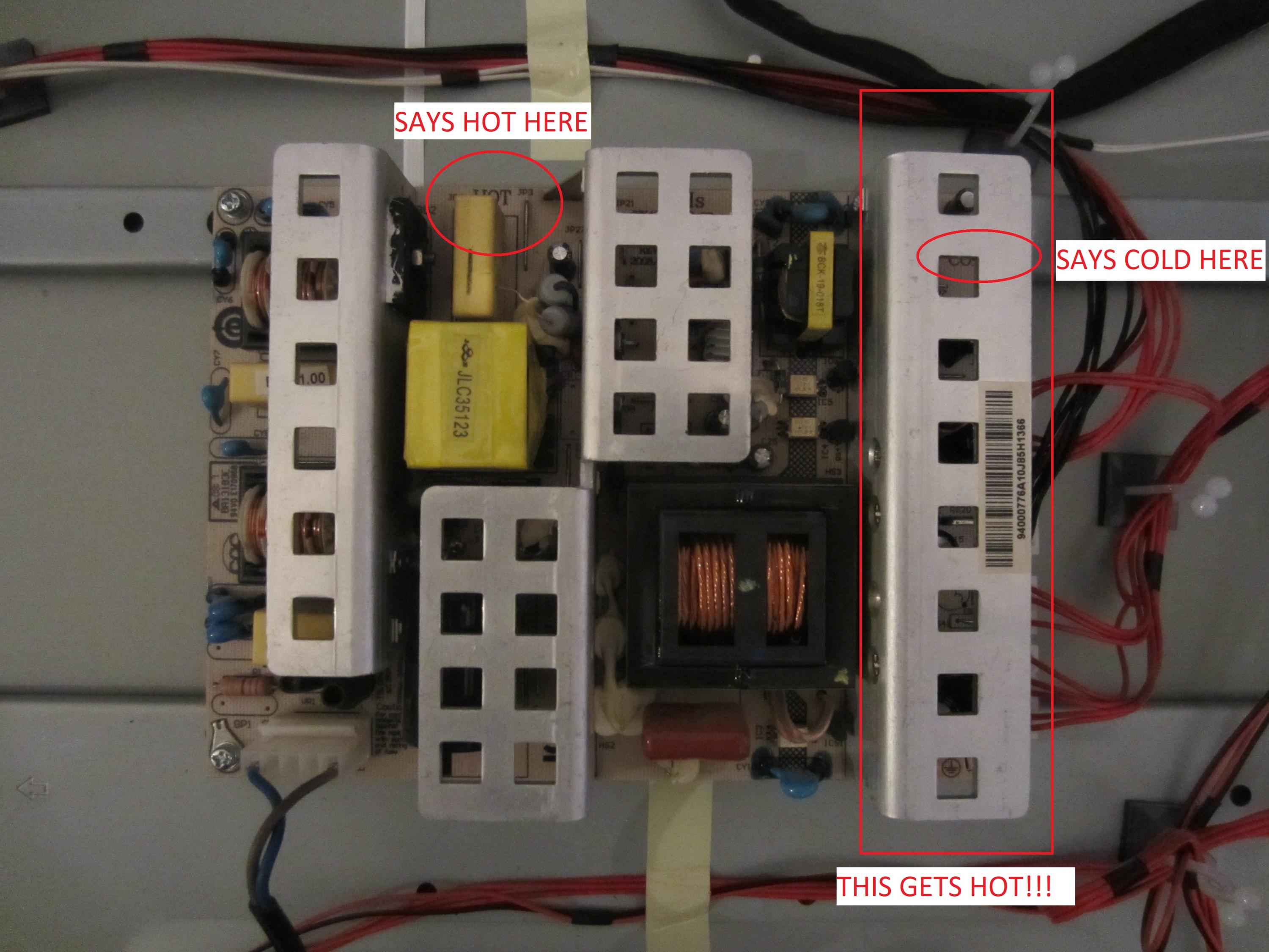

                            Also I have noticed something weird on the main power board today.
                            After powering up to check the voltages I left it on for a few mins after testing once the light went out and found that the power board gets hot on the cold side. I'm sure that's not right.
                            I have indicated below where it reckons it should get hot and where it DOES get hot.
                            Also pictured here are the caps
                            Originally posted by Attached images
                            • cheapie
                              null
                              • Jul 2010
                              • 849
                              "HOT" and "COLD" refers to voltages, not temperature. As in, don't go touching stuff with your bare hands on the "HOT" side while it's plugged in.

                                replace the caps with panasonic fm,if those caps were bulged id expect a lot lower voltage than 24v ,those caps feed the supply to the inverter,can you measure the outputs to the inverter?on dc volts/200v on your multimeter.
                                fixed so far...376 lg lcd tv's,24 onn tv;s,24 panasonic lcd,16 jvc lcd,12 marshall jcm800 amps,refurb of various disco equipment lighting,old style disco decks ,and a flymo!
                                please let us know if everything works ok if your tv gets fixed, as it will be and aid for anyone else having the same problem and wishing to fix it.it would save people clogging up this site with topics that are duplicated,and can be found easily using the search function.,and taking up valuable space.enjoy your fixed tv!,hopefully!
                                  Trust me to take it literally! Thank you cheapie
