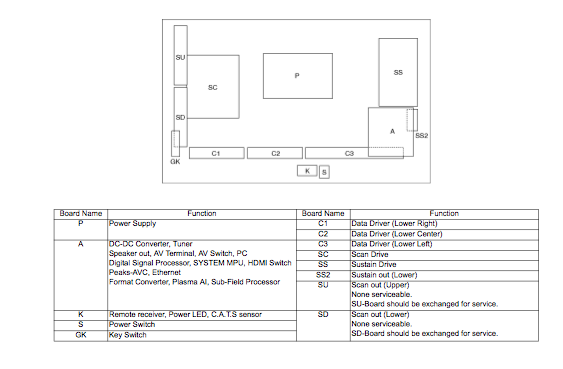

                  #88
                  Re: Panasonic TC-P50G10 10 blink code
                  screen shot of the manual. there are some different numbers for the ss & sc boards.

                    #89
                    Ah ok, I'll clarify.
                    On the SC board, disconnect plug at SC2, (Vsus from the PSU)
                    On the SS board, disconnect plug at SS11, (Vsus from the PSU)
                    Eseentially we're isolating all boards except the PSU and A board so if a blink exists it will be only one of those 2 boards causing the trigger.
