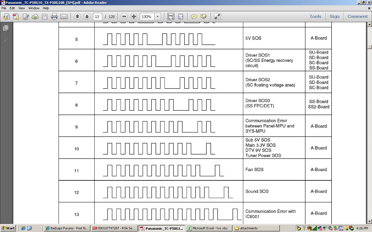

    I haven't yet taken it apart, but SM says
    Sub 5V SOS
    Main 3.3V SOS
    DTV 9V SOS
    Tuner Power SOS
    Check point A-Board.

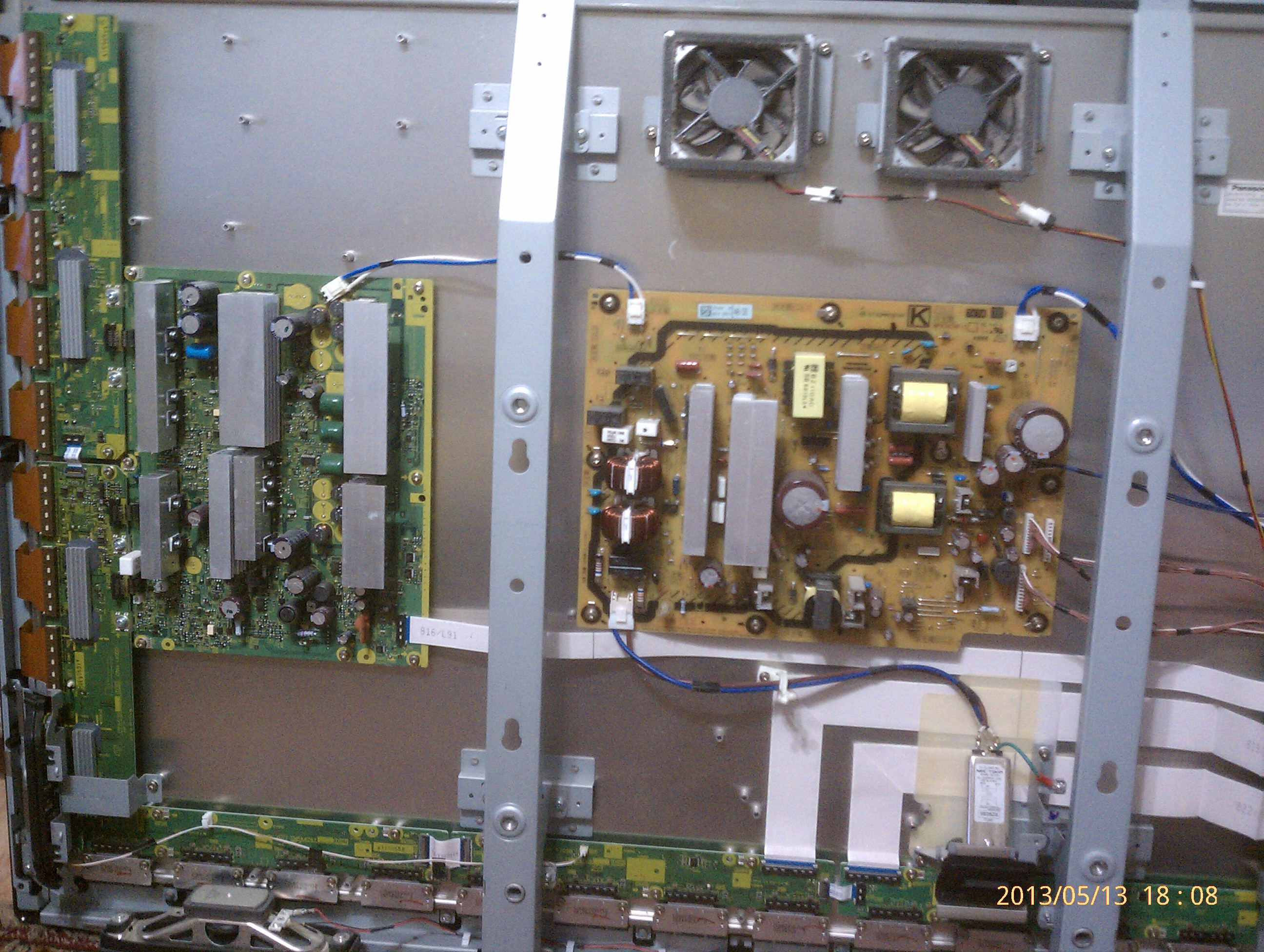

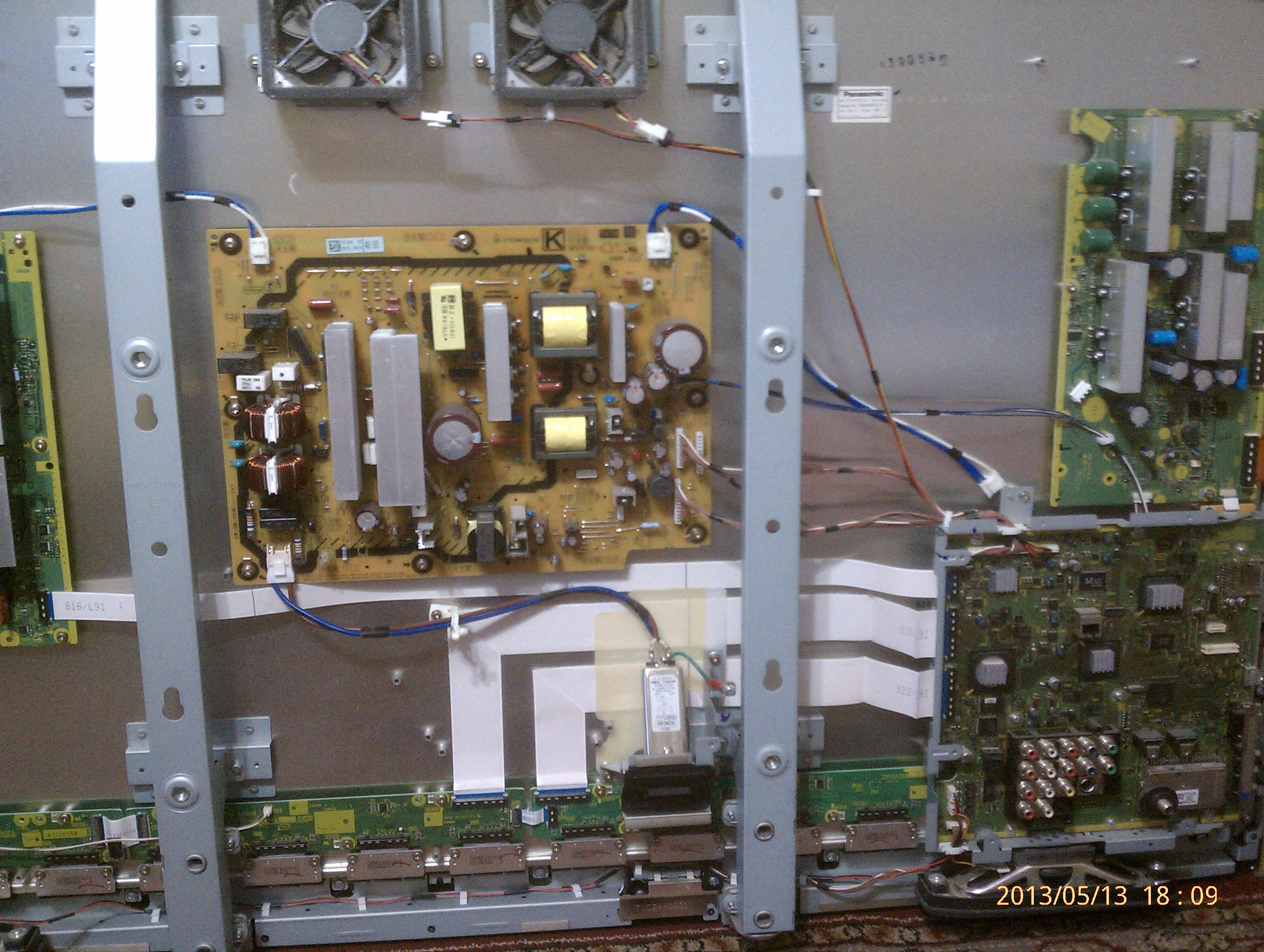

      Im a little lost here Im not sure what Im to be checking here, Im getting 5v going to A-Board but that's about it as LED is blinking. I've disconnected buffer boards, SS and SC boards individually and no change.

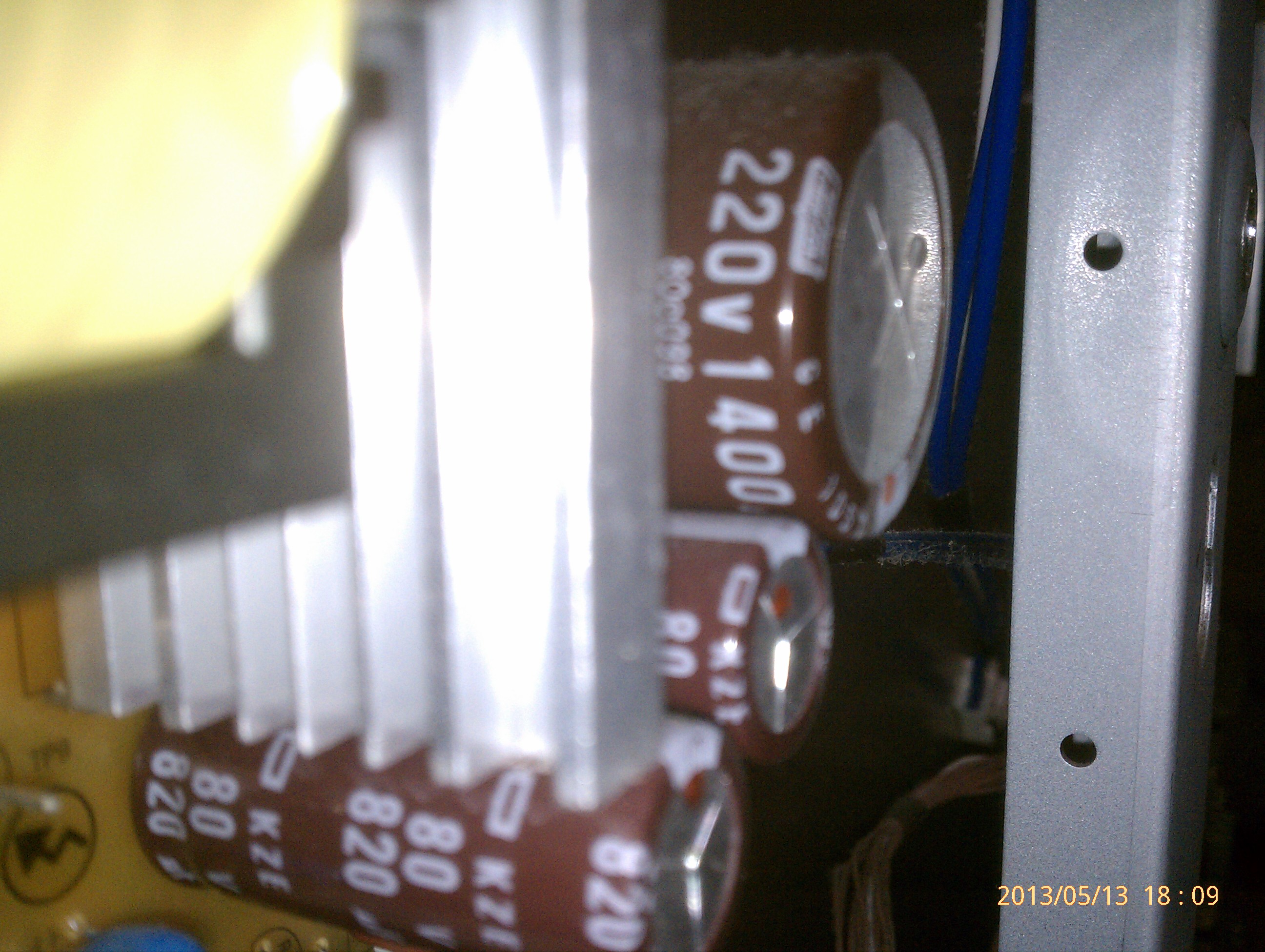

      There is one large cap on the PS board that has a slight bulge on top but not sure if that's normal.
      Any quick way to t/s this down to a certain board, or is A-Board failure common?

            10 blinks probably not SC, but here's how to isolate: disconnect control and power connectors, leave panel connected. If standby lights up then when powered up throws 6 or 7 blinks it's the SC. Repeat with SS. If it throws 8 blinks it's the SS.
              Re: Panasonic TC-P50G10 10 blink code
              OK Tom I think I did what you asked but to be clear there is a power cable going from the PS board to both SS and SC, and either a ribbon or smaller connector going from A-Board to both SS and SC.
              I disconnected both on each board seperately, and still get 10 blinks.
                This means the SC, SS are not short and they are not causing your 10 blink problem.
                Other things to check are the lower driver connectors. Disconnect those white flex ribbons going to the bottom of the plasma panel (to the C board then to the panel.)

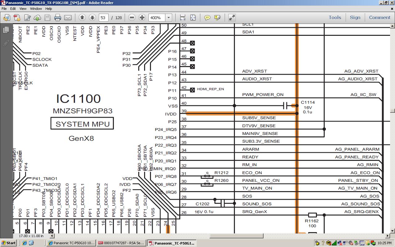

                    Yep. You can look in the A board schematic for 9V, 5V, 3.3V and tuner test point.

                        This schematic is intimidating, I found a test point for Sub 5V (most appear to be on bottom of board), but should I expect to see "Main 3.3v, DTV 9v, and tuner power" on schematic or am I just looking for those voltages..

                          How I'd do it is trace down the microcontroller (hint: SYSTEM MPU) on the A board. This is ultimately what generates the SOS blink code. Some pins will be configured to read the supply voltages. They are labelled, you will see them.

                                  Open PDF, Ctrl+F "System MPU" then wait till you get to the schematic with the GenX8 micom on it. Panel micom deals only with 6,7,8 blinks.
                                  There are pins on the micom which have the 5V, 3.3V etc detect signals, so you'd end up testing those for a HIGH (>2V.) If this is not present, then that is where the fault is.
                                  There's also a TUNER SOS signal which may cause SOS10 but I'm not 100% if that should be high or low.

                                    OK found IC1100 on bottom of board, checked pins 35-38, all show 0v while flashing blink code. Is this something that needs to be checked as soon as plugged in or it shuts down, or should those voltages be there?
                                      Ok I checked them each immediately while plugging in because it was shutting off voltages after protection:
                                      SUB3.3V_SENSE = 2V
                                      MAIN9V_SENSE = 5V
                                      DT9V_SENSE = 0.7V
                                      SUB5V_SENSE = 0.7V
                                      grr just realized those are not all the ones listed Im tired..
                                        Alright
                                        SUB5V = 0.7V
                                        MAIN3.3V = 5V
                                        DTV9V = 0.7V
                                        Didn't located tuner power yet..
