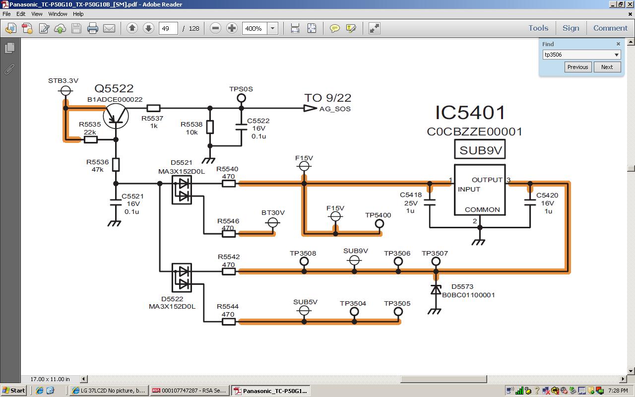

              #66
              Re: Panasonic TC-P50G10 10 blink code
              Ok Tom last question on this one until I get the new parts, I'd like to make sure Im getting the 9V output before it starts hitting everything else. I don't see any easy way to do that..
              Can you suggest anything.? Also is there a way to measure the current on this line in the few seconds before it shuts down?
              From what I can tell, the only other places the 9V goes that I haven't eliminated is the AV jack on the back of board (RCA, Component, etc.), and the side jack which is just RCA. It seems likely this surge may have come thru one of the analog inputs from whatever it was connected to though.
              It does the HDMI also but I had isolated that IC already.

                #67
                Lift the OUTPUT pin and solder a 1uF capacitor between it and ground. Measure output. Then, put your meter in the 10A range (connect red probe to 10A jack) and measure the current going from the output pin to the pad it used to connect to.

                  #68
                  Ok I will try this.
                  Racking my brain over this and check D5573 again in circuit and see its reading in both directions. I had removed this first as it showed short in both directions and it tested OK out of circuit. Now it's not showing short but just reading around .700 both ways. Is this a "protect" diode that can be removed for testing?
                    #69
                    Sounds like the diode has failed leaky. You can replace it with any ~10V zener diode.

                      #70

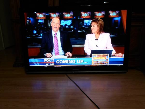

                      I think I've got this A-Board fixed!
                      The 2 IC's that were causing the short seemed to be the only original problem, the secondary problem that was loading down the 9V was due to me removing this tiny diode D3089 to check it and I accidently re-installed it across an adjacent pad. In the picture where D3707 is there is no actual component on the board.
                      I was staring at the schematic and something didn't look right and it finally dawned on me..
                      I replaced the shorted IC5480 and TV comes on.
                      IC3001 described as Video SW/Audio SW is a 100 pin chip I still have not replaced yet but TV comes on without it for now with 9 and 5V removed from it, and should work with at least HDMI.
                      I'm super lucky that I noticed that I made that mistake with the diode I may never have found that..
                      Tom thanks again I appreciate the help, I actually froze this board good this morning and tried the 9V battery again but nothing seemed to happen I have a new power supply on the way though.

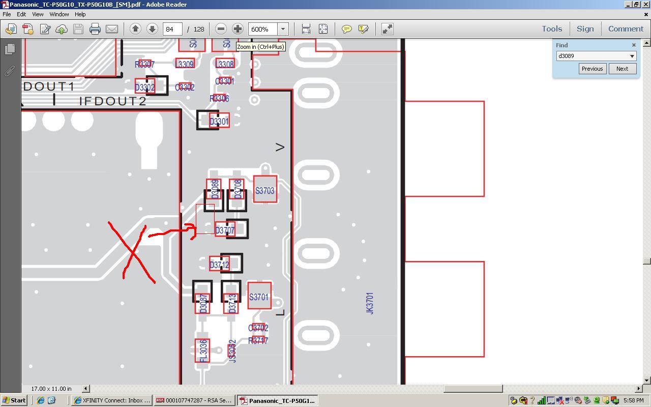

                          #72
                          Yep at the least all 3 HDMI ports are working with sound, so it appears only the analog input is affected by the other IC. Maybe just component.
                          I removed that IC last light, it was kind of stubborn and a few pads did come loose. A couple that came all the way off look like they may not be used so Im hopeful to get it working at least 95%.
                          I shoulda took a break from it for a bit, I wind up getting impatient.
