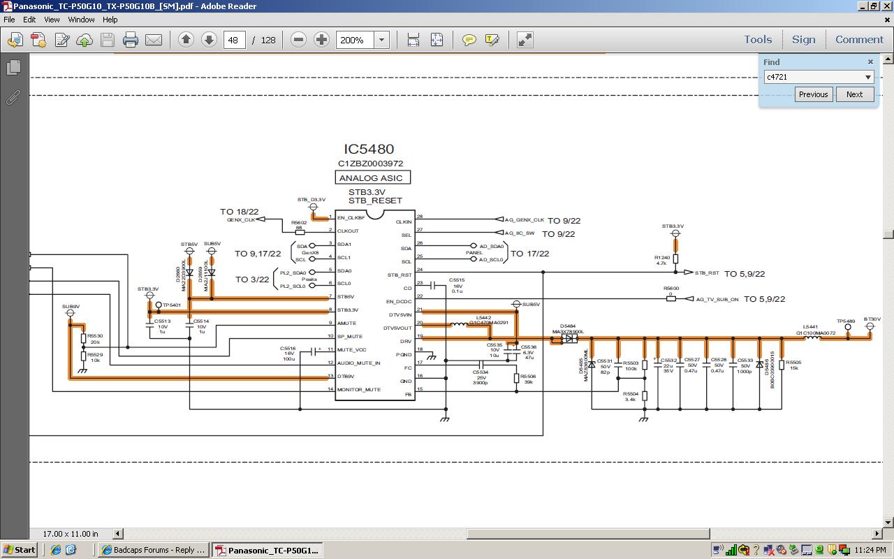

          #44
          Re: Panasonic TC-P50G10 10 blink code
          Thanks Clydeuk bring it on! It's pretty much a dead short to ground at all 9V test points Ive found.
          I have just went thru the 22 pages of A Board on the service manual and wrote down wherever I saw the SUB9V lines, there is about 8 along with the page in manual if you guys have any thoughts to what is likely to fail, Im going to start to try to isolate each if possible..
          IC5480 - Page 48 - Analog ASIC
          IC5401 - Page 49 - 9V regulator IC and detect circuit
          JK3000 - Page 51 - AV terminals - bunch of diodes
          JK3701 - Page 52 - Side AV terminal - 3 diodes
          IC3001 - Page 52 - Audio Video SW IC
          IC1100 - Page 53 - System MPU - Detection
          -------- Page 56 - HDMI ports
          -------- Page 61 - SUB9V just going into 3-7 capacitors

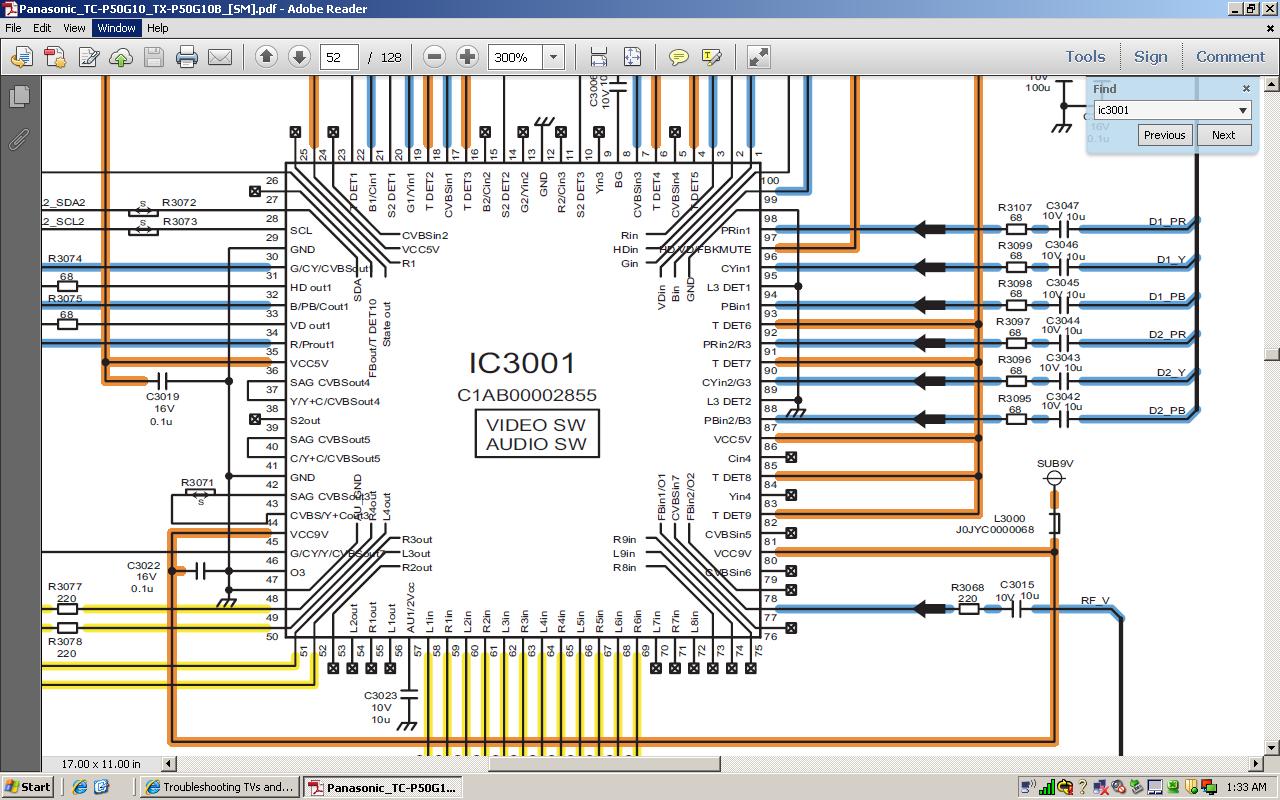

                      Ok Ive still not given up one this one... I've isolated a couple 9V points so far without finding the short, so I came to this IC and decided to cut the trace at pin 13.
                      I still have a short to ground on both sides of the cut trace, the chip side is just slightly lower ohms than the other side.
                      Does this mean that IC is shorted and something else is too, or am I missing something else?
                      • kevinm34232
                        • May 2012
                        • 1884
                        #51
                        Ok found the problem(s). Removed L3000 and short went away. IC3001 and IC5480 both are shorted.
                        Not sure about replacement of these! I think I will check to make sure 9V is back now that those are out of the circuit and if TV comes on..

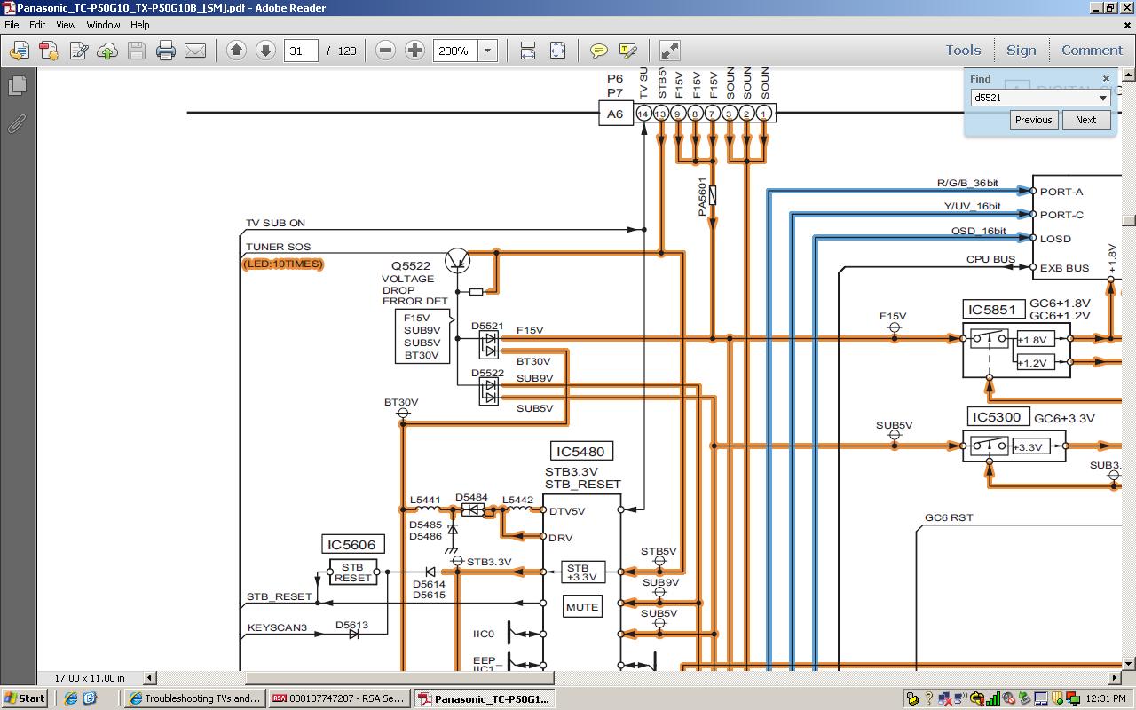

                                  #56
                                  Is there a way for me determine that? I have the 9V removed from the 2 bad IC's, I think the only place it's still going is the system MPU.
                                  I also rechecked the other voltages at D5521 and D5522 in pic, I have the F15V (14.4v actual), the 30V, and the 5V, just not the 9V.
                                    #57
                                    You need a power supply capable of a little more than the 9V battery you have. 6xAA may do, with a resistor of around 18 ohms, to limit the current to around 500mA.
                                    Ideally, you would use a constant-current constant-voltage bench supply, as it would work a lot better.

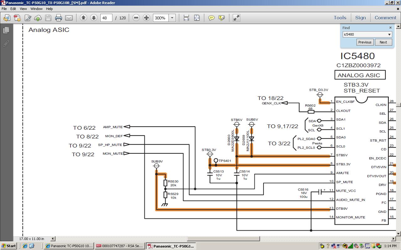

                                      #58
                                      That's fine, but at this point I don't what else am I looking for that could be not letting the 9V come up?
                                      I'm guessing here but take a look at the IC5480 schematic. I cut trace at pin 13, but you can see there is also a connection to pin 9 thru R5530, do you think that's a possibilty?
                                        #59
                                        R5530 is too high resistance.
