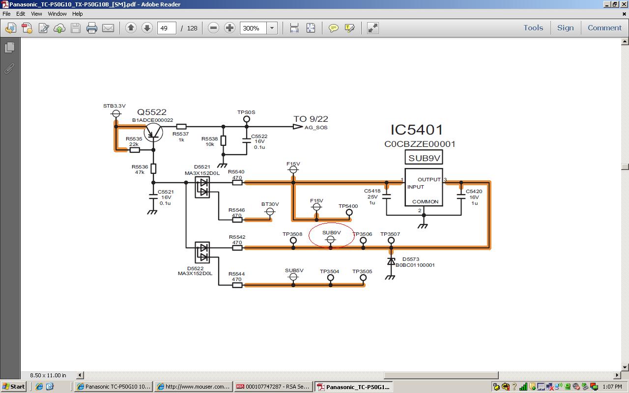

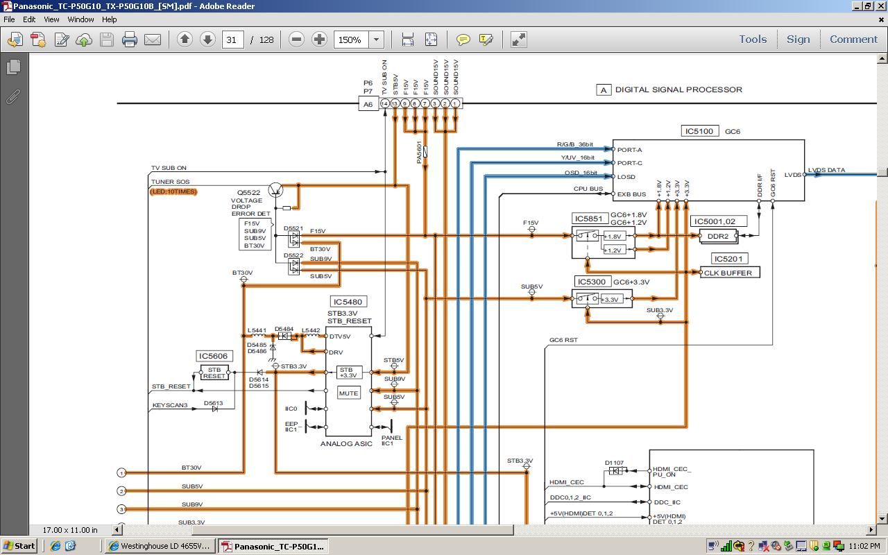

          Well Tom finding this page helps I was studying the actual schematic, any tips on isolating the faulty line I haven't had a chance to check anything yet, I am intending on making sure the F15V is present from PS board first then going from there, but those other lines go in a hundred directions Id like to isolate which one it is but I think Im gonna have to pull some components to do so..
            Re: Panasonic TC-P50G10 10 blink code
            You just need to find the 5V, 9V, etc. SMPS on the A board, do you know what to look for?
            This is a buck converter.
            http://www.maximintegrated.com/image...DI120Fig01.gif
            Sometimes the bottom diode is replaced with another FET. Part # of controller IC can vary.

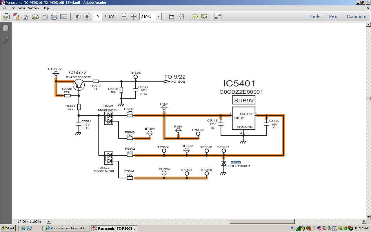

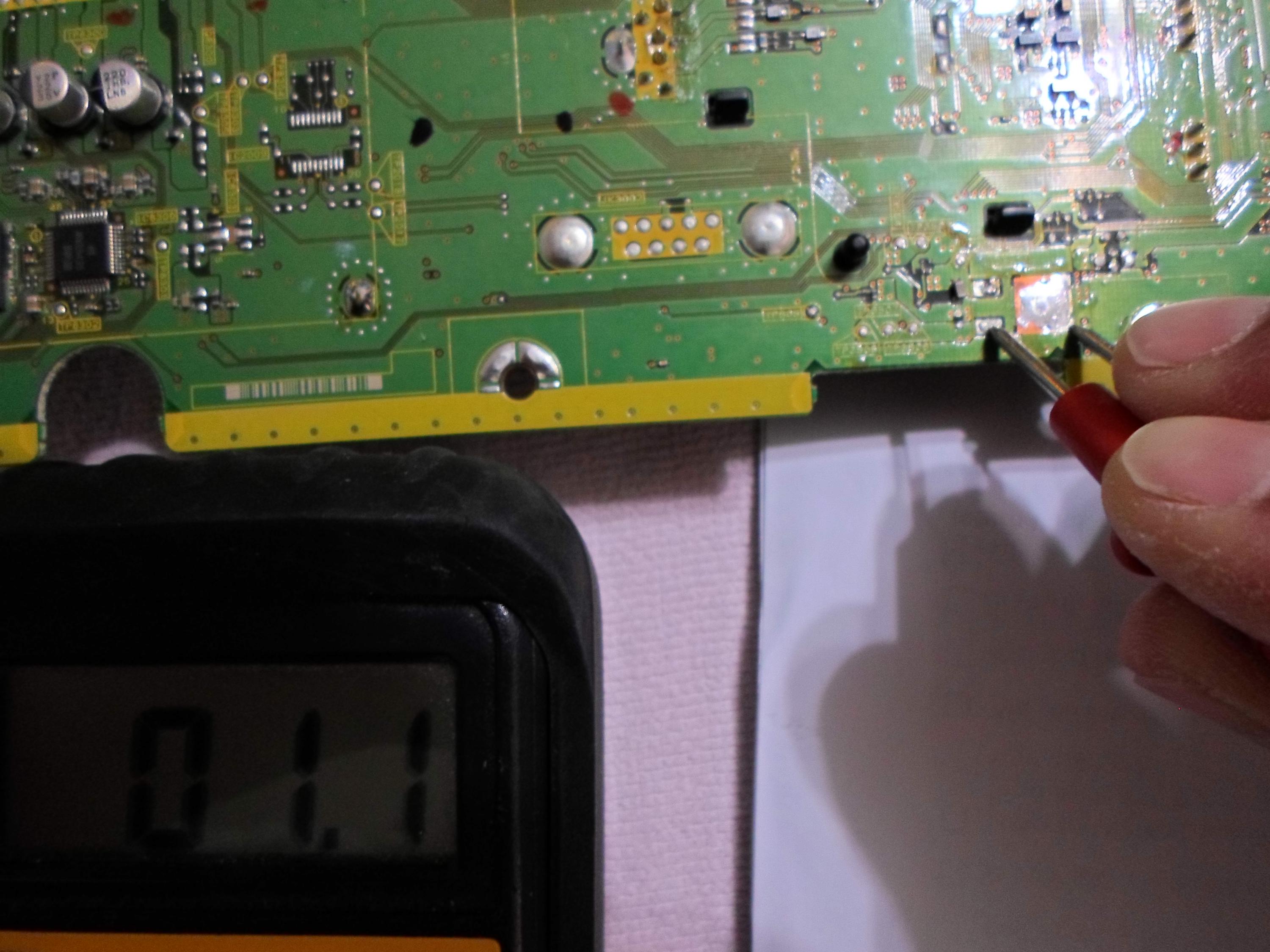

              D5573 shows shorted in circuit as does C5420, what's the best way to isolate, they are VERY small components??
                I would remove the diode, see if SUB9V rises, if not, replace it (you can move it so that it is soldered on only one pad), then repeat the same with the capacitor. Maybe the regulator IC has an output-ground short?

                  Maybe remove IC5401 BA178M09FP-E2, and check out of cct if gnd-out is also short as it's the same measuring point as the cap and the zener.

                    I thought I found the problem but after removing the diode, cap and IC one at a time, none are shorted out of circuit and the short remains between ground and output pads of IC. The diodes 5521 and 5522 test good. I tested input and was getting about 14.5v but no output.
                    Does that mean short is further down the SUB9V line?

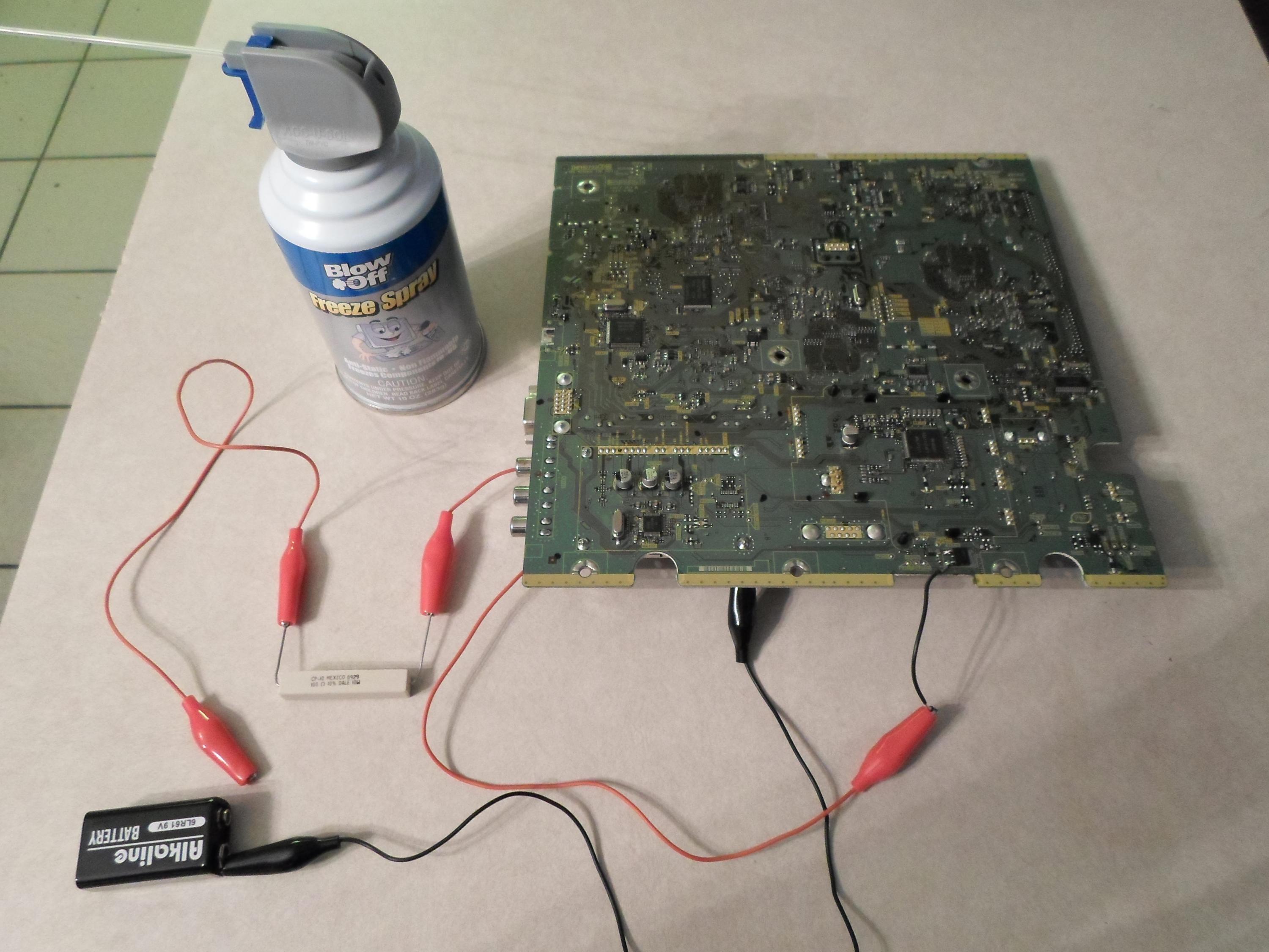

                      If you have a current limited power supply and a can of freeze spray you can warm up the failed component and this will be visible in the freeze spray.
                      Set the current limited power supply to 50~100mA, or use an 82 to 220 ohm resistor in series with a 9V power supply.

                        Thats a great idea. I dont have a power supply but can I do this with a 9V battery? Can you make a quick diagram to show me how it would be wired? Use some ground point on the main board and inject the + at the output leg of that IC above? Thanks!
                          #32
                          Yes, a 9V battery should be fine, but you MUST use the 100 ohm resistor, and the resistor will get hot, so I recommend using a 2 or 3W resistor. As far as explanations go, the TV should be off, the negative of the battery can go to the chassis or any good ground, and the positive goes through the 100 ohm resistor to SUB9V. Limit time to 10 seconds maximum every 30 seconds to avoid damaging anything.

                            OK I had to go to Radio Shack for the resistor, my choices there were 100 ohm 1 Watt and 100 Ohm 10 Watt (cement type) so I picked up a few of each, which one would be better?
                              #34
                              100 ohm 10 watt, as long as the leads are axial (on different ends.) If not, four 100 ohm 1W can be made into a 100 ohm 4W.

                                Didn't have much luck with this technique, I went thru 1 1/2 cans of freeze spray, everything defrosts so quick here in FL! But nothing got noticeably hot unfortunately. Maybe one of the ICs under heatsink?

                                    Yes it was unused and had 9V. Wonder if I should put the board in the freezer for like 20 mins first to give the freeze spray a head start, it just doesn't stay frosty for more than a few seconds...?
                                      #38
                                      Maybe. I've had no problem with freeze spray staying frosty for 5 minutes+.
