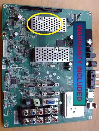

                        • mikeclarke
                          • Dec 2013
                          • 2
                          #32
                          Re: Vizio VT420M No picture - component cooler fix
                          I still have sound. Mine works when first plugged in for about 10 minutes then no picture but I still have sound. If I plug in back in again after 3-5 minutes it's still no picture. If I wait 30 minutes it will work again for 5 or 10 minutes.
                          After it fails if I unplug it and spray component cooler on the mainboard it works almost right away. I normally wait 30-90 seconds before I plug it back in.
                          I'm posting this pic to help me identify this part. What's inside this thing and what is it? Thanks for your help.
                          VT420M94501155
                          CBPF9D1KZ
                          LC420WUF (SB) (A1)
