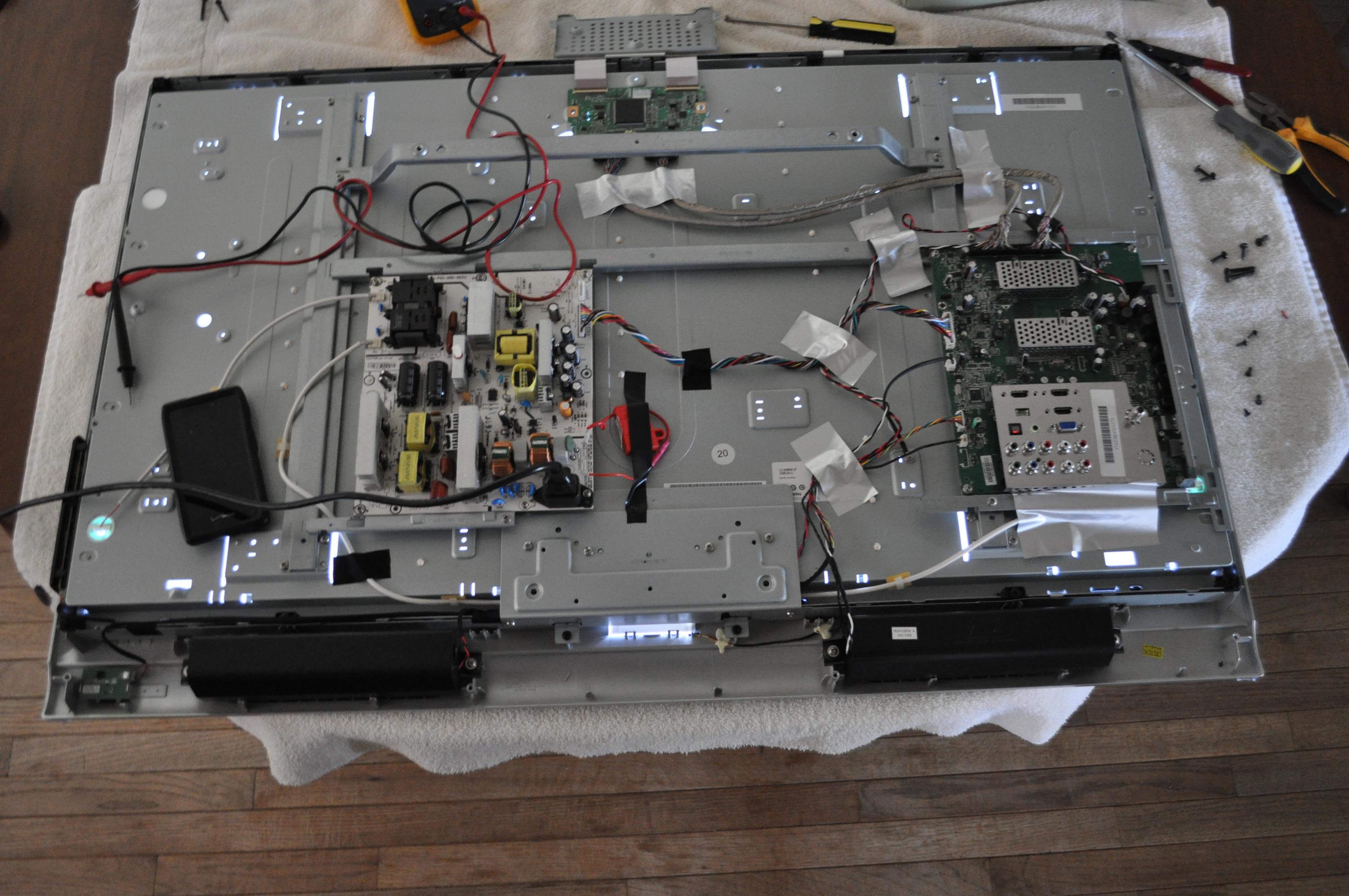

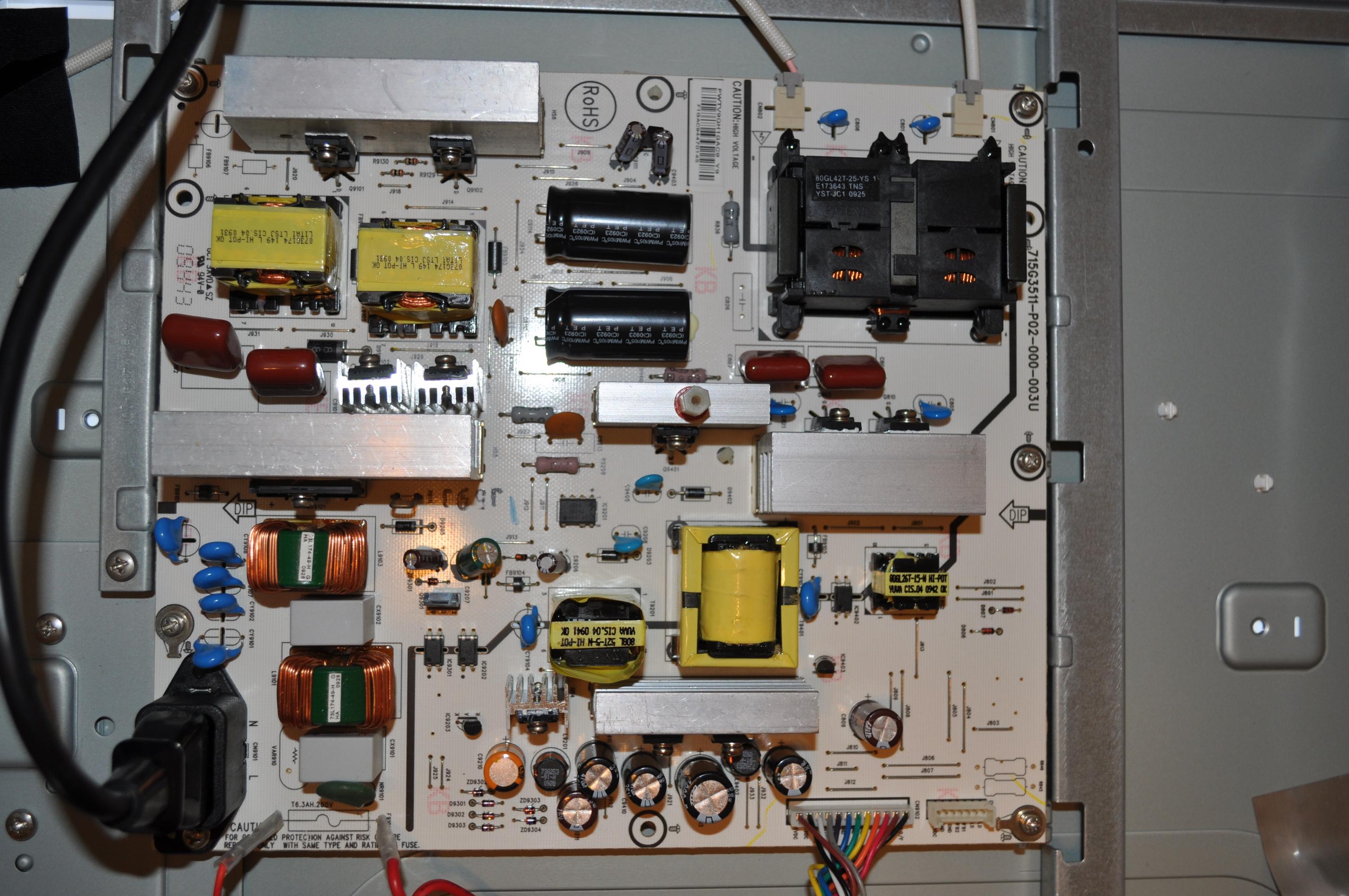

    I picked up another one to try to fix. I give the ones I can to relatives. This one is a Vizio. I have test the power board and all the proper voltages 5v, 12v and 24v. The back light appears to come on as I can see a faint blue background and the vizio emblem lights up. Any suggestions? As you can see I improvised the fuse temporarily as it was missing when I opened the TV????
    Re: Vizio VT420M No picture
    From the rear of the chassis you should see light come through some holes when plugged in, do you?
    • landyboy
      • Apr 2013
      • 443
      Yes I do.

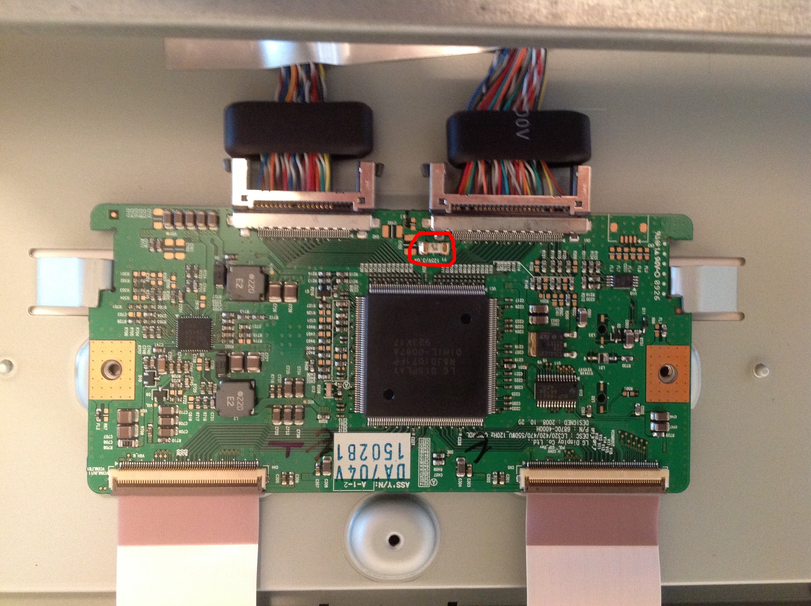

        The backlight is working, then. We will need a picture of the T-con board. Trace the leads going from the power supply. One will go to the top of the TV. This leads to the T-con board.
          Here you go....
            Both screws appear to be missing. Am I correct?
              It does look like that; is that how it came to you?
              Here is the fuse on the T-con.
              Check the voltage on both ends -- red probe on each end, black probe on chassis, tell us what readings you get.
                No voltage either side.
                  Yes this is how it was when I opened it up. I guessing it may have been worked on before but I'm not sure.
                    That was with the backlight on? No voltage either side means there's an issue on the main board.
                      Yes when powered up and turned on there is light in different areas. I have attached another pic.
                          I may have pulled a senior moment. Once powered up there is 11.38 volts each side.

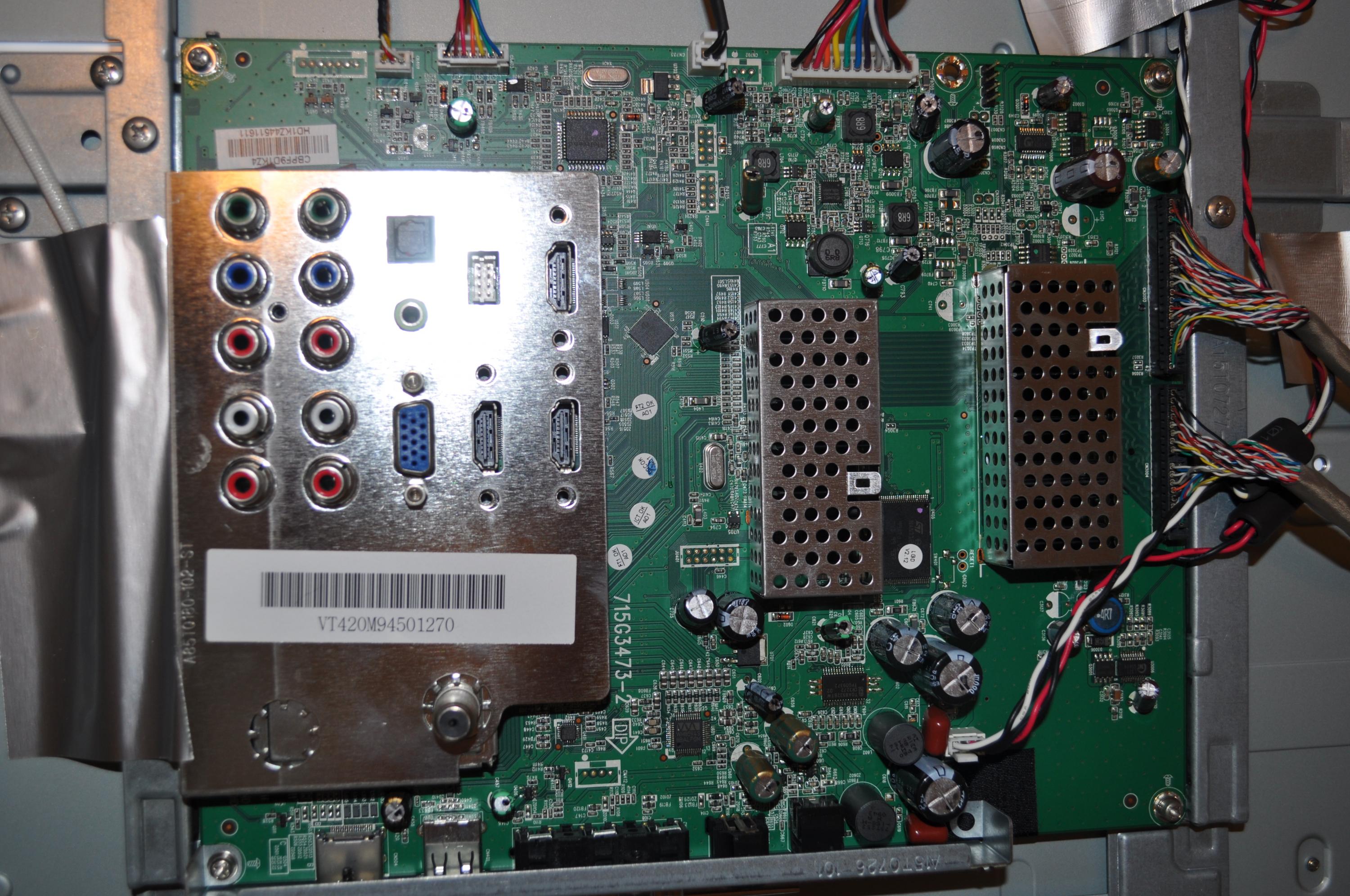

                            Either the main board is not sending a signal.
                            Or the T-con is defective.
                            It looks like T-con replacement has been attempted, so I would look at the main board.
                            Follow this guide:
                            https://www.badcaps.net/forum/showthread.php?t=22231
                                  Ok thank you I appreciate all your help, one last quick question. Is there any chance of repairing the main board?
                                    Probably -- did you see my post above re. voltage regulators?
                                      I will take a look at that now. I did notice when reassembling the Tcon cover I noticed the two screws I thought were missing actually go through the cover and the board so I'm not sure they changed the Tcon Board.
                                        That would make sense. I would personally recommend a t-con board exchange first, if it has not been swapped before.
