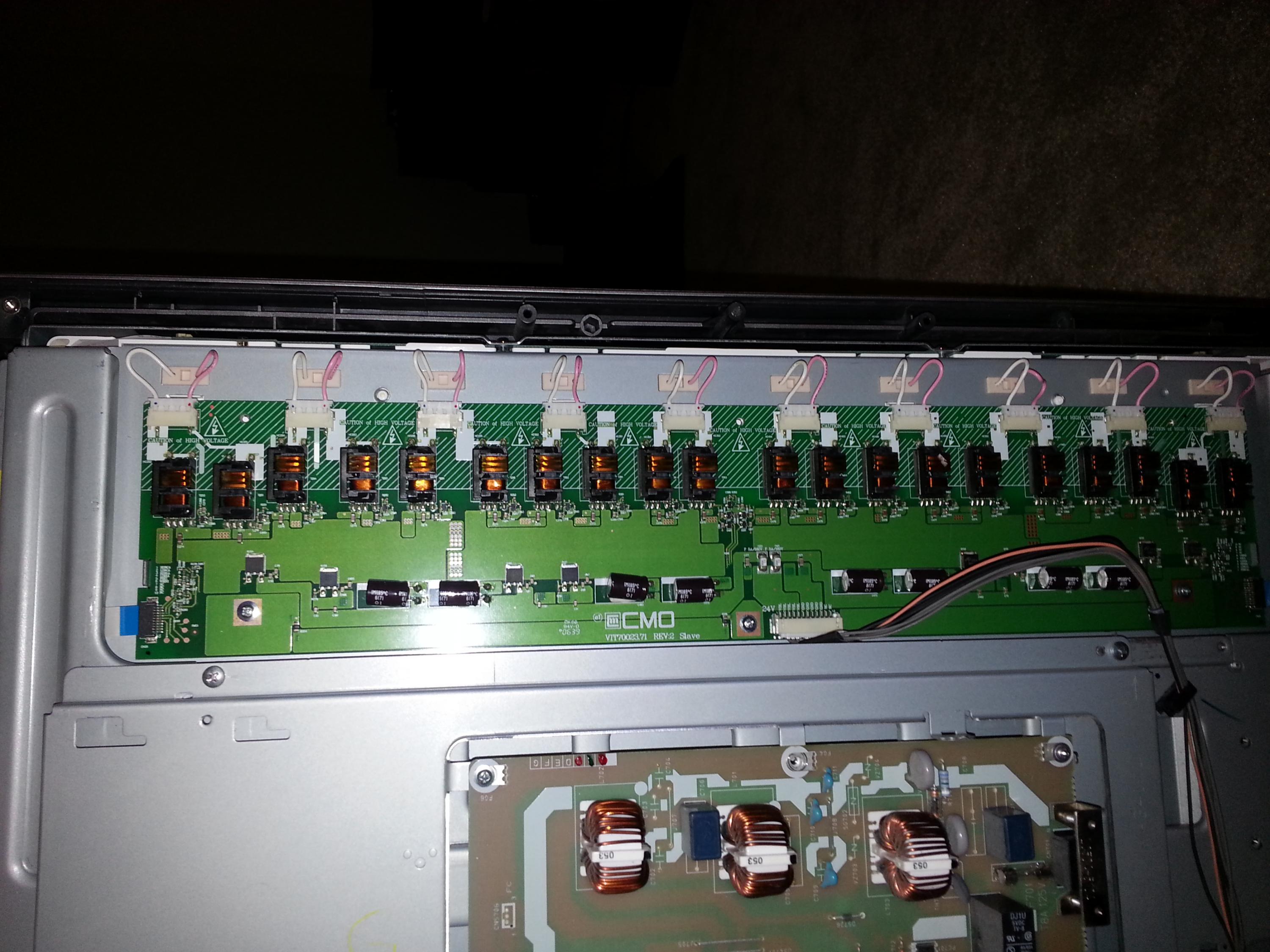

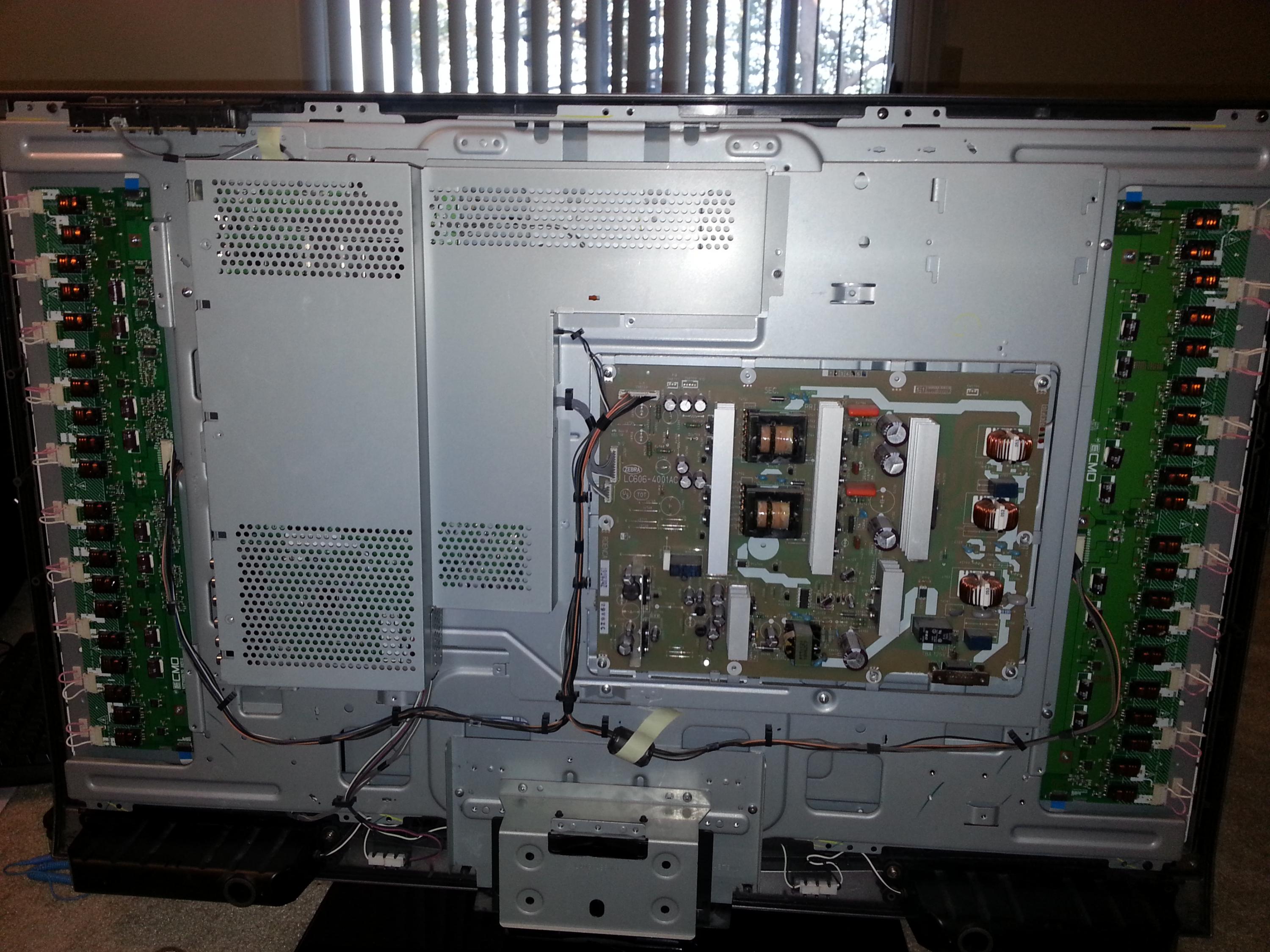

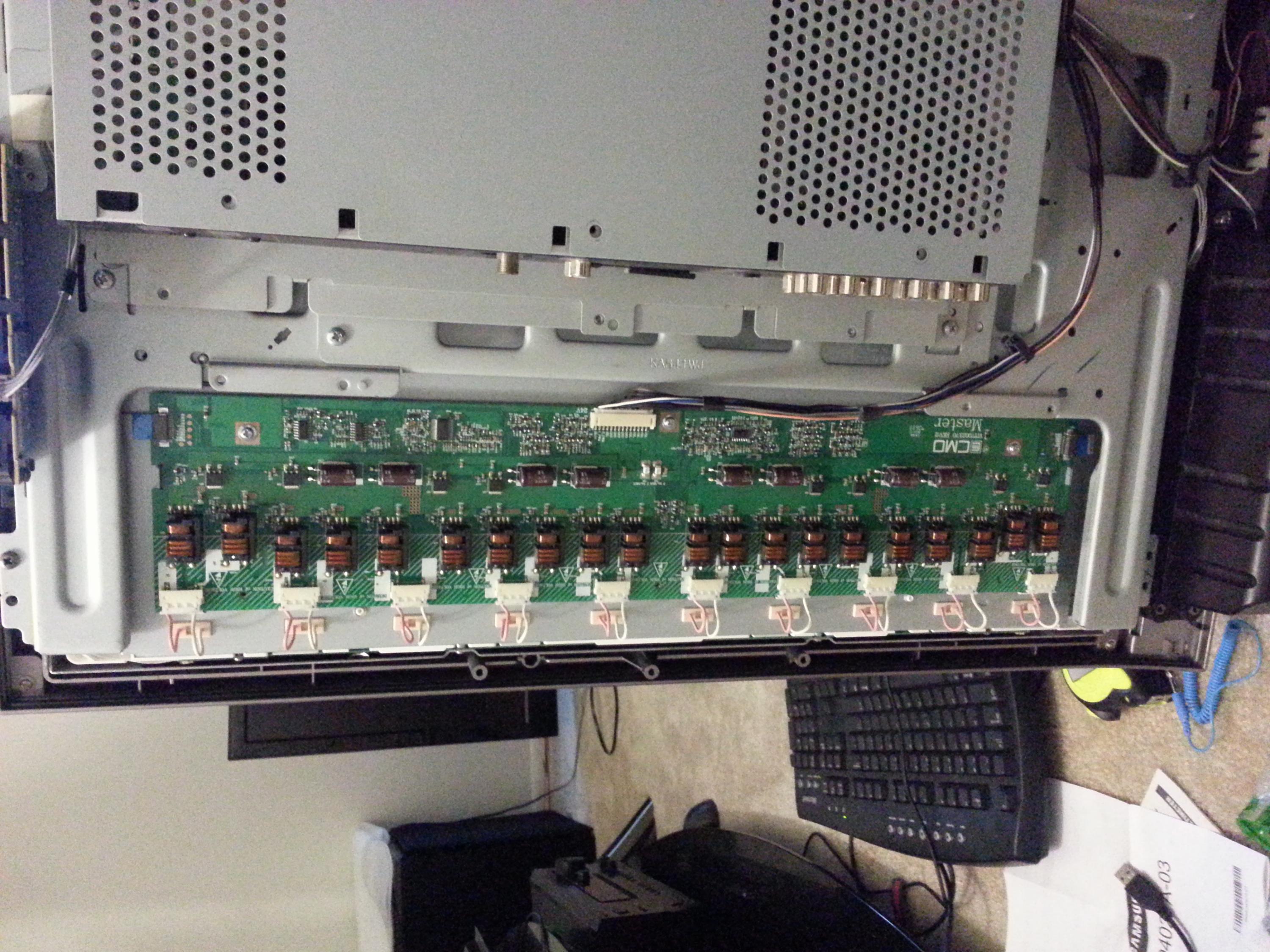

    Hello everyone.
    This is my 1st repair project.
    I bought this display broken. You can see the video with a flashlight, but there is no backlight on the screen.

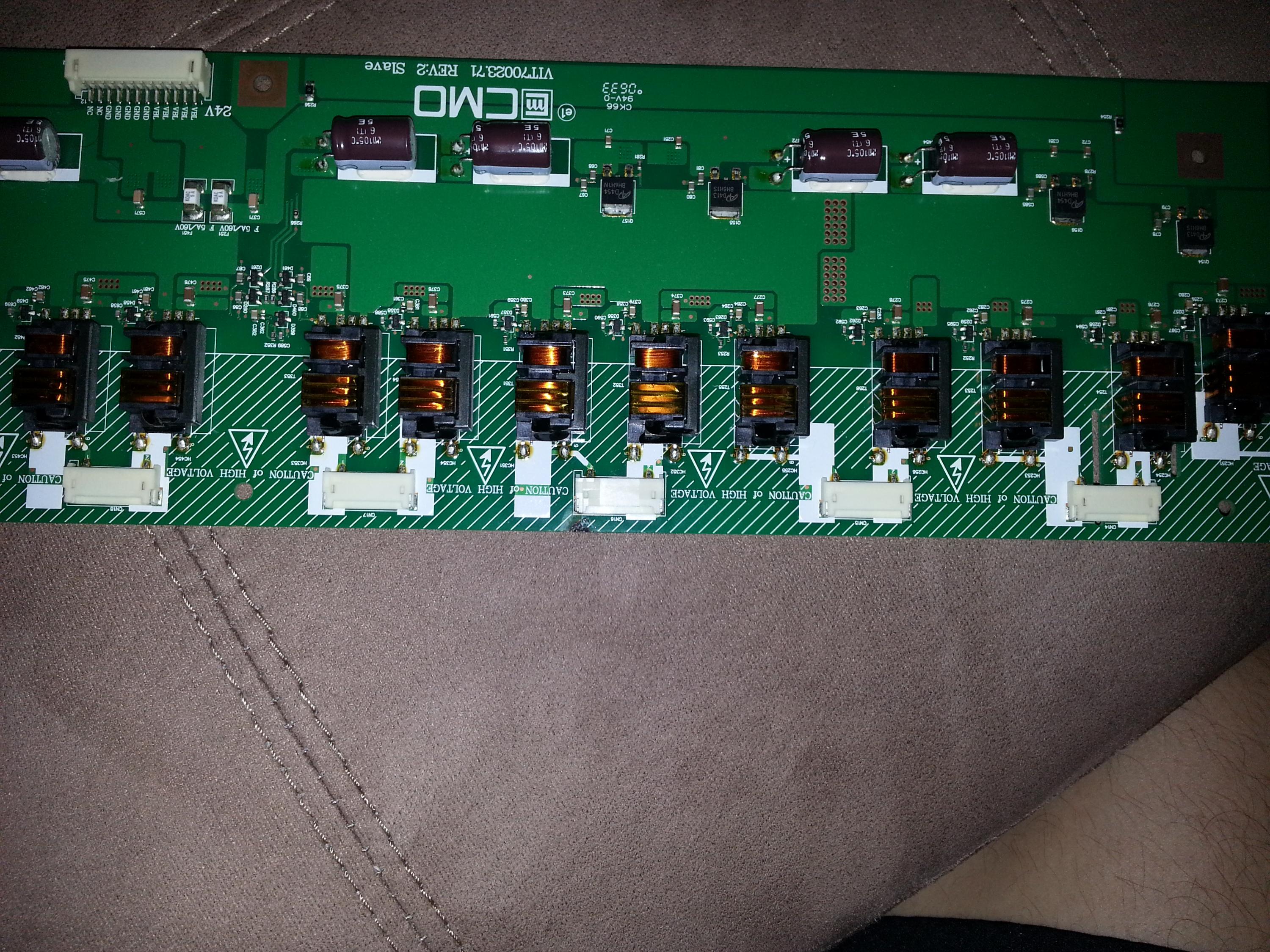

    After inspecting the inverter boards, i noticed that the slave was burned on the board.
    My question is, is it recommend to replace both Master and Slave boards at the same time?
    What should I be testing on the inverter board with my MM to find the cause of the failure?

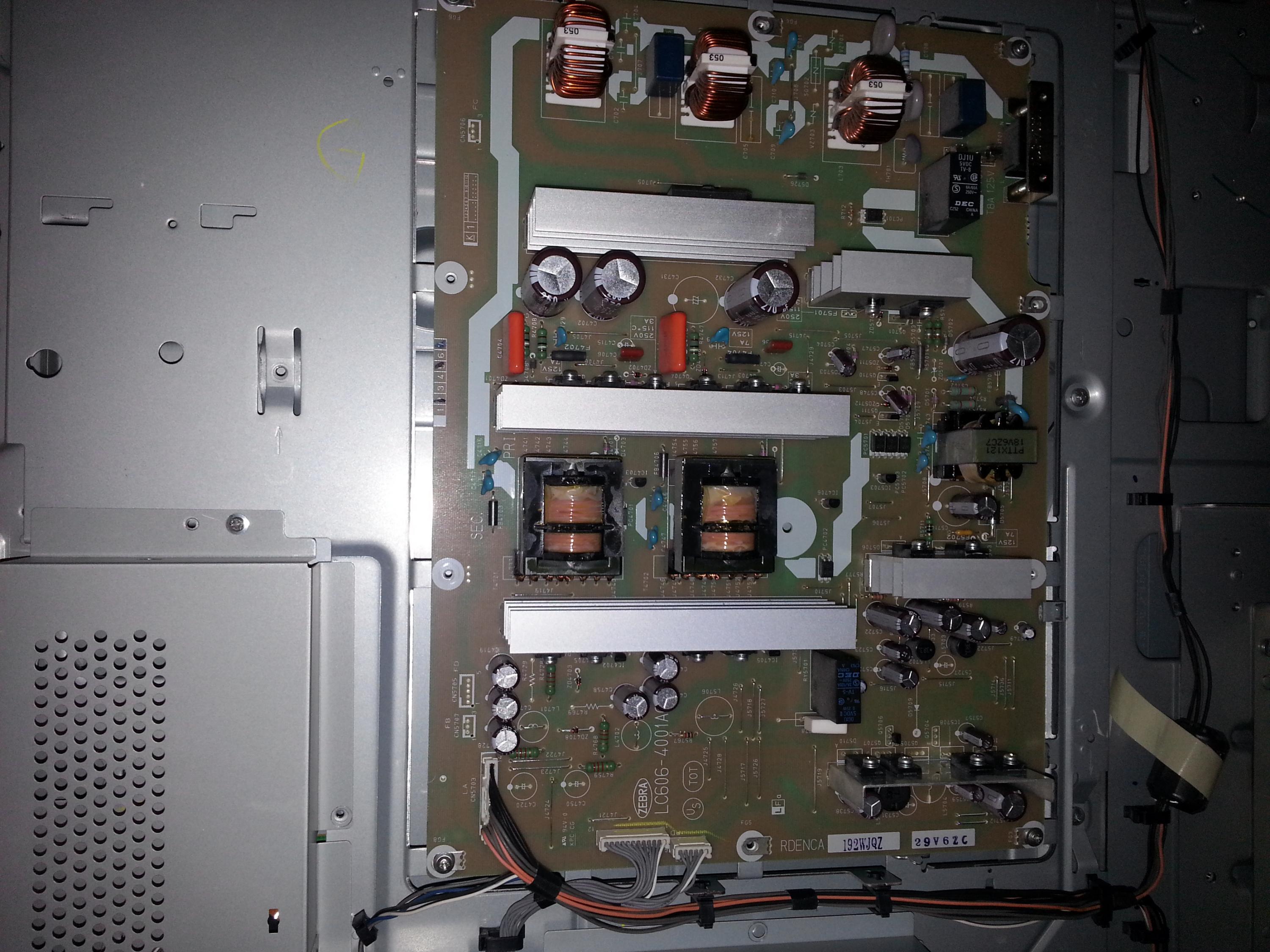

    Re: Sharp LC-42D62U Inverter board
    It's only necessary to replace/repair slave or master, not both.

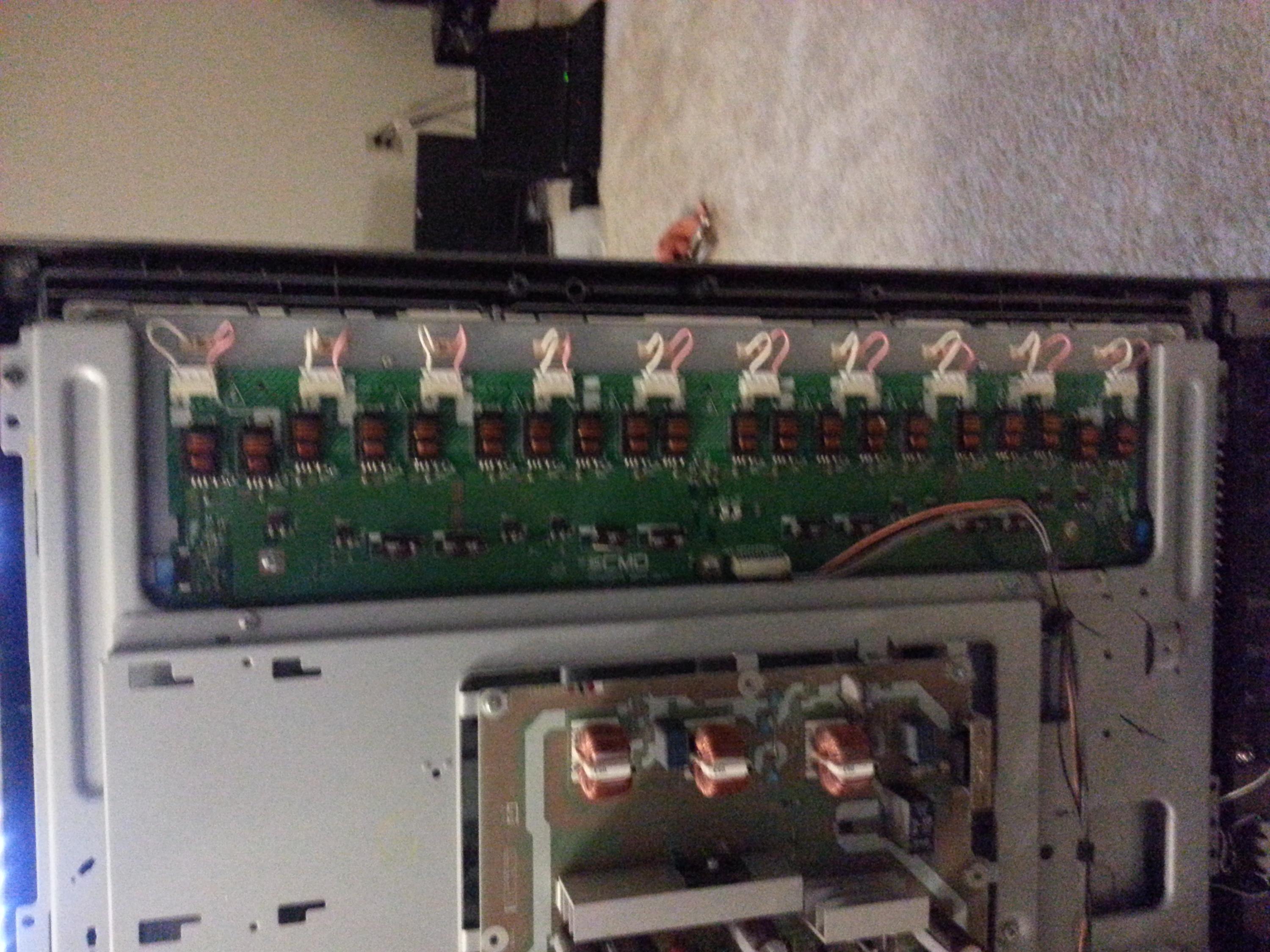

                So i received my slave inverter board and replaced it. It's the same issue, I can see the image with a flash light but there is no back light. What can I test to see if the master inverter is at fault or if it could be the lamp itself.
                Total noob here, sorry for the simple troubleshooting questions.

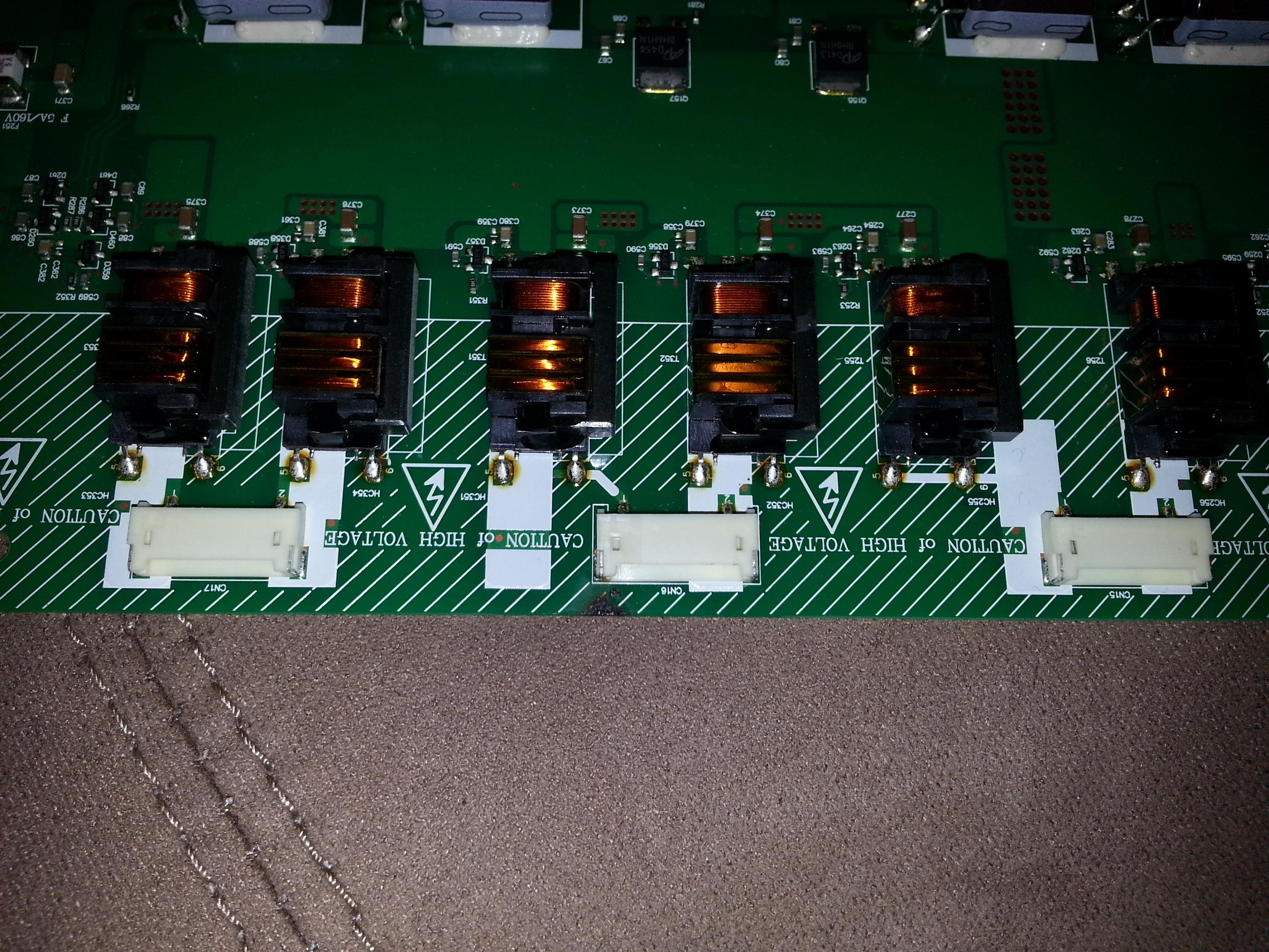

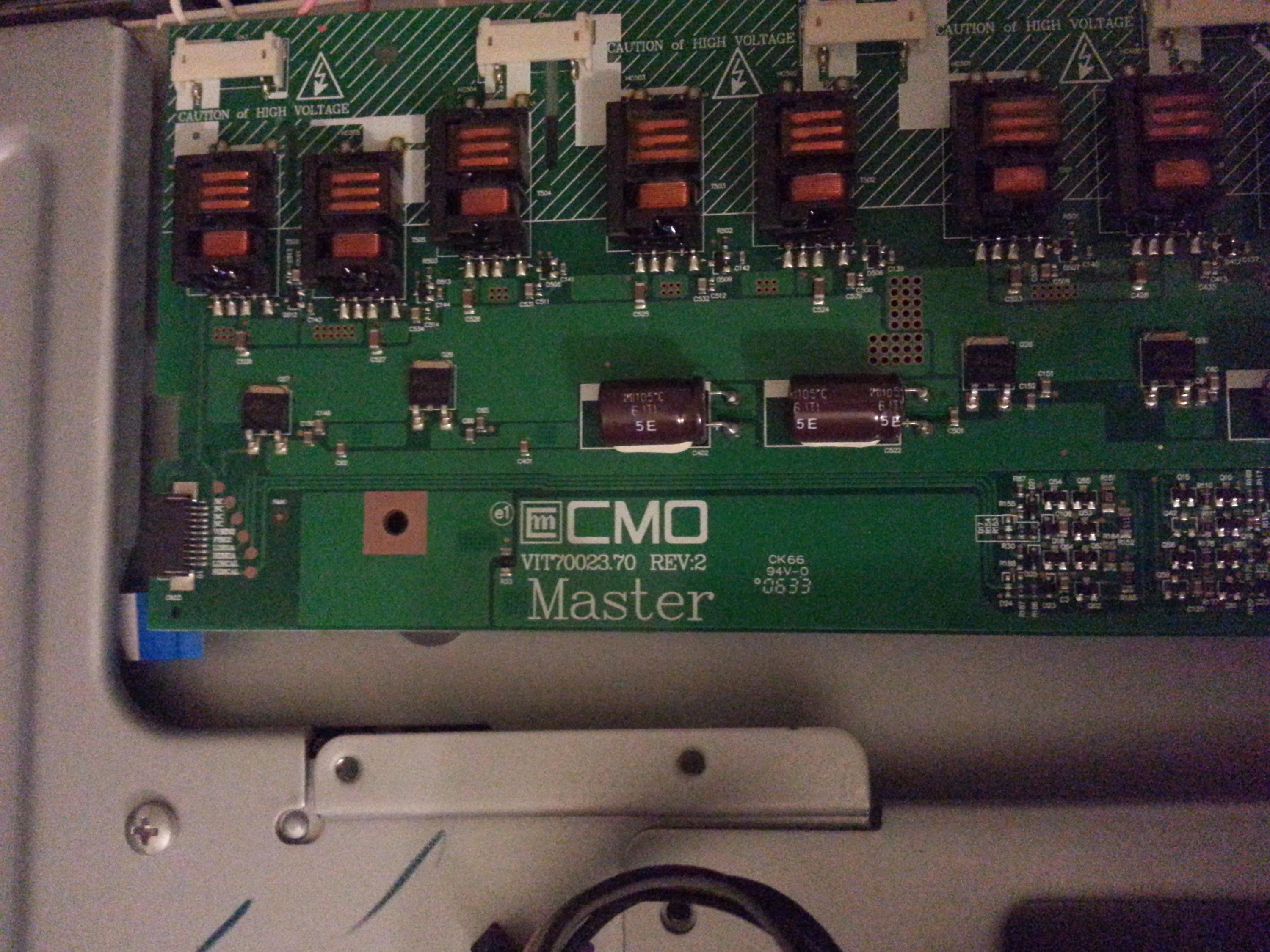

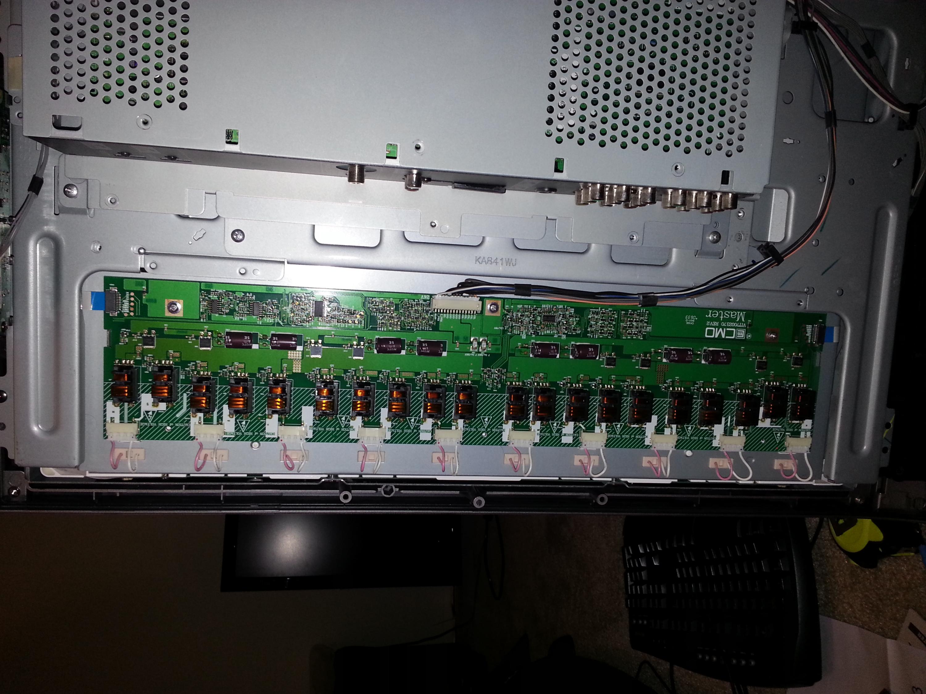

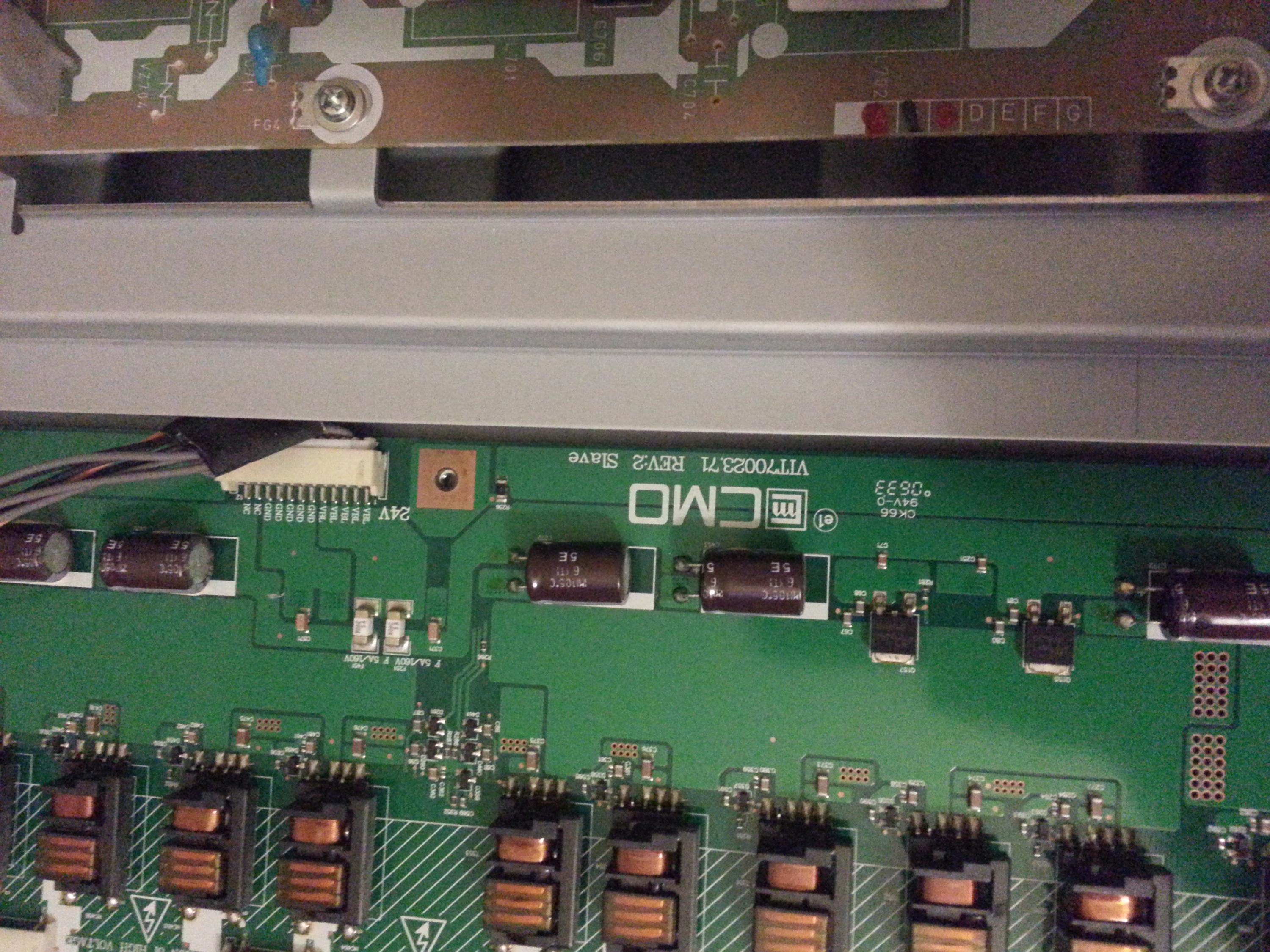

                  Here is a pic of the original slave inverter board which had a burnt mark. It's what made me think this was the issue.

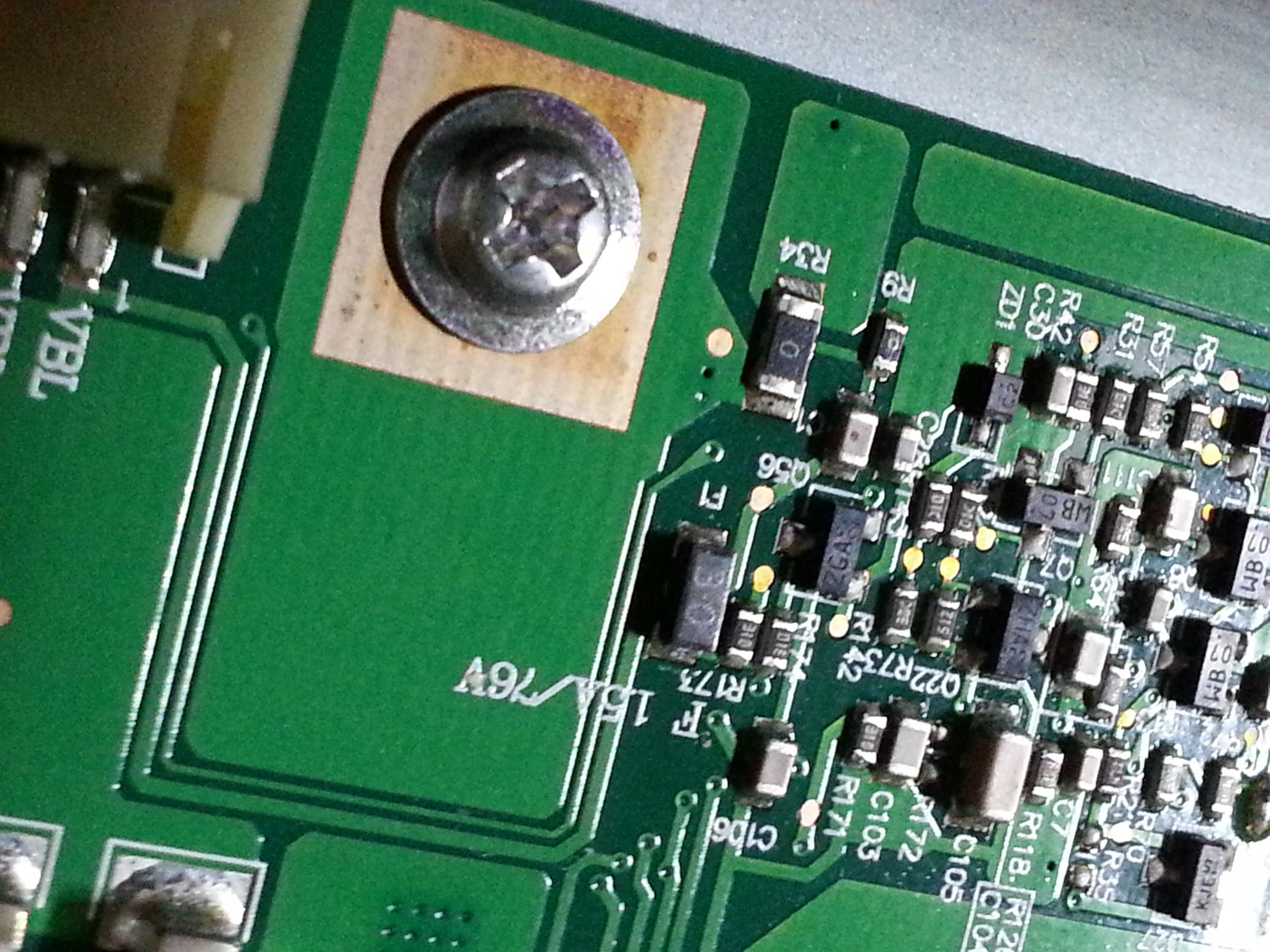

                    So are you getting 24V to the inverter boards?

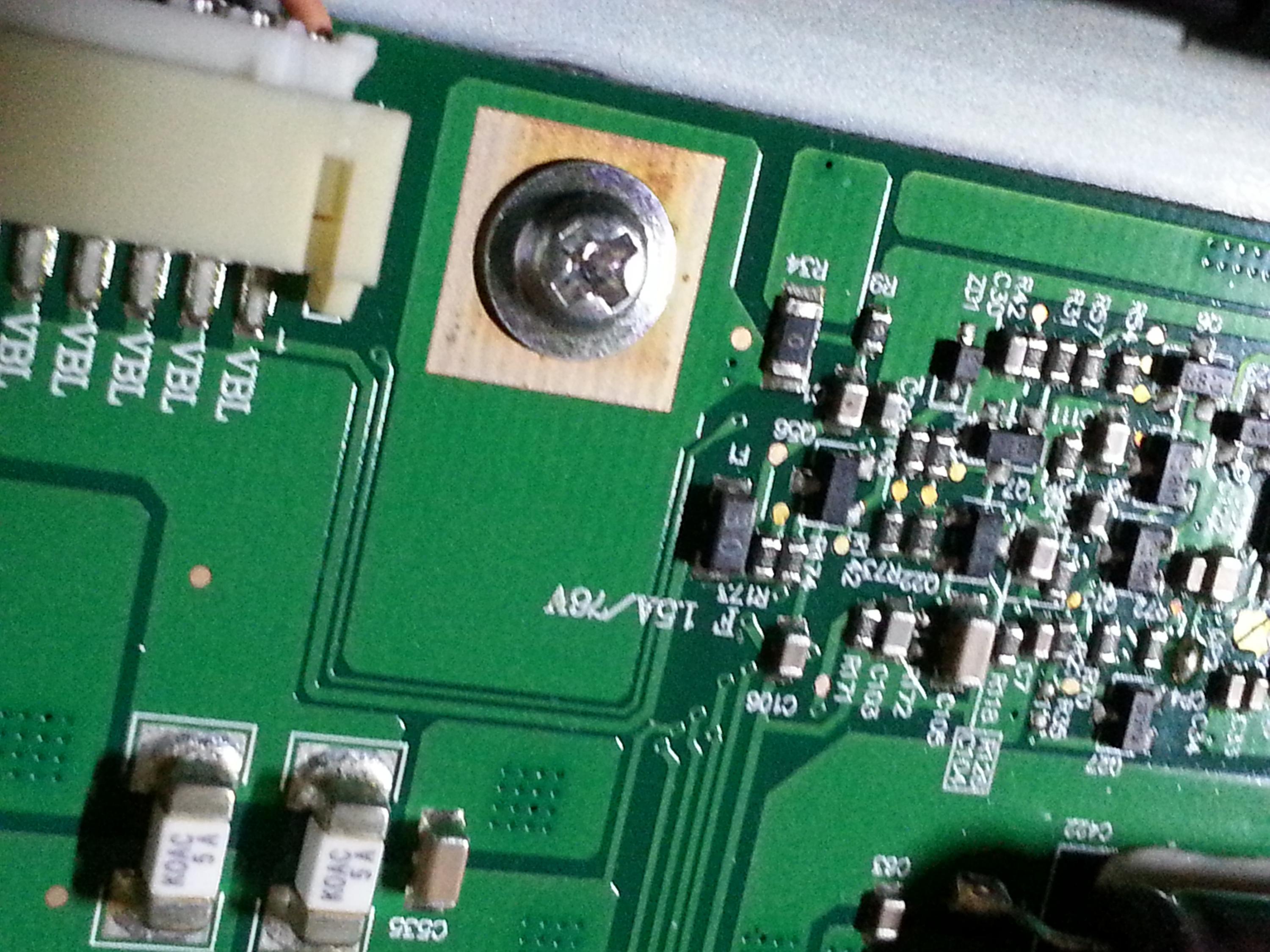

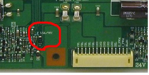

                      Can you take good close up around the white connector of the inverter boards?
                      There is a small black fuse 1.5A 76V (it has '30' on top) on the master inverter board, more likely to be open, famous failure in these CMO inverter boards.
                      By the way, that burnt mark is from high voltage arcing, which mean there is bad connection on that lamp connector, inspect the connector real well.
                        Not sure how experienced you are / if you understood budm's first question, but he wants to know if the inverters are getting 24v while the set is fully on (like when you can use a flash light to see the picture)
                        To check that you will want your multimeter on 200v DC voltage setting (or some dc voltage higher then 24v) DC voltage is marked with a solid line over a dashed line. press the one probe of the multimeter to VBL pin on the conector from the power supply to the inverter, and the other probe to GND and tell us what voltage that reads.
                        As budm said, the burnt mark on that inverter is probably not a big issue / but just from a bad conector there.
                            Here is a close up of the fuse
                              1.25 Ohms, 1.25K OHMS, 1.25 M OHMS??. Your meter should at least beep.

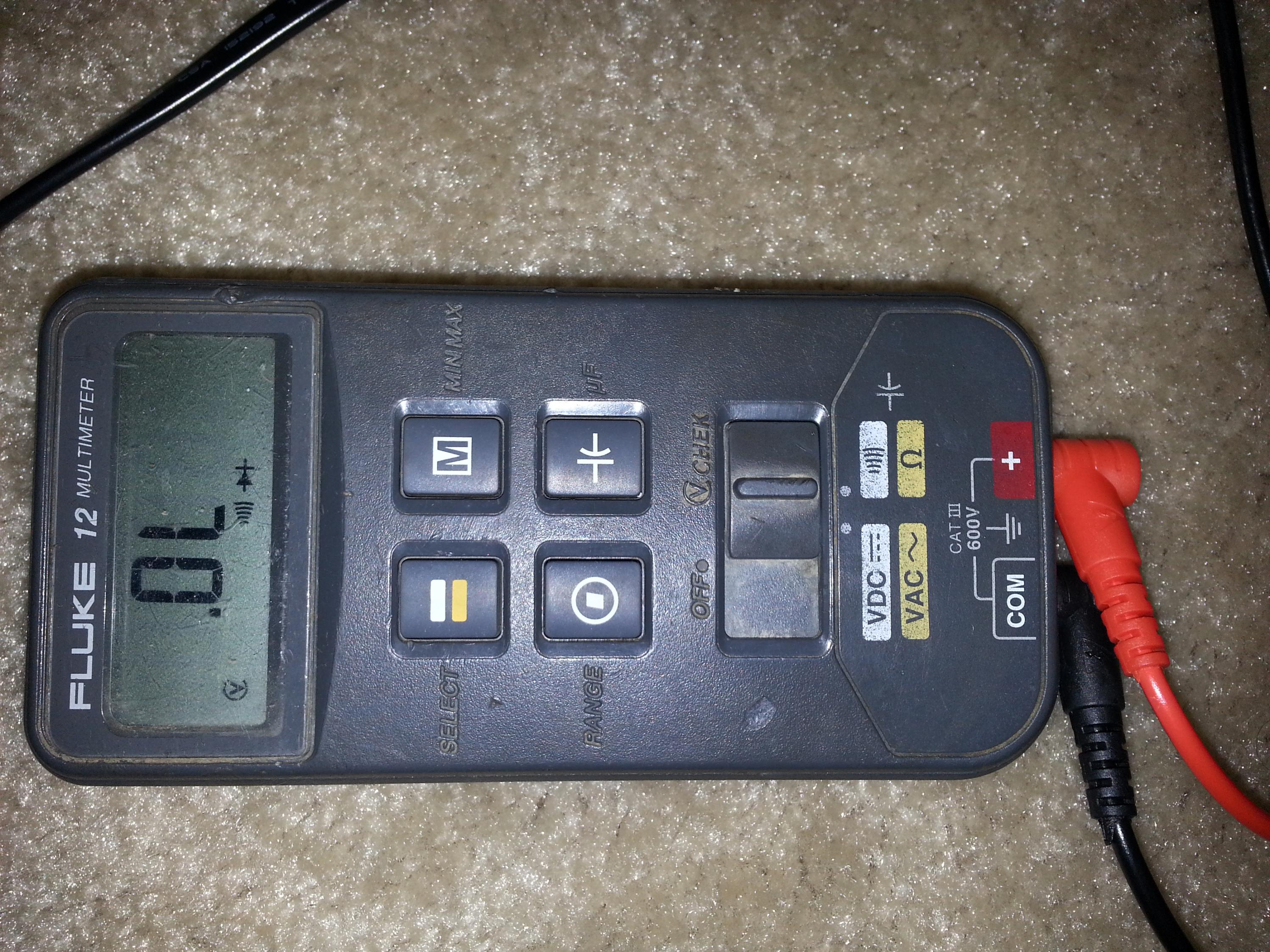

                                I am using a Fluke 12 DMM.
                                I am testing the fuse with the tv off and using continuity mode.
                                14.42k ohms
                                Or when I button with a solid white and yellow line I get
                                1.110
                                I get no beeps.
                                Attached is a pic of my MM
                                • truep
                                  • Aug 2010
                                  • 373
                                  Do you get a beep when you touch the leads together?If so, and you don't get a beep when you test across the fuse, The fuse is bad or you are not getting good contact. Be sure to press on the leads to insure good contact.
