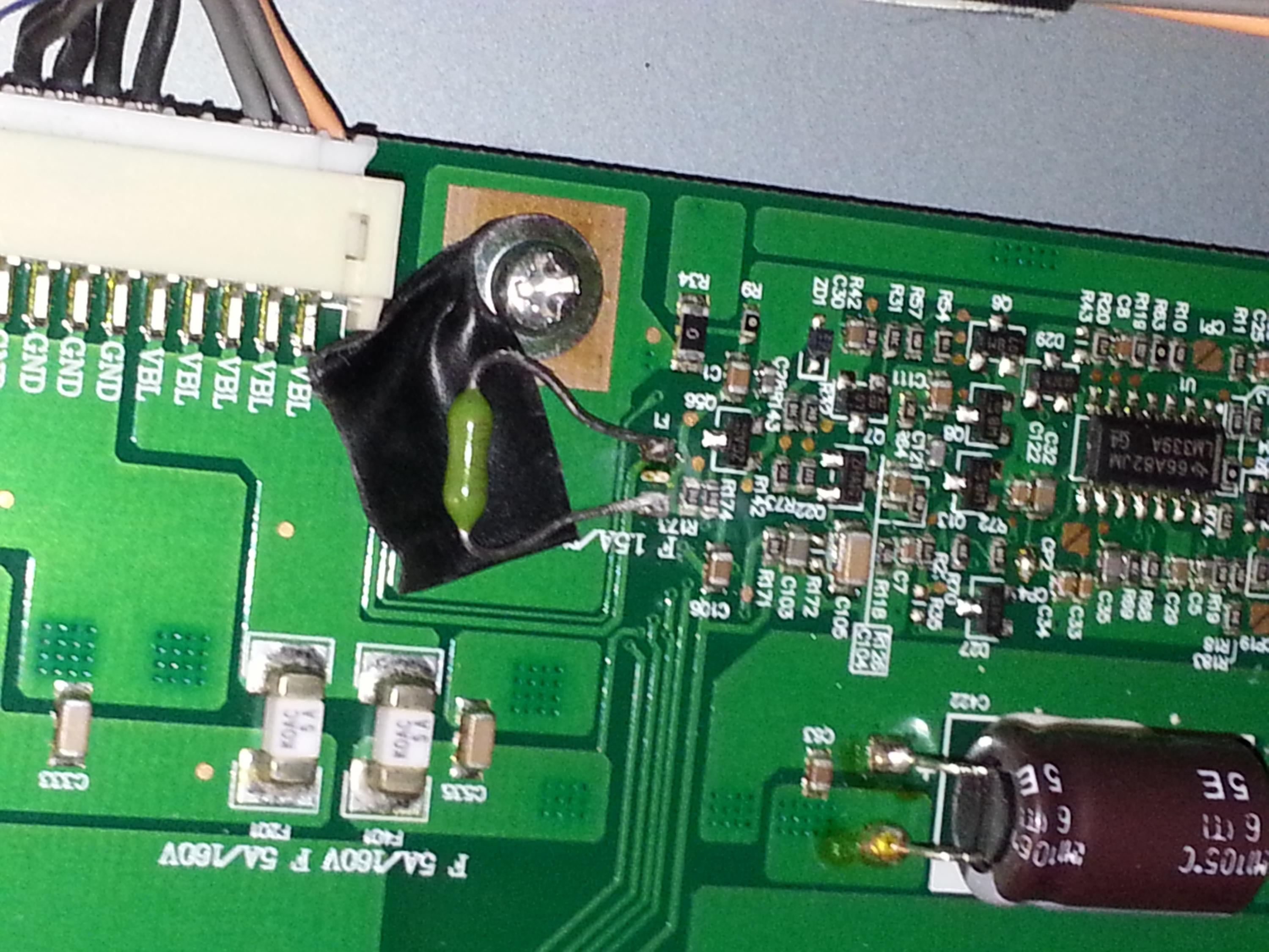

                    Re: Sharp LC-42D62U Inverter board
                    So i replaced the fuse and the fuse gets 24v on both sides. I tested the 2 white fuses below and they are getting 24 volts as well.
                    II am now getting 2 seconds to black.
                    When I test the voltage on the test points near the transformer, it reads. 03 volts.
                    The slave board acts the same way as the master.
                    I'm banging my head on the wall now lol.
                    Please help
                        So are you using the old boards and you also seat all the lamp connectors, clean the burnt connector real well? If one of the lamp does not turn on or will not fire up, or not connected or stays conducting, it will also shutdown the inverter.

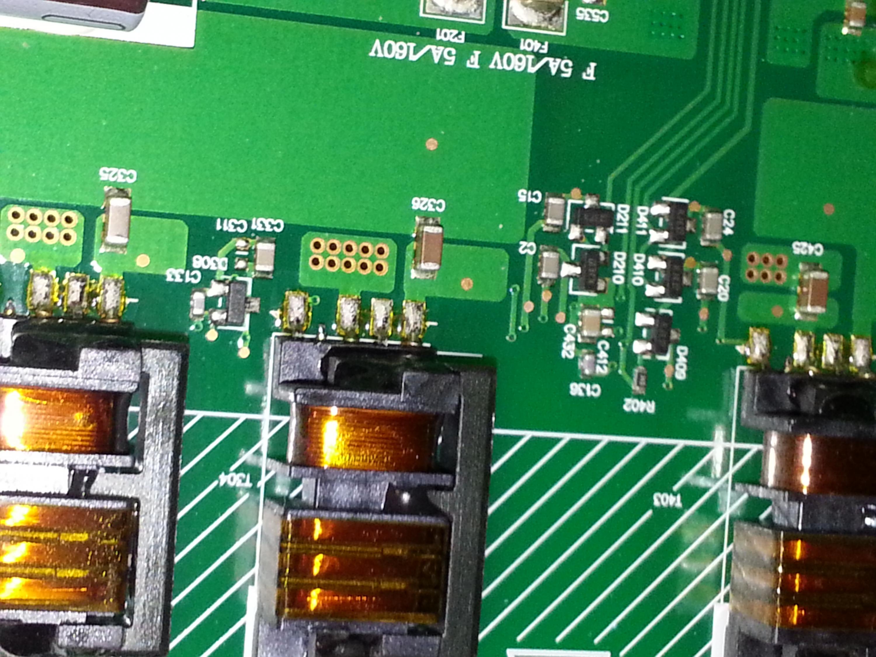

                            Can you show me that test point in the picture? This thread is getting long and hard to keep track now.
                              Here you go.
                                #55
                                OK, I see the picture of the transformers but I do not see the marking where the test point is. Is it right on the leg of the transformer?
                                  #56
                                  Right next to c326 and below it.

                                    OK, you were looking directly at the primary side of the transformer, which when the MOSFETs that are driving the transformers are not on yet when in TV in standby mode which you should see 24V on the transformer pins, when the inverter circuits start driving transformer by pulsing the DC with real high frequency, then you will need meter that can read AC (the voltage at the transformer pins are no longer at steady, but pulsing) at very high frequency it can be as high as 80,000 Hz, which your meter can not response that fast. When the lamps flash on and do the 2-second to black, one it is black out, that 24V should be there again, unless the inverter board tells the main board to shutdown the 24V power supply.

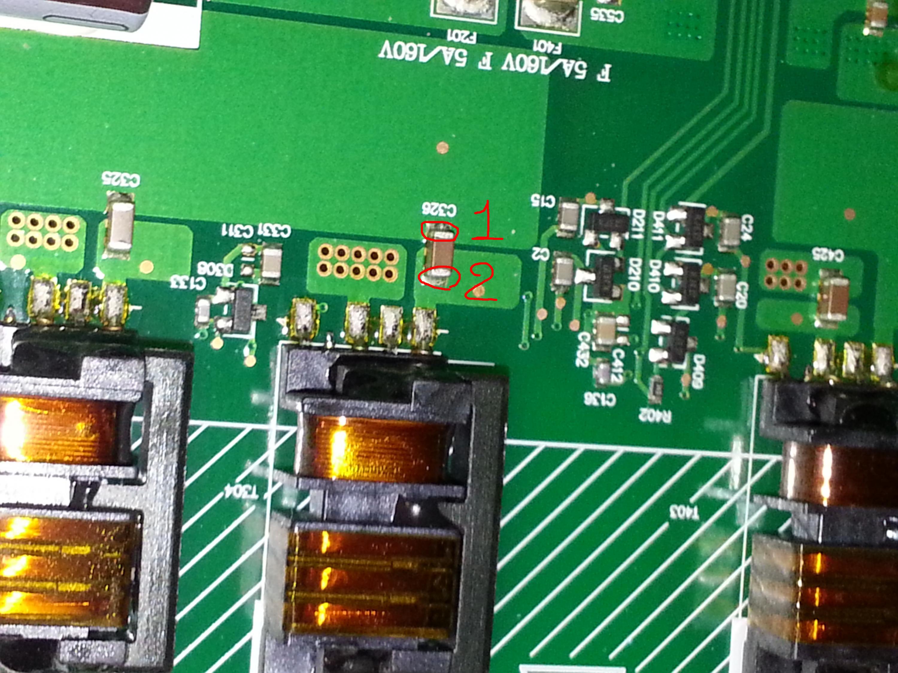

                                      Here's the thing, I no longer get 24 volt reading on the test point in the pic I attached above.
                                      Thinking it was a bad solder job, I removed the fuse and tested the test point and received 24volts
                                      Resolder the fuse and got. 03 volt on the test point.
                                      So there is a line of caps going down the center and one side when you take readings is 24 v the other side is. 03
                                      Is there something faulty going on which is causing the voltage to go from 24 to 03v as soon as it crossed the line of caps?

                                        But that blown fuse is for the PWM IC which drive the MOSFETs that drive the transformers, the white fuses are the one that supply the 24V to the primary winding of the transformer. You can verify by measuring the resistance between the white fuse and the primary side winding of the transformer. Beside you did not have the backlights on at all before replacing that black fuse. omething has to short out real bad to drop the 24V power supply, which if that is the case, the white fuses should have blown.
                                        Just to be sure, what do you get at point 1 and point 2?
                                        At this point the inverter is sensing something to cause it to go into shutdown.
