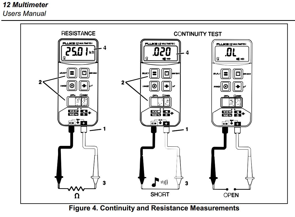

    Sorry but I'm not quite understanding how to read a defective fuse on the mm.
    When it beeps and says OL, is it defective or is it good. When I test good fuses it beeps and says OL.
    For this fuse it does not beep and gives a reading.

        Re: Sharp LC-42D62U Inverter board
        My MM is set to the audio mode where it beeps if there is an Open Line.
        When I test it on a good known fuse, it beeps.
        Are you referring to another mode that when it beeps, you should consider your MM defective?
                    Originally posted by FlipTV
                    Whats a decent DMM that will give reliable readings?
                    You have a reliable multimeter already (I also have a Fluke 12). When you put the Fluke 12 in continuity mode, it should beep when you short the probes together and show a reading of nearly 0.0. When the probes are apart it should show 0L (open loop, out of range). See snapshot of manual.
                    Most people have no problems using a multimeter correctly (i.e. where to put the probes). The main problem comes in interpreting the data correctly.
                    A good fuse should measure less than 1.0 ohms. I always advise people that using continuity is a very poor indicator whether a fuse is good or not. For example, on the Fluke 12, it will beep "continuous" for any reading under 25 ohms (see manual below). The threshold varies greatly between multimeters. Some really cheap multimeters will beep "continuous" for readings less than 1800 ohms!
                    https://cdn.badcaps-static.com/pdfs/...732f8b7f83.pdf
                    If a fuse measures 20 ohms, it is bad, but a novice user will be fooled into thinking the fuse is good. 99% of the guides on youtube, websites, people, don't understand this subtle, but very important, concept.
                    Continuity, is a useful feature, when the user understands the thresholds and when/where to use it. When it comes to measuring fuses, however, use the resistance setting.
                    PS. If you still think your Fluke 12 is crap or broken, I will happily take it off your hands.
                    PPS. When reporting your readings, because we can't see what you are doing, you must report the units. Is it 1.0 ohms, 1.0k ohms, 1.0M ohms, etc?
                          This is what I was doing to test fuses. Please bare with me as I'm on a learning curve right now.
                          What I was doing to test fuses with the TV powered off was:
                          Put the MM into Continuity mode where it will beep when you touch the 2 ends of a fuse.
                          I was testing fuses this way as most of the tutorials online recommend doing this.
                          So when I put the MM into continuity mode, touch the 2 ends of the fuse, should it beep if it is good??
                          Maybe I'll post a video when I get home so you can see first hand what I am referring to.
