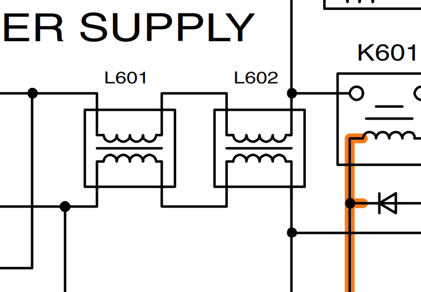

        Still trying to fix my Plasma. Could someone please tell me what these components are and what they do. The schematic is from the powerboard of the above Plasma and I am interested in L601 and L602
        thanks.
          Re: Panasonic Th 50PX70B 12 Blinks
          They are the EMI filters for the input power -- they limit the noise the power supply kicks back into the mains. If your TV has power, they are not the fault.

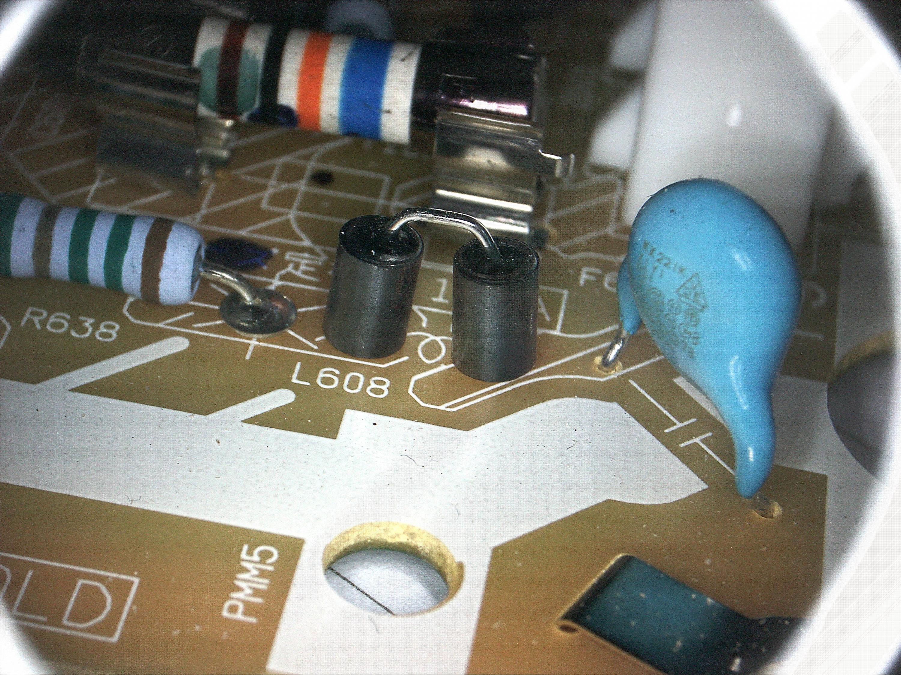

            I am struggling to understand what this component does. It is on the power board of the above Plasma and is designated
            L608
            thanks if you can help me out, as I cannot find it on the schematic
              thanks Tom, I made a mistake reading the schematic, i know about the EMI filters its the L608 I really needed to know about. Sorry for the mistake.
                It's a ferrite bead -- again limiting the noise the power supply produces. It should appear as a short circuit on your ohmmeter, it is basically a piece of wire with magnetic material around it.

                    #29
                    Can someone please advise me of why the lines on this schematic are traced in orange. I know it is probably fairly intuitive and simple but your help would be appreciated.
                      #30
                      It means they are the major buses carrying power. Blue indicates a different voltage, etc.

                        #31
                        I am a bit confused, if that was the case why are the lines in and out of the bridge not Orange also, as surely that is a major power carrying line. I am not disagreeing with what you state, just trying to understand in more detail.
                          #32
                          They only use them on the secondary outputs (isolated from primary), typically on the digital boards, to ease tracing through the fault. You won't see them so often on the power boards because those are easier to follow through, but some of the digital boards can be hard to trace otherwise.
