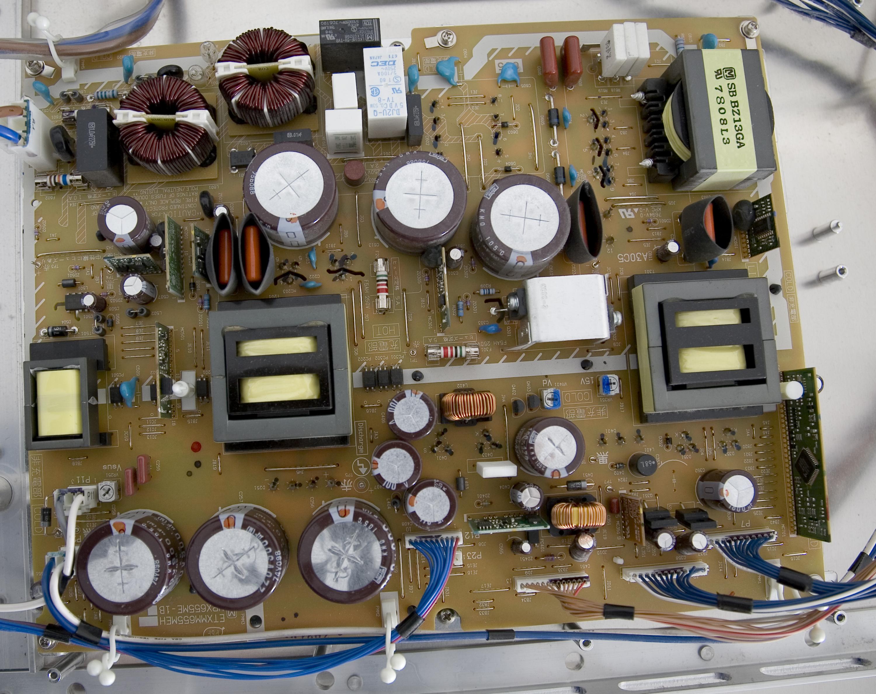

    Hi, and thanks for any help before I begin.
    My plasma has 12 blinking red LED flashes and will not start up. I ave managed to source the service manual which is very informative, and leads me to believe the P board is defective.
    I am not happy about just replacing the board on the off chance it is faulty and would like to know if anyone would have an idea about what could be wrong with the P board.
    Is it worth me trying to locate the problem or am I really wasting my time. I am hoping there is a common fix I can do, surely there is a component that normally fails - or is that too simple.
    Thanks again for any help.

            Re: Panasonic Th 50PX70B 12 Blinks
            Hi
            I have uploaded an image of the board. I will try and test all the voltages today and post the values.

                        Is there something odd looking about the main fuse F602.. I think it looks burnt.. I know it must be working given that there are voltages on some of the rails but it looks burnt on one side.. The two large caps C257 and C256 look slightly bulged and might be worth testing... Cant see anything else that looks dodgy..
                        I like the way you've marked half of the pots to show where they have been moved to.. I usually mark them with one dot but even still it can be hard to keep track of how far they have been turned.
                          Looks like factory markings to me...
                            Hi - no fuses are fine, which is a shame. the markings are from a marker pen, and do seem to be from the factory.
                            I was looking at a small capacitor and it reads
                            0.01 Uf on the casing but tests at 5400 pf
                            is that an acceptable range?
                                      http://www.tgohome.com/ServiceManual...PX75U_[SM].pdf
                                      There's a schematic of that same ETXMM655MEH power supply in this service manual for a similar type of TV. This will help you to troubleshoot the components..
                                      If it was me, I would start by printing out the P-board schematic and take note of what voltages are on all the connections. You can then establish which parts are working and which are not, then focus your troubleshooting on the components on those sections..
                                      There are a lot of "Power Control" and "Control Module" ICs on the board, I'm not sure how you are gonna be able to check those, aside from checking the similar ICs against each other.
