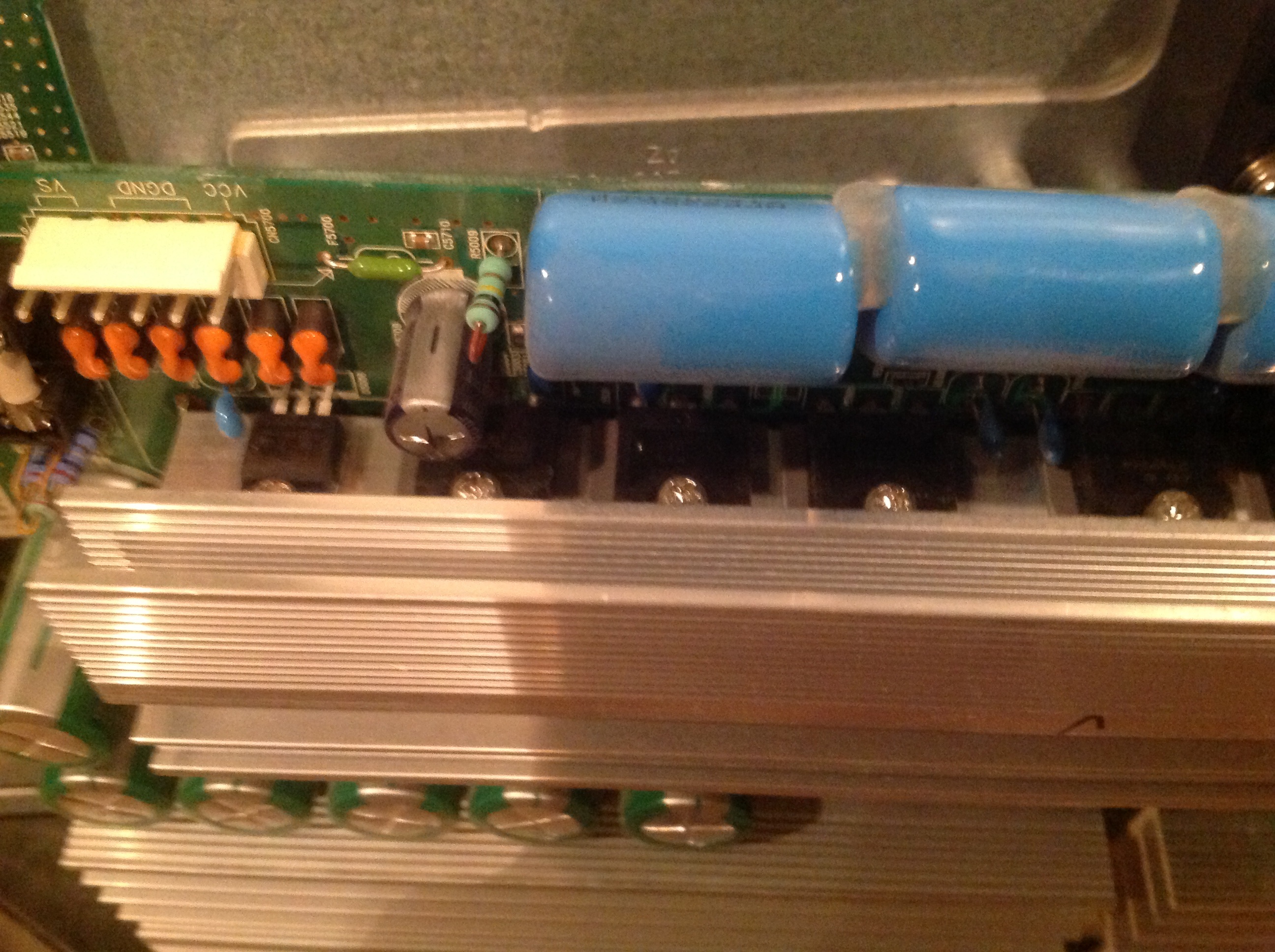

                          This is the y-main
                          • Swright
                            • Apr 2013
                            • 29
                            #33
                            Re: Vizio vp50 hdtv20a no pic just sound
                            Same side y-main

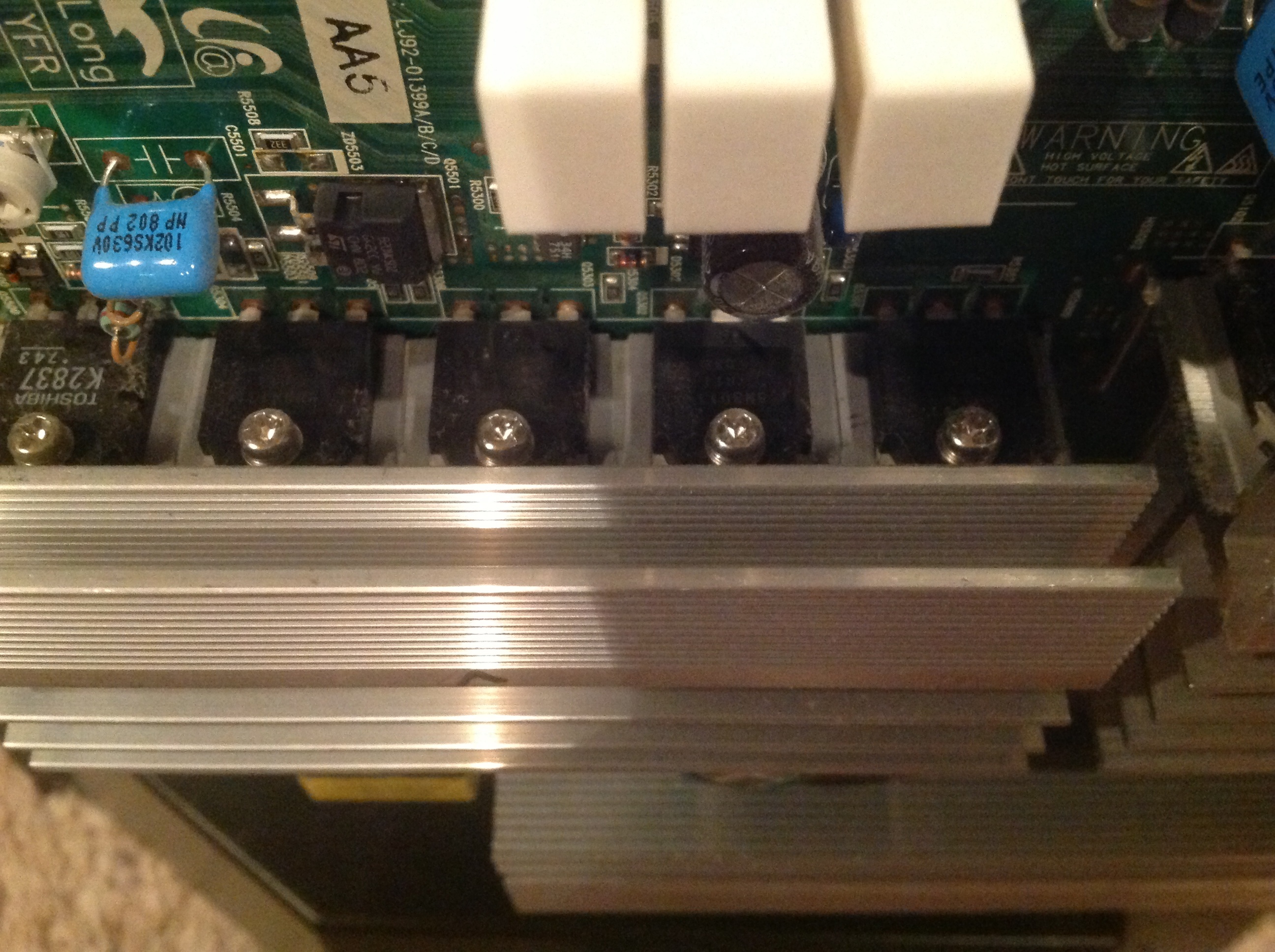

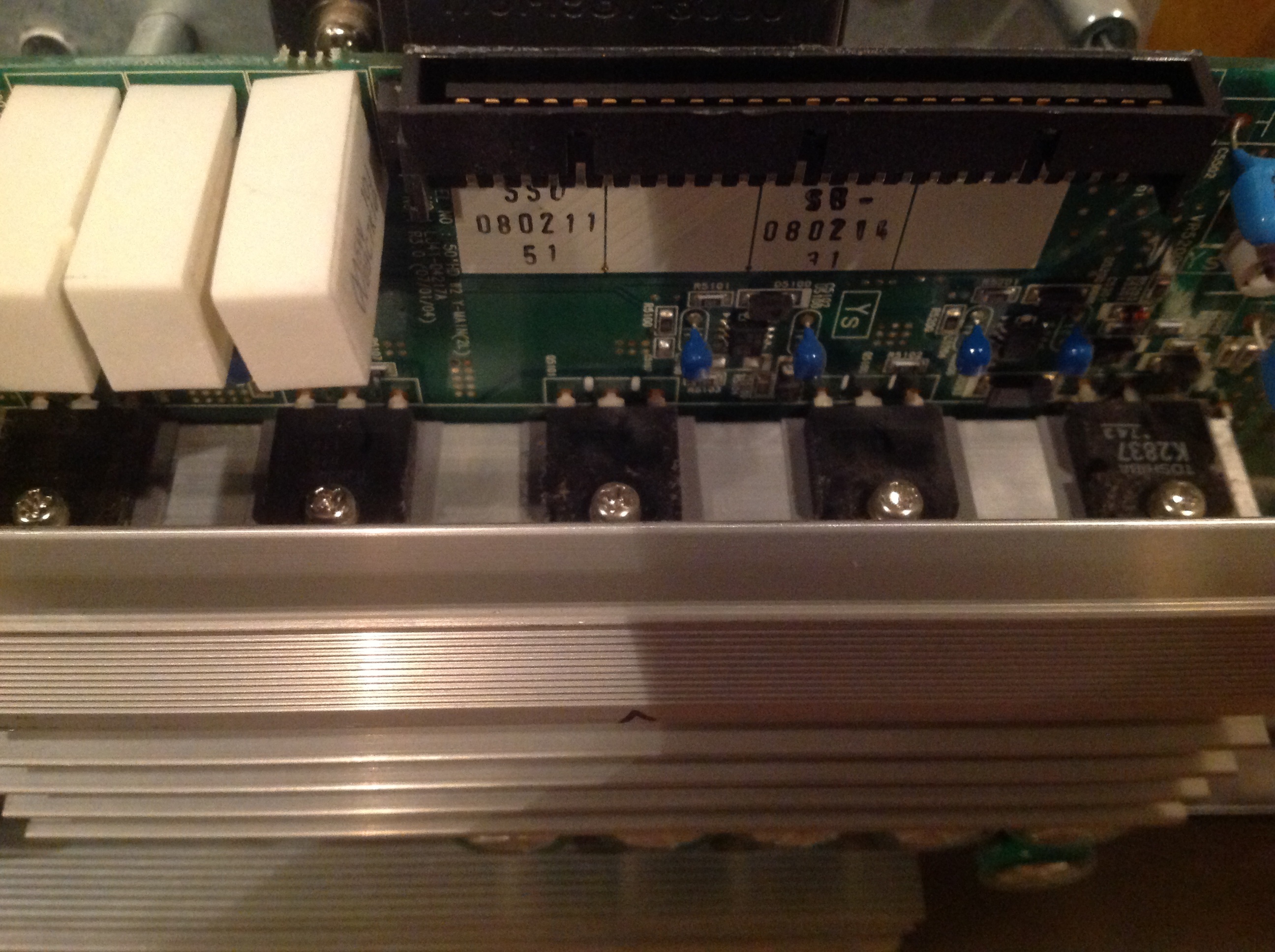

                              Other side of y-main, see the bad cap.

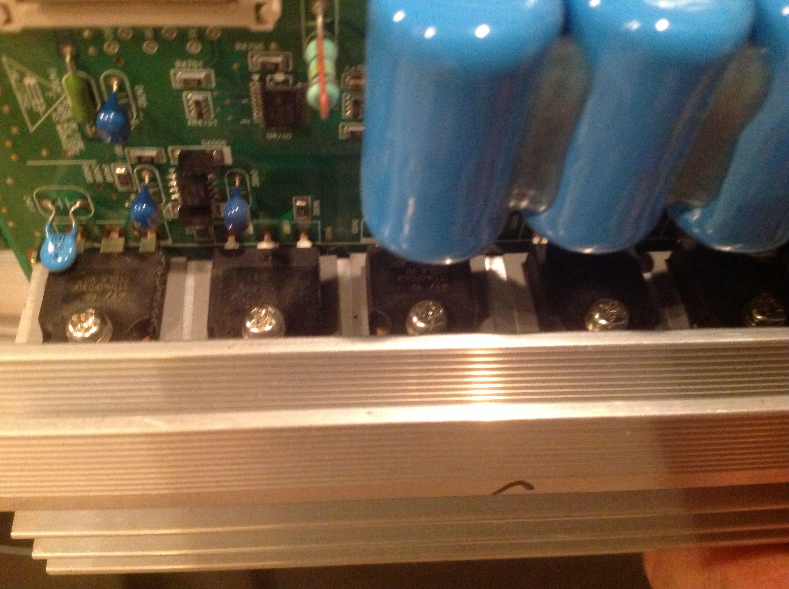

                                Y-main

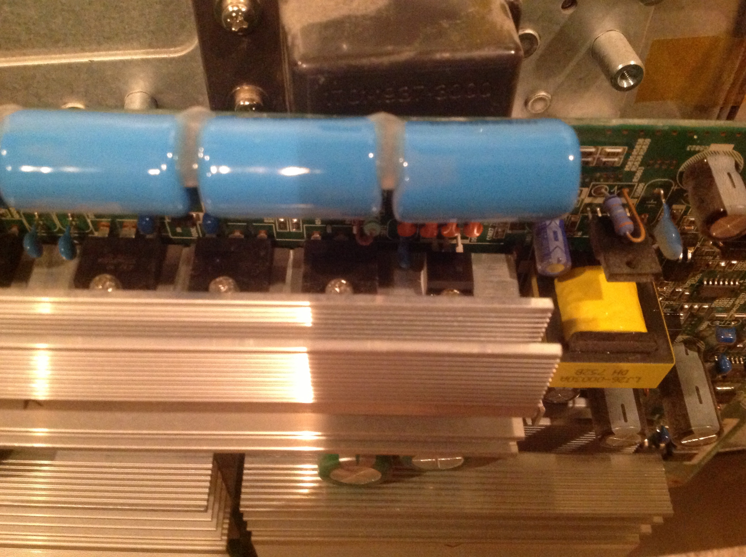

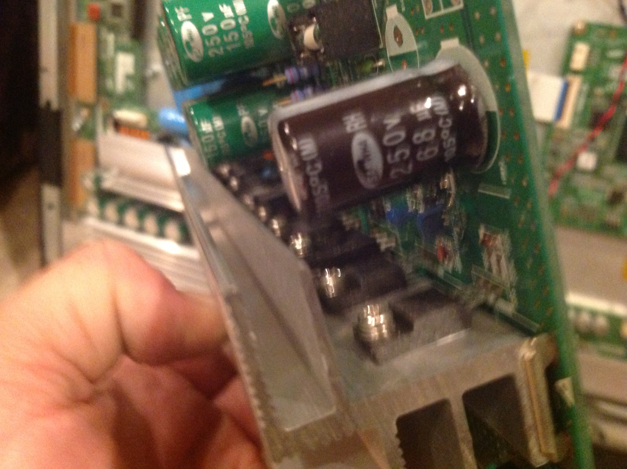

                                  X-main
                                  • Swright
                                    • Apr 2013
                                    • 29
                                    #37
                                    X-main here is the other bad cap, between the fuse and the bigger 250v 68uf cap. I already took it out waiting on the new one. Luckily I ordered two one for a spare, then I found the other one blown on the y-main tonight.
                                      Did you check the green fuse next to the cap? I'd also check the transistors on that heat sink.
                                      Yeah, I always order extras. I'd do the same thing on the X-main: Check the components near the cap and check the transistors on the heat sink. It looks like there's a green fuse near that cap, too.

                                          #40
                                          It's hard to see the markings on the transistors, but I can at least see K2837, which is an N-channel mosfet. I'm guessing that the others are N-channel transistors or diodes, but I don't know.
                                          For K2837, from left to right, you have Gate, Drain, and Source pins. In diode mode on your meter:
                                          (1) Place your red probe on Drain and black probe on Source: Should read "OL" or "1" depending on your meter (no reading).
                                          (2) Reverse your probes: You should get something like 0.5V.
                                          Repeat this test for Gate and Drain:
                                          (1) Place your red probe on Gate and black probe on Drain: You should get something like 2V. <<- may be dependent on your meter.
                                          (2) Reverse your probes: Should read "OL" or "1" depending on your meter (no reading).
                                          The key is that you should get a reading in one direction and no reading in the other direction.
